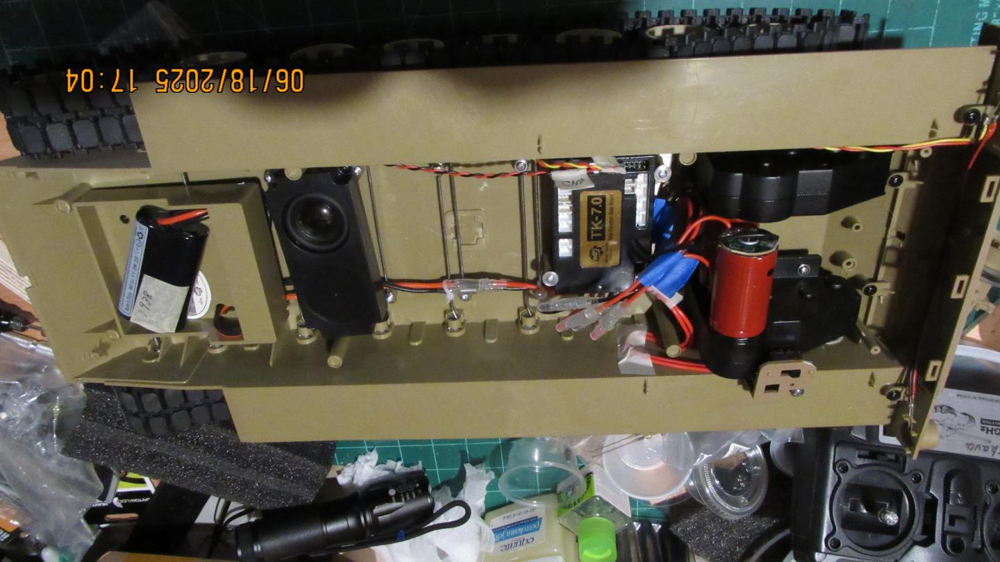

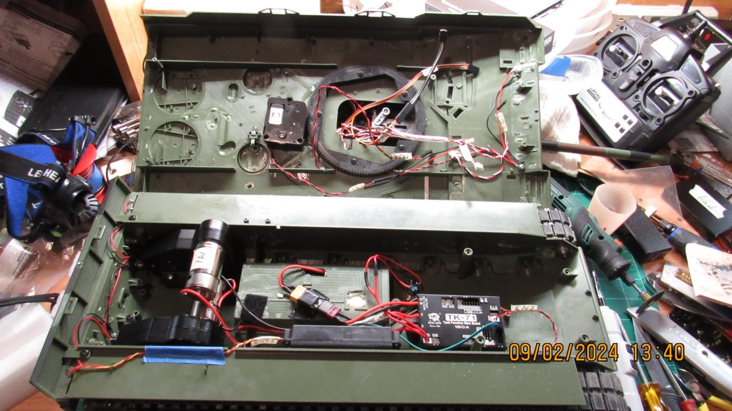

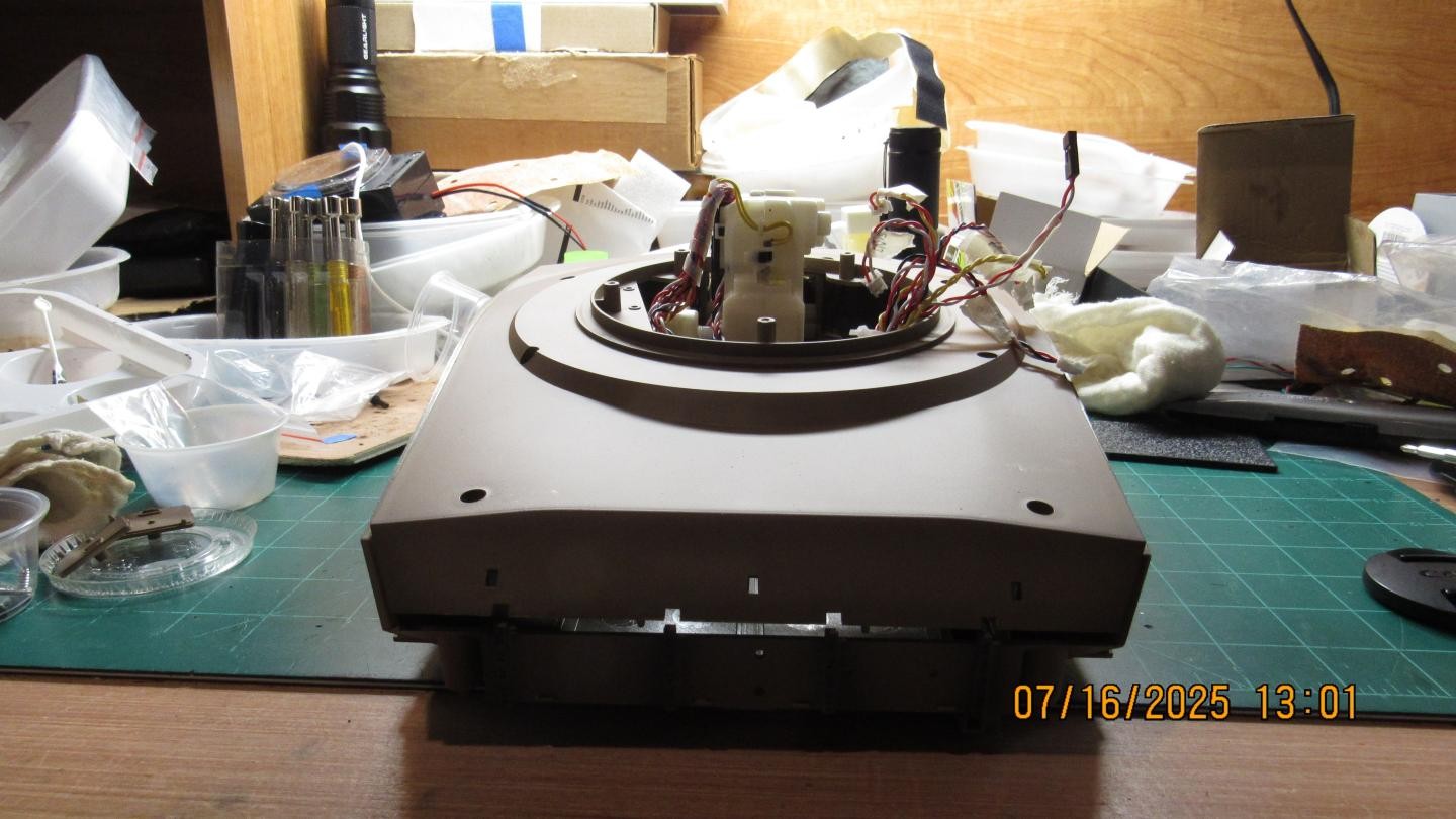

    The Leopard is an easy case. I have a Torro metal chassis for the Leo. Both the original HL and the Torro (picture2) have lots of open space in the chassis because the canon mechanism and BB shooting are all confided in the turret above the chassis.

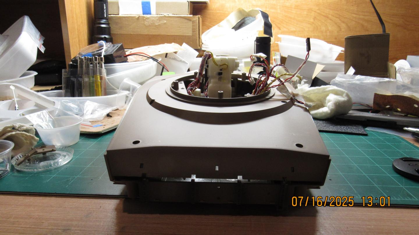

    The HL Abrams turret is a totally different story. The canon mechanism and BB shooting are pretruding 3/4" below the turret. Any speaker box thicker than the original HL speaker will interfere with the turret rotation.
    Click image for larger version  Name:	IMG_5527.jpg Views:	0 Size:	135.4 KB ID:	429760 Click image for larger version  Name:	IMG_5523.jpg Views:	0 Size:	135.2 KB ID:	429759
    I spent 2 days rearranged the Abrams chassis, including removing the battery box upfront. I finally gave up and reinstalled the HL speaker.

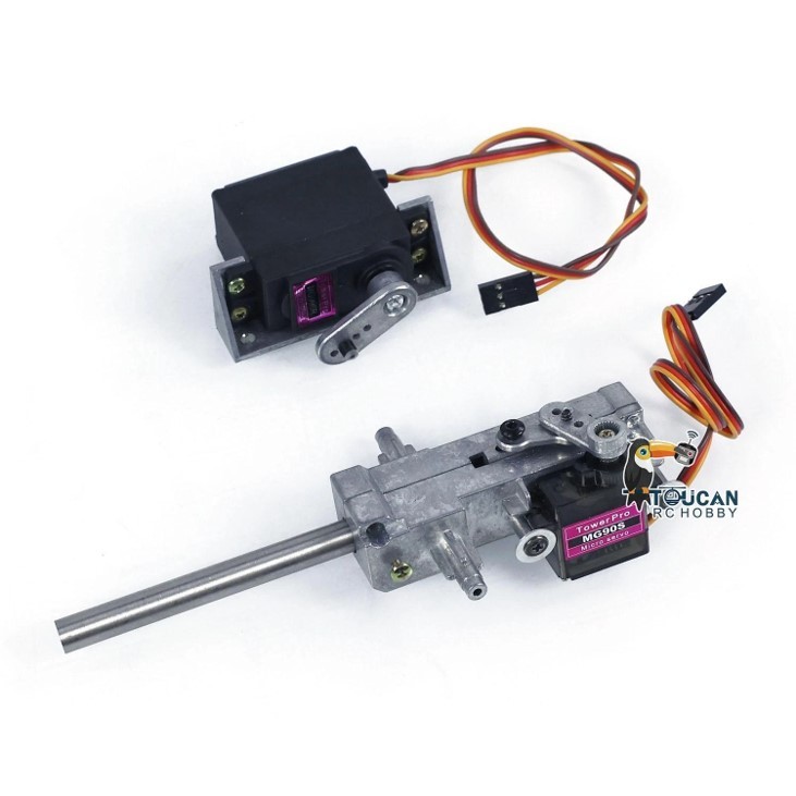

        I may get back to the Abrams for the 2.5" speaker upgrade. The HL 1" speaker has a peak at the lower midrange, making the gas turbine sound exaggerated and somewhat unrealistic. I will have to replace the HL elevation/recoil unit with a servo one like this:
        Click image for larger version  Name:	IMG_5332.jpg Views:	0 Size:	102.1 KB ID:	429844 Click image for larger version  Name:	servobarrelrecoilunit.jpg Views:	0 Size:	59.8 KB ID:	429847
        The servo barrel recoil unit is much more compact than the HL trigger motor unit.

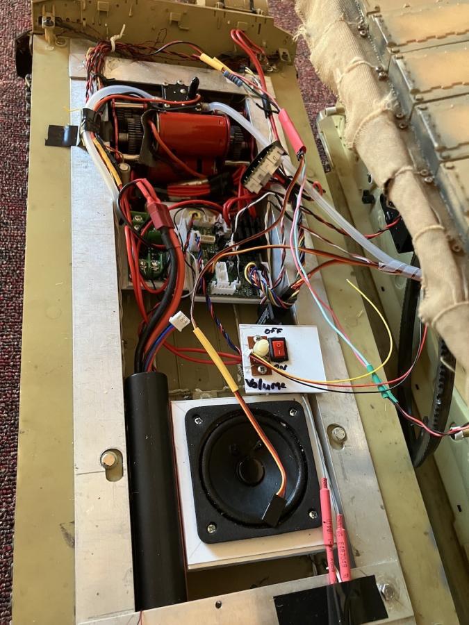

                Originally posted by keilau View Post
                Do you use the DKLM loudspeaker? A picture of your RC tank chassis will be much appreciated.

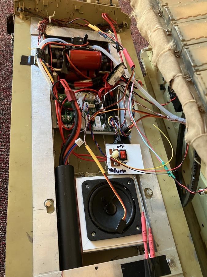

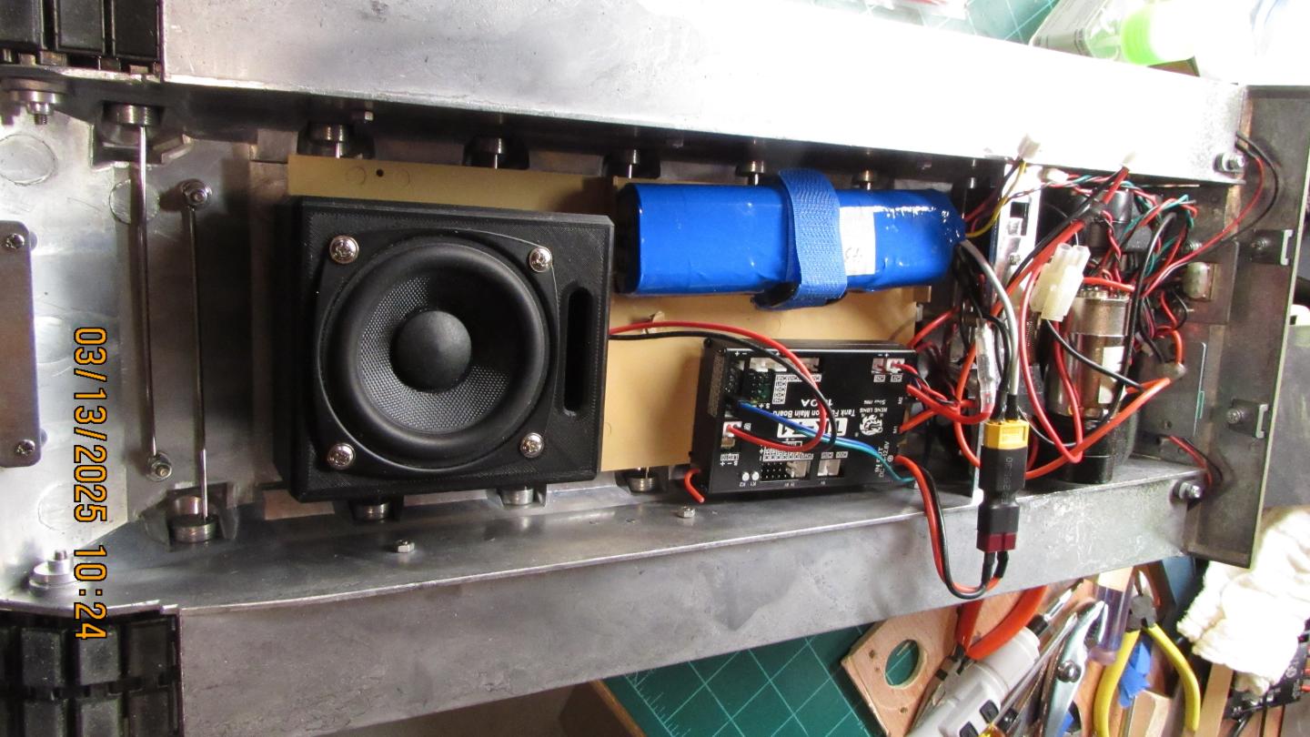

                No the speaker is not from DKLM. Cheaper to buy direct from Visaton, and build a speaker box. The simple solution to gaining space, is to remove the battery box.
                I have also see where the battery box has been made smaller, and used to contain the speaker.

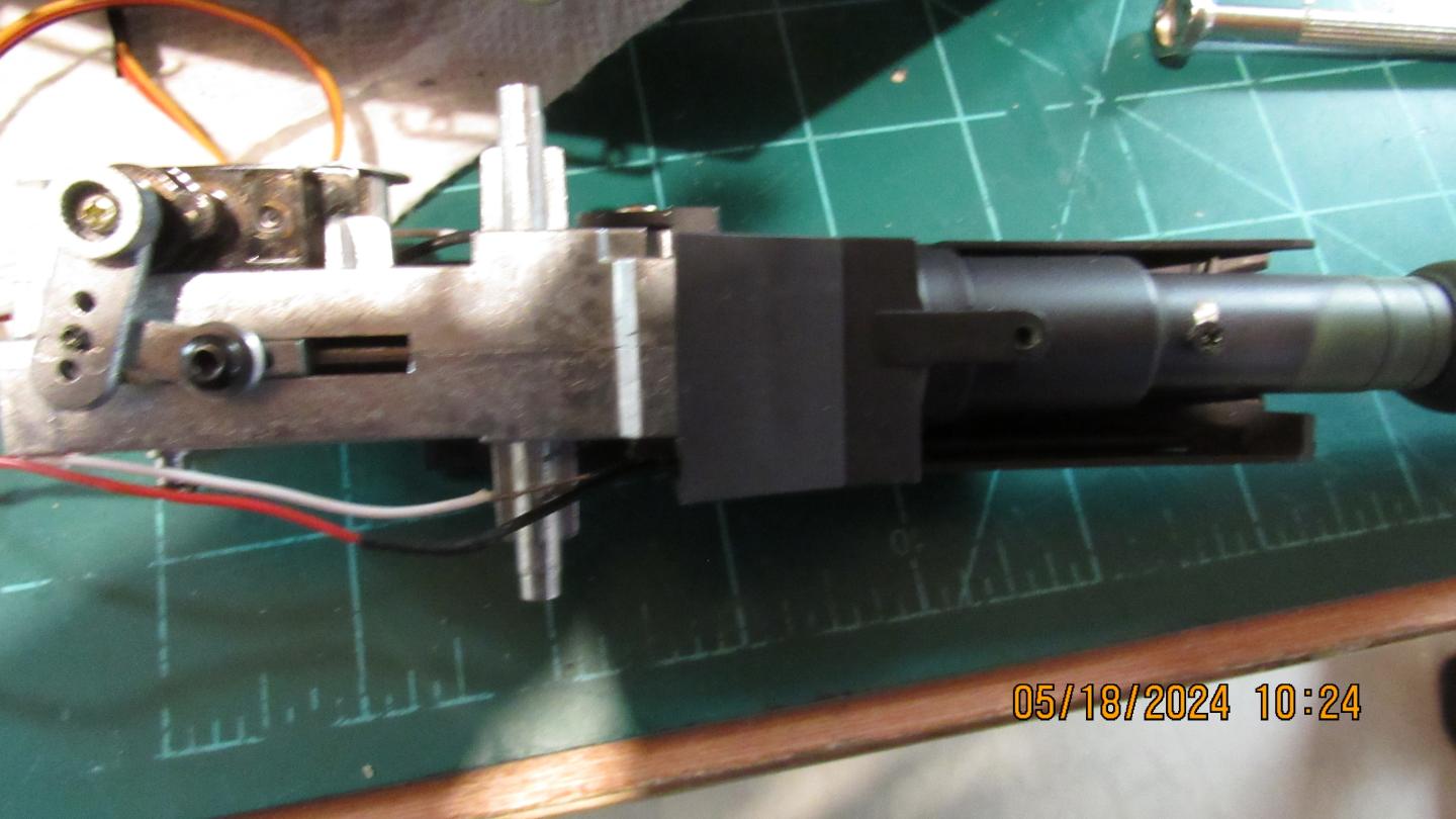

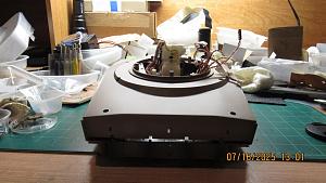

                  Did you do anything about the canon mechanism and BB shooting unit pretruding from the turret?

                    Sorry for the late response. As I do not use the BB shooting, it is simply cut off below the elevation tracks.
