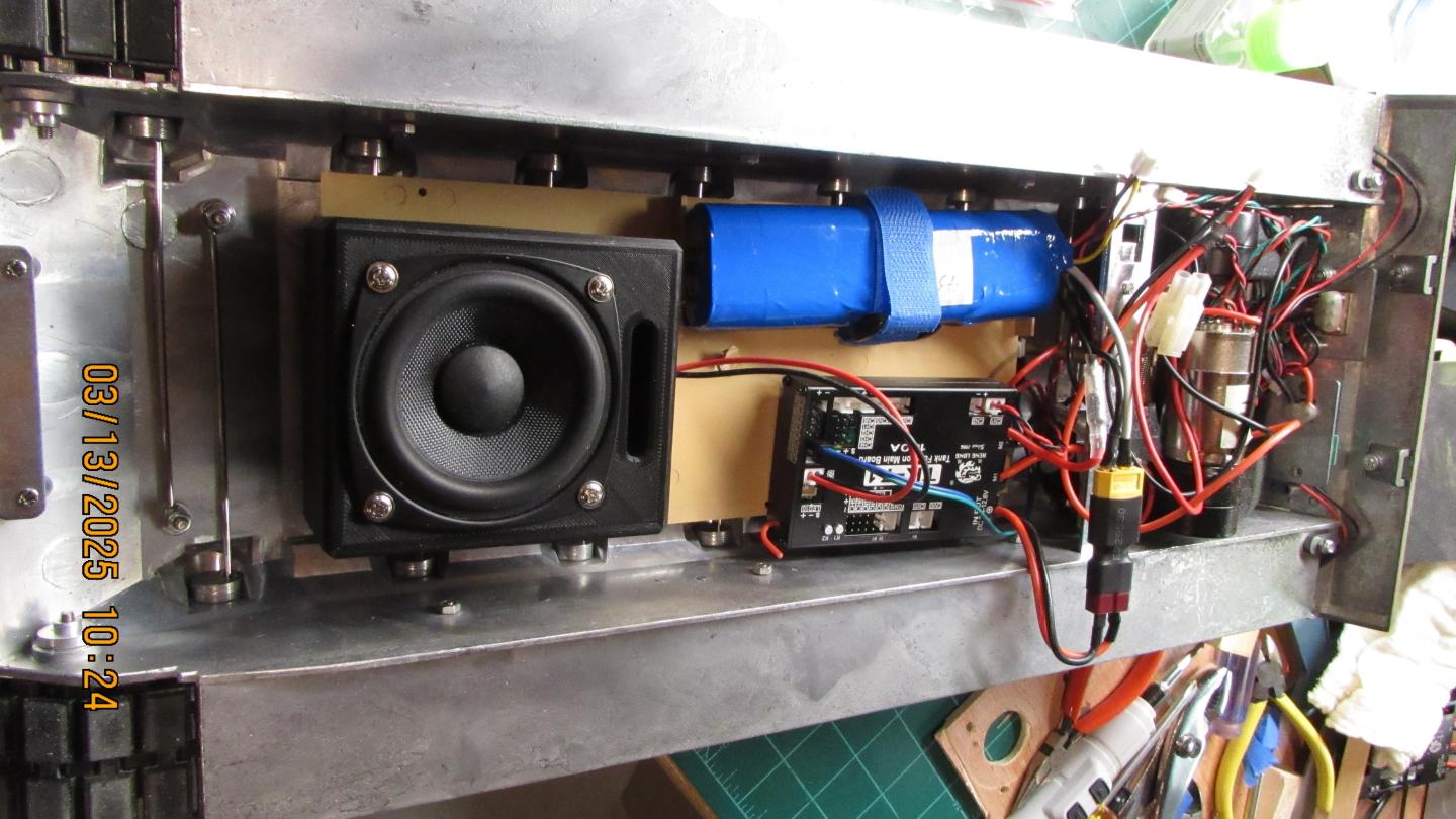

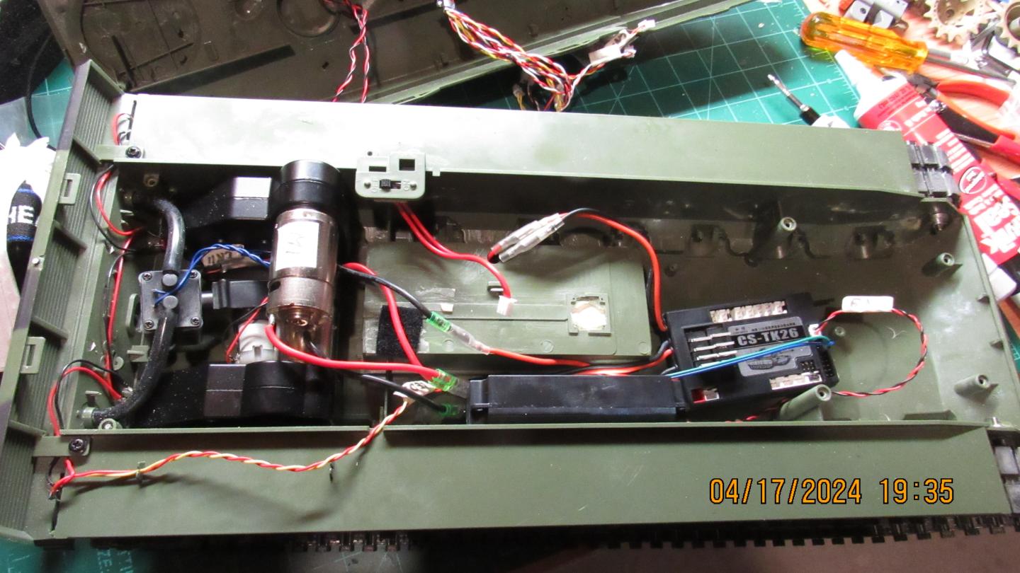

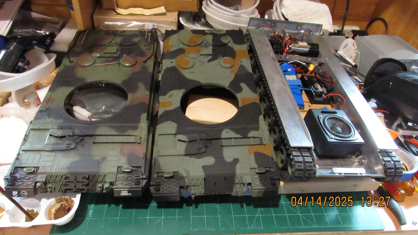

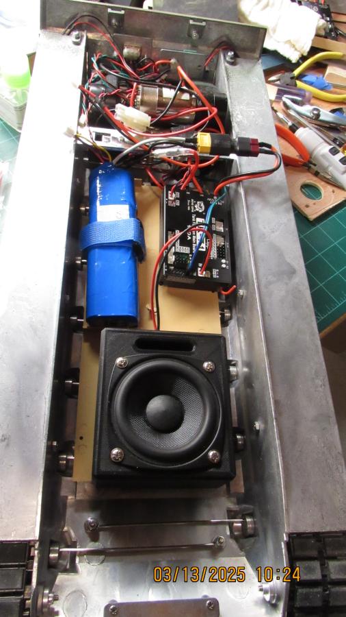

                In the original HL Leopard2A6 chassis with coil spring suspension, the battery compartment took up much of the space. It is difficult, if not impossible, to fit a 2.5" loudspeaker.
                Click image for larger version  Name:	IMG_5321.jpg Views:	0 Size:	153.1 KB ID:	429312
                I added the 2.5" loadspeaker after I upgraded to the Torro all metal chassis. I use velcor to fix the components to the floor plate over the torsion bars.
                Click image for larger version  Name:	IMG_5503.jpg Views:	0 Size:	154.7 KB ID:	429313 Click image for larger version  Name:	IMG_5487.jpg Views:	0 Size:	74.2 KB ID:	429314

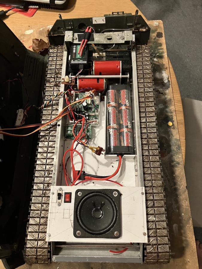

                  I used 2mm plastic card, to make the speaker enclosure, in my Tamiya Leopard 1, which has torsion bars. The enclosure has cotton wool in it to aid sound. Click image for larger version

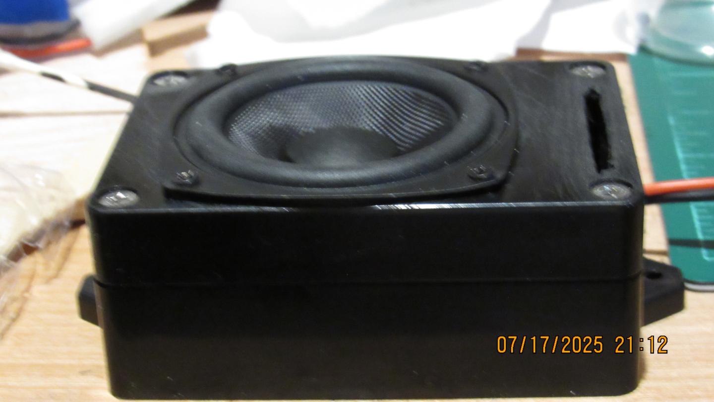

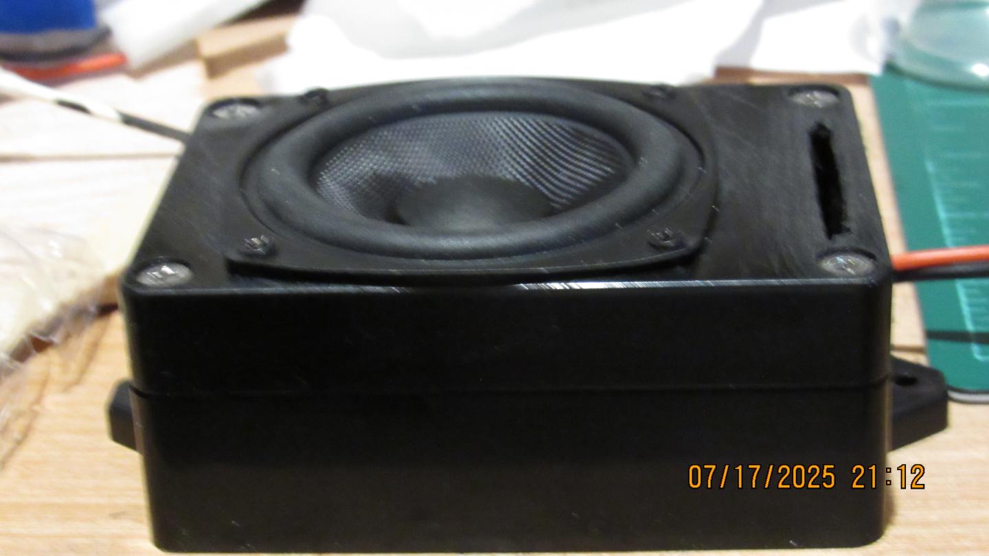

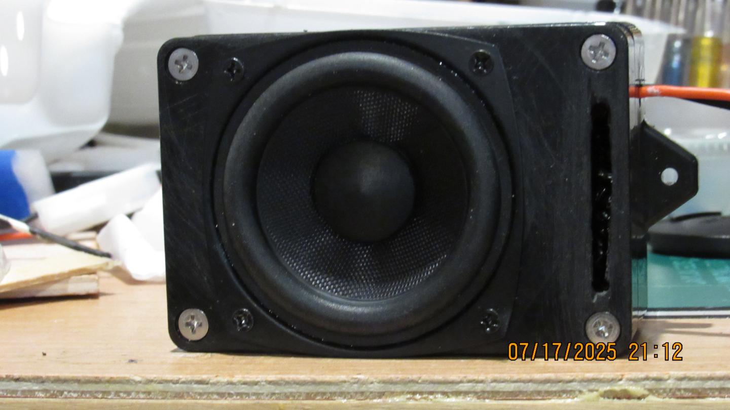

                      Since DKLM currently do not ship to the US, I made the loudspeaker enclosure out of plastic project box from Amazon. I was able to find the smallest project box (100 x 68 x 40 mm) that can fit inside the Abrams V2 chassis and still house the 2.5" speaker. The box is much sturdier than the DKLM enclosure. I lined it with 3M vibration damper. It is important to use an vented loudspeaker enclosure to enhance the efficiency and the low bass.
                      Click image for larger version  Name:	IMG_5534.jpg Views:	0 Size:	82.4 KB ID:	429325 Click image for larger version  Name:	IMG_5533.jpg Views:	0 Size:	101.1 KB ID:	429324

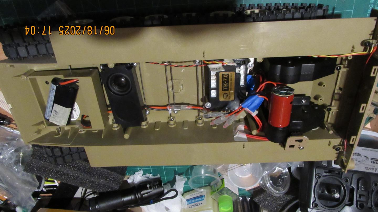

                                    After trying for 2 days, I can't figure out a chassis floor arrangement to accommodate the 1.57" thick loudspeaker for the Abrams.
                                    The location in the Leopard Torro chassis does not work because HL put the battery compartment there.
                                    Click image for larger version  Name:	IMG_5487.jpg Views:	0 Size:	157.1 KB ID:	429413 Click image for larger version
