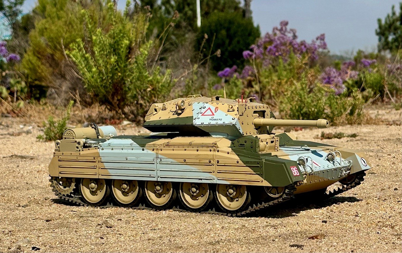

        Yep, you did good. Check youtube for M5 videos. They do go a lot faster than their heavier brethren. I guess that's why they were used for scouting!
        The Crusader has the same guts as the M5 & M8. It's a larger thank though, and runs a bit slower. By all means do a caunter scheme. It took a LOT of masking tape and newspaper, but it's worth it.

          Damn! You beat me to it!
          Now that does look good. Hoping they do a Matilda or a Comet at some stage in the not too distant.
          Always felt that British (I declare my bias here) tanks have got a worse press than their Wehrmacht counterparts.
          How's the Crusader run? Does smoke function work?
          Never been overly interested in the bb shooting thing that you get with other more expensive types. Quite happy with a scale representation that has accurate detail, and runs. The
