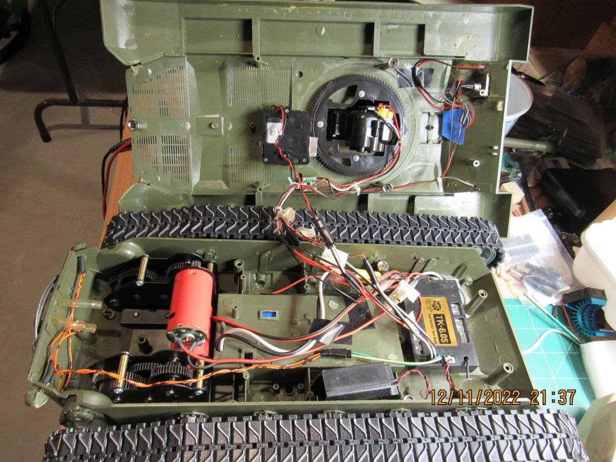

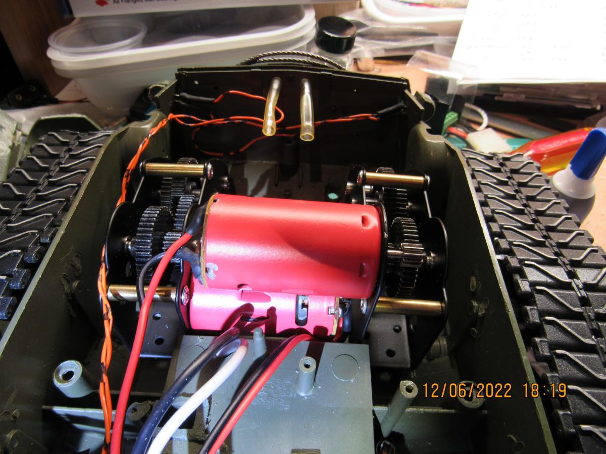

The Red390 runs at 25000rpm (vs 15000rpm of the standard HL380). It is better suited for the bigger and faster modern MBT such as Abrams, Leopard2A6, Challenger2, T-72/T-90, Merkava. I also use 390's on my Pershing, M60A1, T-34/85 where they will have excessive scale speed, but are fun to drive in open space. The only tank that the 390 cannot physically fit is the Sherman.

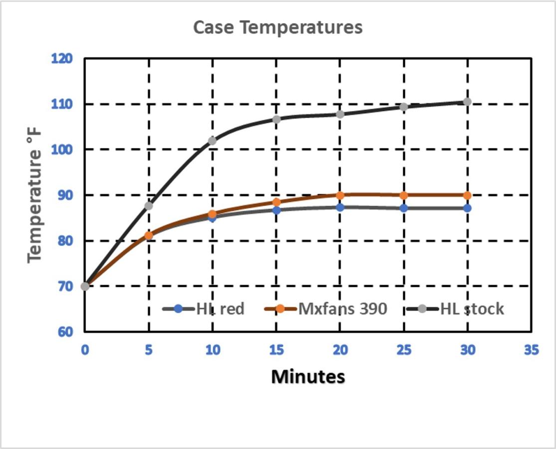

Using 8.0 volt Li-Ion, the HL grey stock 380 measured at 15,000 rpm. The grey 380 runs at 40°F above ambient. The 4 better quality motors all run 20 degrees or more cooler. The Mabuchi RS380PH-3270, Tamiya 380SP, HL Red 390 and MxFans 390 have rotational speed of 14,000, 17,500, 26,000 and 30,000 rpm respectively.

The HengLong RC tank come with the grey380 motor which is a knock-off of the Mabuchi 380. It runs at about 15000rpm, but runs hot at 40°F about ambient. The 390 that you use has an internal cooling fan and runs 20°F cooler. It should give you reliable service in your large MBT RC tanks. Below is the motor case temperature measurement in a HL Leopard2A6 with all metal drive chain and Tamiya track.

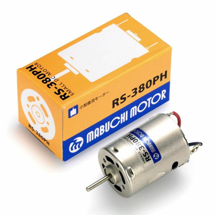

The HengLong grey380 runs hot because theu cut corner to save cost. It uses high friction sleeve bearing for motor axle instead of the ball bearings in the Mabuchi motor. If I have to use 380 motor, I pay the premium to get the Tamiya SP 380 which is bonafile Mabuchi motor and runs much cooler than the HL grey380. Mabuchi does not sell to the retail market.
