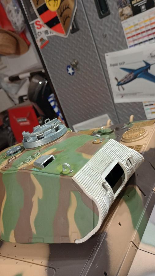

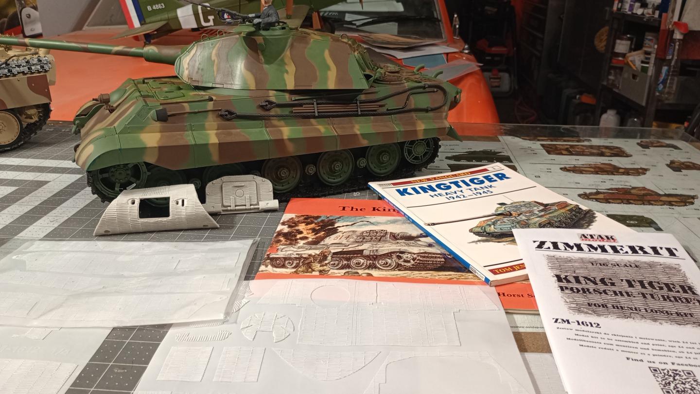

                          So it came today, along with the decals which I ordered the same day I bought the model. Just waiting on the Atak zimmret kit which is coming from Australia somewhere, and I think I'm going to order a Heng Long professional version to get all the metal parts and barrel recoil etc. There's some pretty smoking deals on eBay from Toucan. I also have a barrel smoke kit. One of these days I'm going to learn to stop sticking irons in the fire.
                          On a side note the turret/main gun mount was broken when I got it, USPS must have had a lot of fun throwing the box! I used regular model glue to set the parts and then reinforce them using the baking soda and super glue trick. It's amazing if you've never heard of it. You can actually tap it if you need to. It's hard as a granite.

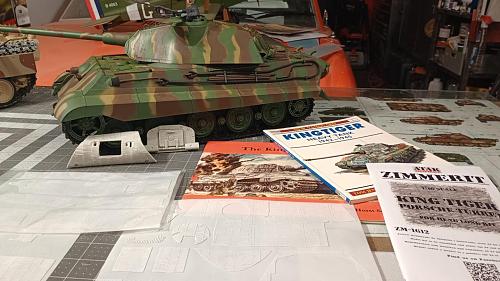

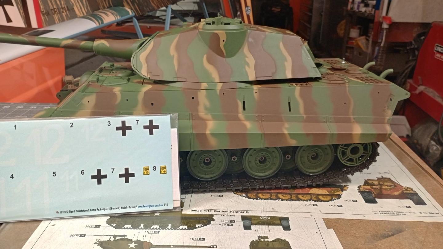

                            Click image for larger version  Name:	IMG_20251201_180808598.jpg Views:	0 Size:	173.5 KB ID:	440612

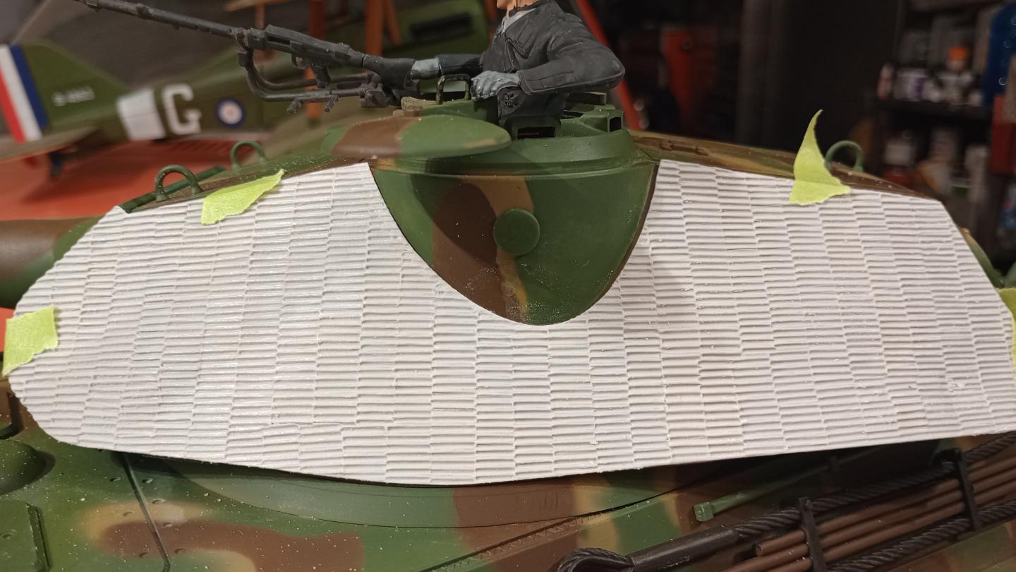

                            Ok, the zimmerit came today which was surprisingly fast as it came from Australia. Purchased it from eBay as the company ATAK does not ship to the United States. Guessing it's a tariff thing. Gathered my reference material and all the stuff to include a professional edition Heng Long King Tiger that I bought on sale on Motion RC site for a Black Friday deal of $300 shipped, and photo etch grenade screens, and other metal detail parts. This beat Toucans price. Basically I'm going to take the turret from this kit and put it in the 7.0 version. And I have a 7.1 TCU for Tiger. I'll move the gun from the 7.0 into this early production turret.

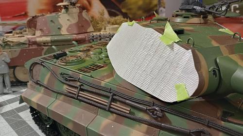

ID:	440613 Click image for larger version

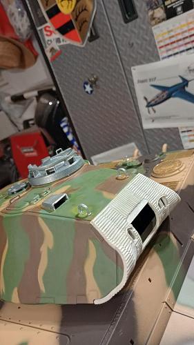

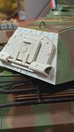

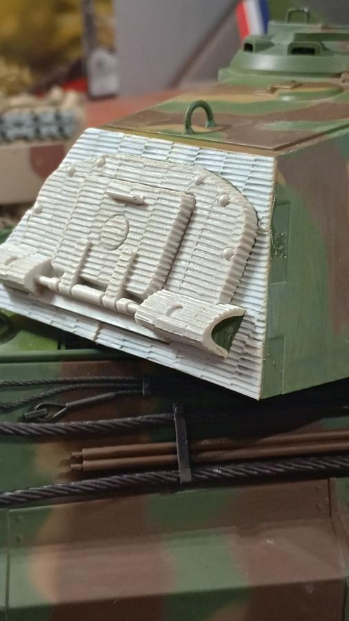

                                It's on! I must say whoever the person was that glued the original part on this turret did not lack in the glue application area! I had to cut it off with side cutters. Then clean it up with my Foredom rotary file. Crazy!
                                This stuff looks pretty good.

                                  #36

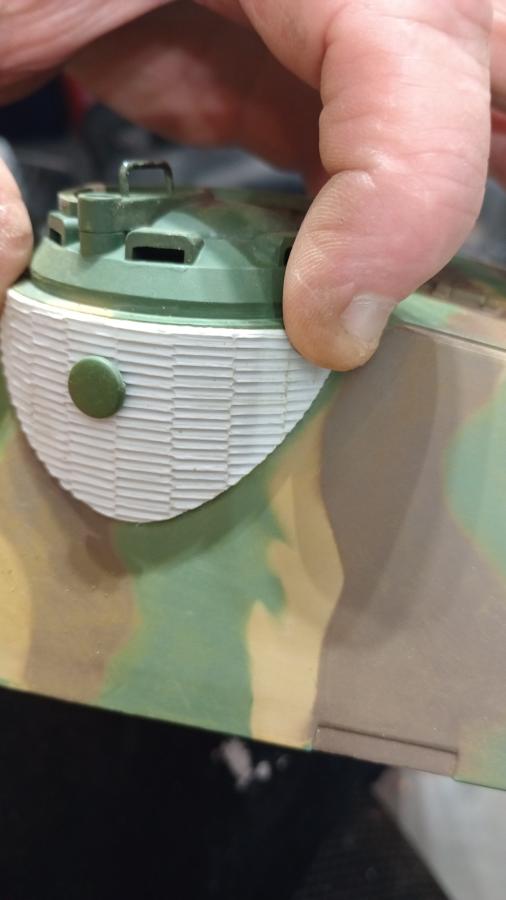

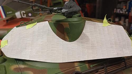

                                  I must say I am very happy in this product is very well engineered.

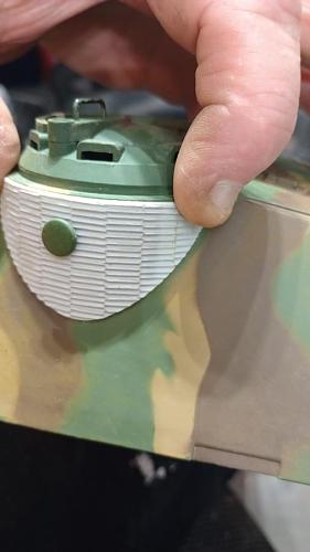

                                    WOW!! Super cool!

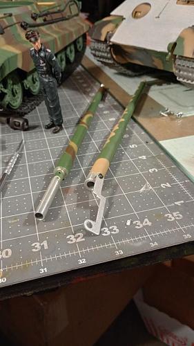

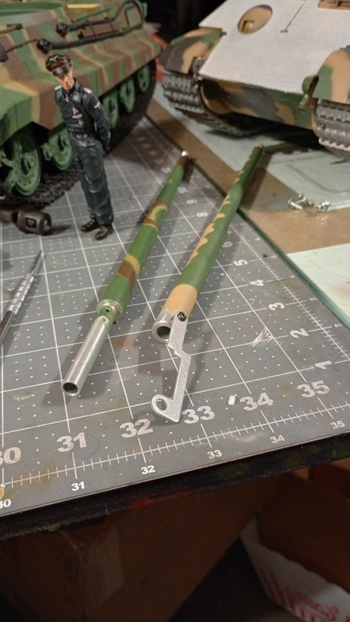

                                      Click image for larger version  Name:	IMG_20251205_165632413_HDR.jpg Views:	0 Size:	59.8 KB ID:	440827
                                      Click image for larger version  Name:	IMG_20251205_171233528_HDR.jpg Views:	0 Size:	57.0 KB ID:	440832

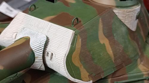

                                      So the donor pro version arrived today (complete with Abrams or Leopard 2 sound choices) along with several metal parts that came yesterday. There's some major differences between the barrels. The actual vehicle did not have the stepped barrel. It had the early barrel per the photographs (see next post)I've seen of the actual vehicle. So after looking at it for a while I've kind of concluded the only way to make it work (factory recoil mechanism) is to machine the later style barrel and get rid of the step. Since it's the recoil barrel it slides over a tube that protrudes from the gun mechanism. The older style barrel had the elongated in that pushed into the gun itself. This means I would just take it to a machine shop (I am sure a machinist would get a kick out of this job) and have it cut it down on the lathe. I don't have that capability. I can try and attempt it with a file and a drill press but that would be awful. I would never get it straight. Or I can install the later barrel and ruin the accuracy of the model.
