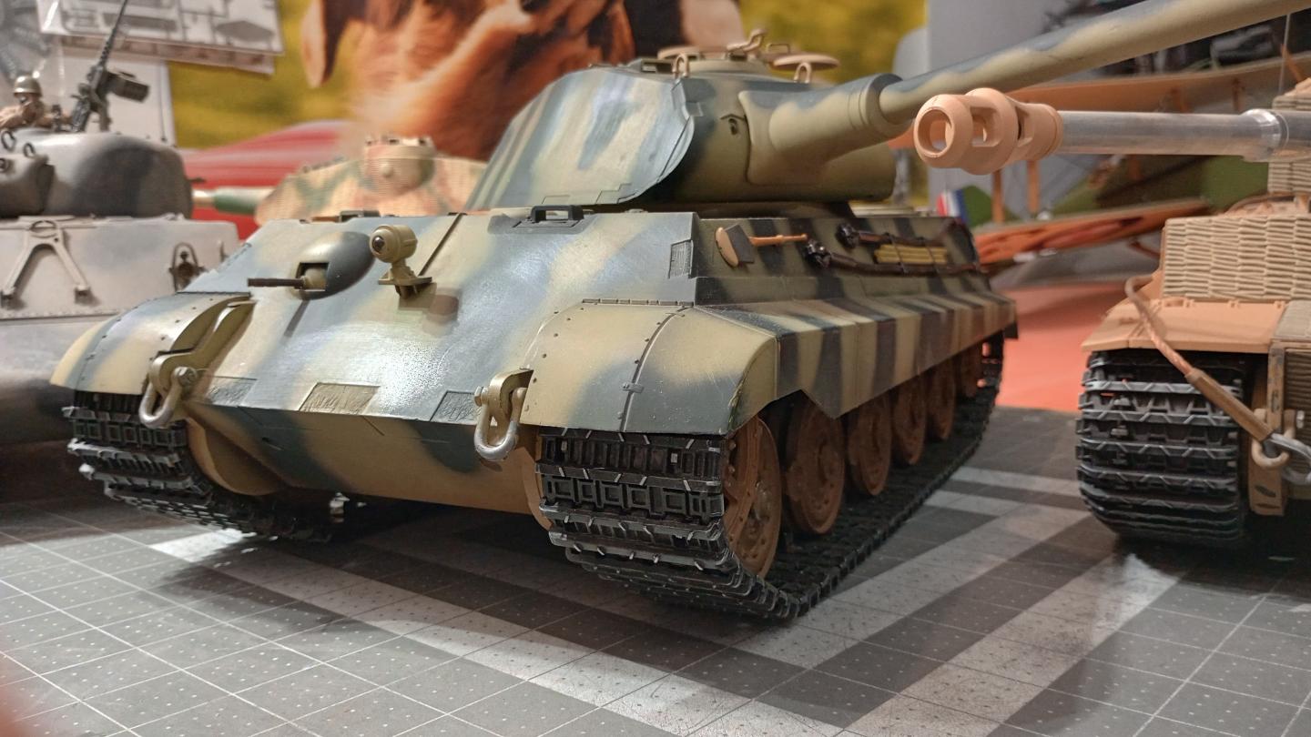

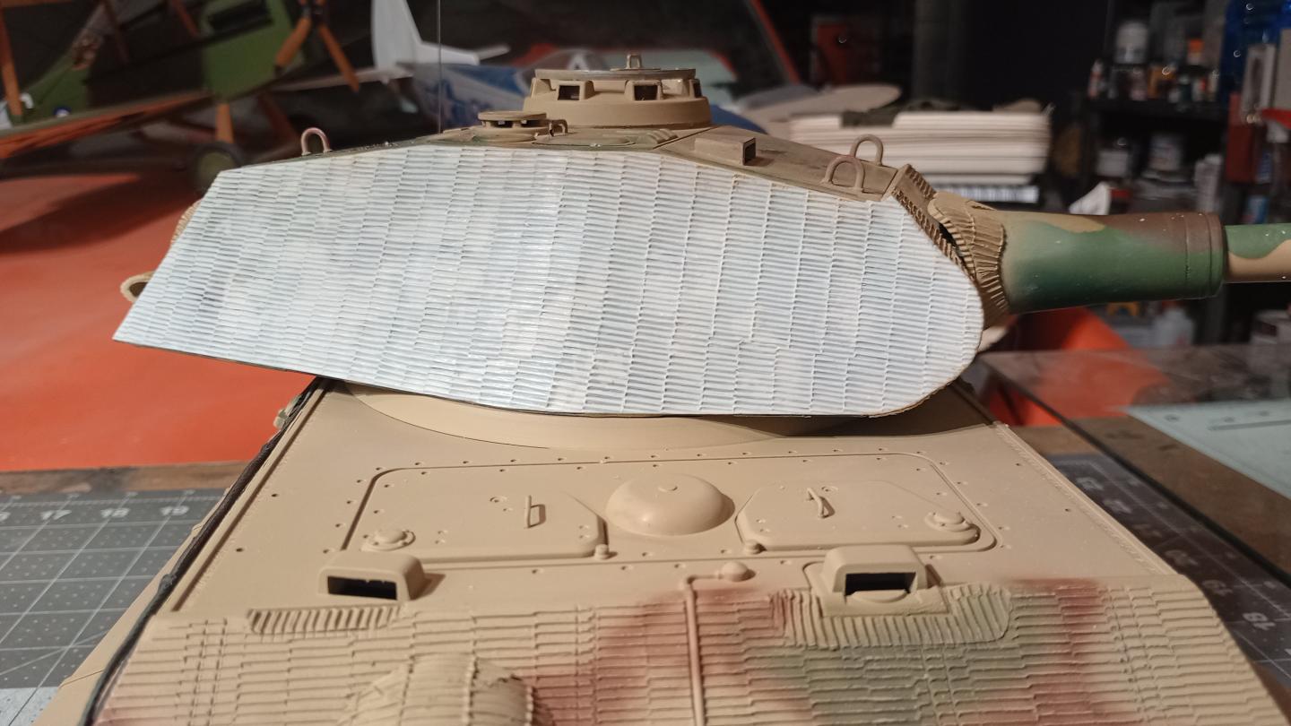

    Been a minute, been working on this a little bit at a time and tonight I attached the first section of turret zimmerit. It's looking pretty good and it fits really nice after it's trimmed correctly. I do the final fit with around 200° f water and it just melts in like butter. It will contour around a lot of curves. Just have to take your time and don't get crazy impatient.
    I chose not to go with that number 12 vehicle from the Normandy campaign. If you look closely at the photos it doesn't have the base ring at the turret to contour in the early production turret with the hull, and eliminate the trap shot from the sides or front. It's just weird looking.
    Instead I'm going to model vehicle 114, which also fought in Normandy. It has the normal large main gun and just standard camouflage. I don't prefer to model any kind of strange or one-off vehicles which #12 what that tank was. I'm a really big fan of this Atak Zimmerit.

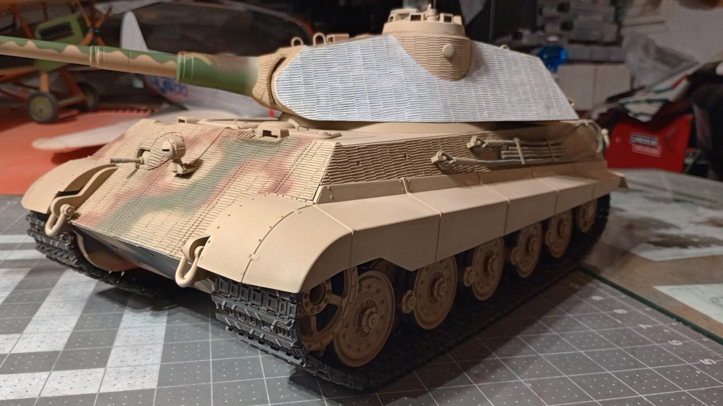

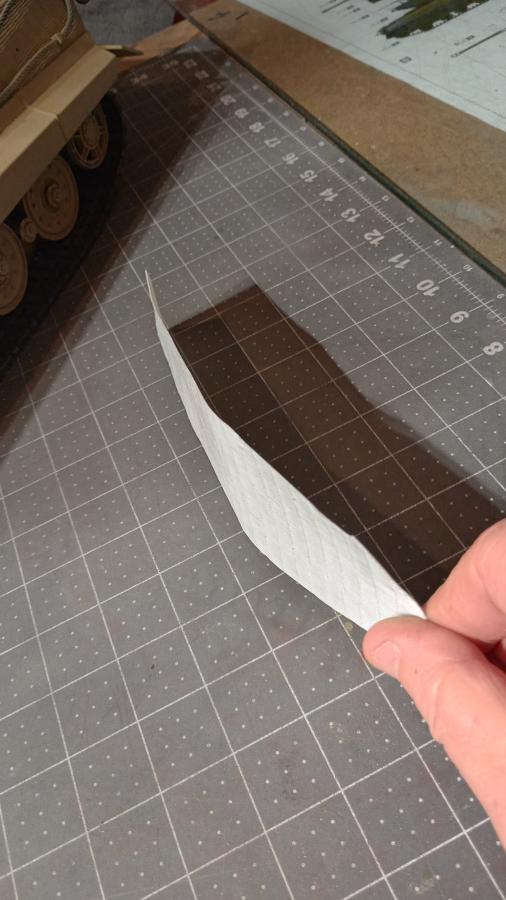

        I don't know what motivated me, I went ahead and put the other side on tonight, you can clearly see here the preformed shape after heating with hot water, I soak the paper towel in the 200° water and lay it down on the Zimmerit while it's in position. It takes the shape of the item you're trying to make it conform to pretty quick. Make sure everything's dry, mix up your epoxy, you don't need much because you're putting it on thin. I don't mix it hot but I probably use more than I need initially and then scrape off what might be extra. I keep an isopropyl alcohol soaked towel nearby to clean off any extra epoxy that oozes out as I'm working out the air bubbles between the Zimmerit and the hull or in this case the turret. I keep a little space heater running on the workbench to warm it up so the epoxy sets quicker, you can use 15 if it's in a weird area and it might take a little extra to get it to conform but these were easy. 5 minutes was enough.
        Once the epoxy has set, just trim off the extra. There will be extra. The parts are designed to be a little larger than the area you're covering. I used number 25 blade medical scalpel which is one of my favorite tools. Dragging across the top and it just comes right off. Trim it down to the existing edge of the turret.

          very nice work. Nice tip about the preheat.

            Thanks, the instruction included with the sets are very good, clear and concise. I didn't come up with it by any means. Its in the instruction. I was skeptical at first, but upon trying the technique, the resin parts give up immediately with the hot water. Only thing I would add is when you sand the parts out of the sheet, go slow and use just a bit of Dawn. Do the sanding wet. Add the Dawn to keep the paper from catching, and use one direction stroke, away from you. Otherwise it will bind and fold when it catches. It happened to me once, but not bad enough that the part was ruined.
            Atak has resumed shipping to the USA. I bought mine off eBay, from Australia. Crazy.

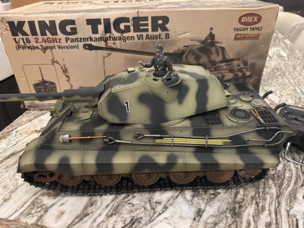

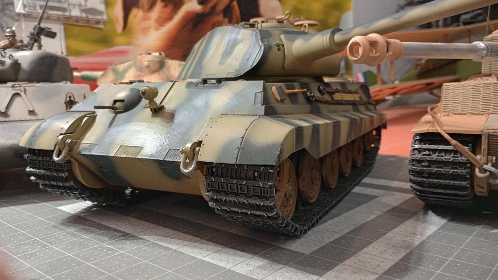

                              So the Taigen King Tiger showed up, my recent eBay accusition. It's in decent shape, and happy with it. Already ordered another ATAK zimmerit kit, but the chassis definitely has issues as it's all plastic with all metal suspension, road wheels, and tracks. I have my eyes on an all metal set up. Click image for larger version

                                The new King Tiger looks awesome. Is that a Sopwith Camel I see in the background?

                                      Ahhhhh my Unicorn! One-day she will be Mine... Been looking for awhile myself. Congrats on your acquisition.
