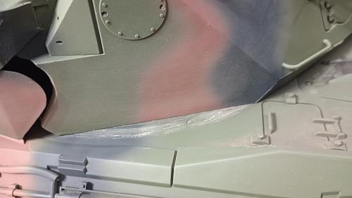

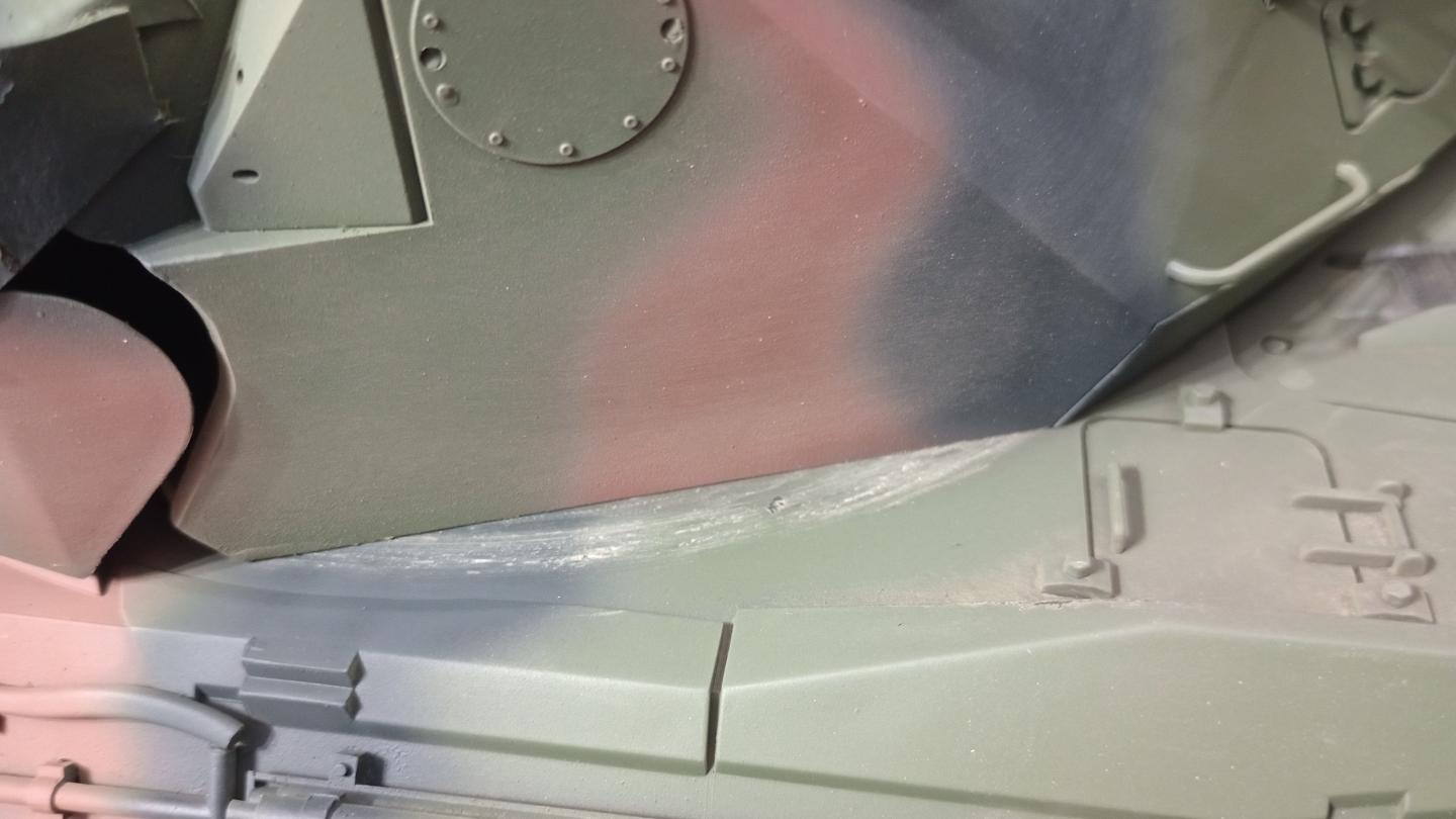

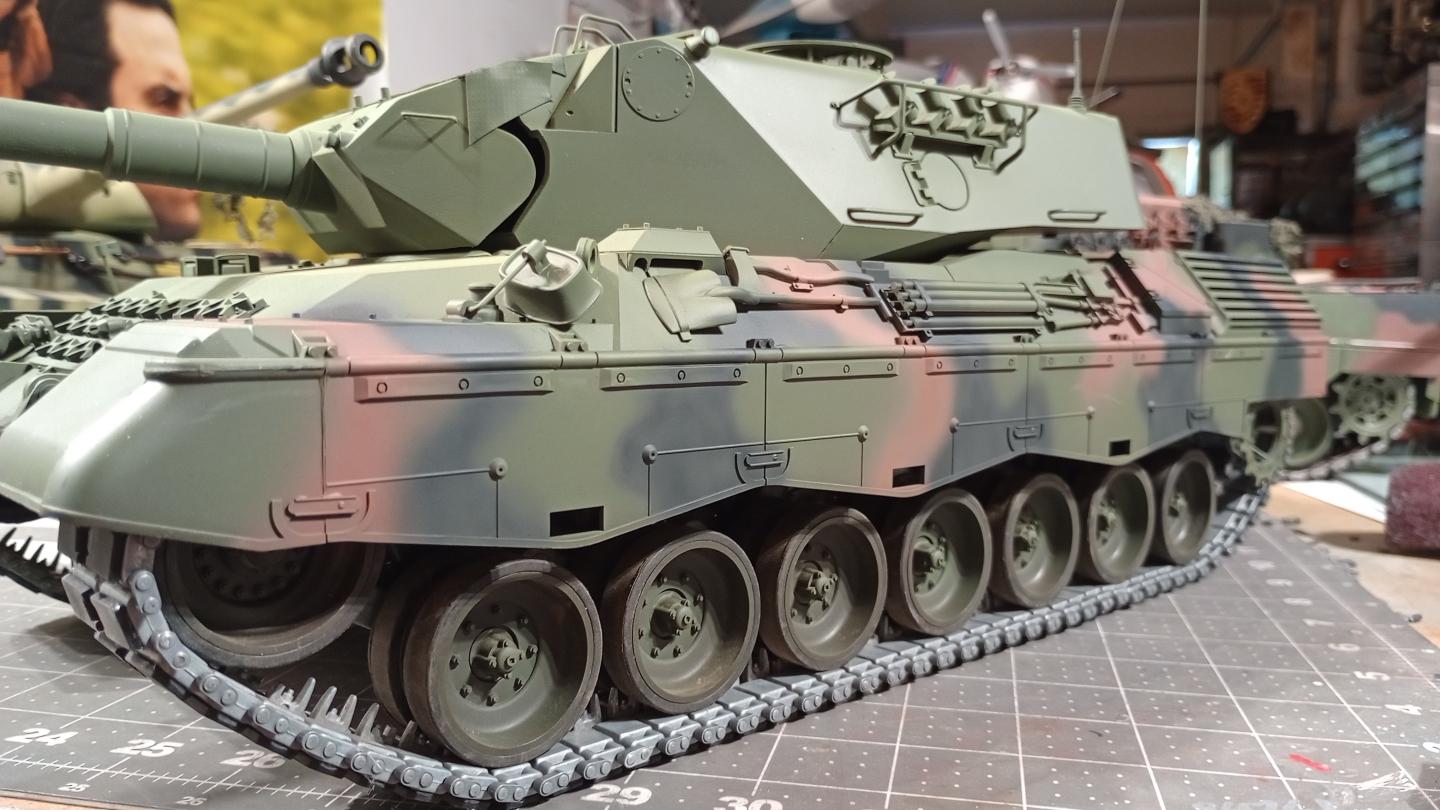

                    • #31
                      So what are people doing to stop this issue? New paint and if you move the turret at all it destroys the paint. I have a couple of ideas in mind but it really needs some kind of bearings. Click image for larger version
                      • #32
                        Personally I would design and print a small ring for the turret to ride on that could be glued to the deck. You could cut one out of styrene if you don't have a printer. You would have to make sure there was enough vertical gear engagement with the turret ring gear and the rotation gear. Only has to be less than a millimeter in height.

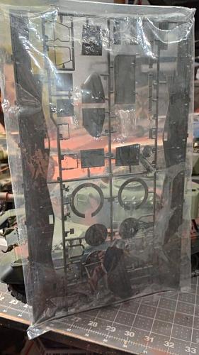

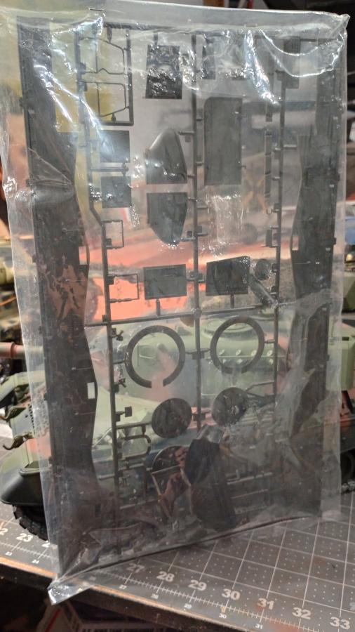

                        • #33
                          I found this on eBay and probably paid too much for it, but it's got a lot of the parts I need for this. This is the D parts. New in the bag. It has the rubber mantlet cover, the searchlight the wire guards for the roof of the turret equipment, the hatches and some other stuff. Still looking for some rubber road wheels as few, well they're cracked. Shocking I know. They're only 30 years old!
                          Click image for larger version  Name:	IMG_20260330_190203027_HDR.jpg Views:	0 Size:	68.9 KB ID:	446593

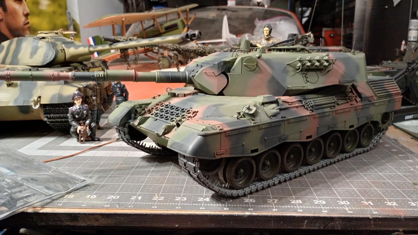

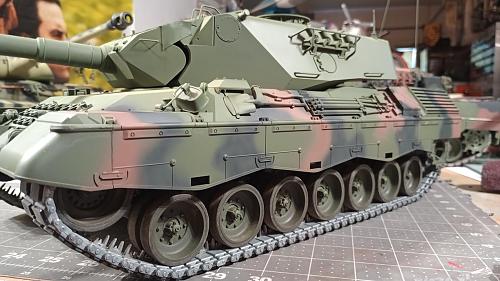

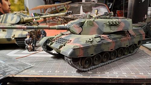

                          • #34

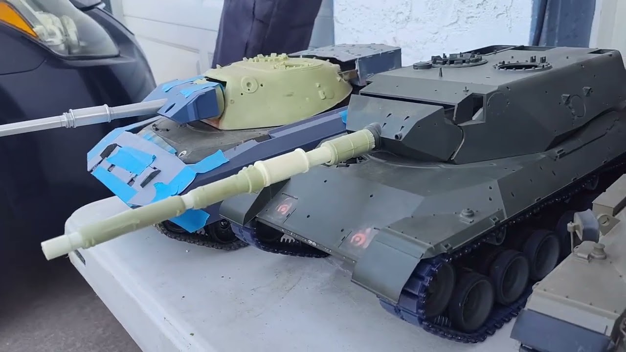

                            The camo came out all right. It's the first time I ever did a woodland NATO three color without a guide. I looked at a lot of pictures of real Leopard 1 A4 types in this scheme. I had to make most of the grab handles out of metal as they were broken off or missing. This model is a $300 eBay special that was mostly intact. I grabbed it because it was a smoking deal!

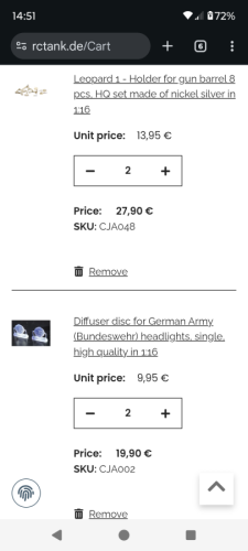

                              That paint job looks really nice. He did a great job. RC tank.DE has replacement rubber road wheels as well as a lot of upgrade detail parts although they are silver castings and they could be expensive but they do have a lot of parts. As I’ve said before I turned all my road wheels down and put flange bearings into them cut off the metal arms Axles and drilled them to 4 mm screw holes and used 4 mm screws for the axles hauled out the hubcaps and glued them back on the wheel over the screw.

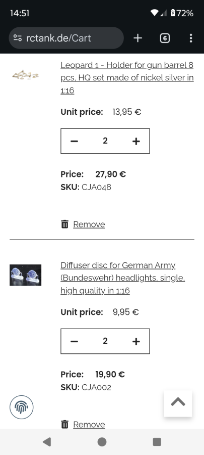

                              • #36
                                I'm filling up my basket quick but I'm unable to find these rubber road wheels? Are they the same as the Leopard 2? They have some super cool stuff!
                                VR
                                • #37
                                  The tyres are different on the Leopard 2.
                                  Depends on how original you want it. Will and Cathrine at https://wcpmodels.com/ printed up a set of tyres and wheels to replace the damaged ones. He should still have the files. Might be worth dropping him an email?
                                  • #38
                                    You may have to email rctankde and ask. I think I had to because he didn’t have them listed at the moment I wanted to buy them. They come a bunch together moulded to a flat sheet of rubber.
                                    • #39
                                      Message sent, but they literally have most of the items I need in stock to complete this eBay special. I just got back from the hobby shop with an electronic speed control and a new servo. See if I can make it run.
