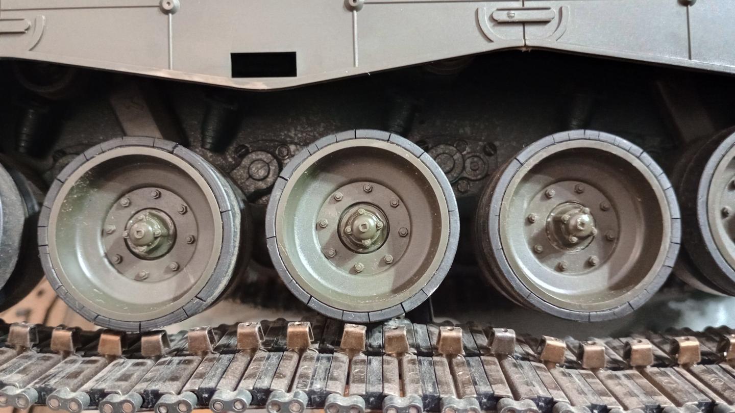

              I'm just going to consider this the Tamiya Leopard 1A4 resource/rescue thread. If you have something to post that's useful to anybody trying to repair one of these, this could be the place.
              I just asked for a full set because the other Leopard that I acquired recently, yep, another one followed me home has most of the wheels cracked. Or falling apart. And the models new, has never been run, was assembled and just sat in the garage in the California summer heat.
              Tamiya Leopard 1 / Gepard - roller rubber in 1:16 Roller rubber made of tire rubber, suitable for rollers from the Tamiya Leopard 1 and Gepard The rubbers m
              Click image for larger version  Name:	IMG_20260402_115545765_HDR.jpg Views:	0 Size:	154.6 KB ID:	446727
