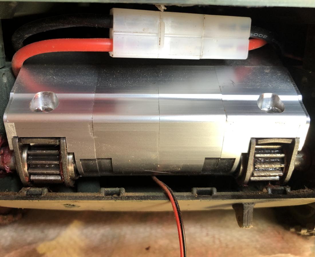

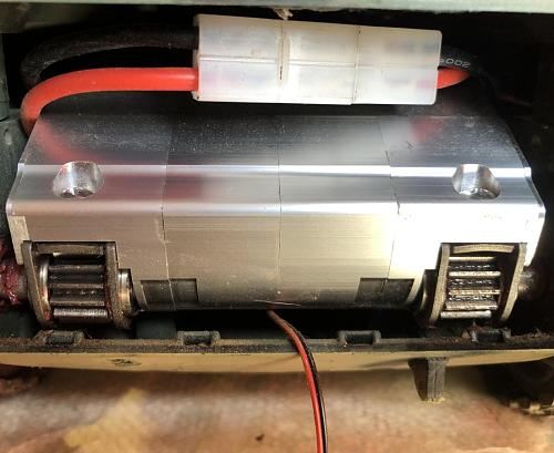

    Click image for larger version  Name:	IMG_8027.jpg Views:	0 Size:	104.1 KB ID:	447905 Above the new DKLMRC full metal transmission installed in M60. Super clean fit and slim profile.

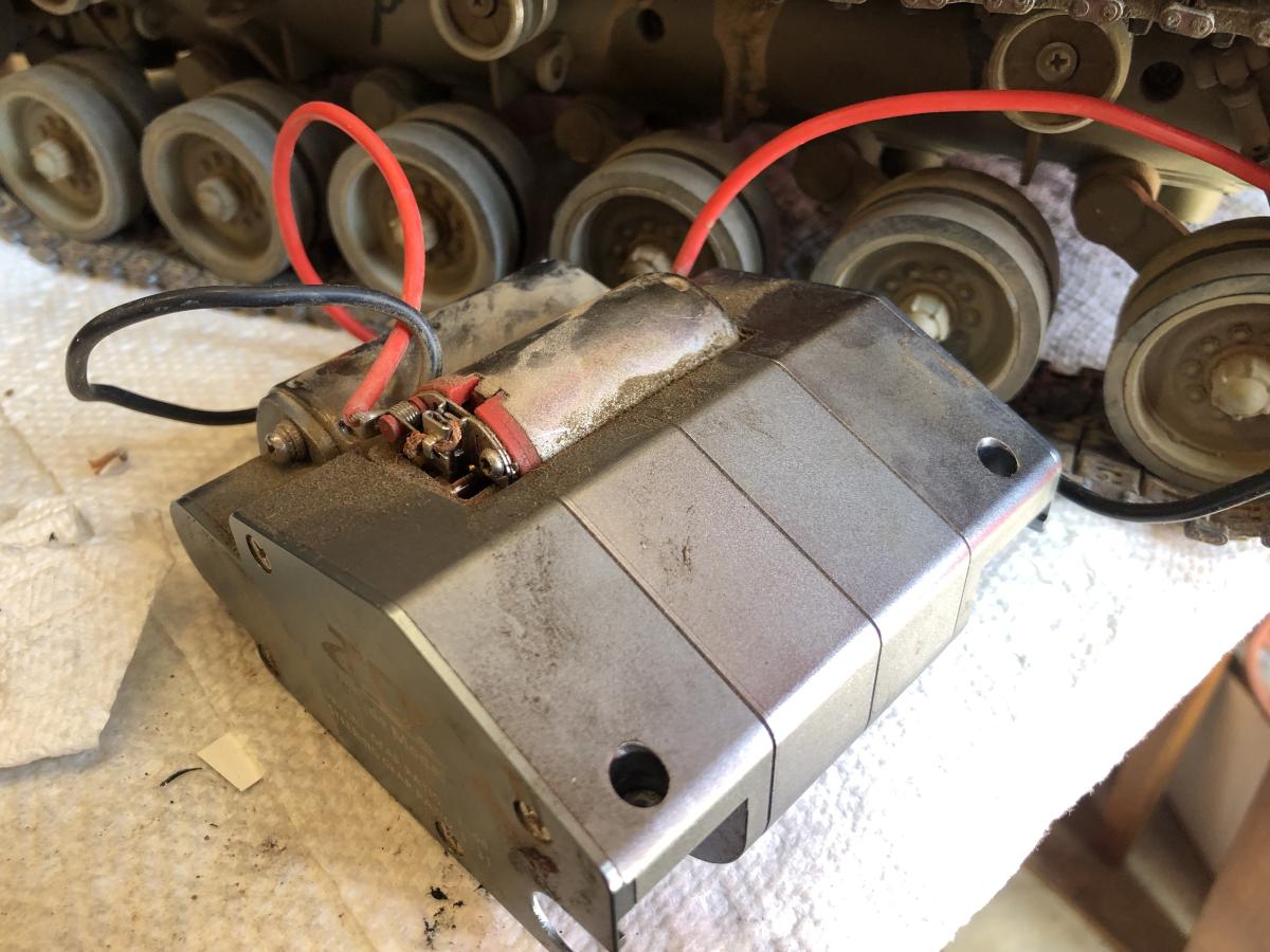

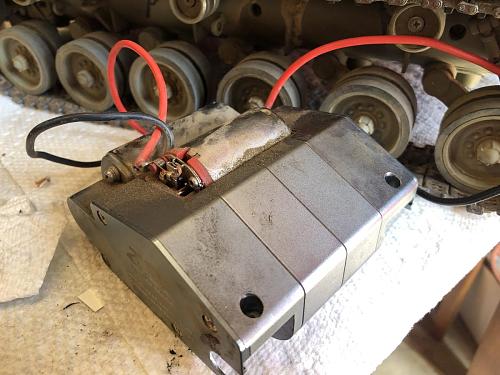

    Click image for larger version  Name:	IMG_8028.jpg Views:	0 Size:	132.0 KB ID:	447906 Old TongDe transmission now needs a new home.

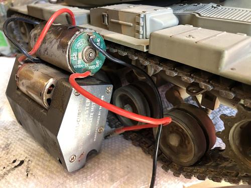

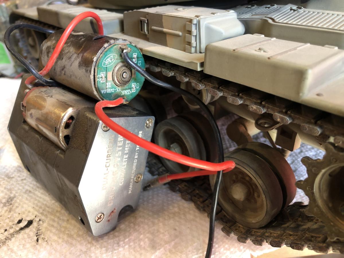

    Click image for larger version  Name:	IMG_8029.jpg Views:	0 Size:	131.0 KB ID:	447904
