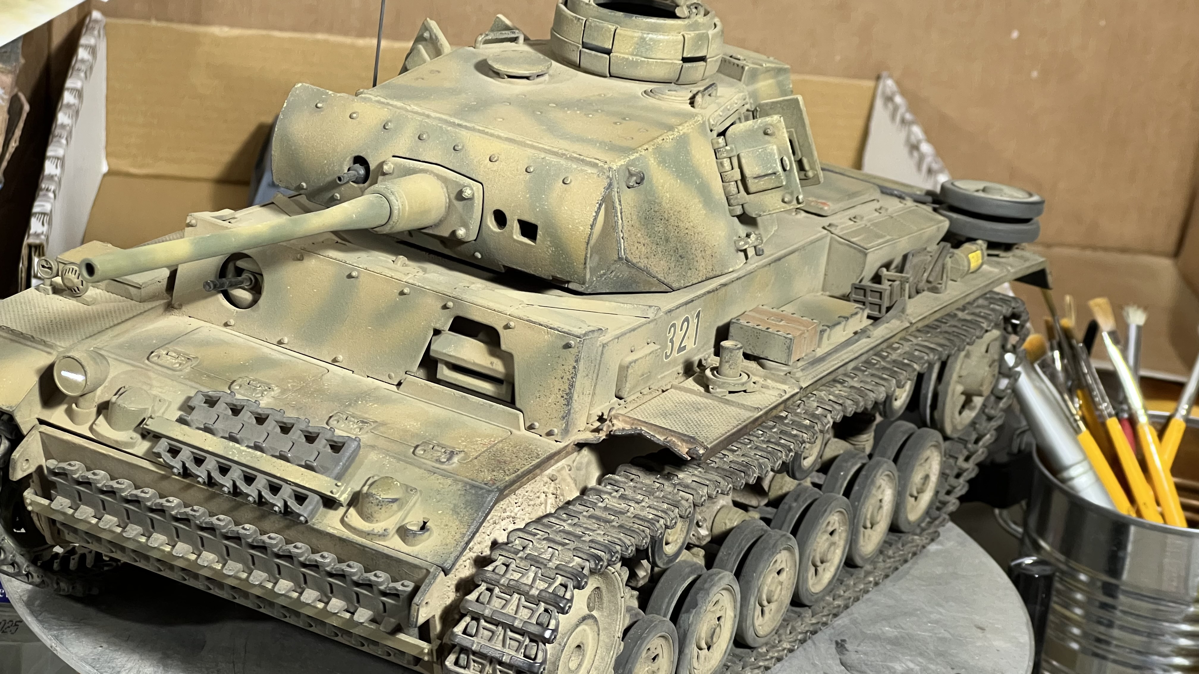

            They come apart after removing the 5 screws. The 6th screw in the middle at the rear holds the smoke unit in. It is possible that the age and the paint has kinda stuck it together. Have you tried prying it gently?
            Here is my PzIII L at Kursk-

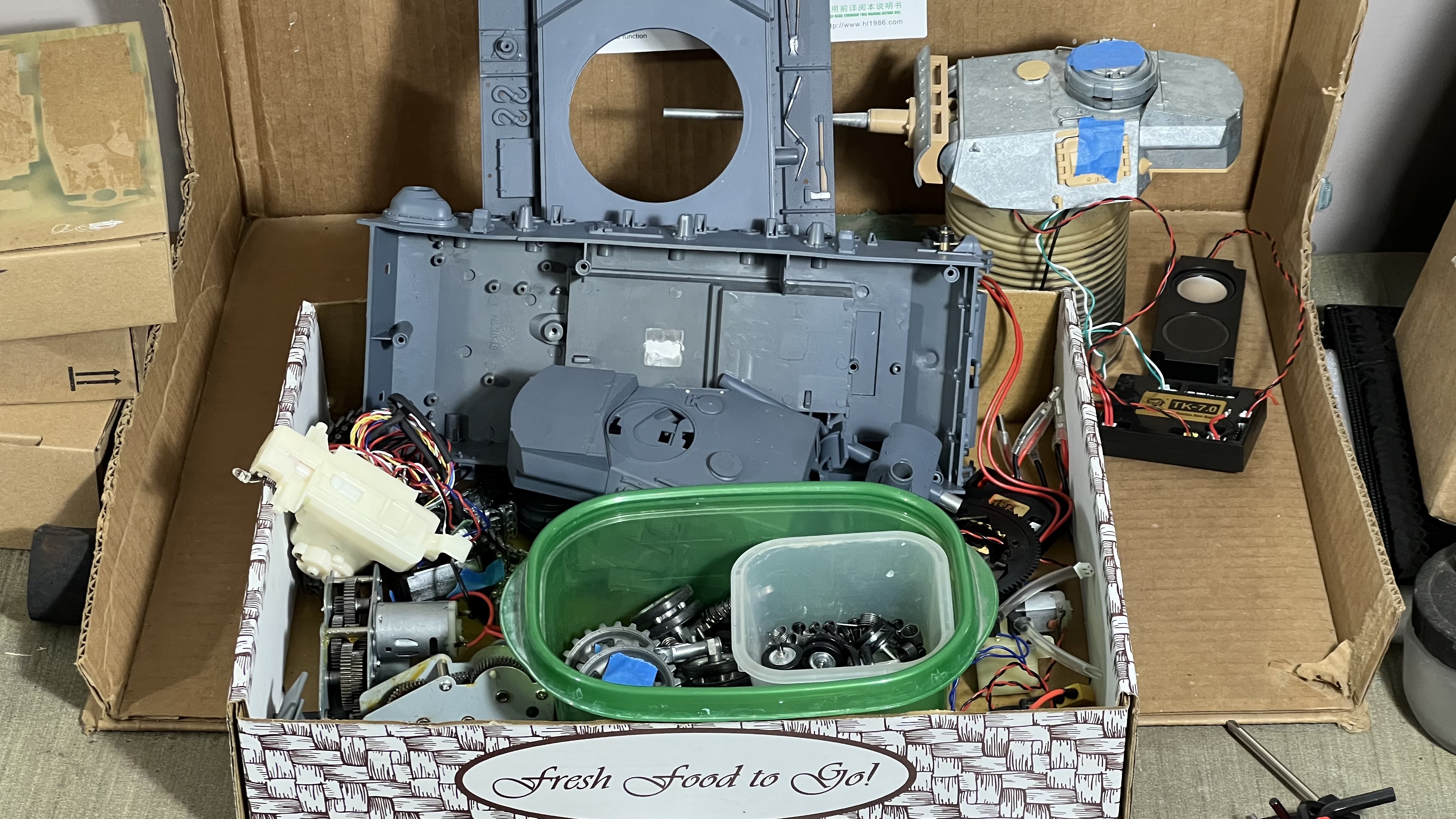

              • New York, Not the city
              lots of pieces
