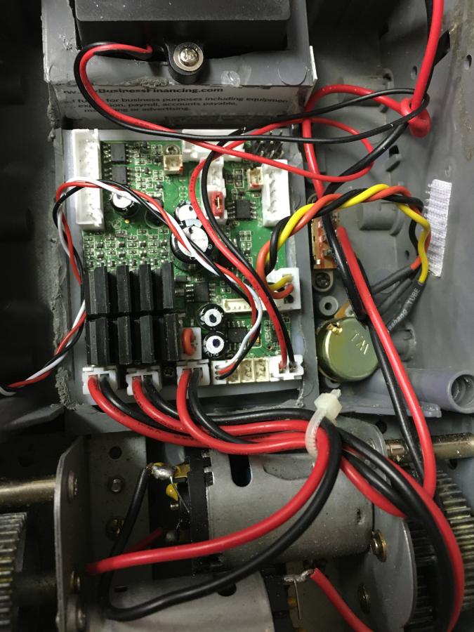

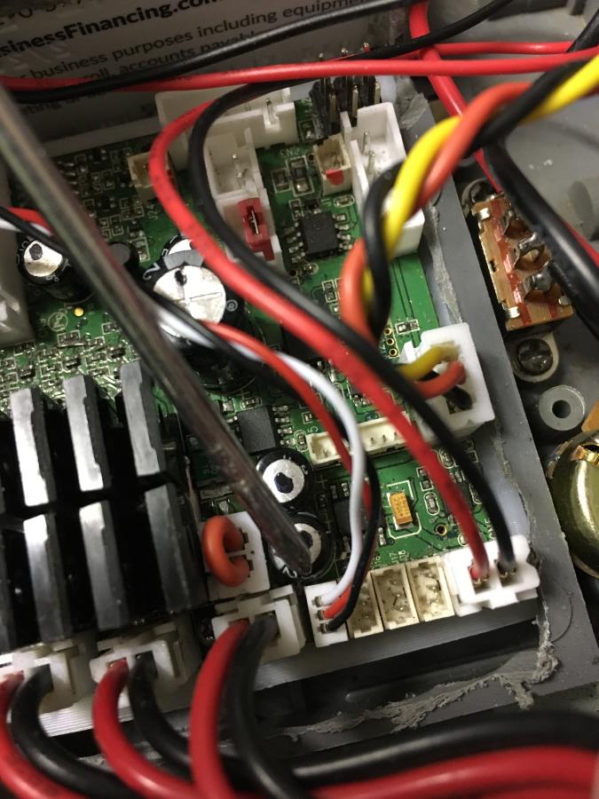

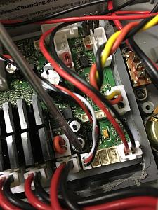

                          Ok how about a picture of the receiver? What port is the cable coming from the board going into on your receiver?
                          Gathering 1-2x monthly/All Ages & Experience levels welcome
                          • #33
ID:	450594 here is a picture of my board. Does yours have an on and off jumper? That is the red wire in the photo that curves into the same socket
                            • #34
                              No mine has the physical switch in that socket

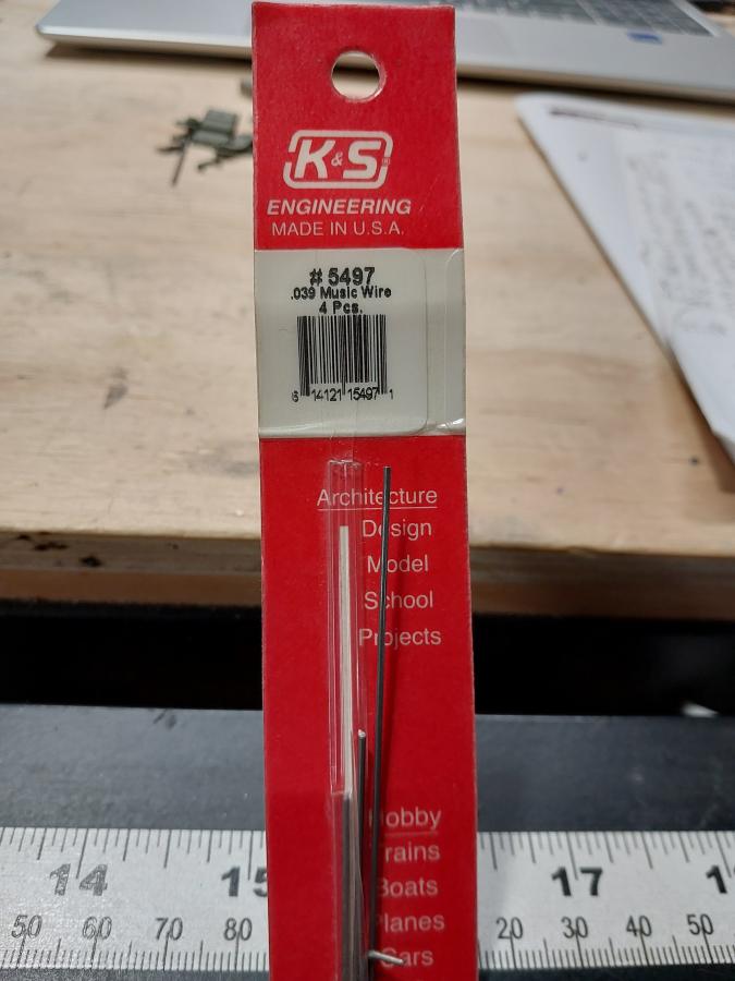

                                Tang, thank you very much for your information packed well thought out reply to my question. I think I'll sell my new (many years ago) and never used TK22 M4 Sherman board and get a new HL 7.1 board, and swap out the turret servo for the motor you mentioned. I also want to change the original drive motors & gear boxes for something better, for the 1/6 M5 is under powered. I'm also planning to modify the tracks by drilling many small hole to insert pieces of what's referred to as music wire to give the tracks the traction they're lacking.
