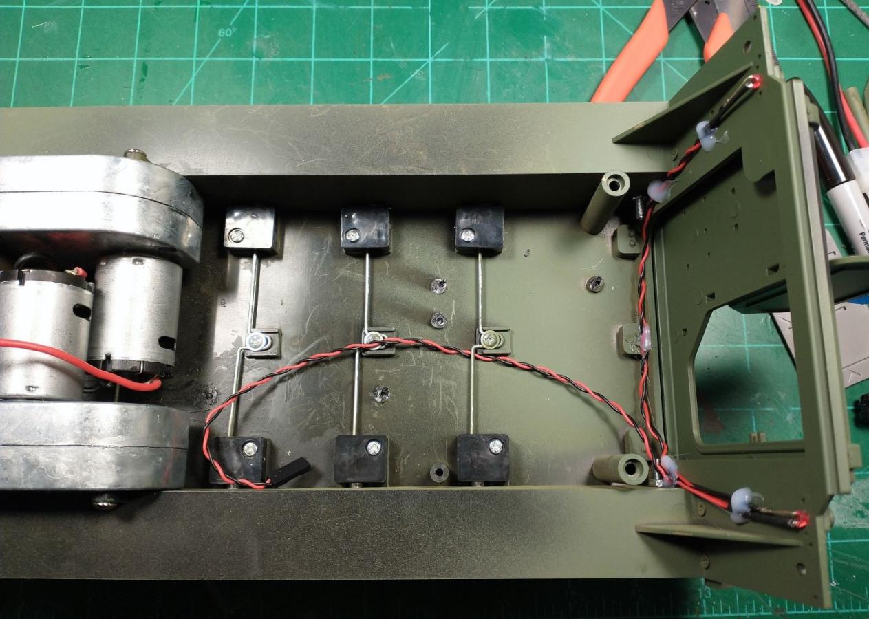

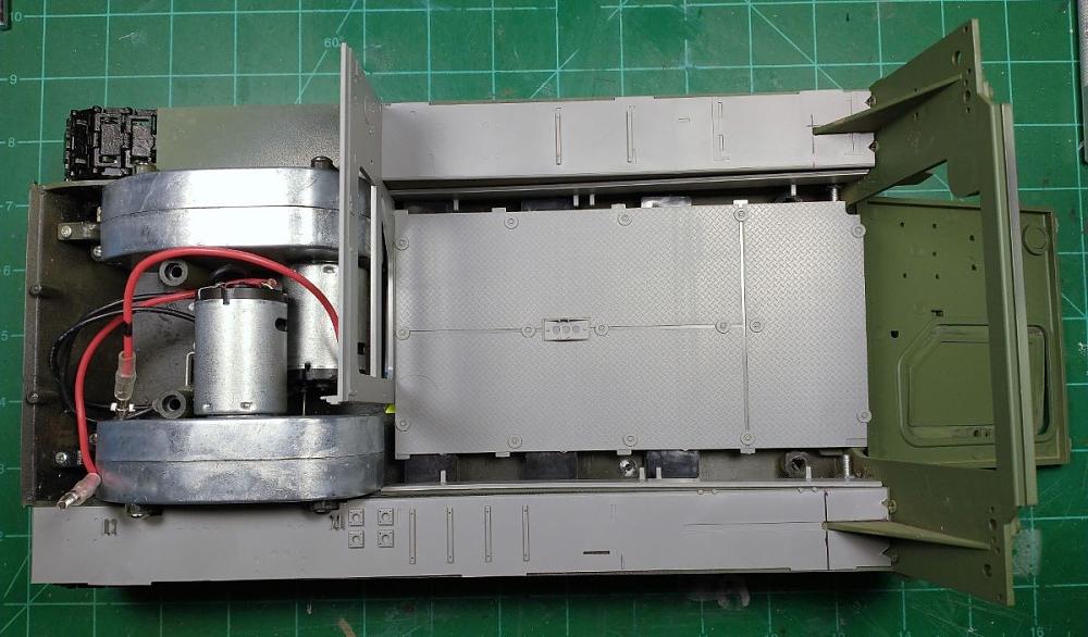

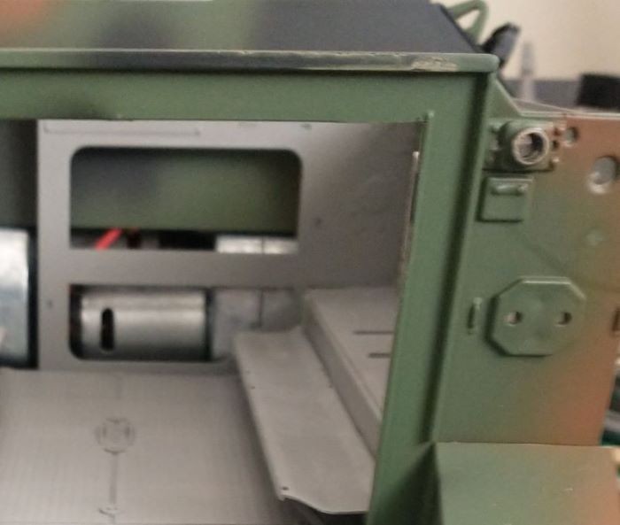

    First thing I did was strip down the hull and remove all the speaker, main board, smoker, and related wiring. Also removed the turret mechanism and cut down all the mounting points.

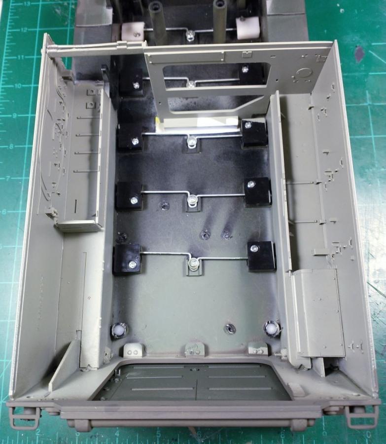

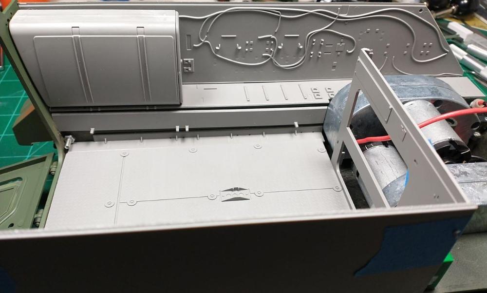

      Next, I test fitted the various parts from the AHHQ kit. This included hull sponson top and side covers where the rear seating and other parts are attached. Also test fit the firewall between the engine and crew compartment and the hull floor access plates to see what needed to be trimmed or cut down to fit.
      Click image for larger version  Name:	2.jpg Views:	0 Size:	180.2 KB ID:	450653

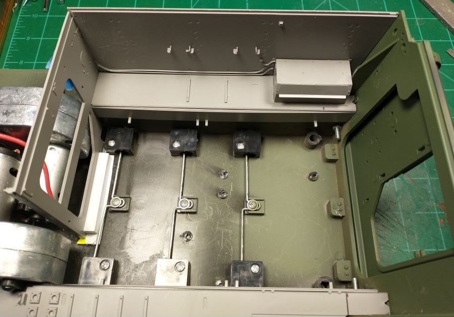

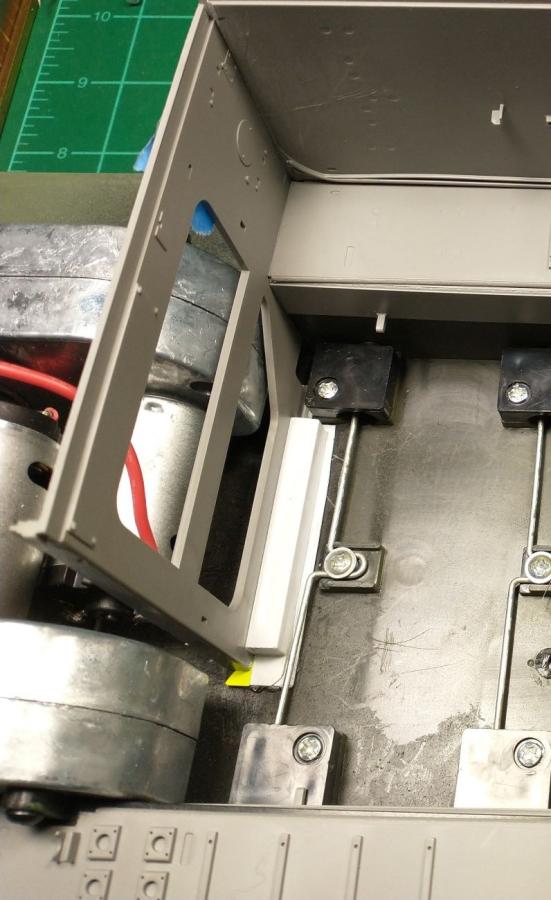

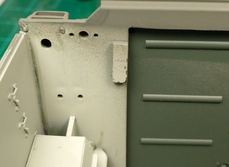

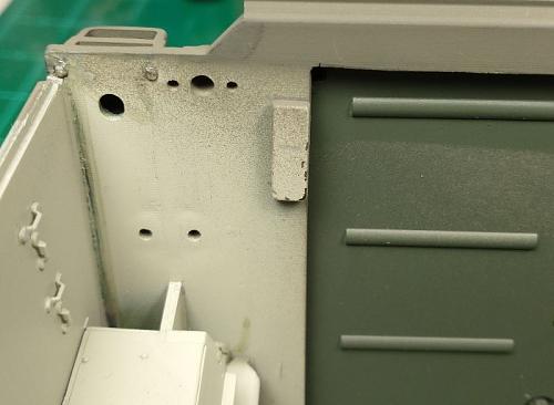

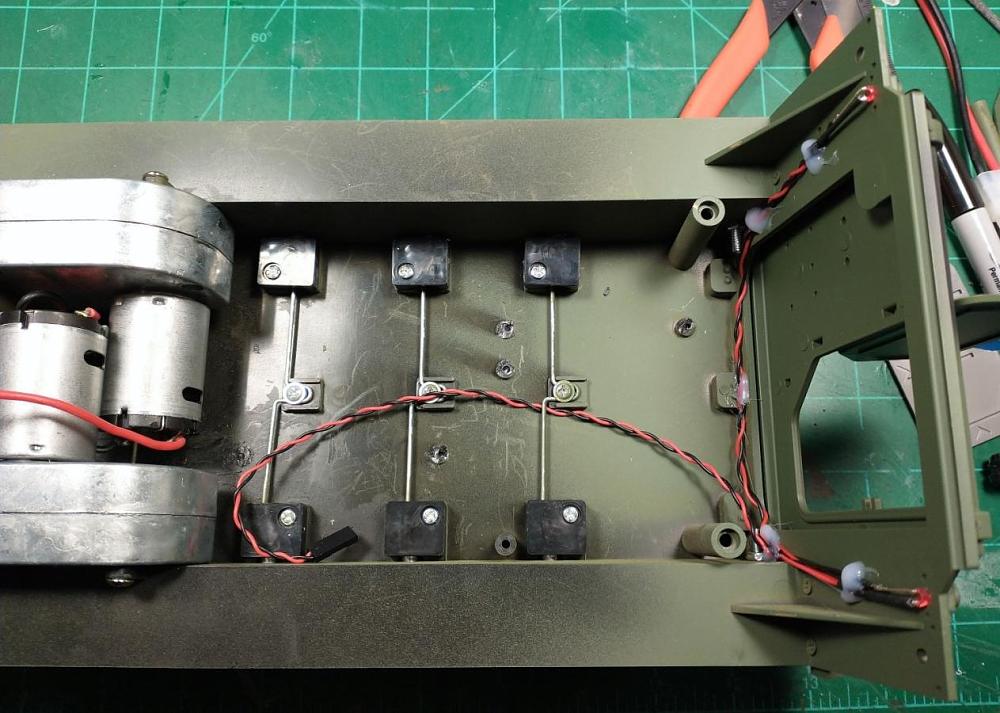

        I cut down the kit side wall to fit between the firewall and the rear panel on the right side. This also shows the seating attachment panel on the side of the hull. And a test fit of the battery box to see how much of the rear support bracket needs to be trimmed.

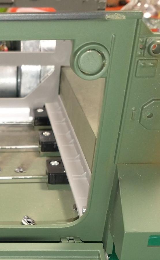

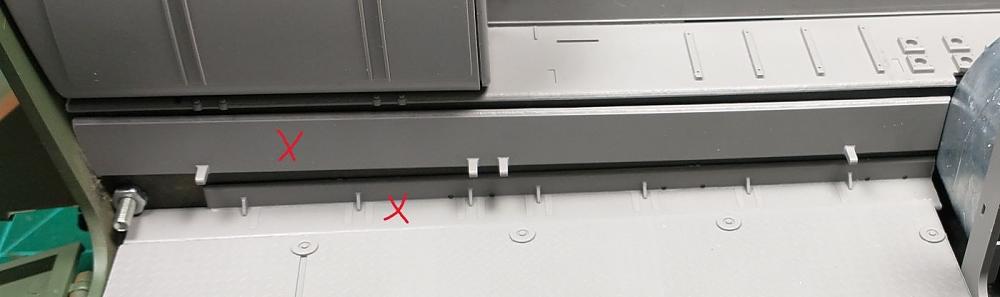

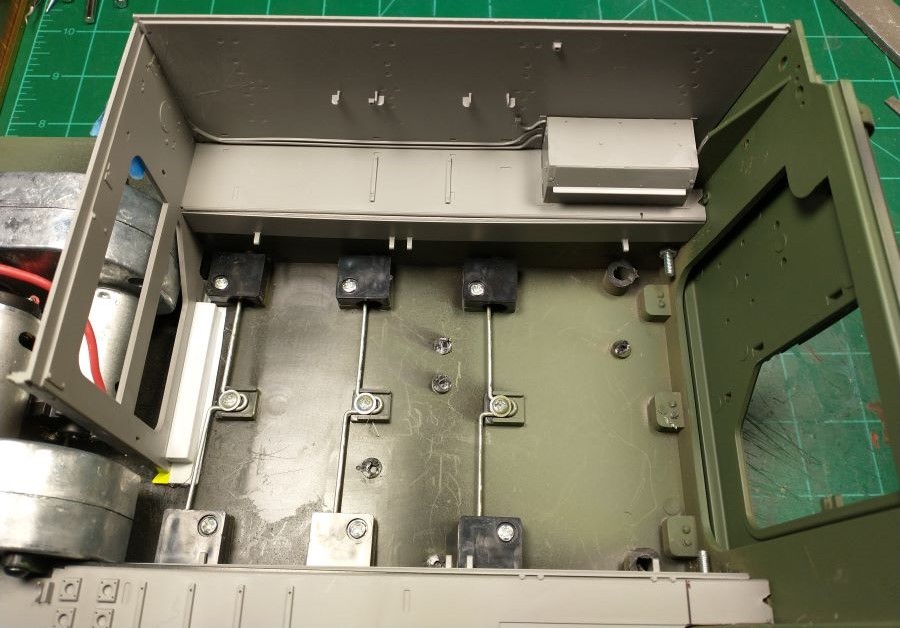

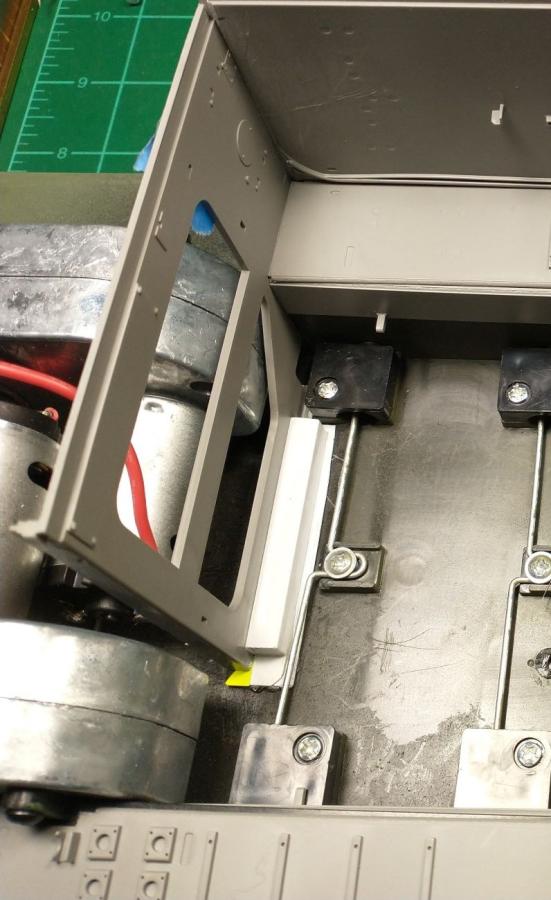

          I cut down and fitted the side panel on the drivers side. Test fitted the seating panel on the lower hull and the fuel tank. The fuel tank was notched to retain the original rear panel support bracket. This shows the side panel extended all the way to the front, but I found it did not fit with the actual hull dimensions. I cut it back to the firewall area in anticipation of mounting the battery there instead. First plan is to put the speaker in the fuel tank. More on that later.

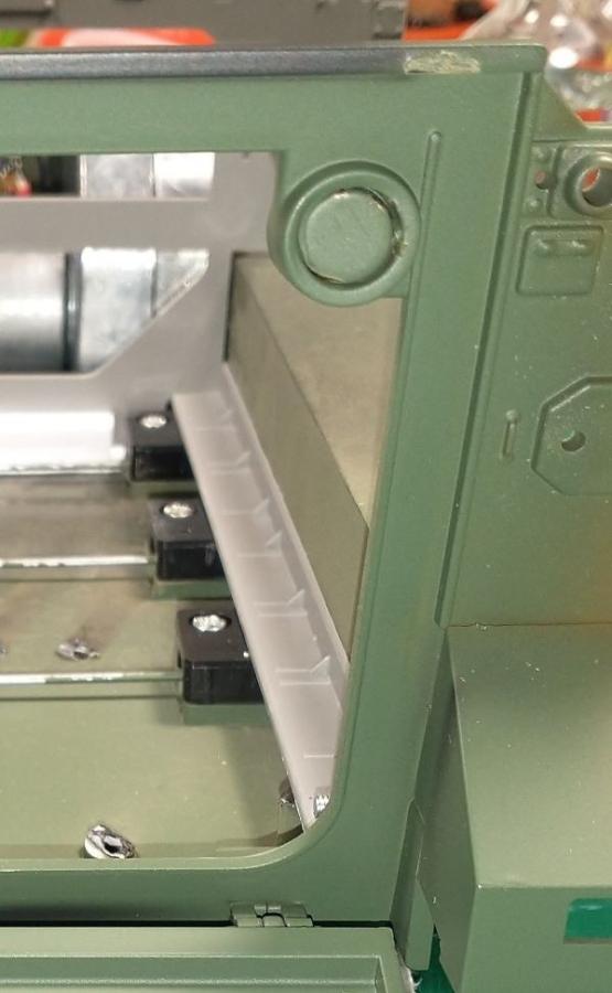

              The AHHQ kit sides were fixed flush with the outer edge and the rear body of the Tongde hull. Then the sponson covers were fixed to the hull and aligned with notches along the bottom edge. The Tongde upper hull will fit over it. A hull within a hull.

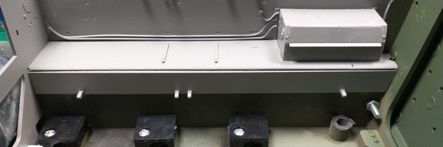

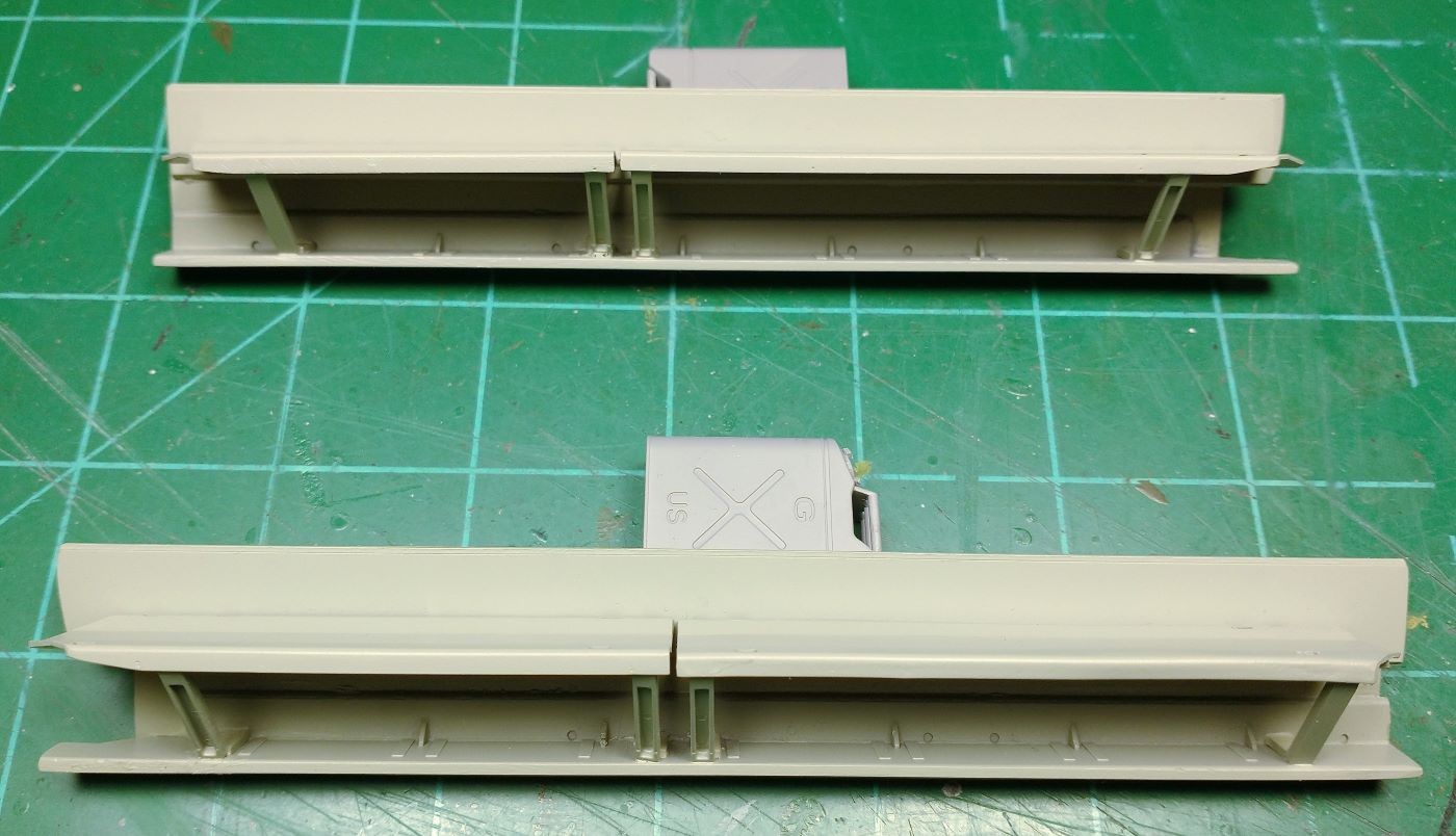

                The troop seats and the floor were next. Both had to be removable to allow access to the suspension parts. The kit has 2 pieces on each side to mount the seats with. There is an upper piece that is fixed to the top and a bottom L shaped piece that the seat brackets sit on.
                This is the top piece, right side. The 4 small posts are what the seats will fasten to.
                The bottom L shaped piece.
                Test fit with the floor set in place.

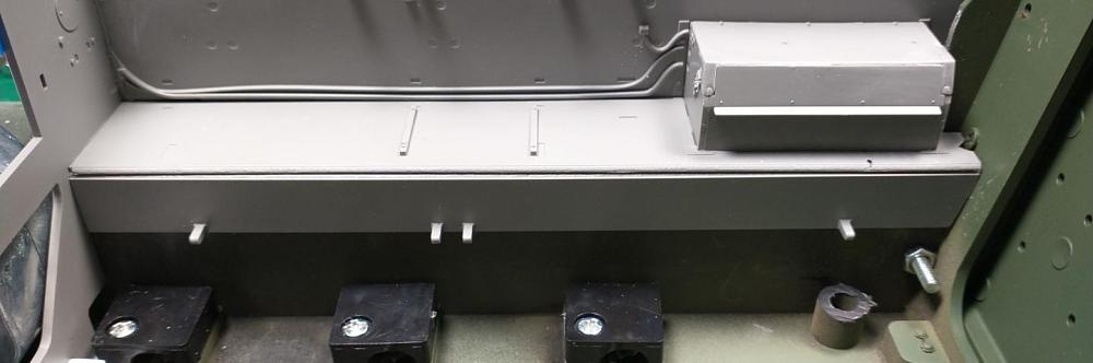

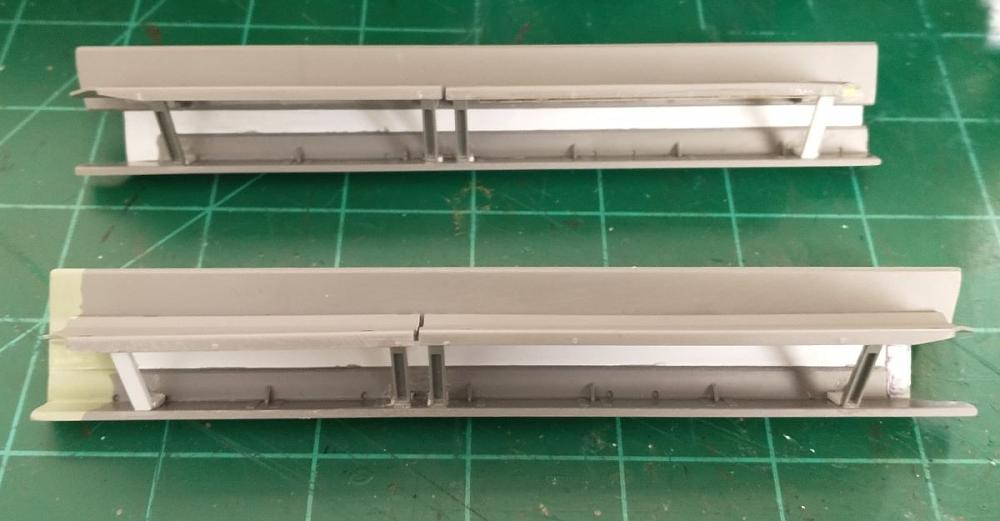

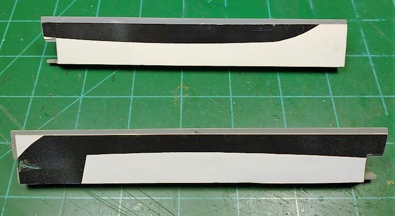

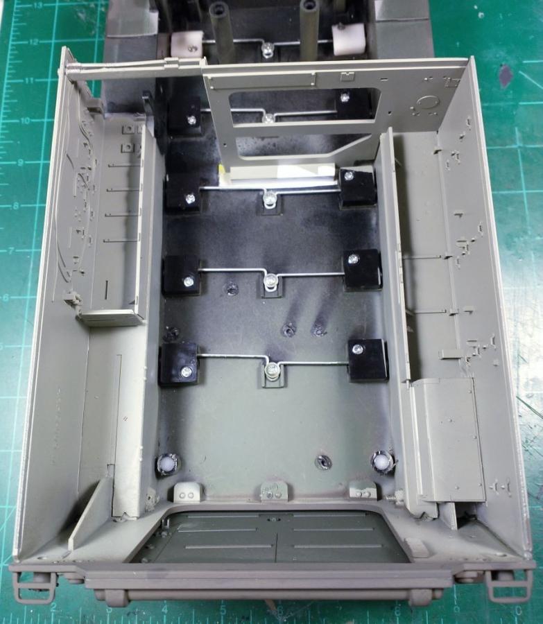

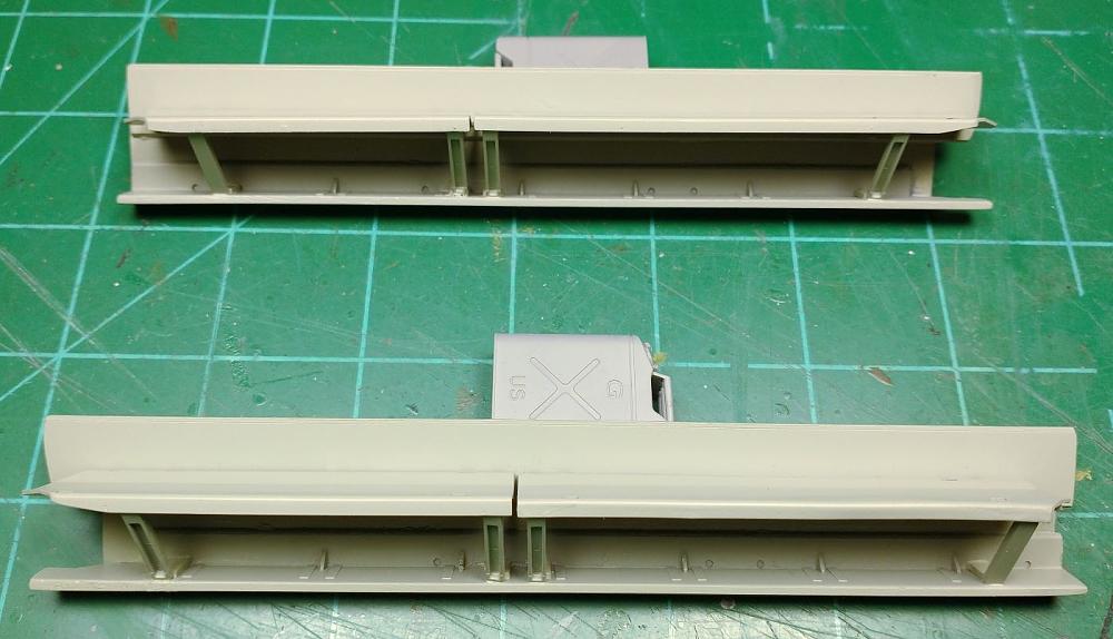

                  I cut a piece of very thin plastic sheet and made it the same size as the lower hull side and temporarily set it in place. Then I lined up the 2 pieces and glued them in. Next came the seats glued to those 4 small posts and then all the legs for the seats were added. It turned out to be a strong assembly that should hold up to handling.
                  Seat assemblies mounted on the plastic sheet.
                  Click image for larger version  Name:	seat1.jpg Views:	0 Size:	105.1 KB ID:	450694

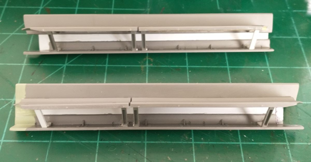

                  Here's the back side showing the plastic sheet holding it all together. One end is notched to clear the idler mounting bolt.
                  Click image for larger version  Name:	seat2.jpg Views:	0 Size:	68.6 KB ID:	450695
                  After a quick test paint.
                  Click image for larger version  Name:	seat3.jpg Views:	0 Size:	189.9 KB ID:	450696

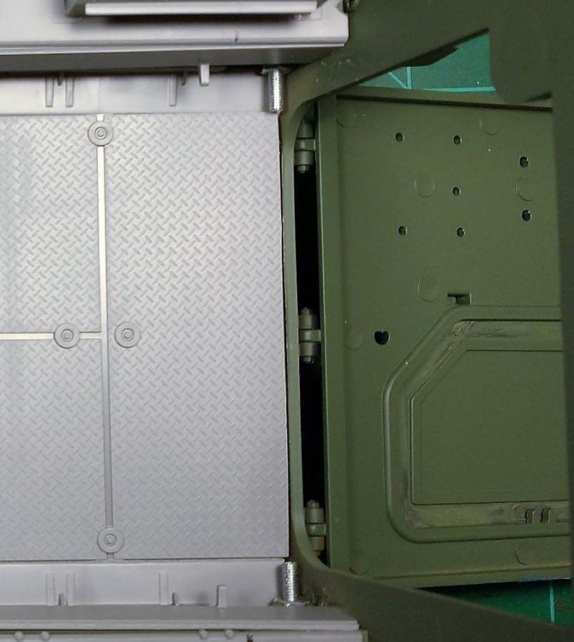

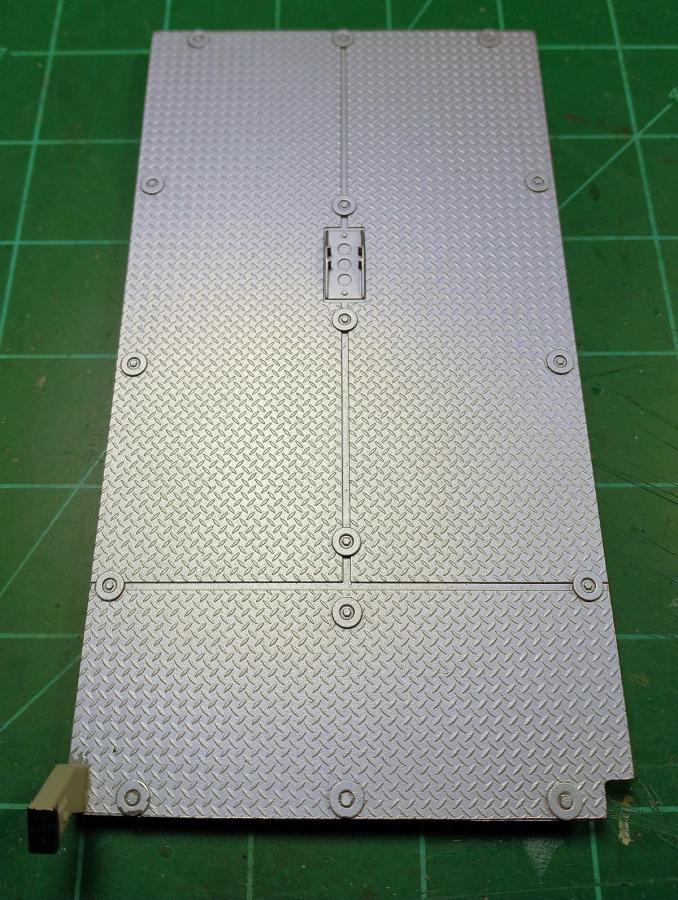

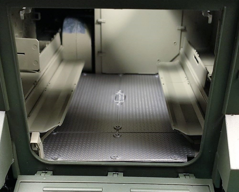

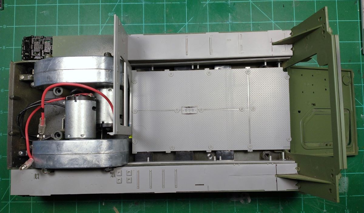

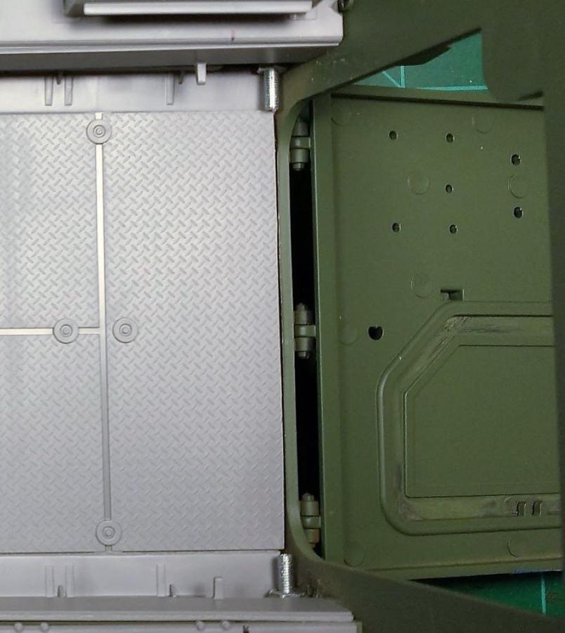

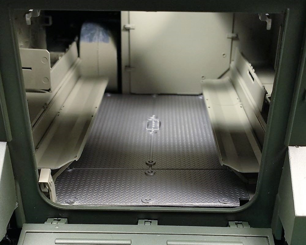

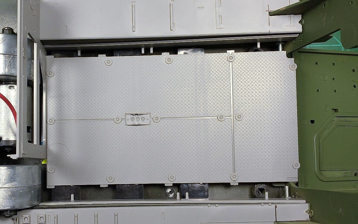

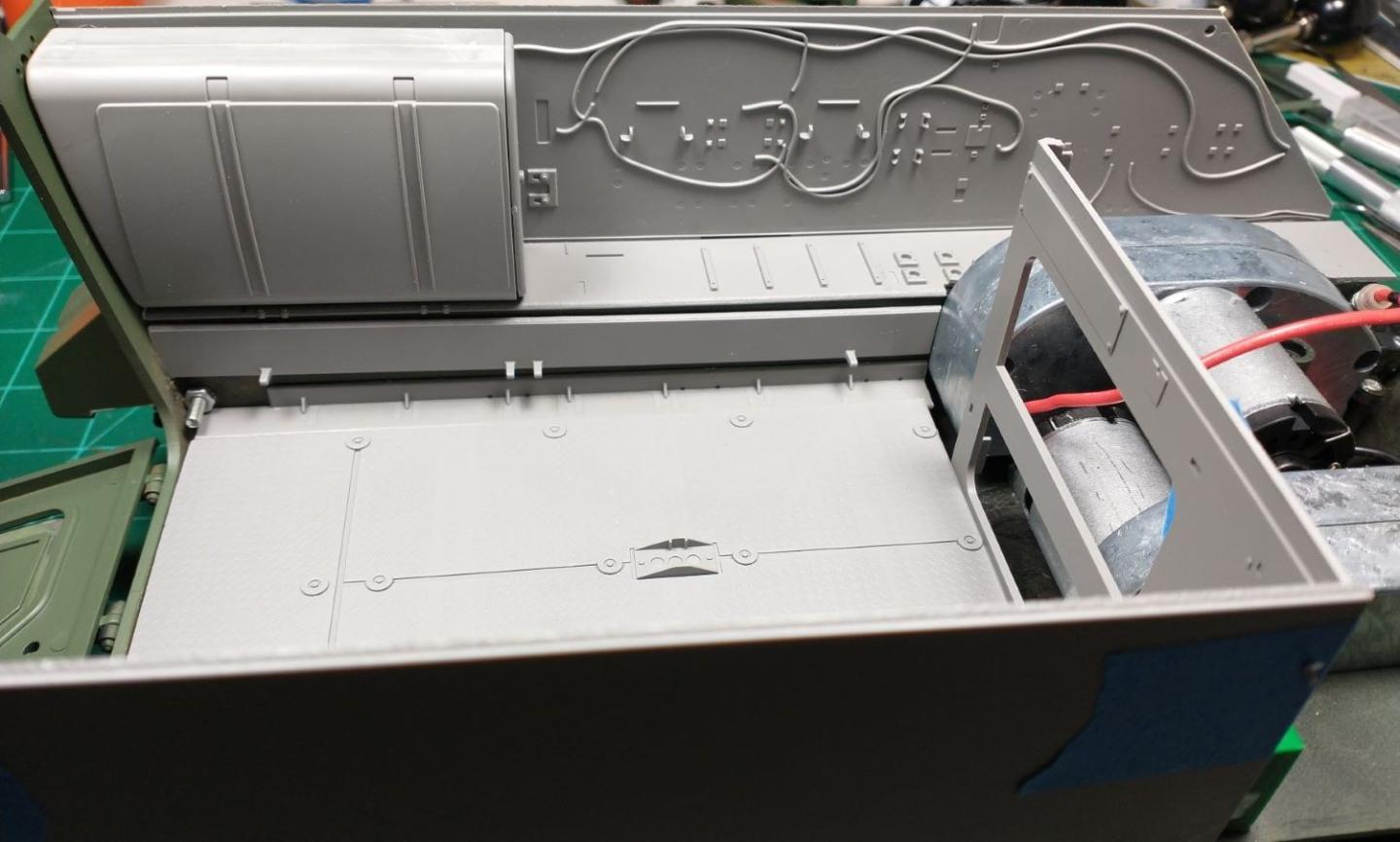

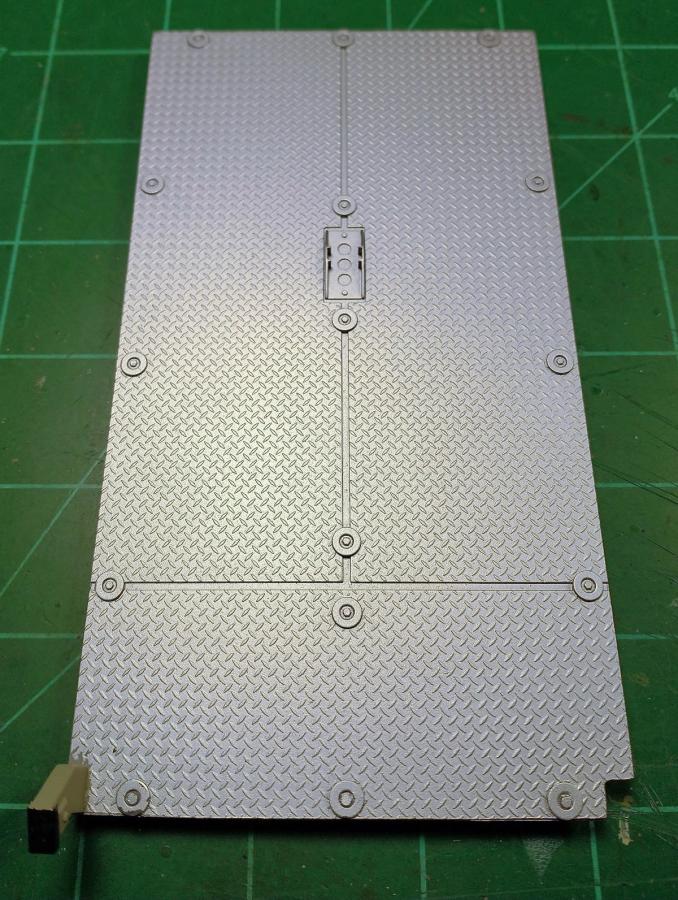

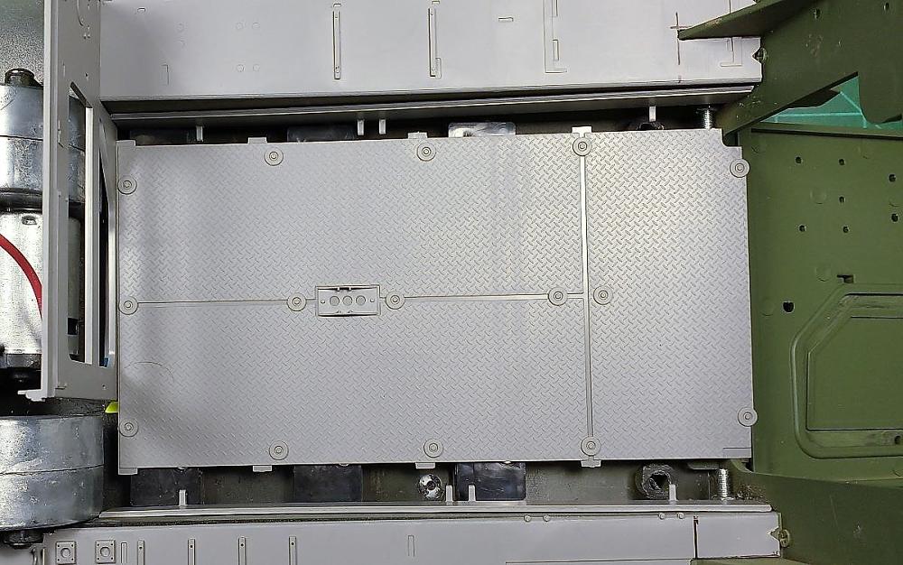

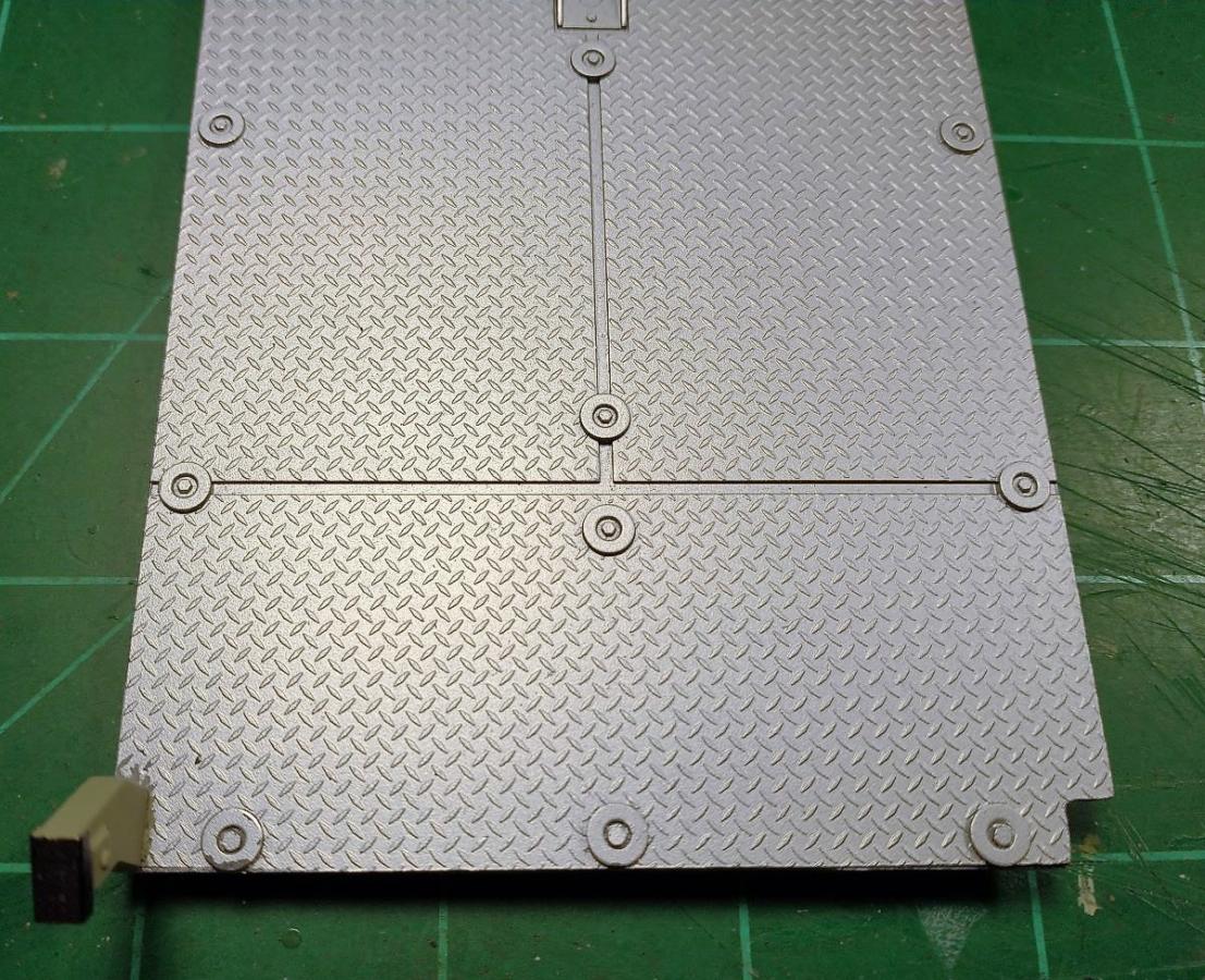

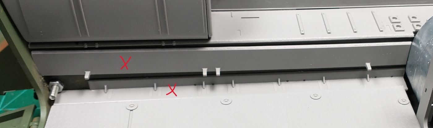

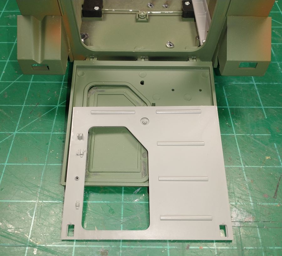

                          Now for the floor. The AHHQ kit piece is about a 1/4 inch too long. I choose to cut it down on the ramp end to keep the commanders seat assembly mounting notch somewhat in a correct position related to the turret.
                          Here's the test fit.
                          Click image for larger version  Name:	FL1.jpg Views:	0 Size:	230.3 KB ID:	450749
                          And the trimmed piece. You loose the hold down bolt and washer detail.
                          Click image for larger version  Name:	FL2.jpg Views:	0 Size:	71.1 KB ID:	450750

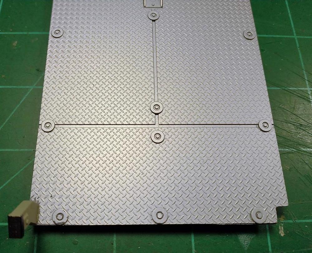

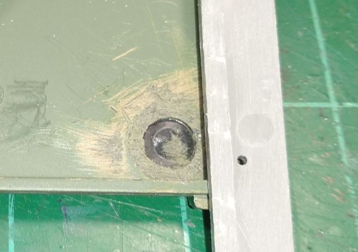

                          I added the missing bolt detail back with small washers and some 1mm bolt heads left over from my gun truck project. I also added the notch on the right side for the bilge pump discharge tube and the ramp pulley assembly on the left.
                          Click image for larger version  Name:	FL5.jpg Views:	0 Size:	216.4 KB ID:	450751
                          Click image for larger version  Name:	FL6.jpg Views:	0 Size:	130.3 KB ID:	450752
                          A placement and paint test. Not to sure about the interior color.
                          Click image for larger version  Name:	RMP1.jpg Views:	0 Size:	128.1 KB ID:	450753

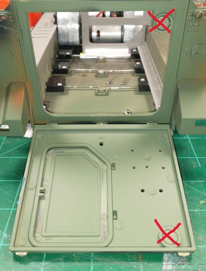

                          • tdriver113
                            • Apr 2023
                            • 110
                            • Peoples Republik of Illinois

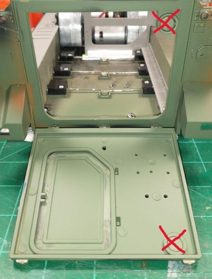

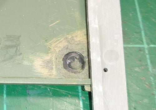

                            The factory ramp magnets were removed and 15mm x 5mm x 3mm thin block magnets installed in their place. This allows the new inner ramp cover to fit flush and improves appearance.
                            New magnet.

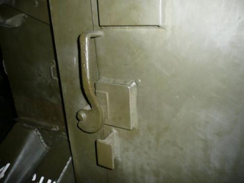

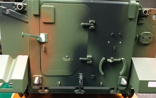

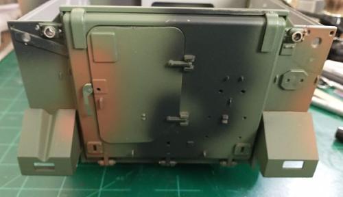

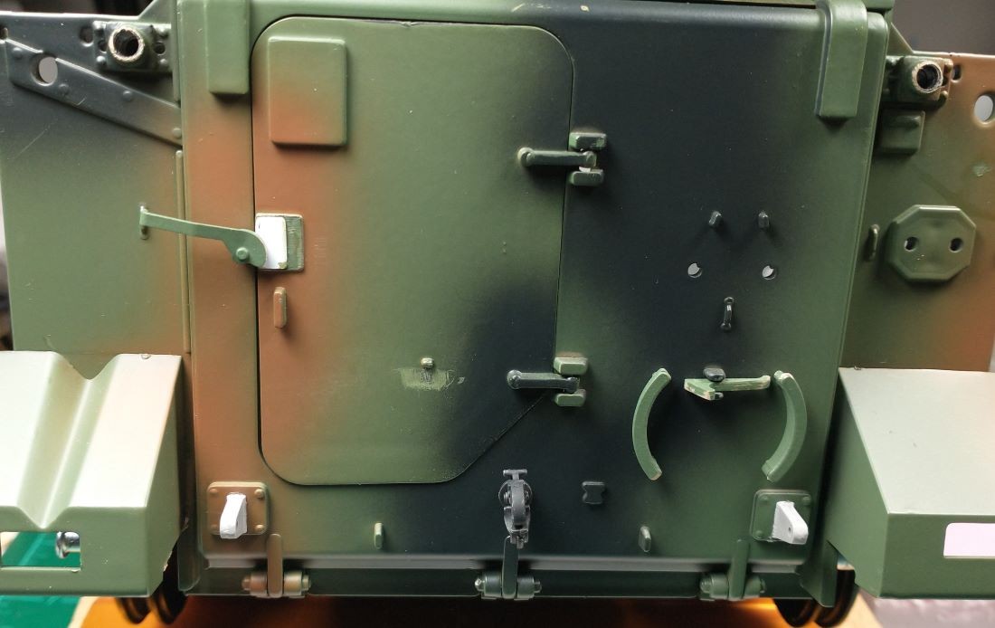

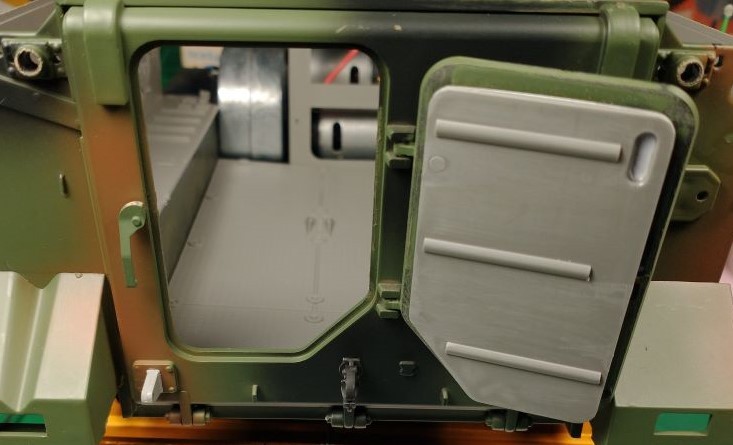

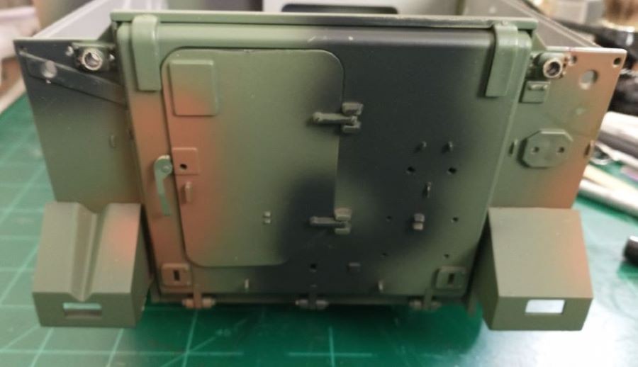

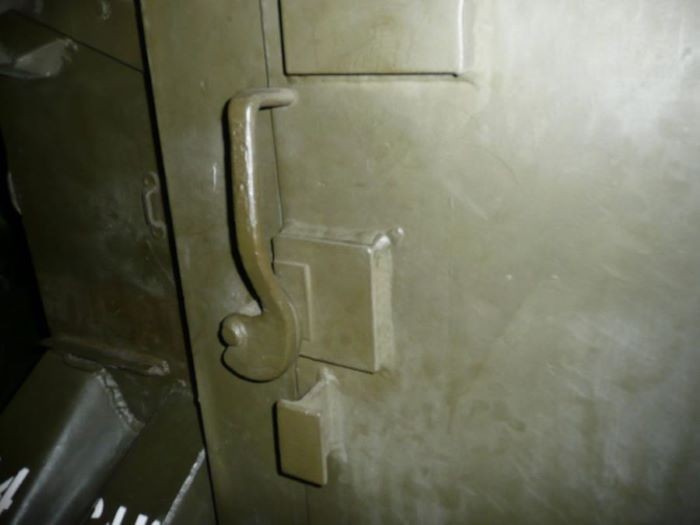

                              The door handle is mounted in the wrong location on the door instead of the ramp. I drilled a new hole a size smaller than the pin to give a good press fit. The handle is operational. The hole in the door was patched with a small piece of thin plastic that also adds a little pressure to help keep the door closed.
                              Click image for larger version  Name:	RH.jpg Views:	0 Size:	52.6 KB ID:	450956
                              Click image for larger version  Name:	RH2.jpg Views:	0 Size:	102.5 KB ID:	450957
                              • tdriver113
                                • Apr 2023
                                • 110
                                The small patch is similar to the actual door mount.

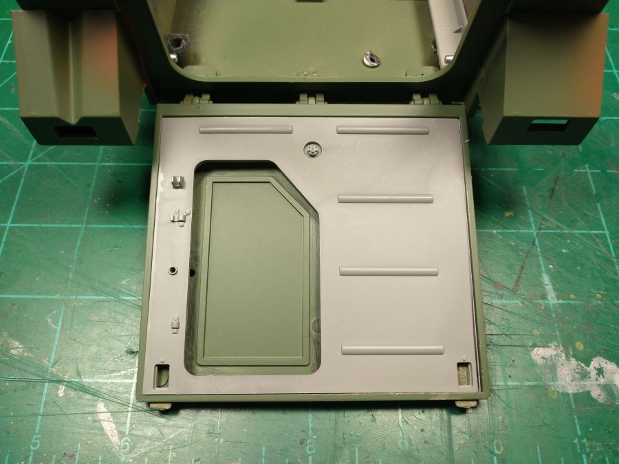

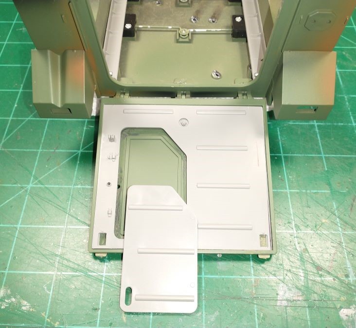

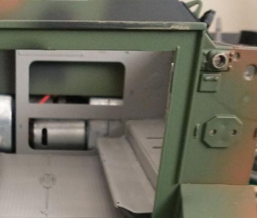

                                  #17

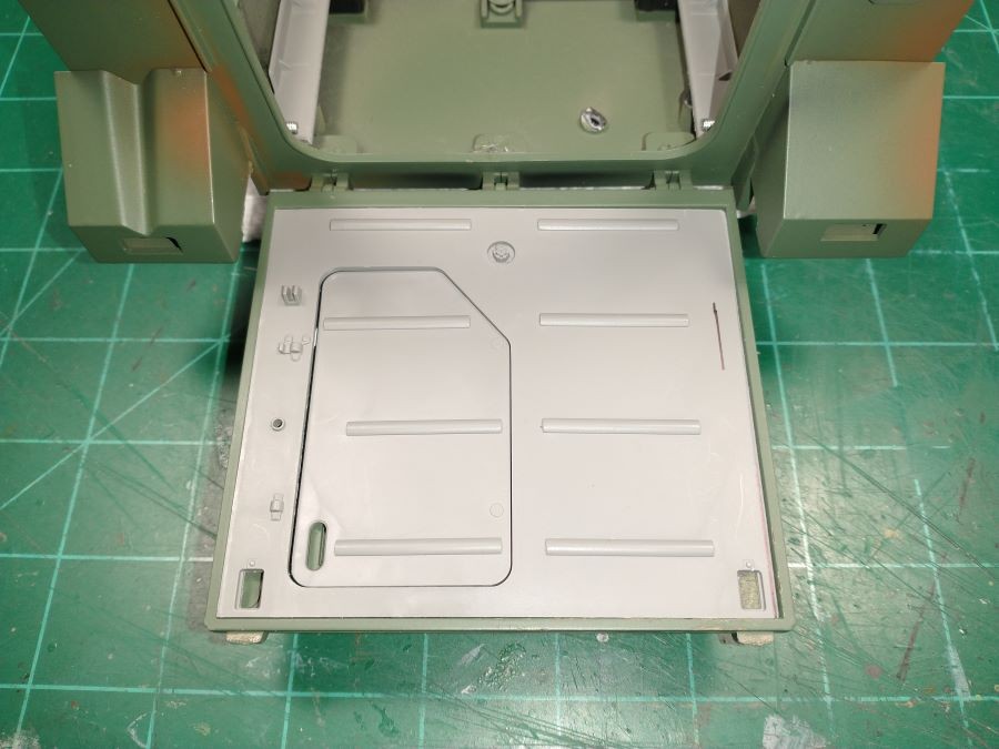

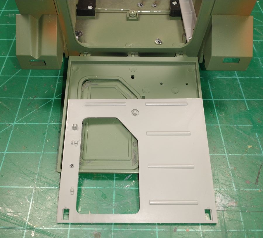

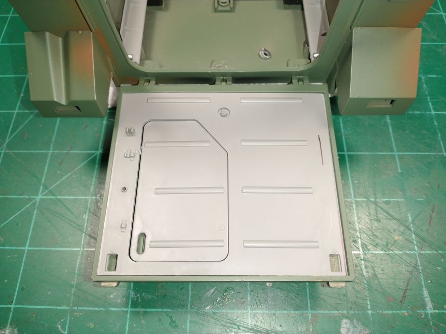

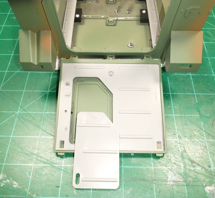

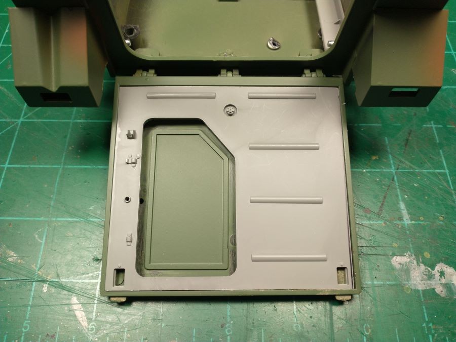

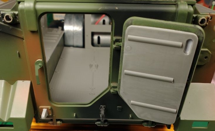

                                  The inside ramp panel from the AHHQ kit is almost a drop in. A slight trim on the sides and bottom and it slides right in. That and the door panel were shimmed to fit flush and glued in place.
                                  Click image for larger version  Name:	R11.jpg Views:	0 Size:	127.7 KB ID:	451002
                                  Click image for larger version  Name:	R22.jpg Views:	0 Size:	105.4 KB ID:	451003
                                  Click image for larger version  Name:	R33.jpg Views:	0 Size:	96.3 KB ID:	451004
                                  Click image for larger version  Name:	R44.jpg Views:	0 Size:	97.2 KB ID:	451005
