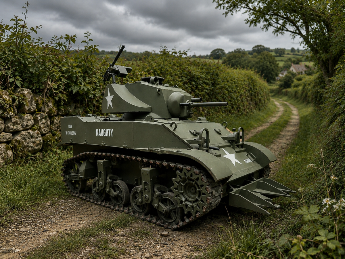

    Those that have one, has anyone removed the side Armor plating? If so, how did it come out?
    Thanks..........
    Ed
  • SoCalBobS
    • 2775
    • Southern California
    Many of us have. Dremel is on the job!

      Of course, a Dremel, didn't click, senior moment 🙄, Exacto knife did though. Thankyou.............

        I have been studying your work for a bit now, close up as much as I can. Hope mine turns out close to that, it's what I have in mind, I do plan not to have the hedge cutter on it. The Stuart and the Walker have always been my favorites. There is a Stuart on the grounds of the Quincy Veterans Home in Quincy Ill. I always spend a few minutes walking around the old girl when I visit.

          Thanks! I can see my flaws, though. The biggest issue is the type of plastic used for r/c tanks. It's much tougher than, say, plastic display models. Xacto blades would take forever, and Dremels can melt the plastic. Short runs with the rotary cutter, then Xacto blades can be used for fine finishing.
          The Coolbank hedgecutter is a snap on/off item. I put it on for display, but remove it for outdoor running.
          Another view of the cut line:

            The old saying goes, one's worse critic is themselves. What I see is a goal for me. Thanks for the photo.

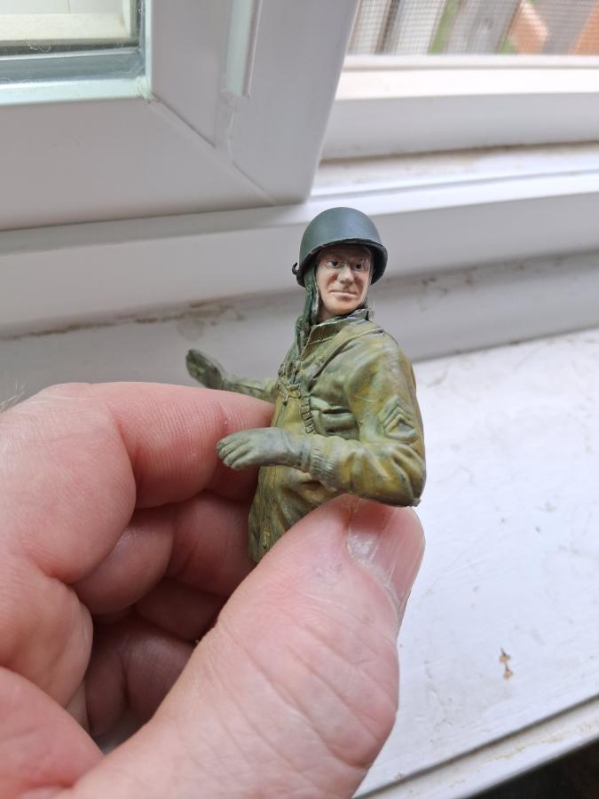

              Hi guys, I borrowed a partial body tanker figure from Dave Geee to see how they were to work on. 1/16th scale in a couple of hours.
              First hour:
ID:	451424 Click image for larger version
              Second hour, time for a break!

                I see my tankers will be in good hands.....Ed

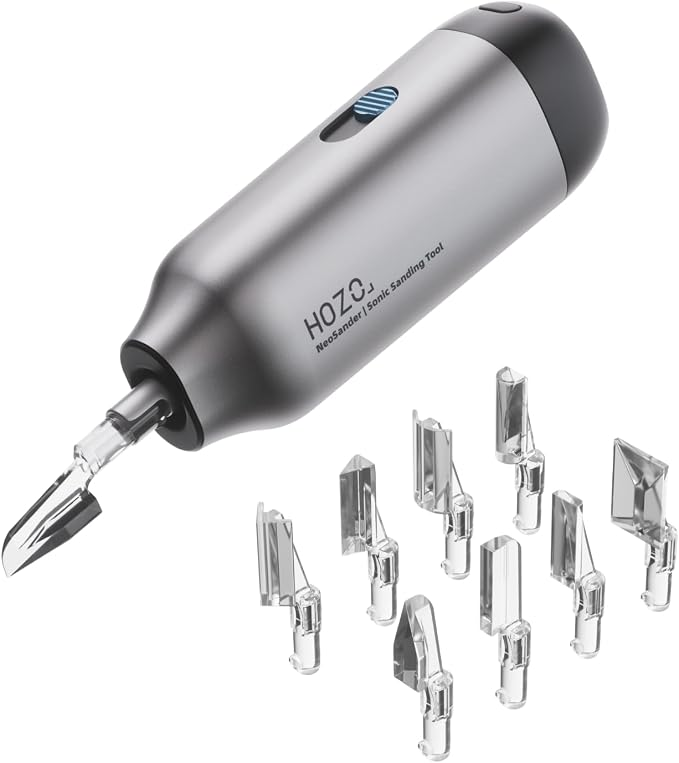

                          I'm not able to give you a review on the ultrasound cutter today as planned, it does not work. Returning it and have purchased a different brand but by sight only I can see how it could be an asset, just need to find the right one. I did receive a micro sander by the same brand, it's working just fine.
                          HOZO NeoSander Reciprocating Detail Sander, Mini Electric Pen Sander with 13000 SPM Linear Motion, Adjustable Stroke for Precision Sanding, Ideal for 3D Printing, Model Making, Crafts & DIY Projects

                            A less expensive way to go....add this to the above Neo-sander:
                            NeoSander Saw Blade Set, Turns NeoSander into Mini Reciprocating Saw, 8pcs 0.2mm Anti-Binding Blades, 4 Curved Blades for Straight Cuts & 4 Jigsaw Blades for Curves, for Resin, Plastic & Wood

                              These arrived lastnight. Tried one attachment, really precise cutting.

                                I finally got the side armor off the Stuart...BTW, the little saw blades work great.
