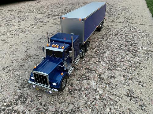

                                Beetlemankurt inspired me by asking if I was going to do lights on my trailer. I was skeptical because the kit is pricey for what you get IMO ( tail lights and blinker). However I wanted to take it a step further for greater realism. So I decided to custom install marker lights as a stand alone lighting system for simplicity. I love the way it turned out. If you look at the pics notice how nicely the LEDs blend with the stock, marker stickers so that when the lights are off it still looks very scale. Since this turned out, it forced my hand to get the tamiya trailer light kit to complete the scale details. It will be installed soon and I’ll follow up with some real world pics with it hooked up to my King Hauler.

                                  Baysim80 Are those SMD LEDs? Whatever they are, they look great, especially how they "blend" into the marker stickers, as you said.

                                    Alpha those are “Edgelec” 3mm Orange 12v LEDs. Works on 2 or 3s lipo Direct connection.

ID:	270773 It’s complete!! And B-E-A-utiful IMO. Ready for the sidewalk highway, man is this thing fun to drive too!! I love it. Sorry if this is too many pics but I just can help it. I hope this inspires others to join in this incredible aspect of the hobby.

                                        Baysim80 Oh man, that is completely awesome! I love the marker lights and really like the pic in the dark showing the high beam of the headlights on the footpath/sidewalk.
                                        That box trailer just looks so right at home on the back of your KH mate. Sorry to lead you astray in regards to the trailer lights .....looks like it was well worth it though!
                                        If people aren’t inspired by that, they better do a bit of pulse checking .....make sure they are still alive..Theres just something cool about these trucks and they offer such a different RC experience to anything else. Definitely addictive!
