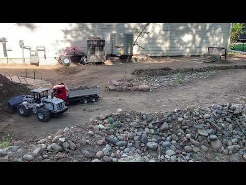

                      Thought I would update with some thoughts and share some video so you would know what to expect with the tamiya electric actuator for the tipper truck. It’s slow! Real slow. The Huina dump truck dumps faster. I checked the manual for the tipper mechanism and it states that full range operation should take approximately 50 sec. I timed it and it’s right on. If your patient it’s great and operation has been reliable even with what I would consider allot of use. I’ve included a video link so you can see it in operation yourself. It’s cleaner than hydraulic and easier installing. Still very happy with the equipment I have installed on this fabulous truck.
