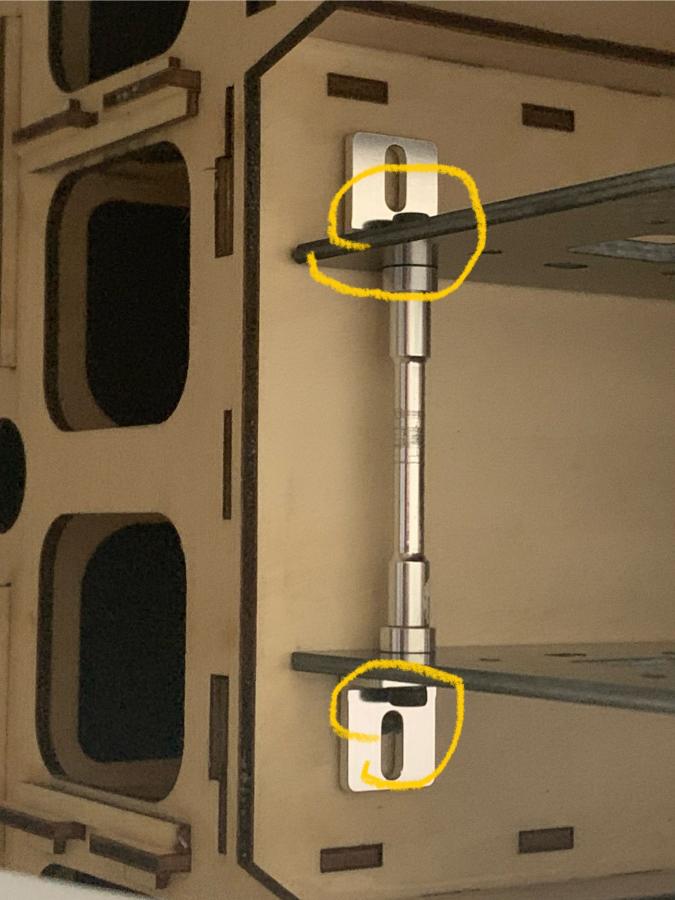

                      • DLHam3463
                        • Mar 2024
                        • 28

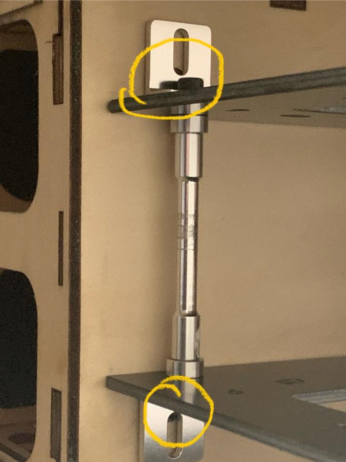

                        Click image for larger version  Name:	IMG_5009.jpg Views:	0 Size:	59.0 KB ID:	402950 Click image for larger version  Name:	IMG_5008.jpg Views:	0 Size:	63.9 KB ID:	402951
                        Question, the stock Roban frame width expectations are based on a 47mm width. The later Trex and PhoneixTech 600ESP are 54mm.
                        I have the spacers etc for tail rotor bearing plates, but in doing some checking with 54mm spacing the frame mount lug holes are too wide for installed T-nuts.
                        i am thinking perhaps to locate them agains the inside frame wall as they are 2mm thick so that looks like it would be enough.
                        anyone else do something different??

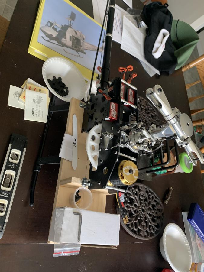

                        • DLHam3463
                          • Mar 2024
                          • 28

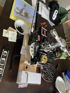

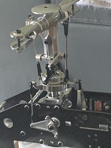

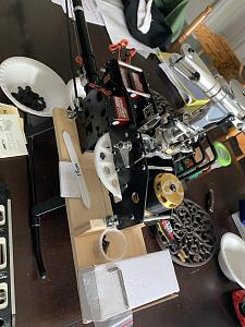

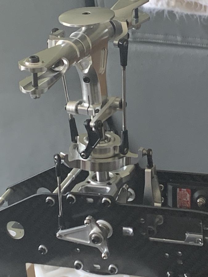

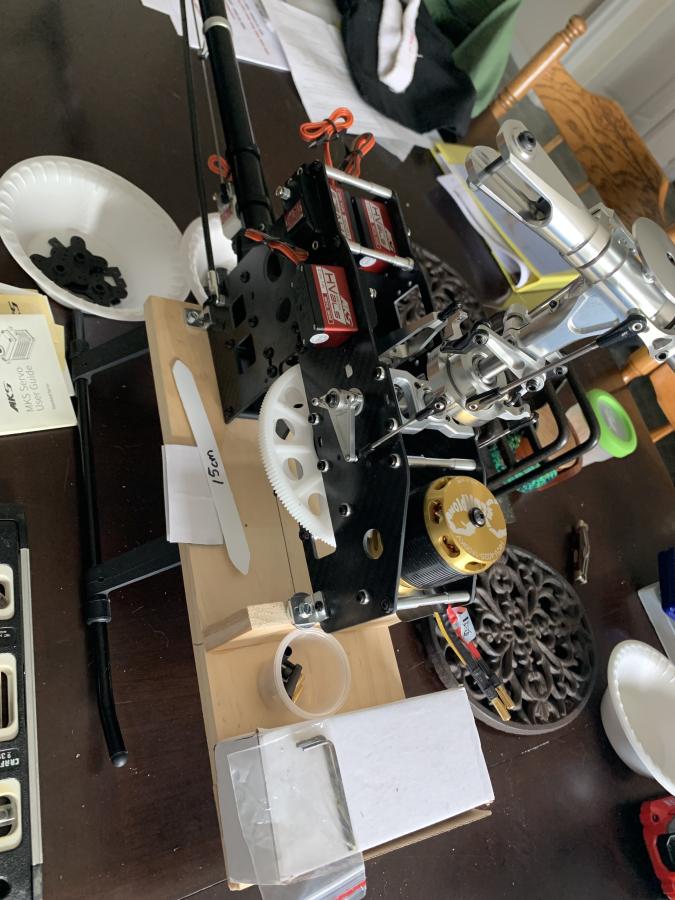

                          Slowly getting there.
