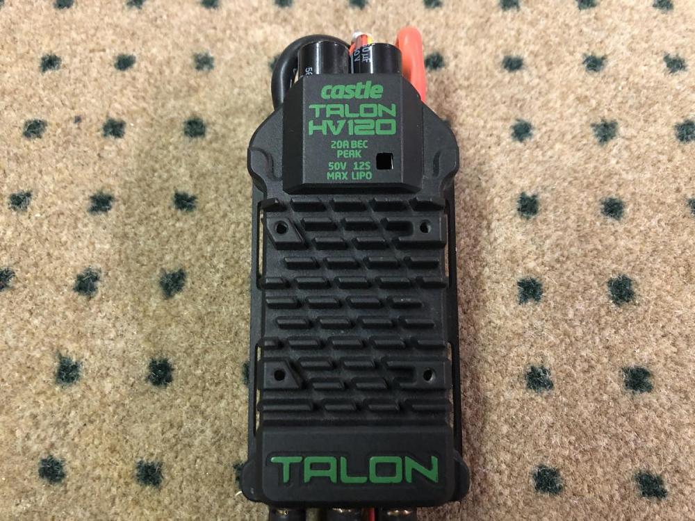

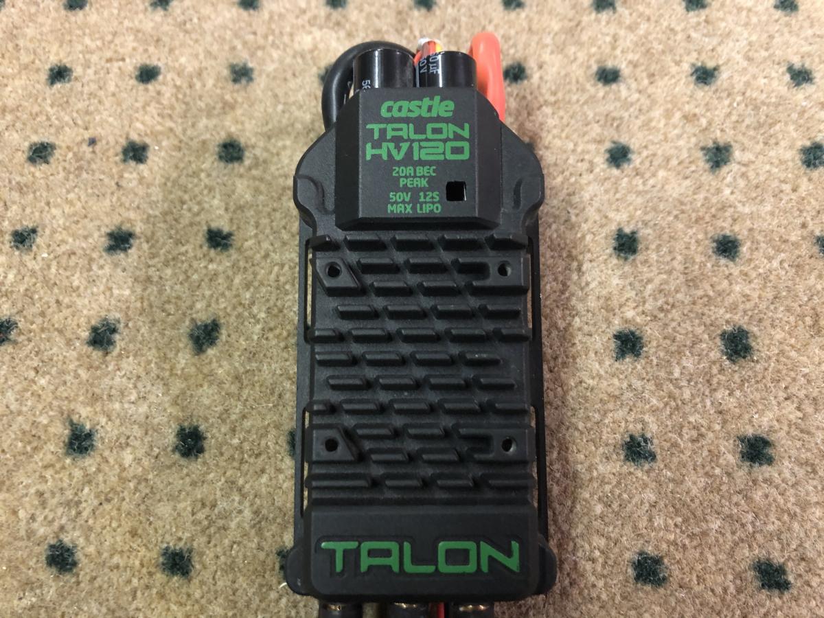

    Here's the link for the kit, I'm using a stock T-Rex 700e mechanics and a Castle Talon 120A ESC.

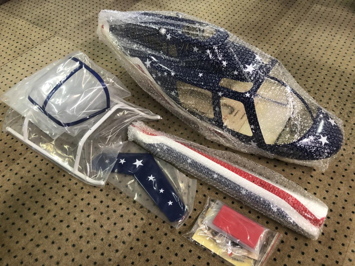

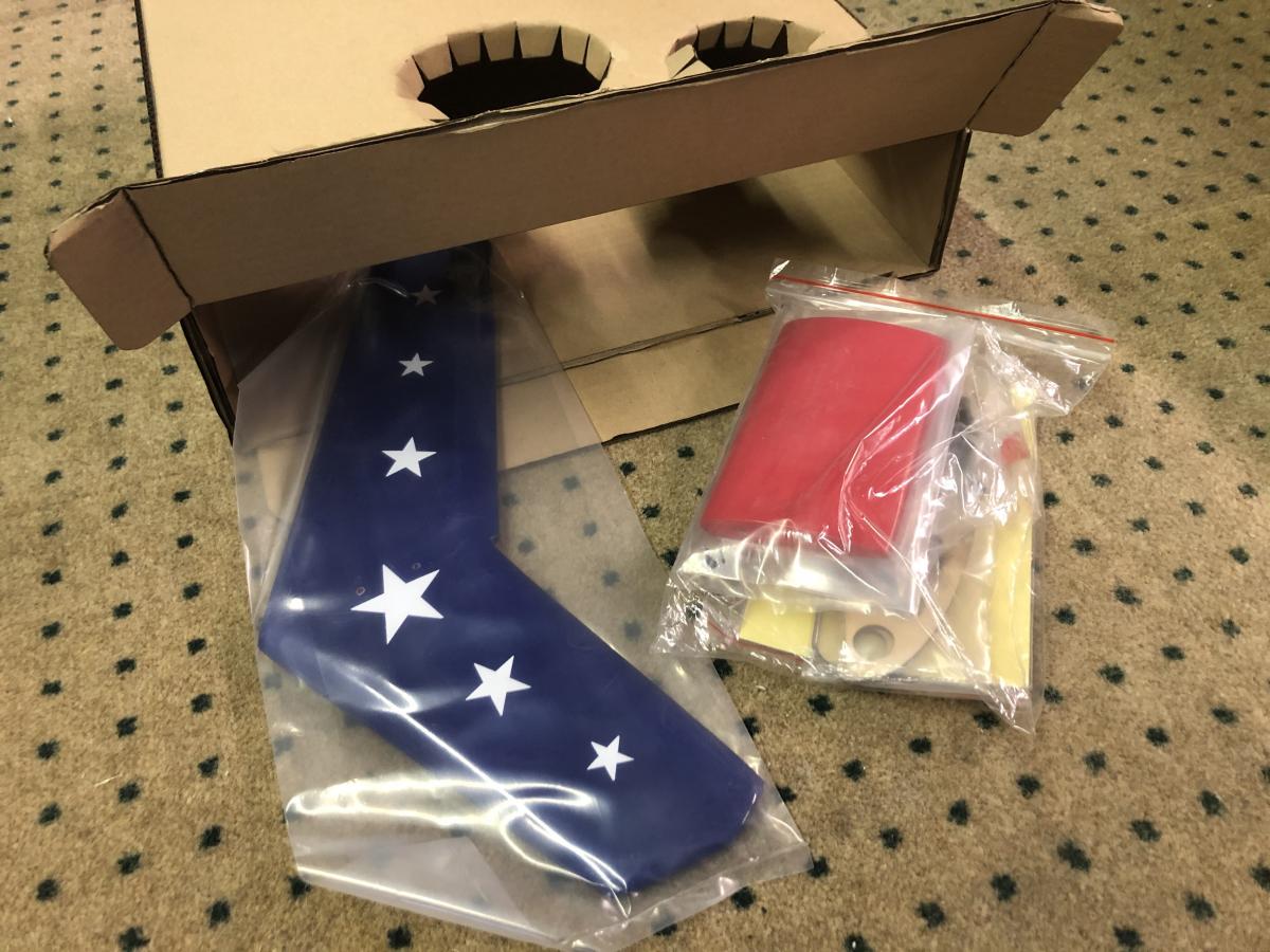

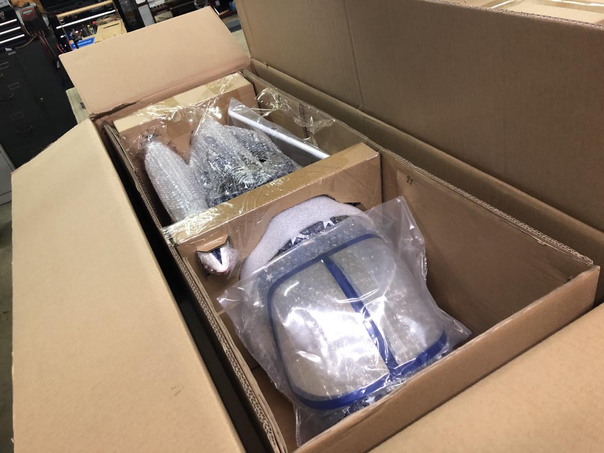

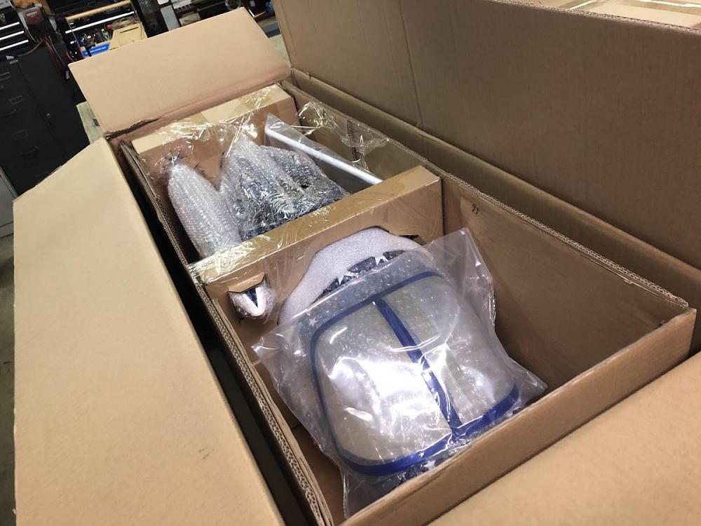

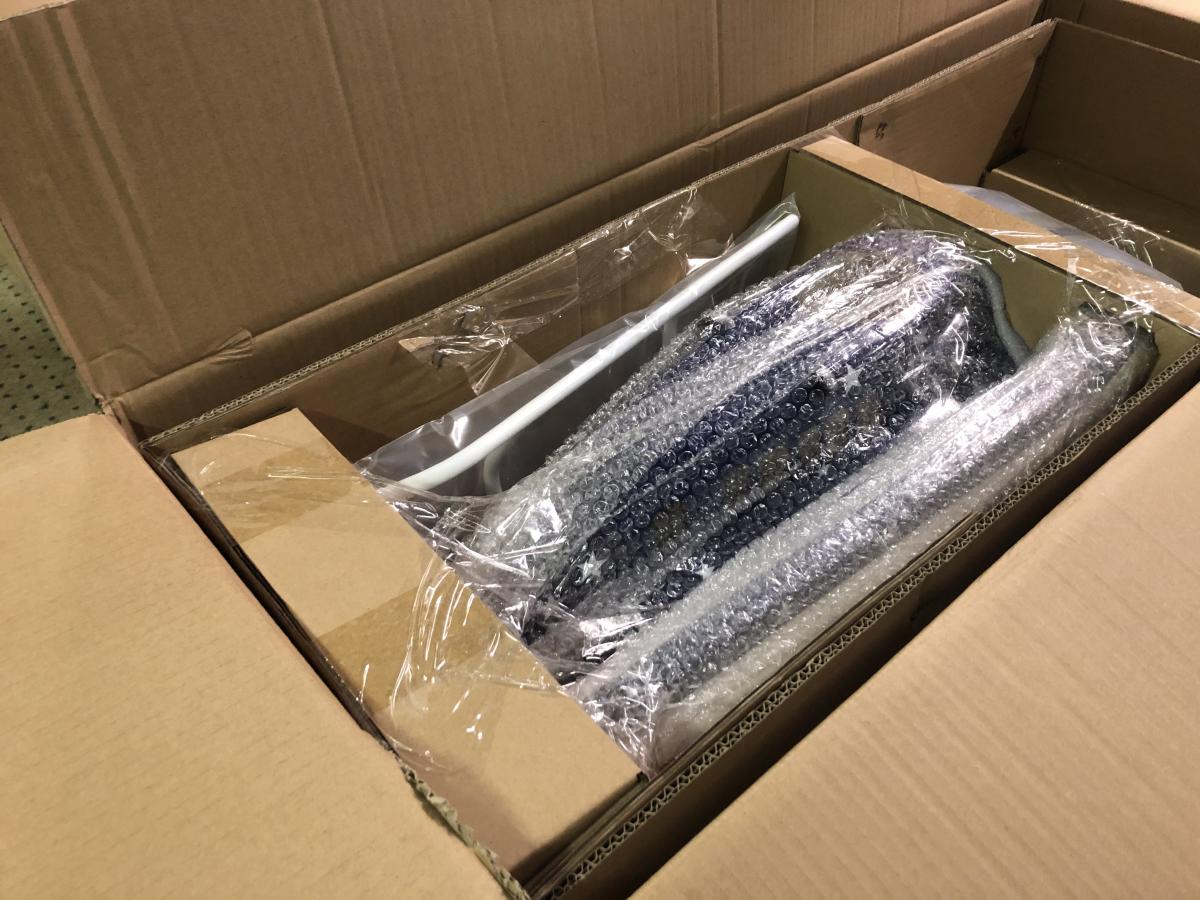

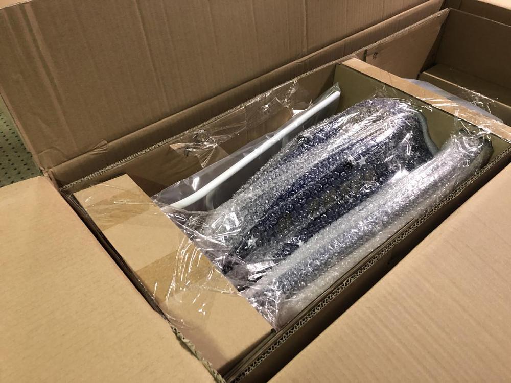

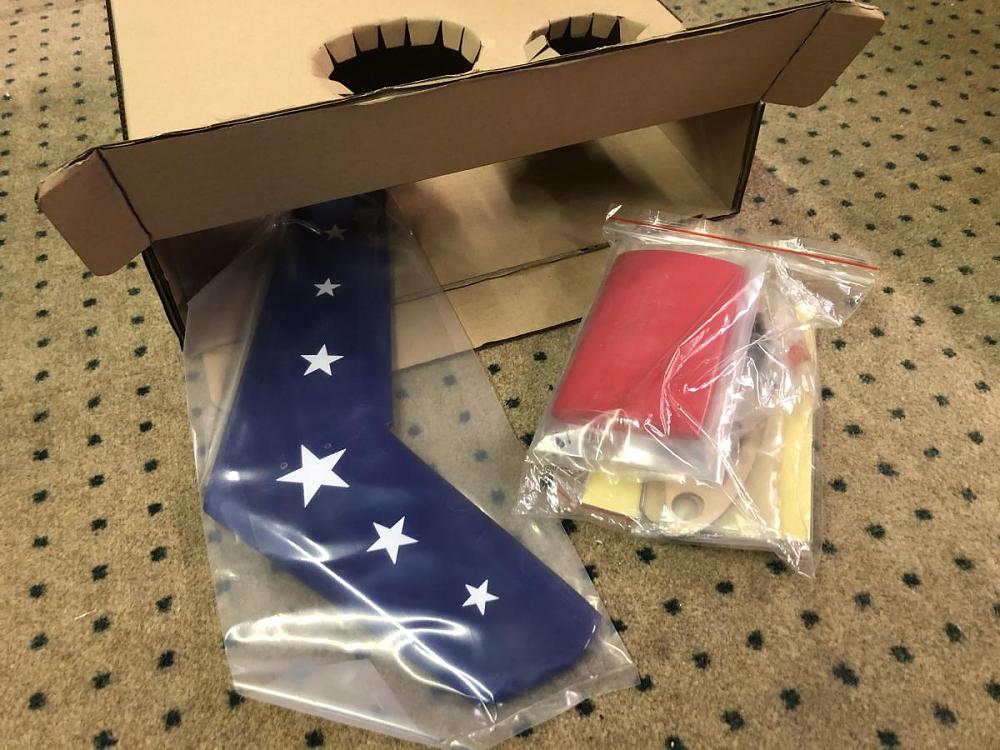

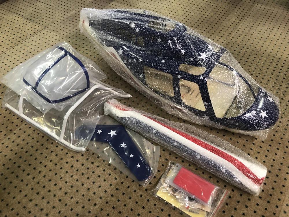

    I have opened up four new Robans and they have all been well packaged and arrived with no damage whatsoever.
    Click image for larger version  Name:	IMG_4516.jpg Views:	0 Size:	115.0 KB ID:	236987
    Double thick cardboard and double boxes, all parts were well wrapped and taped in place through out.
    Click image for larger version  Name:	IMG_4517.jpg Views:	0 Size:	142.8 KB ID:	236988

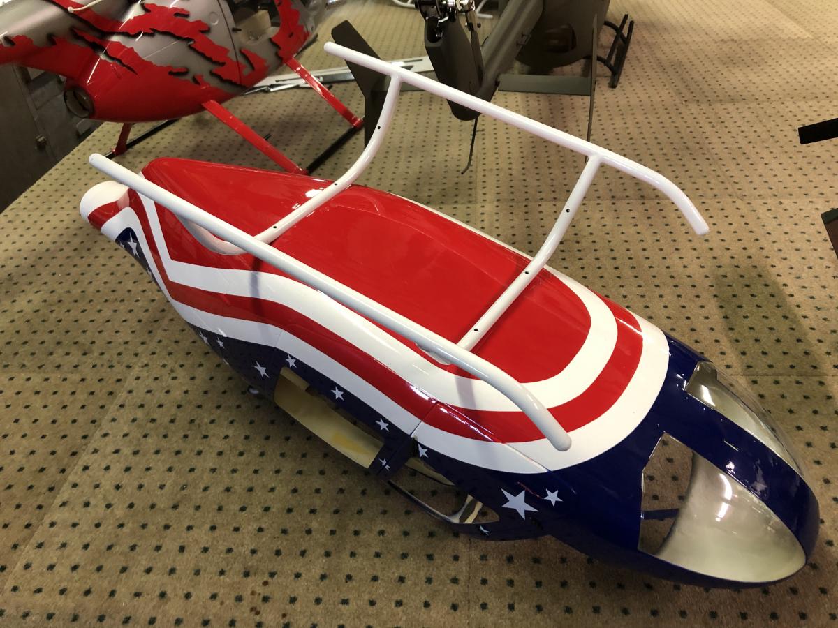

    Click image for larger version  Name:	IMG_4534.jpg Views:	0 Size:	175.9 KB ID:	236991

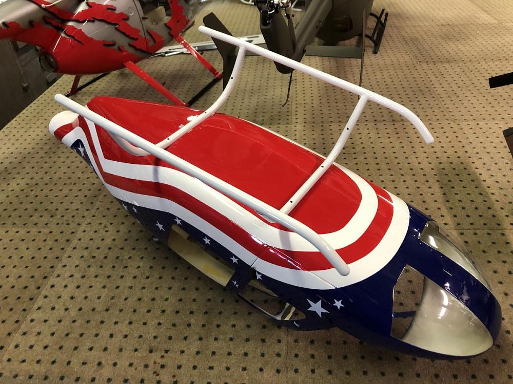

    The paint finish is absolutely gorgeous

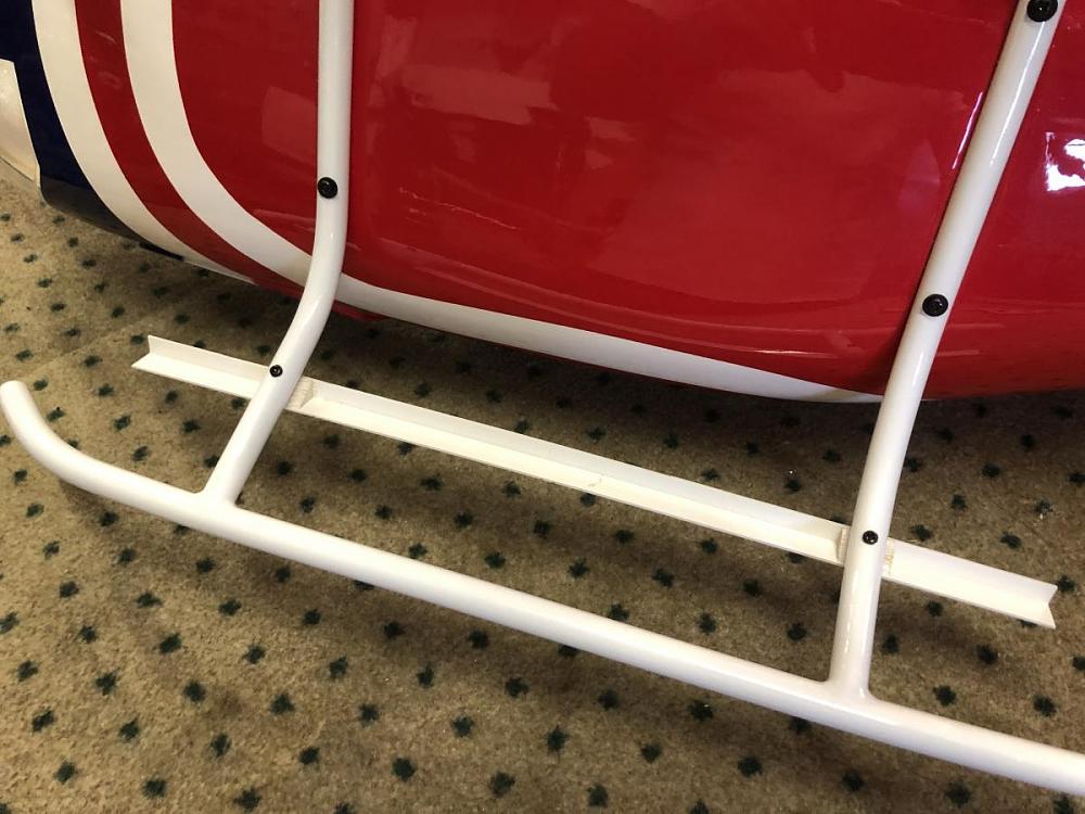

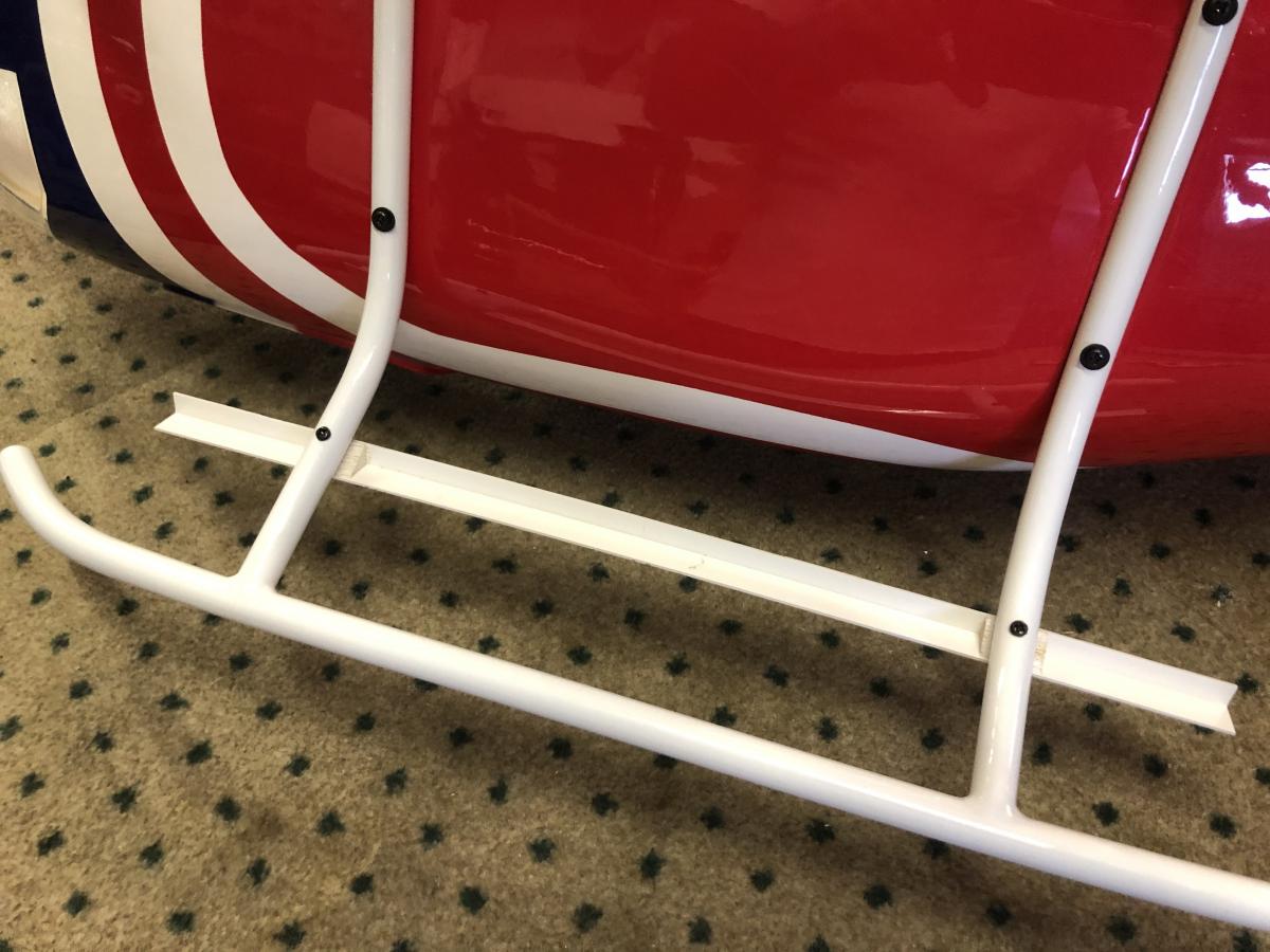

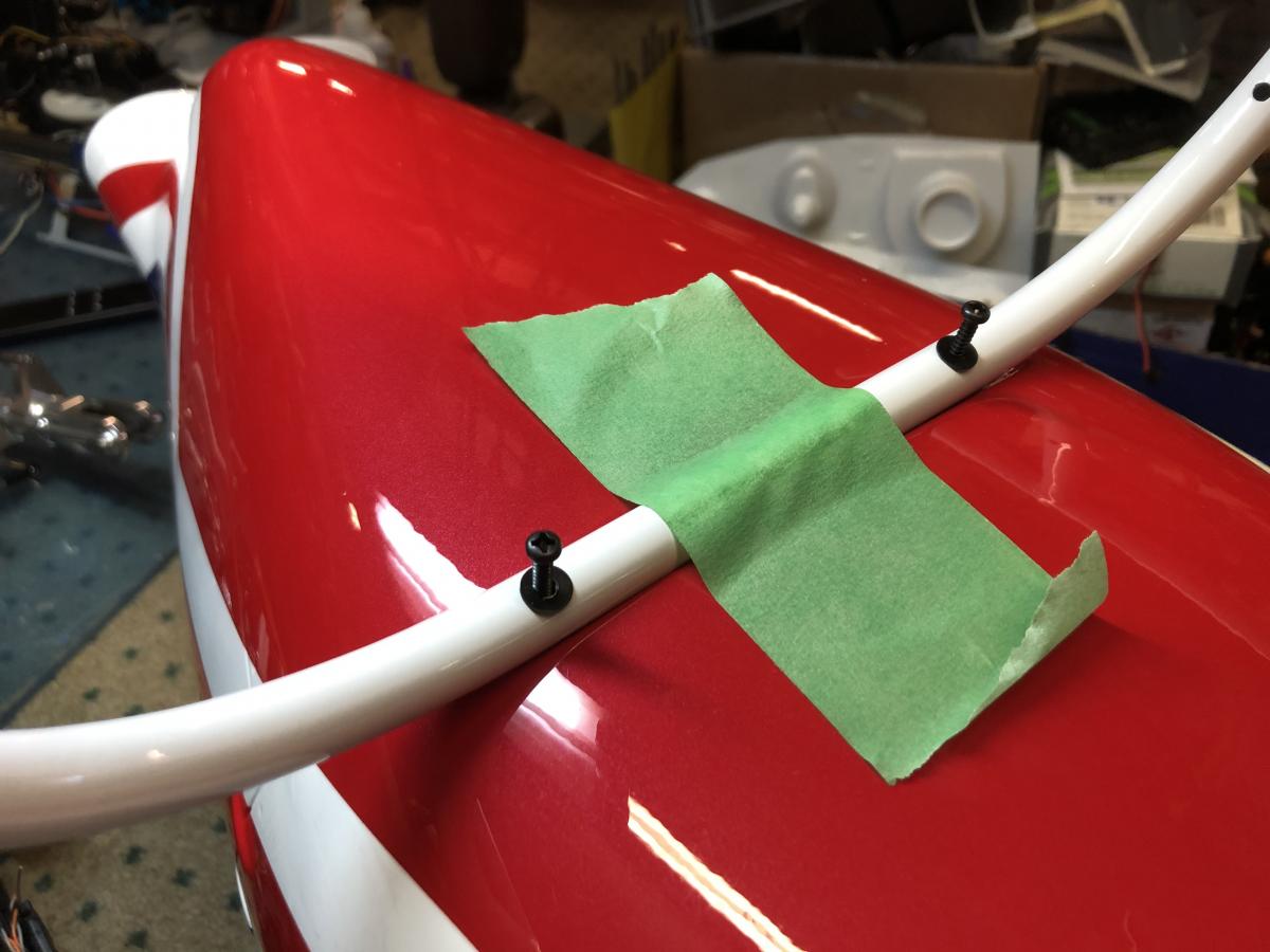

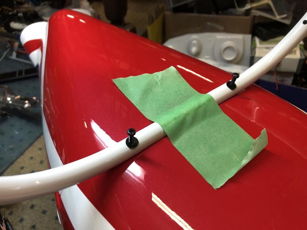

    I used a 2mm drill to start the holes for the skids and steps.
    Click image for larger version  Name:	IMG_4594.jpg Views:	0 Size:	119.5 KB ID:	236994

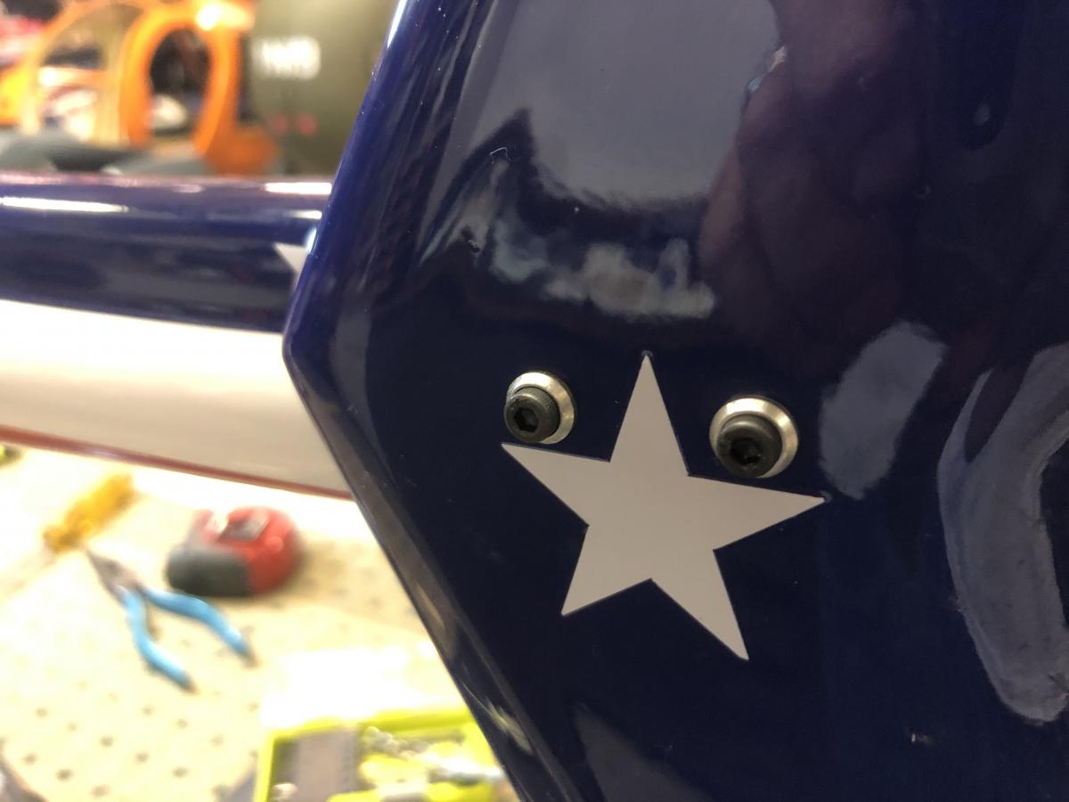

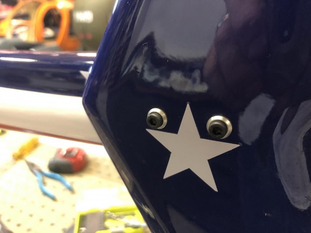

    I used these 3mm hex-heads and aluminum cups from the T-rex.
    Click image for larger version  Name:	IMG_4595.jpg Views:	0 Size:	66.1 KB ID:	236998

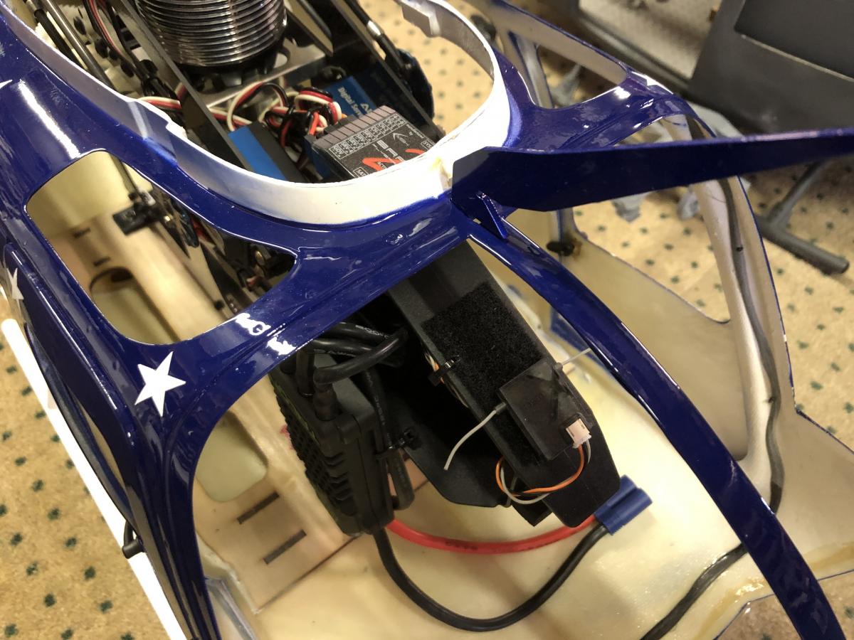

    I'm using the Brain2 or Ikon2 (same thing just different 😎) and satellite receivers.
    Click image for larger version  Name:	IMG_4592.jpg Views:	0 Size:	169.2 KB ID:	236996
    Clearanced the frame adapter holes to 5mm for some wiggle room, again I used the 3mm hex-heads and cups from the T-rex.

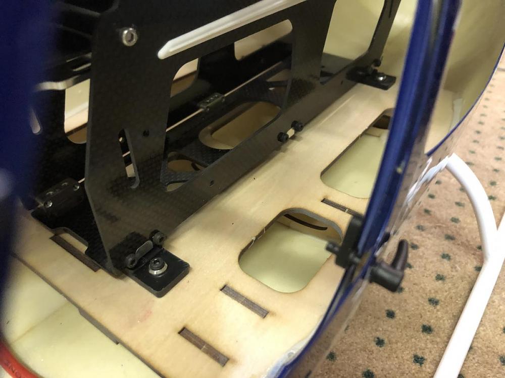

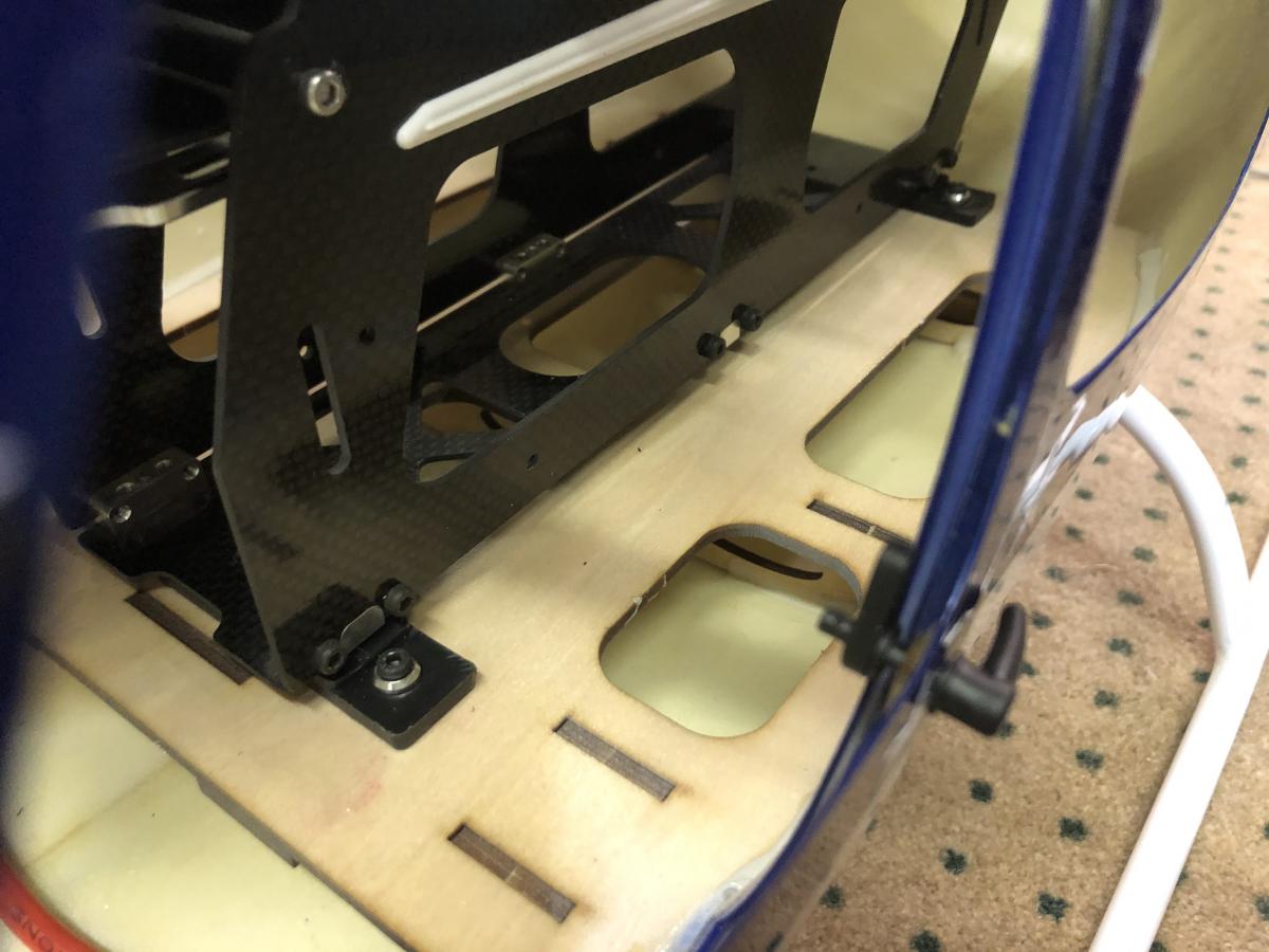

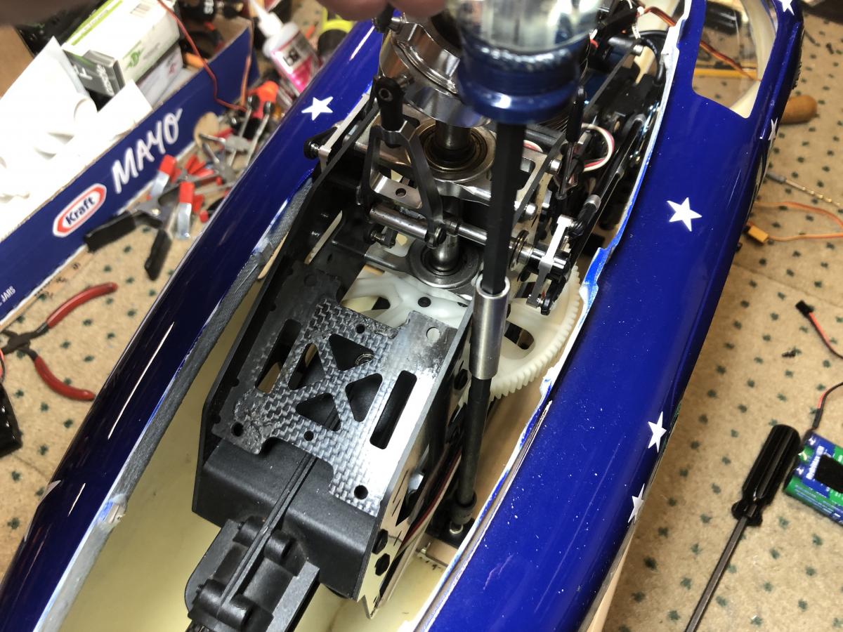

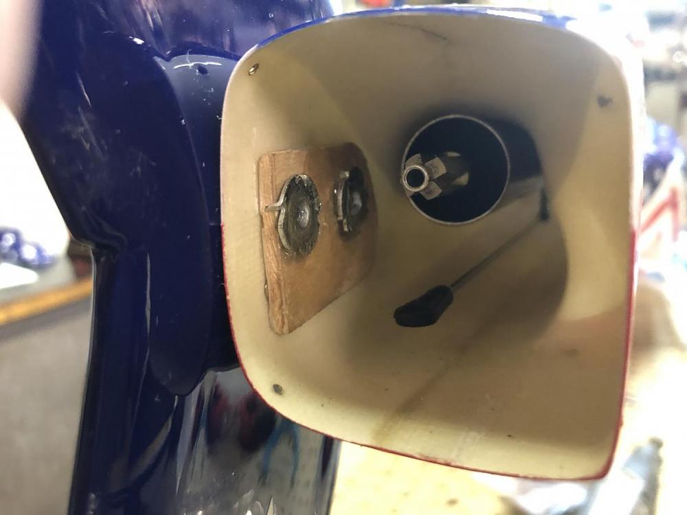

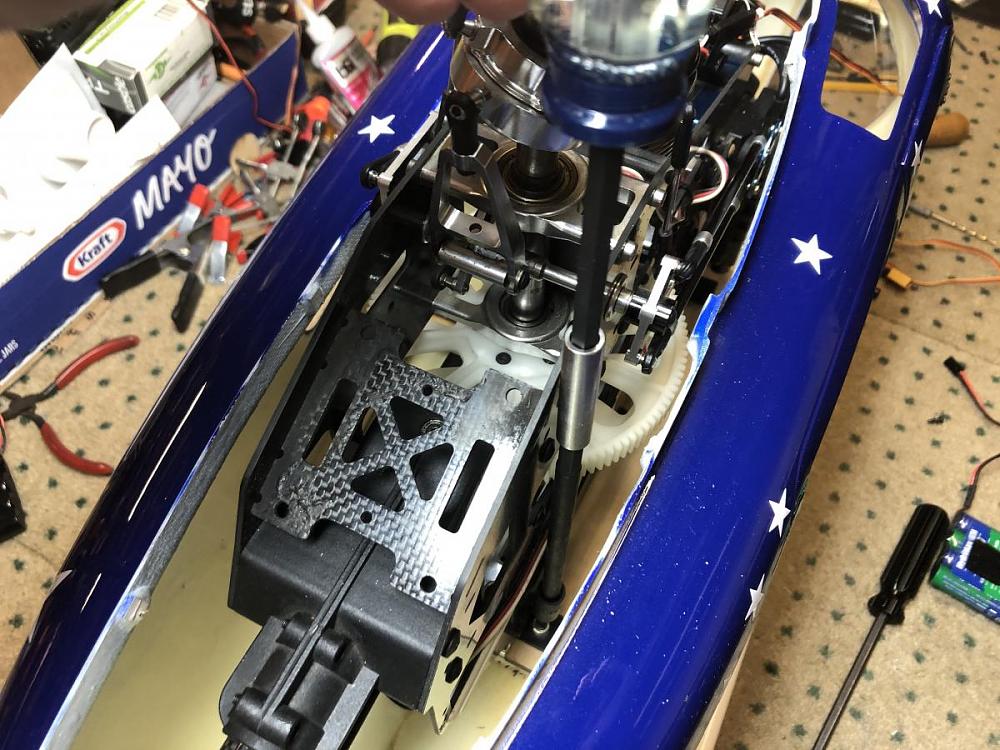

            I installed the tail boom in the fuselage first then dropped the frame in and hooked the boom back up, there's plenty of room to slide the mechanics forward enough to tighten the boom and put the servo arm back on.

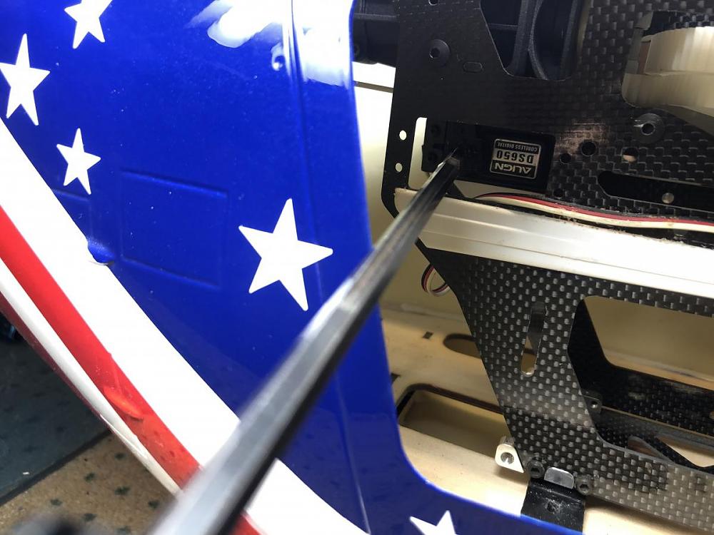

            I made this magnetic hex-driver extension that really helps in tight spots.

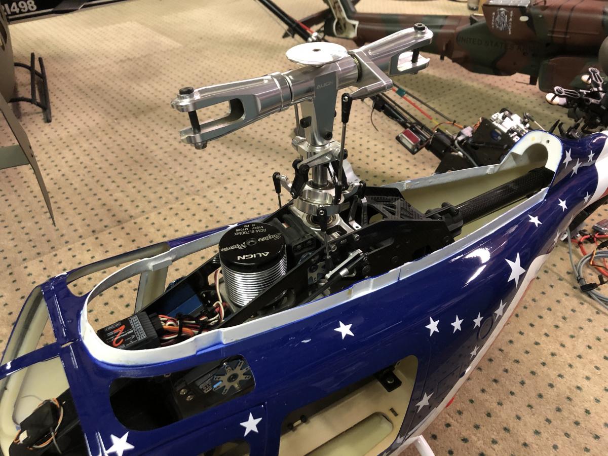

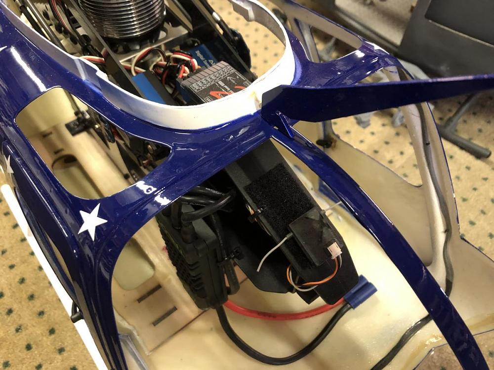

            Mounted the FBL up top so it's easily accessible, usually one satellite towards the top of the fuselage and one on the very bottom.

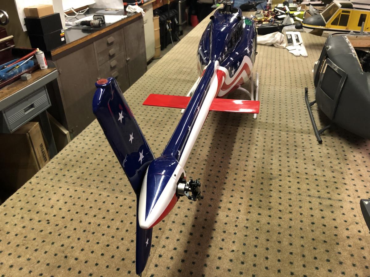

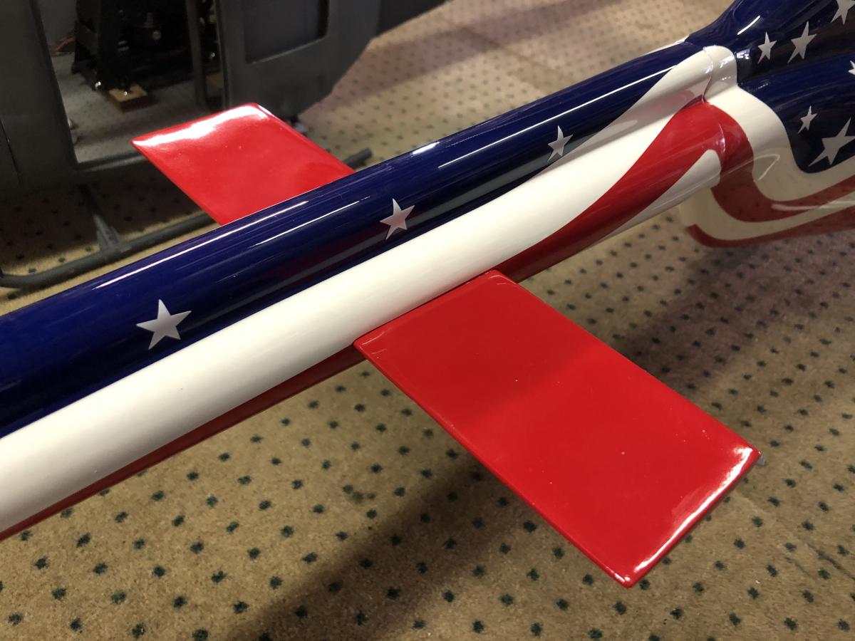

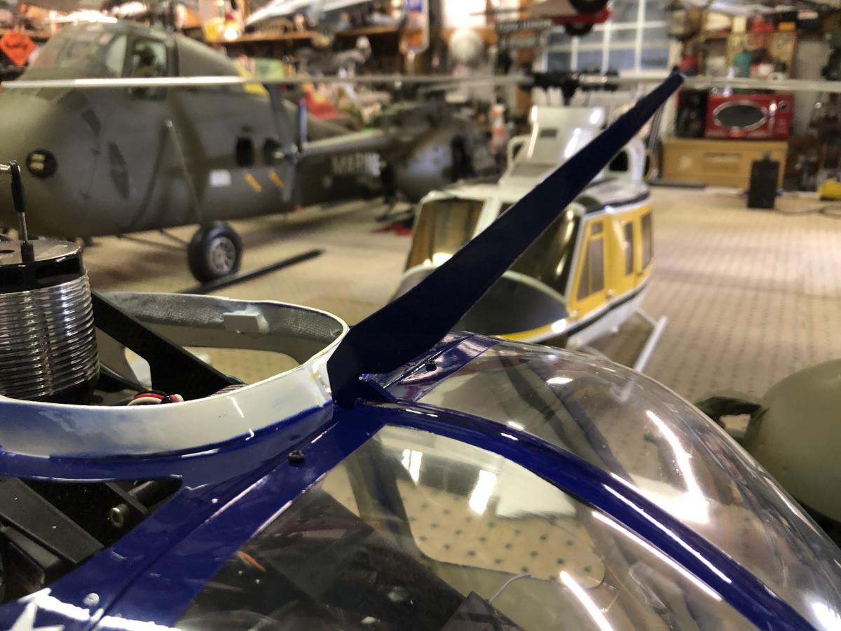

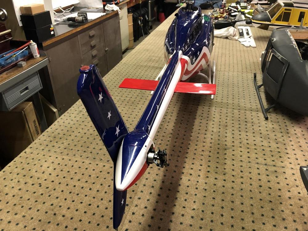

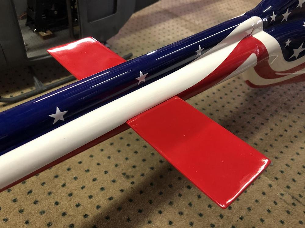

            Installed the horizontals using a 6mm wood dowel and E6000 (Goop) adhesive.

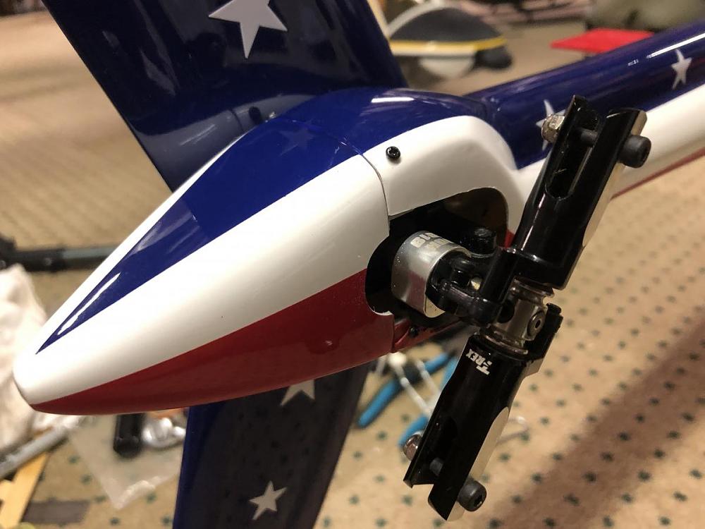

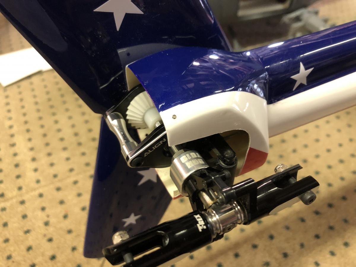

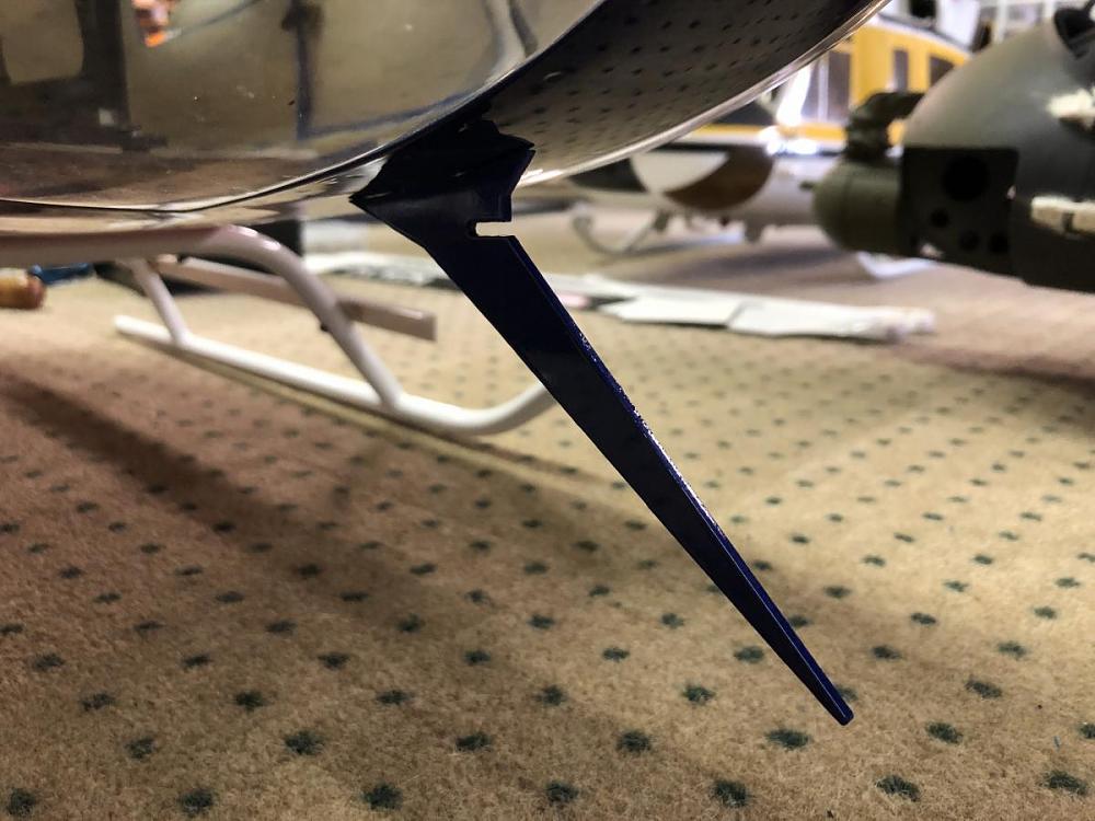

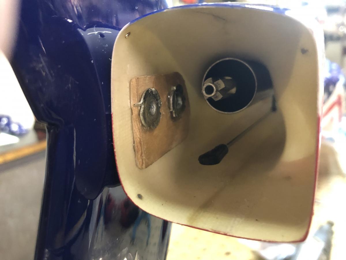

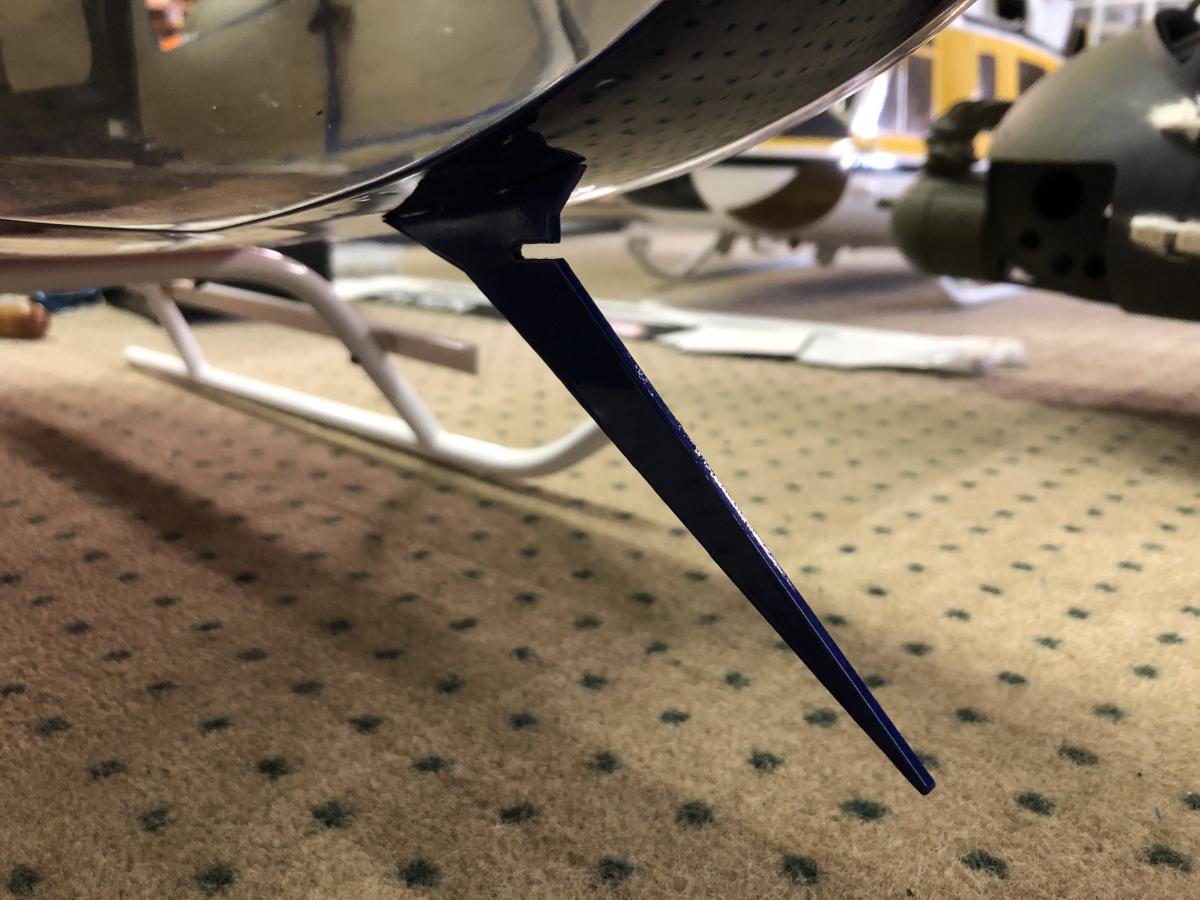

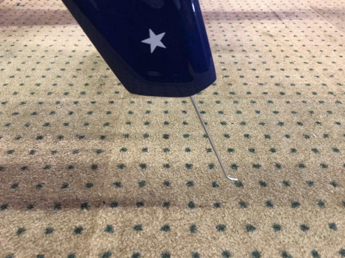

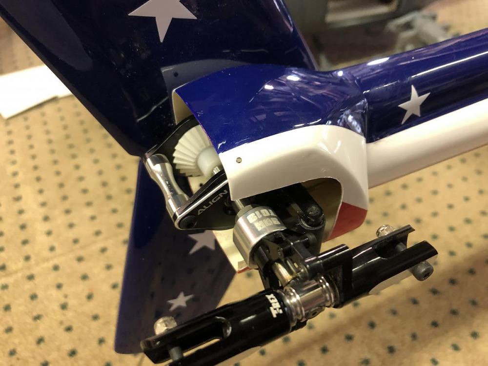

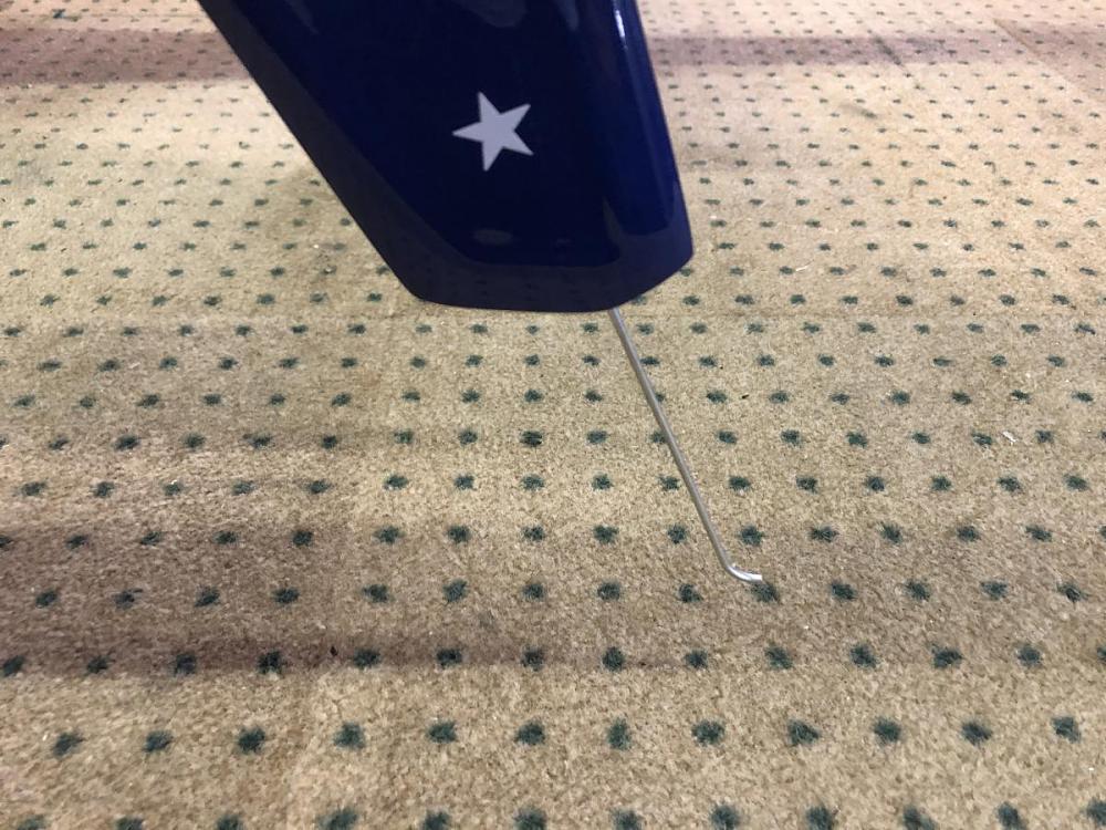

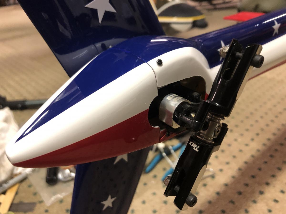

            Trimmed out for the tail rotor and installed the stiff wire skid, I'll put a black rubber hose over it to keep from impaling myself .

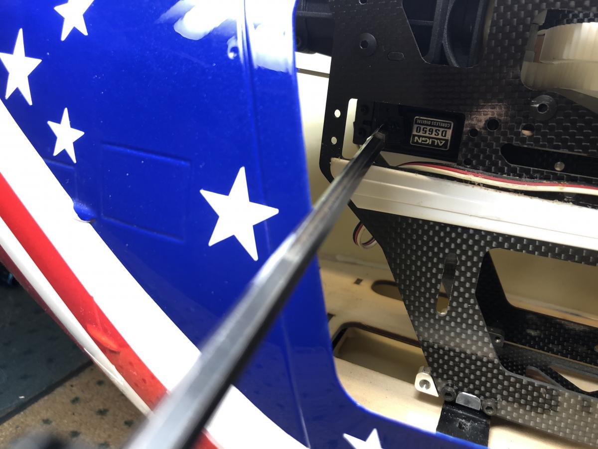

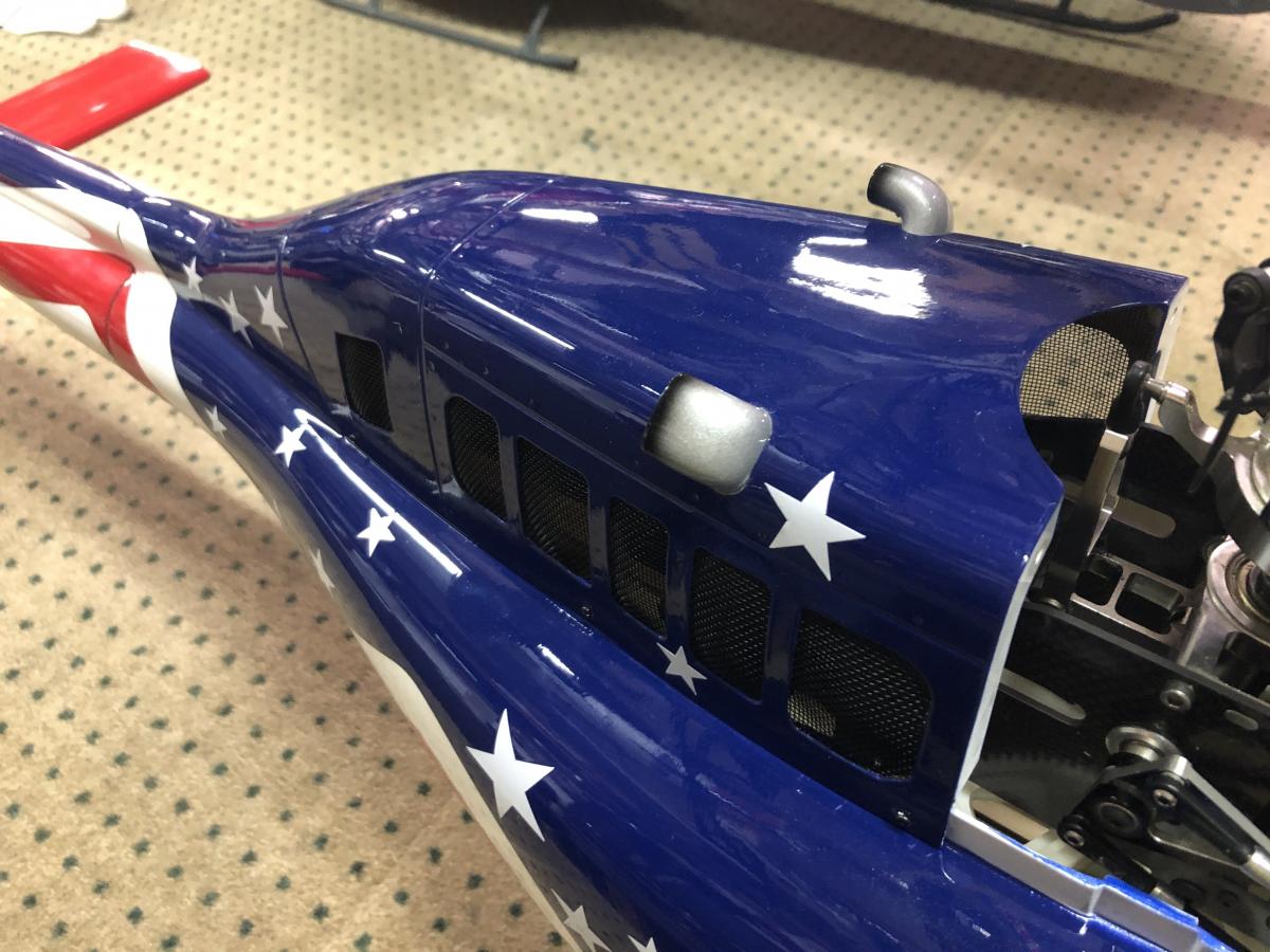

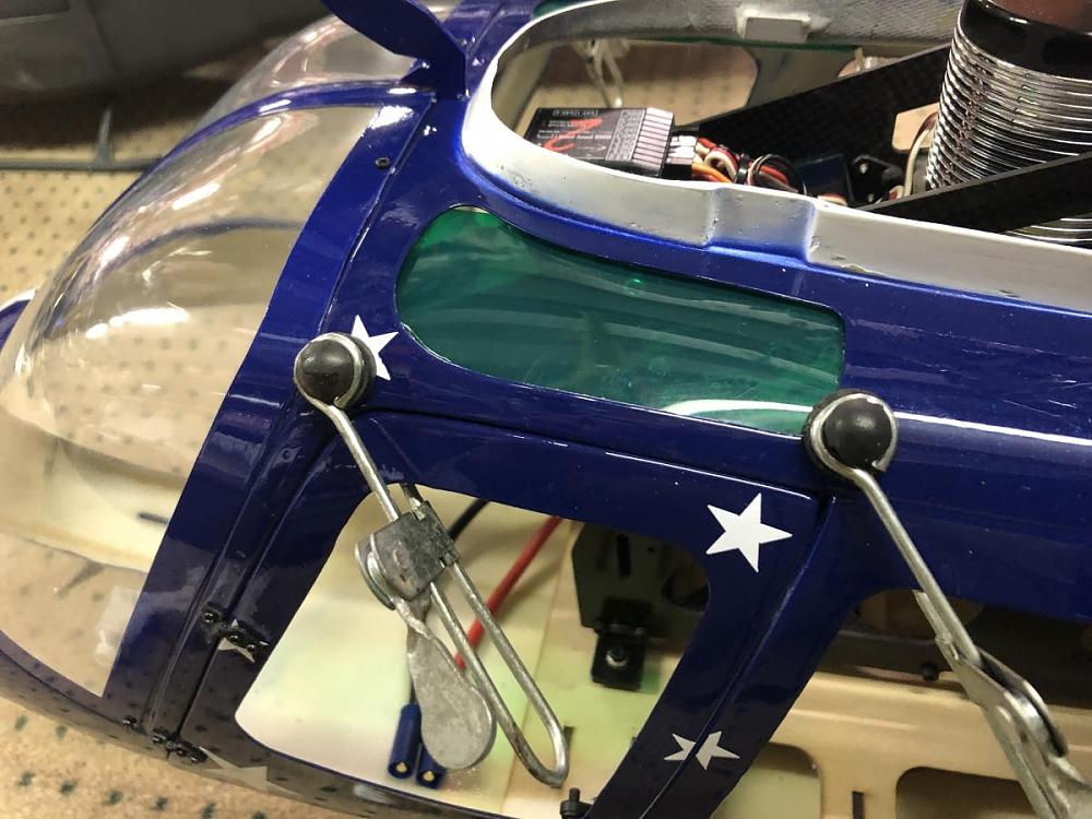

            Installed the wire cutters and started buttoning up the fuselage.

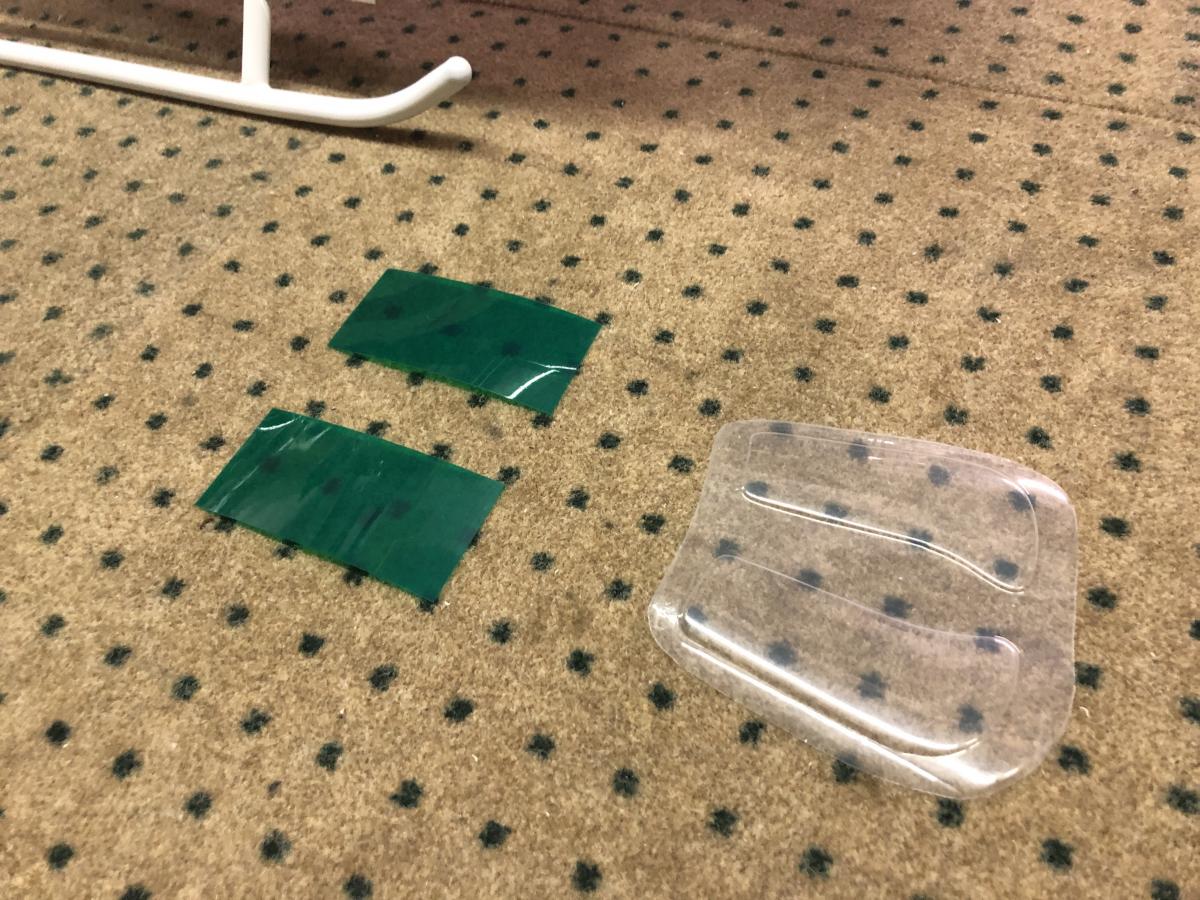

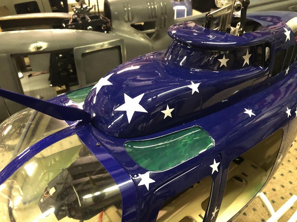

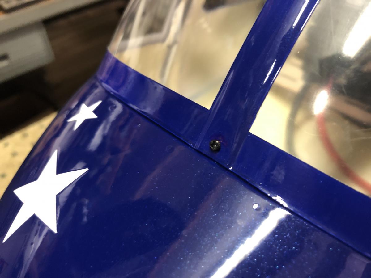

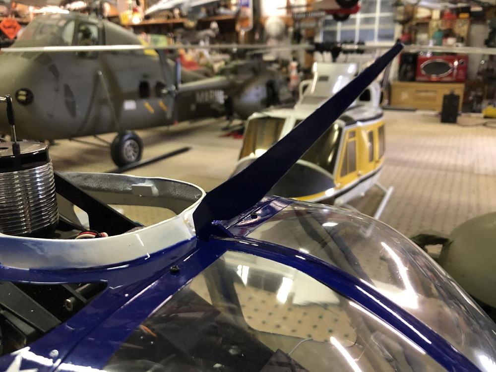

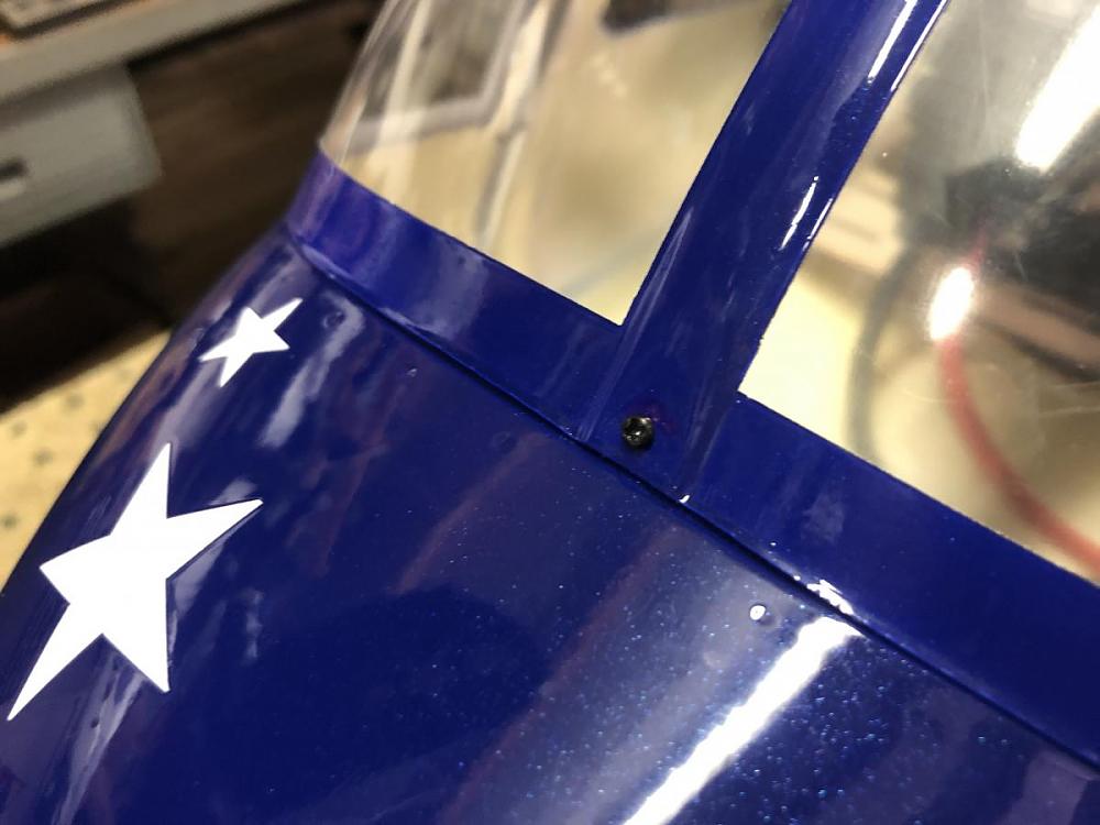

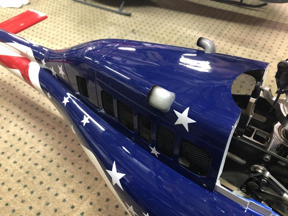

            Installed the windshield (fit was perfect) and opted for some tinted styrene on top, I'll wait on the side windows.

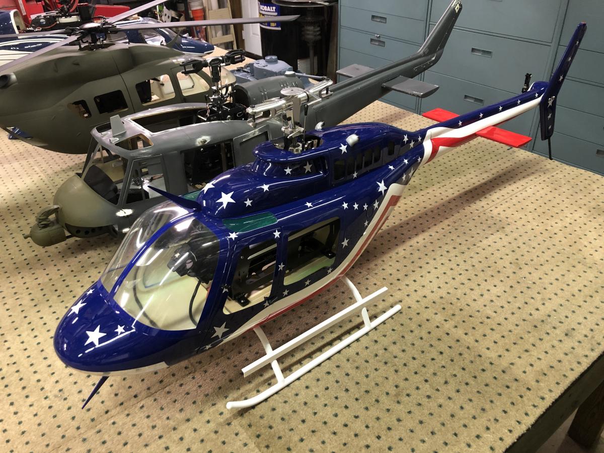

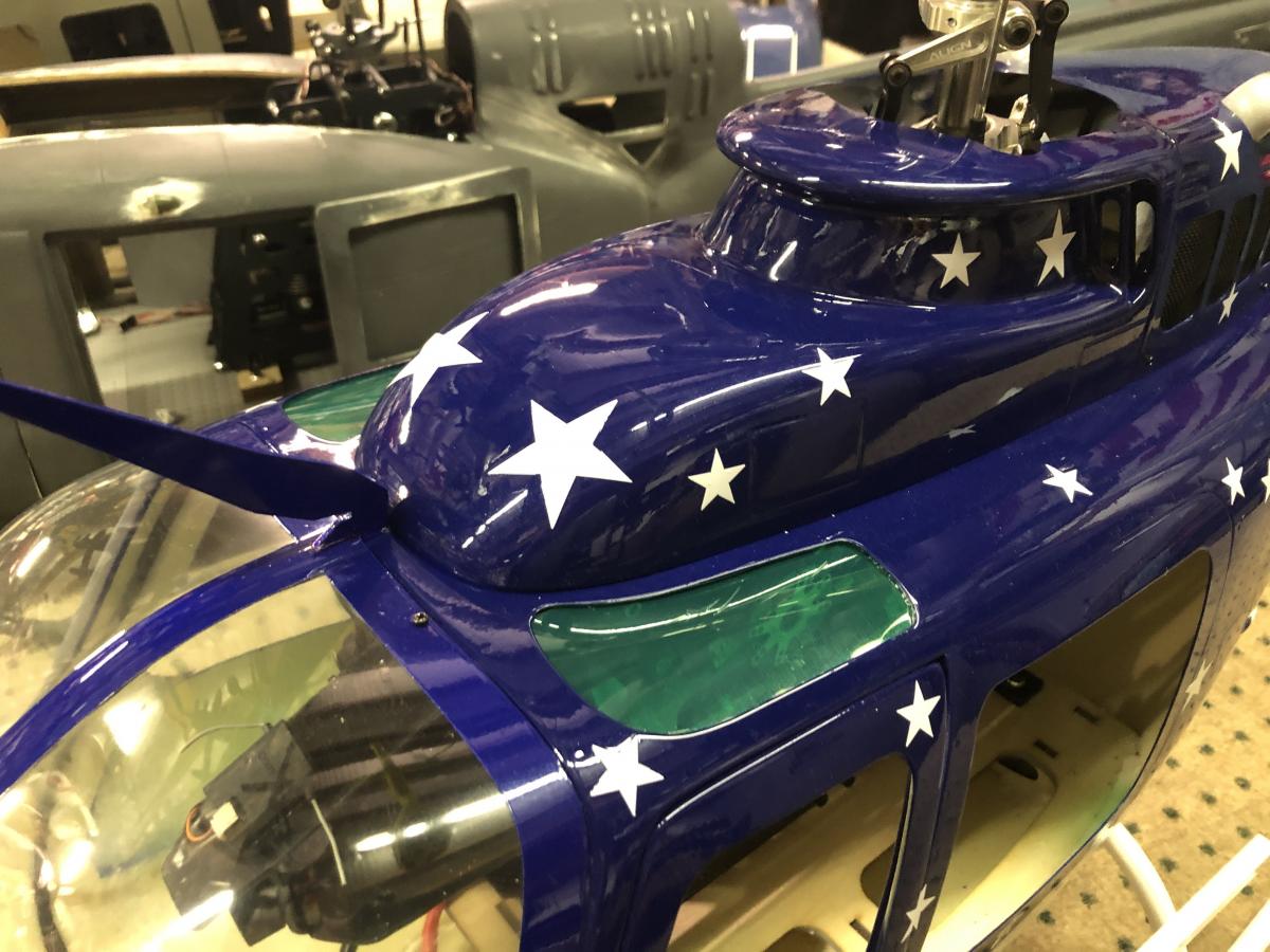

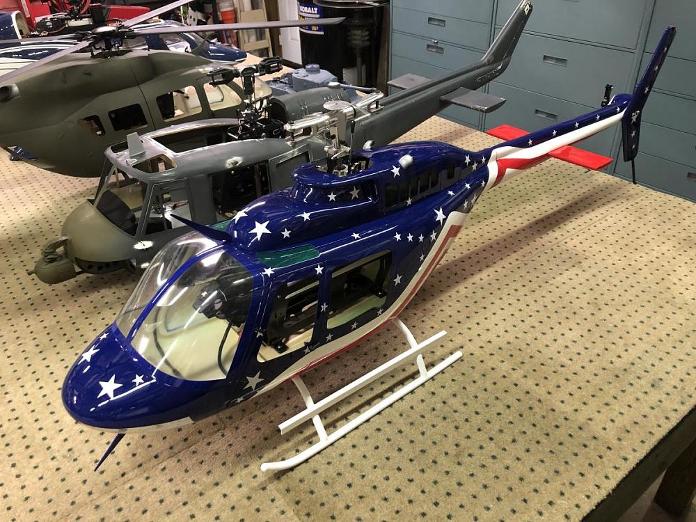

            She's one sleek looking bird and the paint is beautiful, I can't wait to get it out on a sunny day.

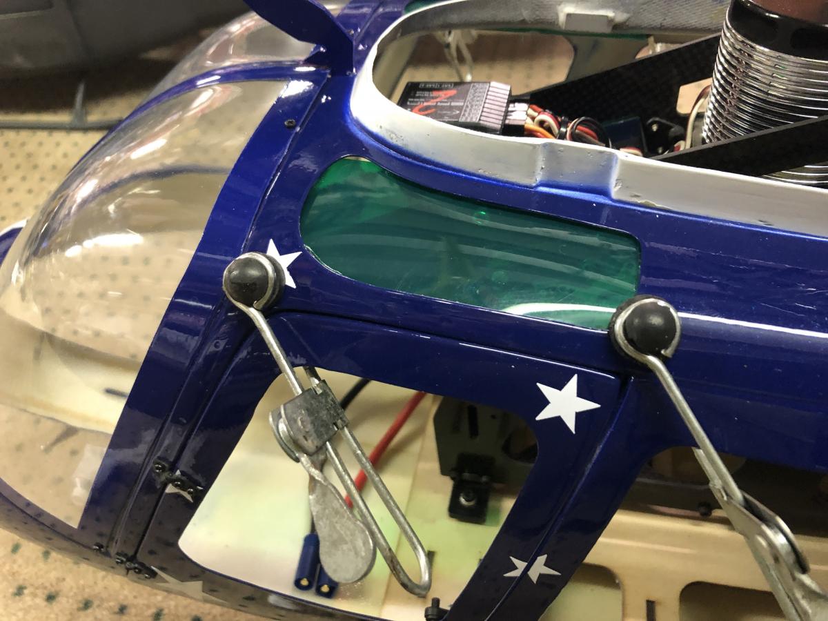

                Looks awesome. A couple of questions. Do the the mechanics sit out (height wise) enough, I have seem some other builds where spacers were added for a more scale look, making the swashplate sit higher up? I have seen a few where the head is very close to the body Do you think mounting the mechanics directly to the wood will be okay for vibrations or would it be better to adde some rubber between the wood and mechanics? Im really interested to see how the batteries will mount with CG and the maiden!
                  Those rubber footed scissor clamps are so handy! I need some of those! My plastic clamps don't have the reach.
                    Originally posted by Ryanmlt1 View Post
                    Looks awesome. A couple of questions. Do the the mechanics sit out (height wise) enough, I have seem some other builds where spacers were added for a more scale look, making the swashplate sit higher up? I have seen a few where the head is very close to the body Do you think mounting the mechanics directly to the wood will be okay for vibrations or would it be better to add some rubber between the wood and mechanics? I'm really interested to see how the batteries will mount with CG and the maiden!
                    I think about 4mm under the supplied adapter bracket will be all you could raise it, I have some hard rubber spacers I may try. I plan to run two Admiral 6S 5000 in the frame towards the front, if I go with an interior I'll mount them outside the frame one on each side.
