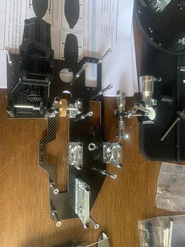

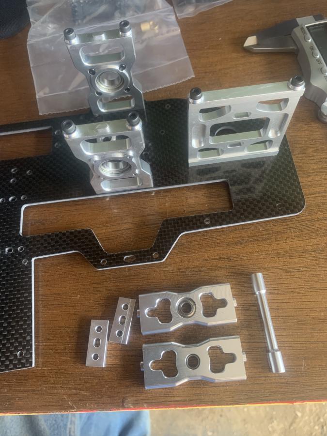

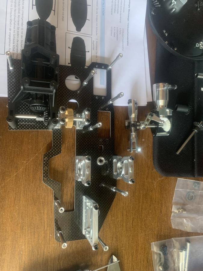

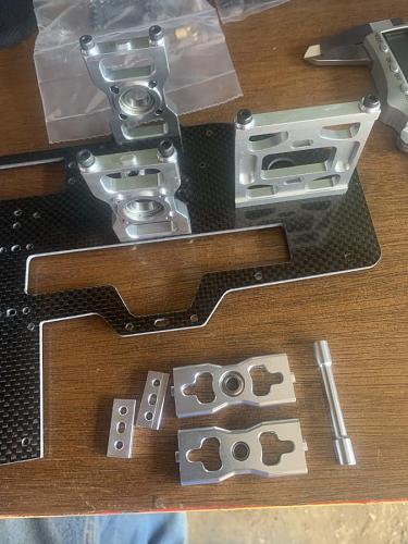

                                Started mocking up my kit this morning and see that since I am using 54mm phoenixtech 600 esp mechanics they are wider than trex by 7mm. Included in the kit were two 3.5mm spacers for the tail shaft bearing blocks. ( still need two more for other frame side) and I would need 18 3.5mm spacers to go between all of the frame spacers included with the kit. Any thoughts? Thanks! Click image for larger version

                                  So they didn't include what you need, I thought they would have got that right by now with all the complaints about it, your going to have to contact MRC and talk to Ed, he is the one who has been dealing with this issue, see what he says or open a ticket with MRC and see what they say.

                                    That fuselage kit needs to be updated with the right spacers because that kit is really made for the old Trex 600E or ESP version with the 47mm width frames.
                                      Thanks! I will jump on that! I’m going to make a list of everything it needs and let MRC know. This is the kind of things that make new builders Leary about buying these kits.

                                        Exactly, I thought they updated it by now with the right spacers, they say everything needed to convert your 600 using the included side frames and all that jazz,, so why are those spacers not included???
                                        MRC you need to get on this if your going to continue to sell these kits, the Pheonixtech 600ESP is the heli you carry and recommend for this project, yet the spacers that are needed to convert the 600 are not included for this.............
