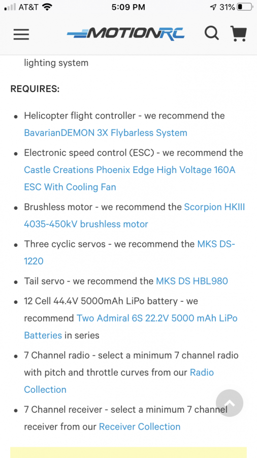

          Lol and yet 450kv is the motor Motion recommends.
          sounds like they need to update their recommendations for this bird.

            The problem I have with that is, the 450kv is the recommended motor. You are supposed to be able to run a head speed around 1000 to 1200rpm. I'm checking my pitch right now to make sure I'm at 0 pitch at half stick and 11 at full.
            I'm using the new spektrum flb controller so I have some tuning to do tomorrow. I need to adjust my PIDs.

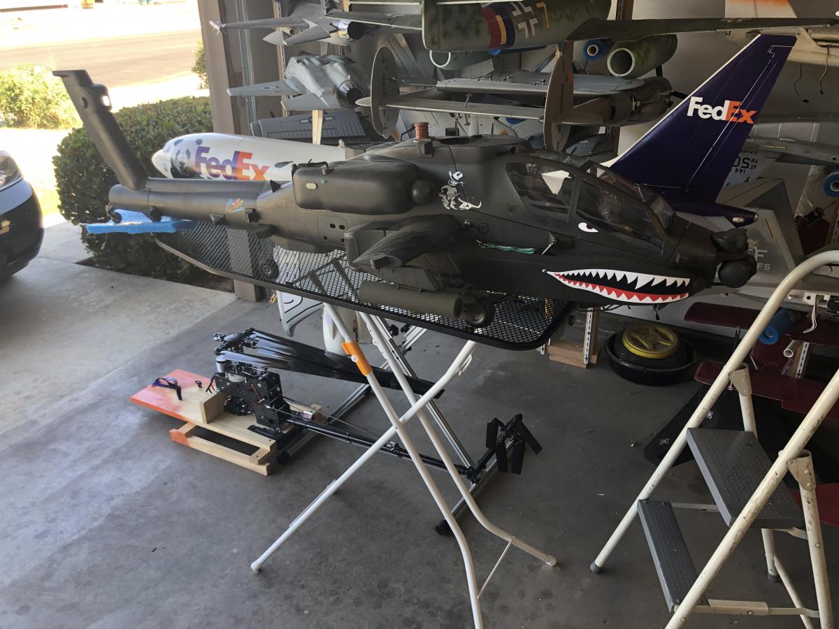

                                    Yeah I forgot to come back and post but the 510kv feels real good. I ended up with 30% headroom. I was at 20% but could hear the blades free spinning at times while the governor was backing off. So I backed off a bit in the head speed and that went away.

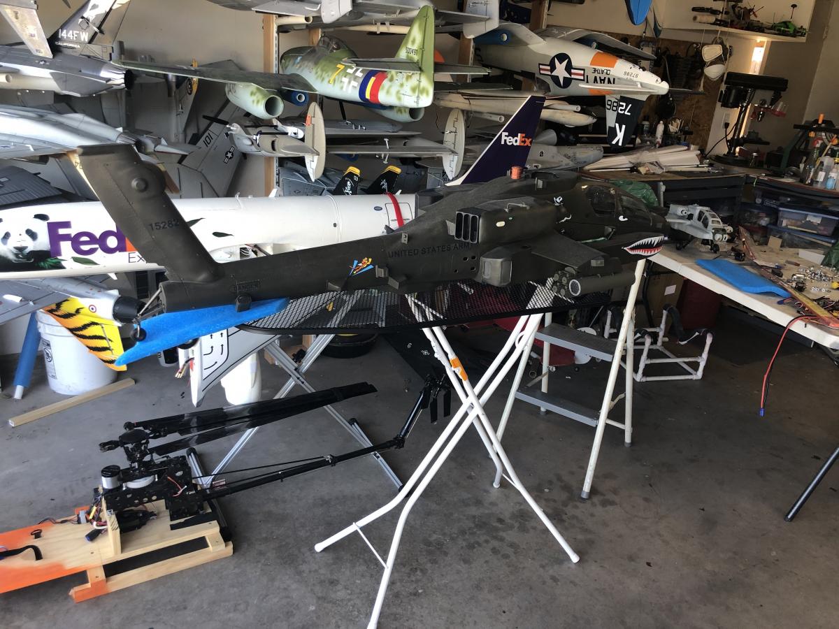

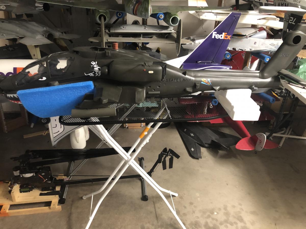

                                    alao I’ve been working on a plarfoarn that will added in transport, assembly and tear down. I still have some things to mod on it I.e. couple carrying handles, Foam riser and strap down for the back and couple wheels so I can roll it around a little. But iron board is a great start.
                                    Gravy

                                        Nice flight Gravy! Looks awesome. I like your ironing board idea, too. Reminds me of the old Ferno EMS stretchers that would fold their legs backwards as you pushed them into the ambulance.
                                        • #40
                                          Thanks. Yep that’s why I picked that ironing board. It makes loading and unloading out of my van really easy.
                                          best $45 I spent in this helicopter.
