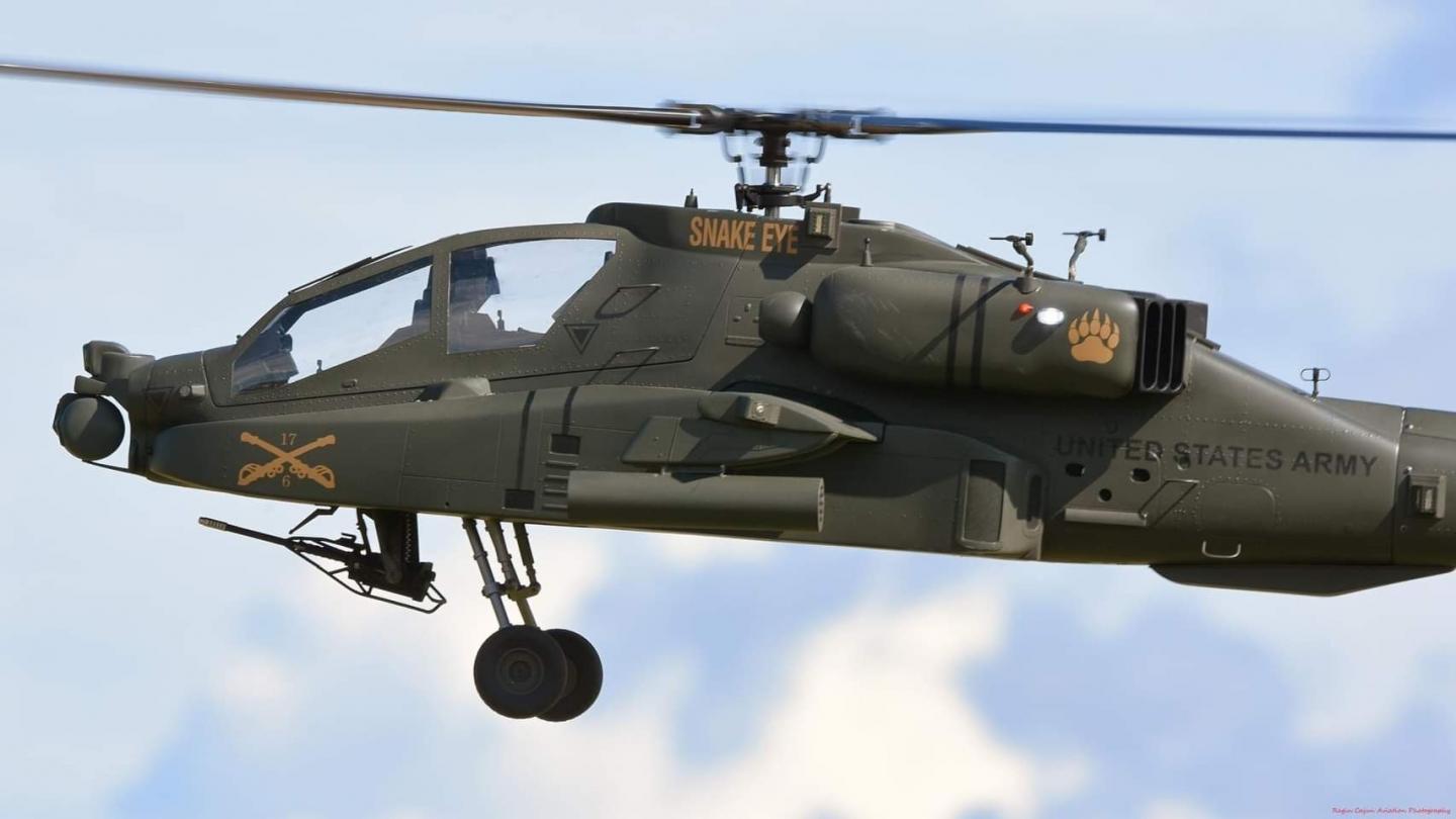

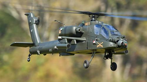

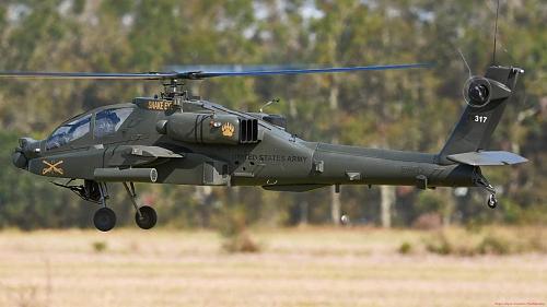

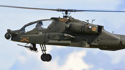

        Teaser from today's AOA fun fly
        • #44

          • #45
            Looks awesome, between you and Gravy showing his off, I might have to build me one............
            • #46
              You wont be disappointed. If you do, make sure you beef up the landing gear mounting points.
              • #47
                Looks great. Man I do love how she looks in the air.

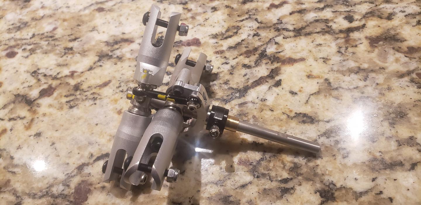

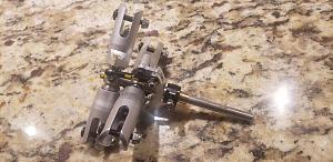

                            Got my cascading tail today from Michael Brown. It’s a thing of beauty. All I need is my 20Amp bec for my test setup and I can start testing it out again to see if the tail vibration is gone.
                            Gravy

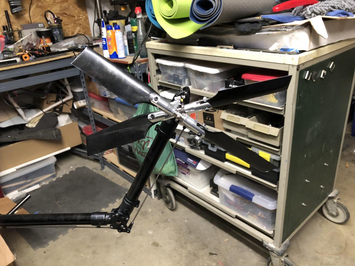

                              Michael Brown is the man.
                              Recieved my cascading tail. Now off to paint and fly this weekend.
