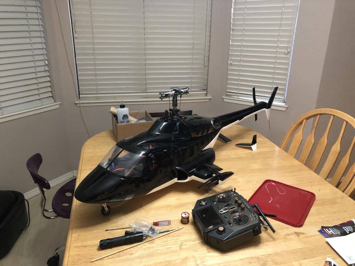

    Well she’s ready to stuff the bird. Got two great flights on the mechs today. She runs smooth and will even be smoother with the extra weight.
    8s was the magic number. Motor temp was 90f after 5 minutes of flight. I’m running with 45% head room, more than I like but esc was nice and cool too.
    so now to put her in her new home.

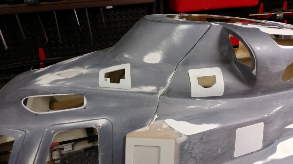

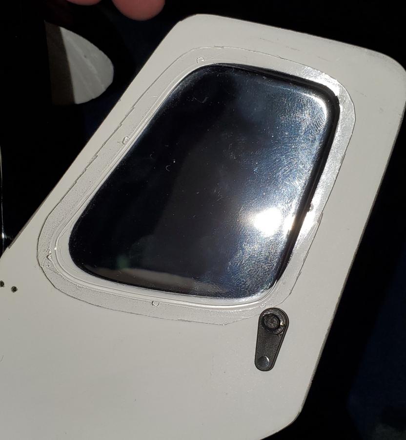

            I'm working on one of these right now myself. I have a question - the windows for the doors do not fit in the window opening - they are too big. What did you do to make yours fit other than just simply trimming them to fit. All of the other windows fit in the openings ok.

              Didn’t get windows for my doors. Honestly I didn’t pay attention and just thought it didn’t come with them by design.
              now I need to decide if I want to buy the spare parts window or just leave them off.

                I'll try and get a couple pictures of those windows, they don't fit into the openings, the raised window portion that should sit down into the opening is too big. If they are all like that you might want to just save your money and not buy them. I think mine were all packaged together, but if you still have you box it came in check to see if they are in there.

                    Here is what they look like. Way too big. Think I'm going to leave them out as well for airflow.

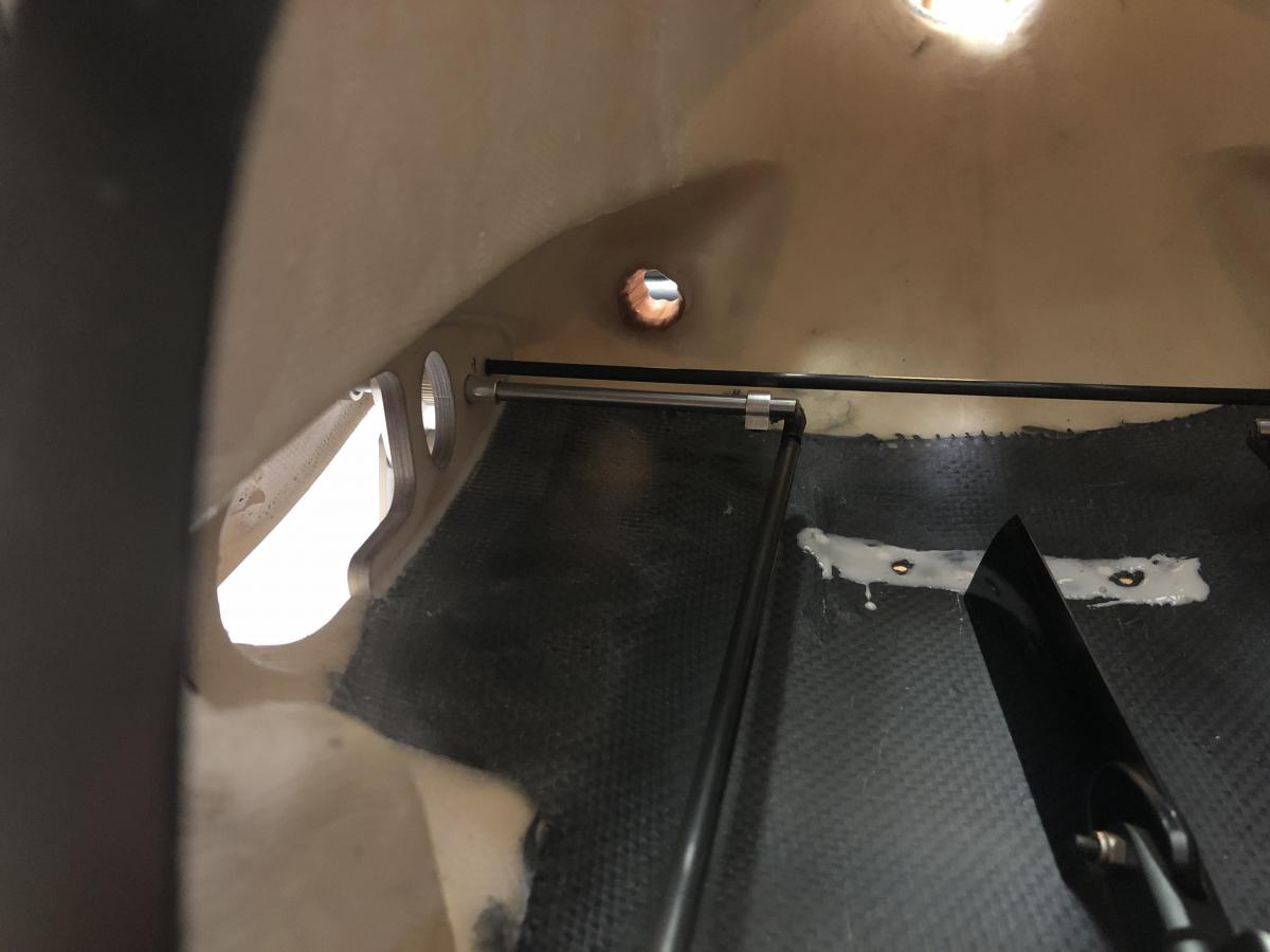

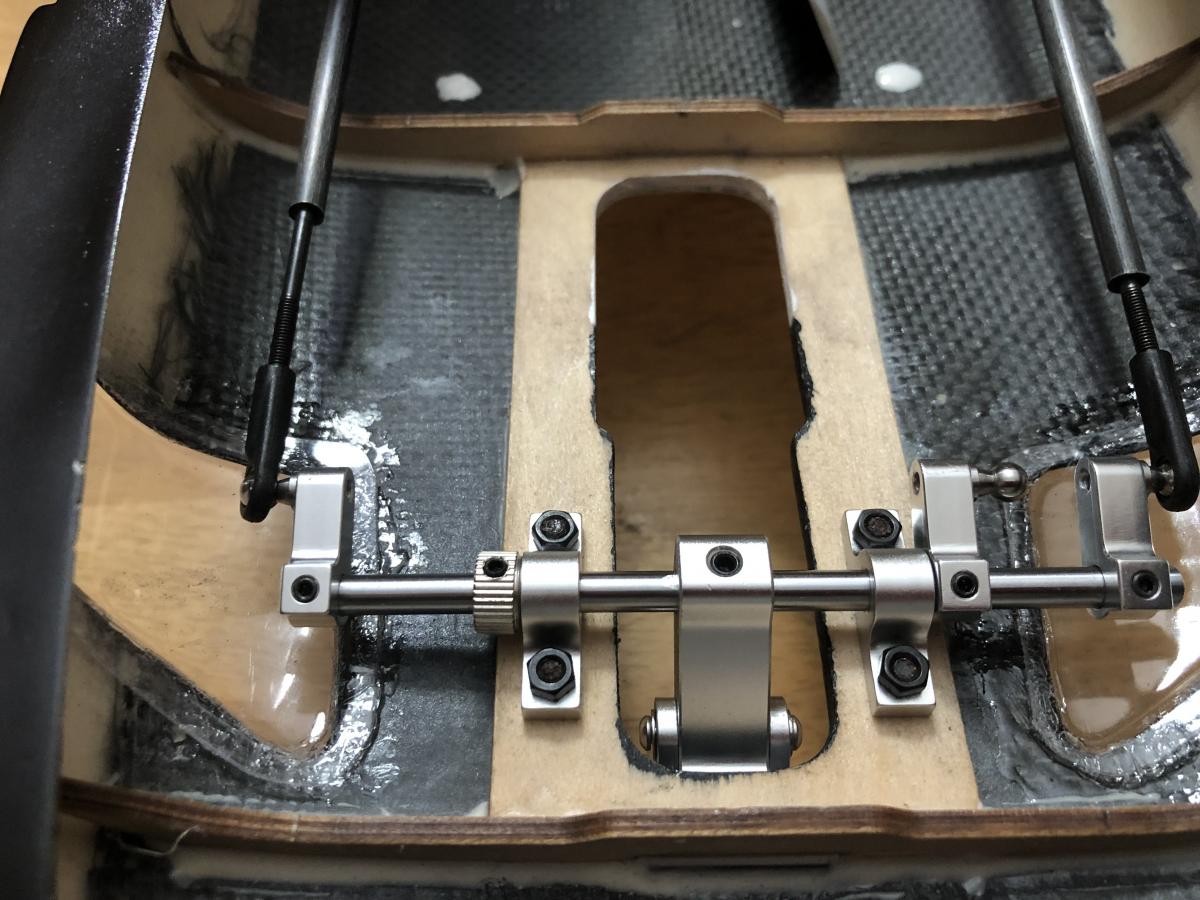

                          So last time I took her out to put her through the paces, the gear gave me nothing but issues. So I decided to do a whole gear overhauled. All three CF rods are changed out now with new steel rods. I still need to grind in some flats for the grub screws but on a dry test it’s now butter smooth. Second I will make the gear ridged. No more shock spring. I decided to do this as I got some major ground resonance while the aircraft was in the spring range during both take off and landing. Also she just squats down to low when the gear compresses.
                          Hopefully this takes care of my LG issues.

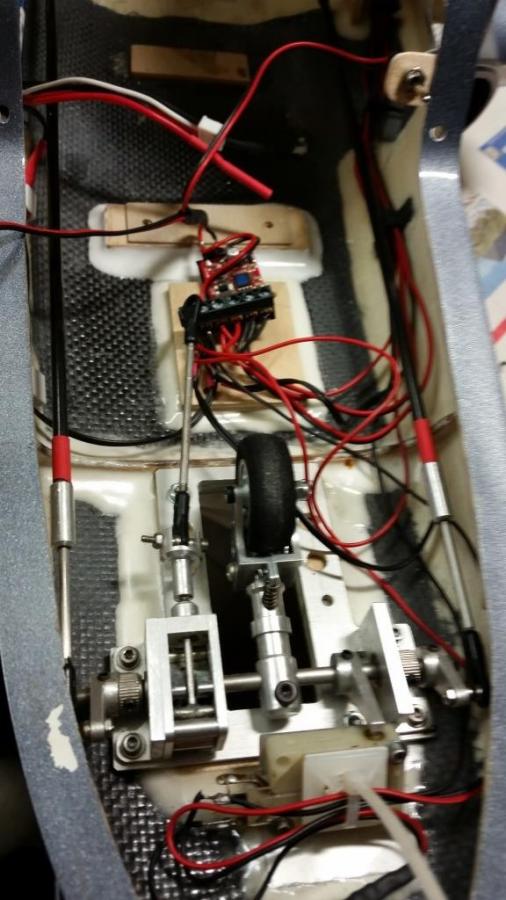

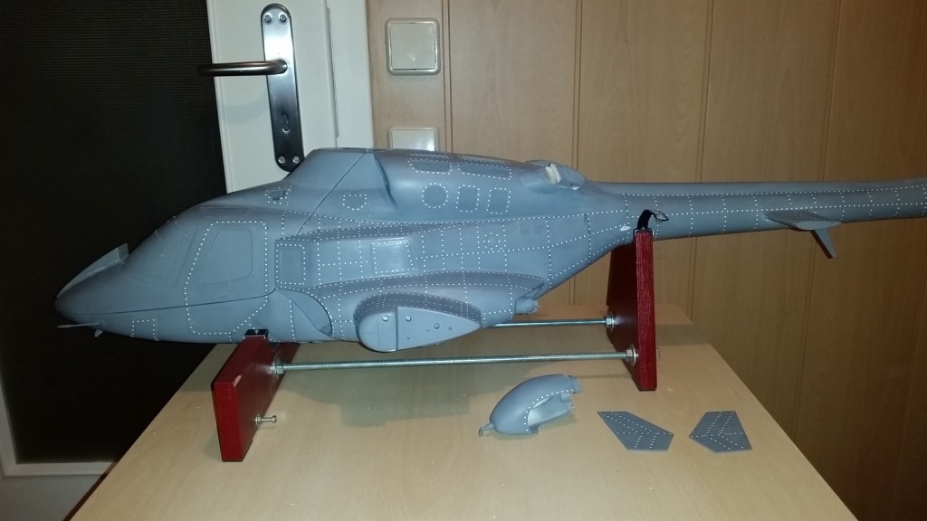

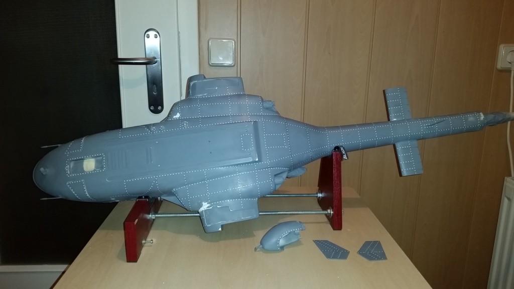

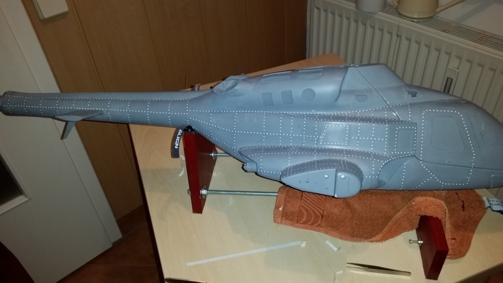

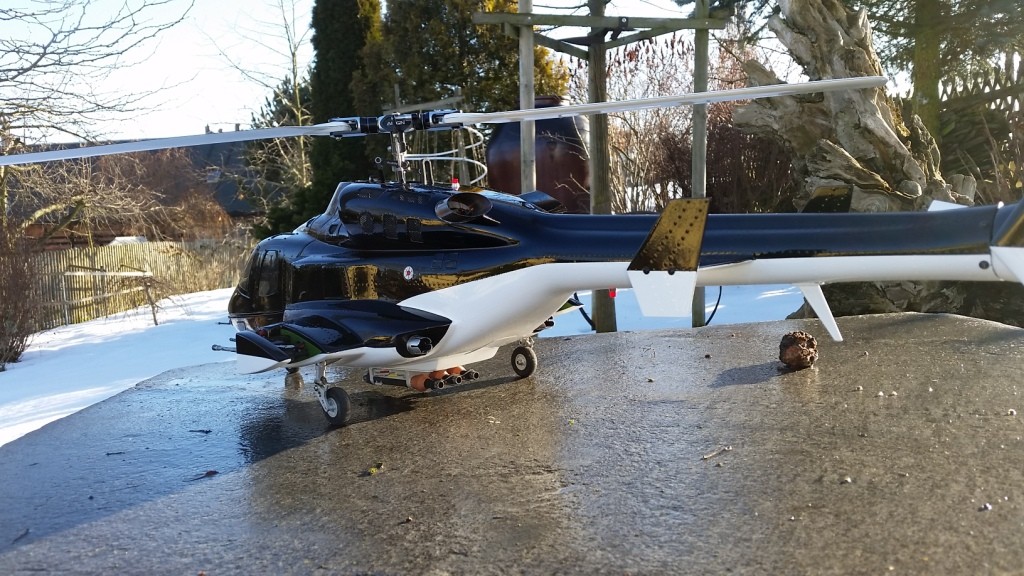

                            Hi!

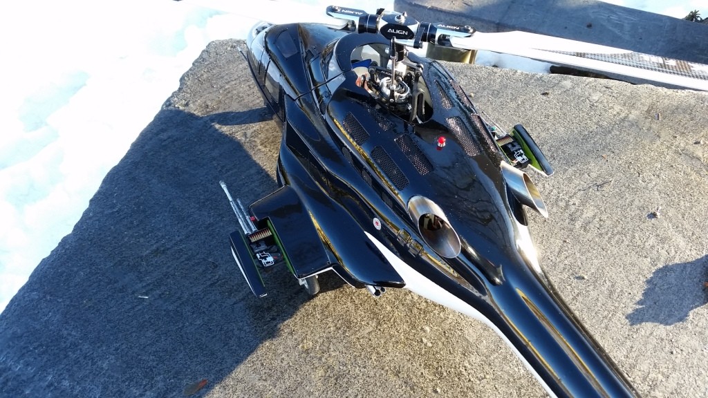

                            The landing gear maks also a lot of trouble in my 500 Airwolf. After a crash I made it a little more scale. The gear locked in both directions, so the servo is without
                            pressure. I builded in some ballrings and reinforcement for the axes.
                            Jens

                              Your rivets look pretty good! Did you free hand those, or perhaps used a rivet strip?
                              • liberoreiter
                                • Nov 2020
                                • 9
                                • Greiz, Thueringen,Germany
                                #35
                                It's self-adhesive film , cutting by Laser 1,5 mm, distace 4x4 mm. I cut it in stripes how I need it.

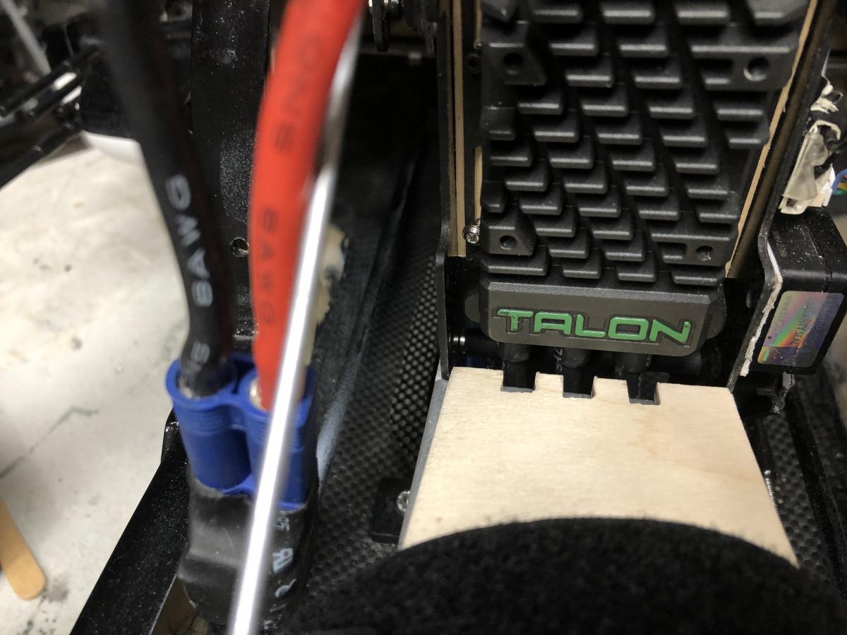

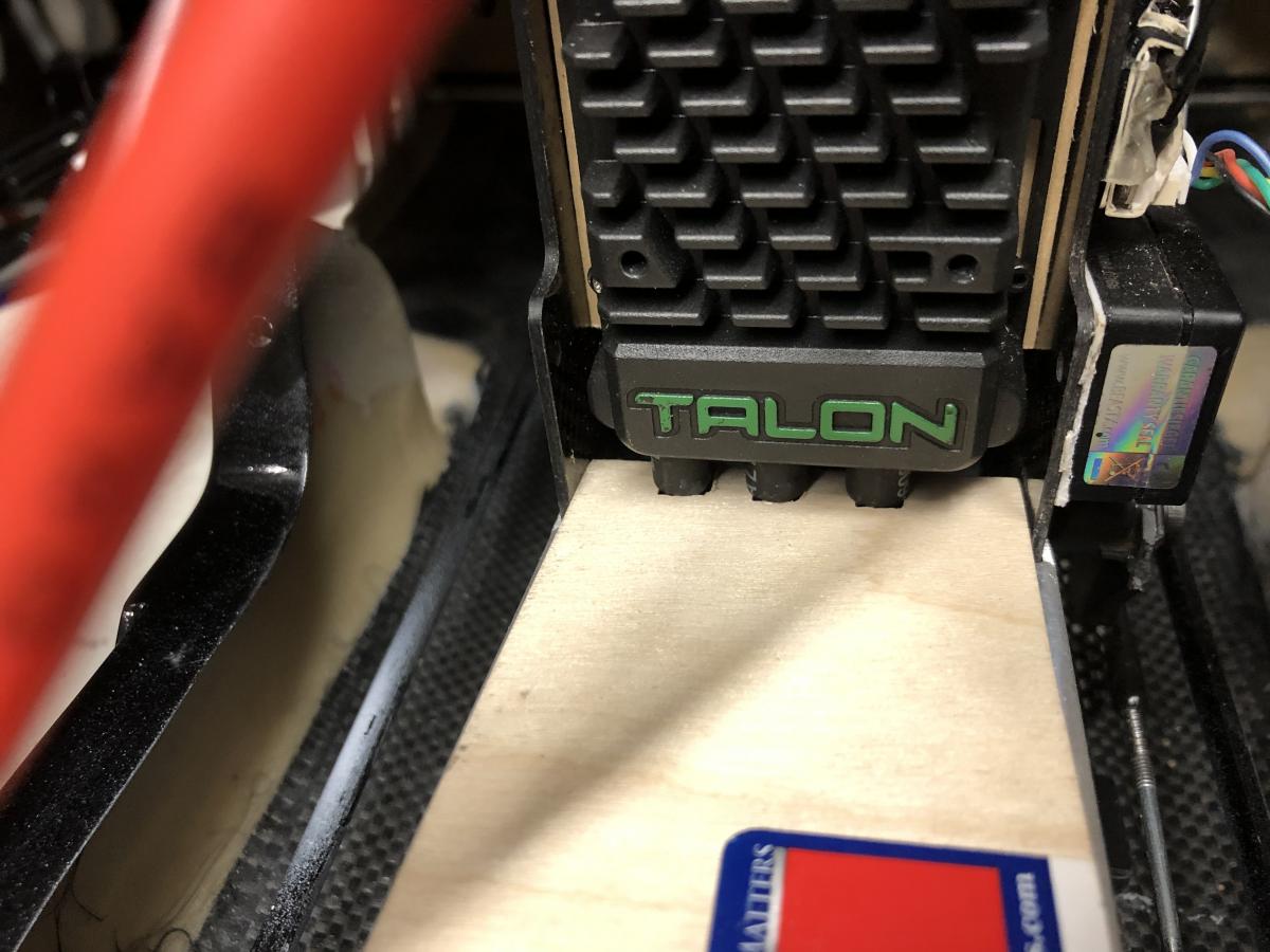

                                  Got her all back together and did a test hover and gear check Sunday. It could have ended very badly, but luck was smiling on my.
                                  Everything went smooth. Gut her started up and lift off nice and gently. Did a few gear up / gear down with no issues. Did some side to side and yaw left yaw right. All went smooth. About 3 minutes into this I thought about taking out for a run but finally decided on just set her down. As I was about 1” -2” off the deck, the motor just died. WTF! She set down all sweet and just finished coasting to a stop.
                                  Motor and ESC not even warm. Tried to restart it but she just stuttered. Took her back to the pit for closer inspection.
                                  one of the motor leads came out of the CC HV120.
                                  So many things went through my head at this point.
                                  so I made a lead lock. This should never happen again.
