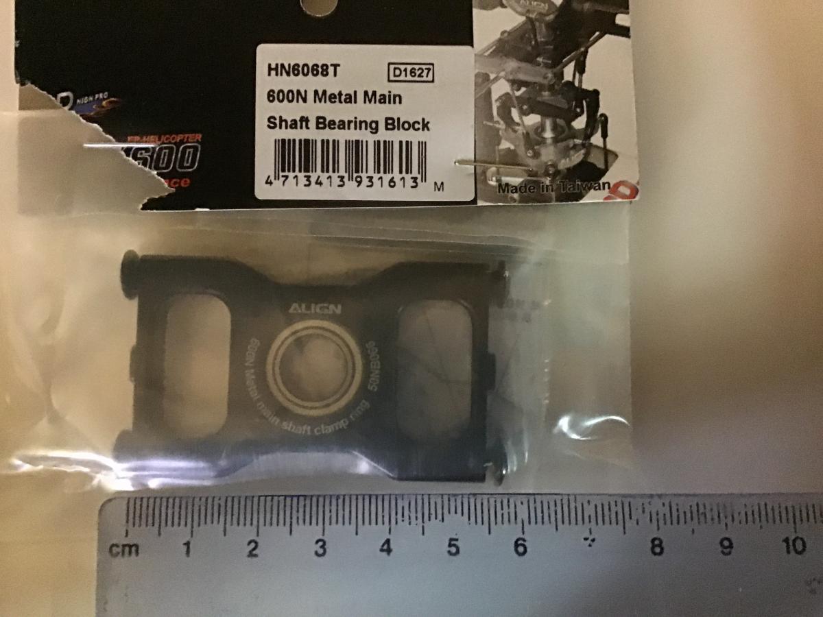

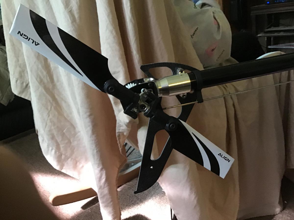

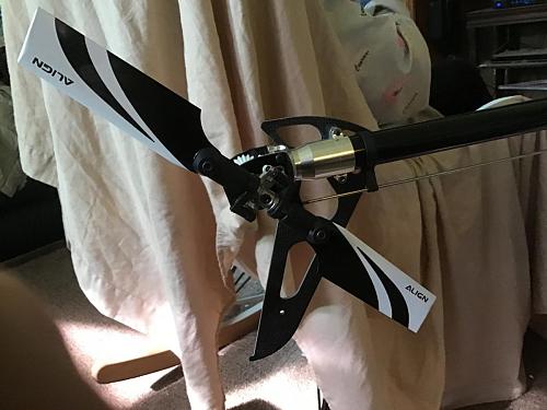

        To follow up on Phoenixtech 600 ESP parts: Due to the wider frame spacing of the PT 600 ESP vs the Align 600 ESP the Align 600N (Nitro) main shaft bearing block is a direct drop in fit for the optional Phoenixtech 3rd (lower) bearing block, which has proven to be impossible to find in the U.S. so far. I gambled & ordered a pair of the Aligns (HN6068T) from AMain & even the mounting ears/holes fit without filing. I also replaced those Freddy Kruger tail blades with something more respectable for a man of my golden years.

                I couldn’t locate a 9x19x5mm bearing to replace the 10x19x5mm one in the Align bearing block I bought so I tried several things. My solution is a 6x10x6mm self lubricating bronze bushing drilled out to 9mm then JB Weld(ed) in the bearing. A flanged bushing would probably work also. I’ve read some folks have reamed the bearing block out to 20mm for easy to find 9x20x5mm bearings also.
