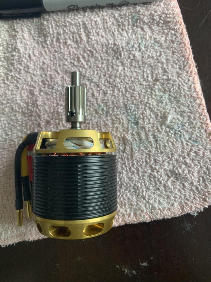

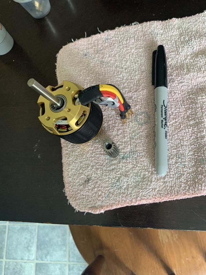

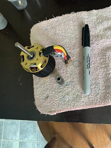

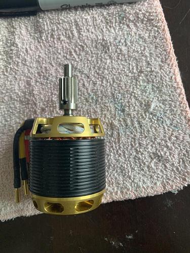

    Well, it worked out well. Chucked it up in drill press and opened up closed end. Click image for larger version

    That is awesome, my pinion gear cracked the last time I tried that.....
      I used a new drill bit, slow RPM, and cutting fluid. Surprising cut very well!
