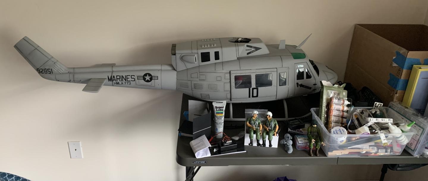

              Does anyone know of another make/model of 600 size heli that is available and will work in Roban UH-1 600 size??
              I went with the 600 but now wishing I did the 800 which comes with all the mechanics.
              as of now I have a real nice (but expensive) static UH-1N model that’s as far as I can go with no donor 600.
              I can’t seem to find anyone else who sells the phoneixtech 600ESP. Motion RC could only tell me to click link and enter email to be notified if back in stock, and no idea if/when they will be 🙁
              Click image for larger version  Name:	IMG_5018.jpg Views:	0 Size:	76.3 KB ID:	403181

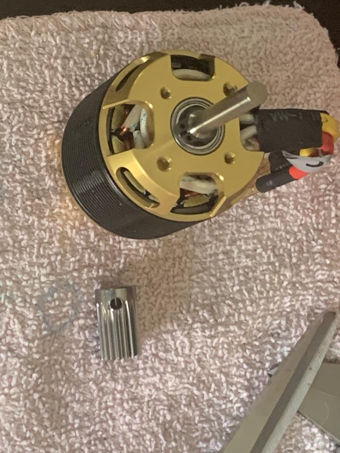

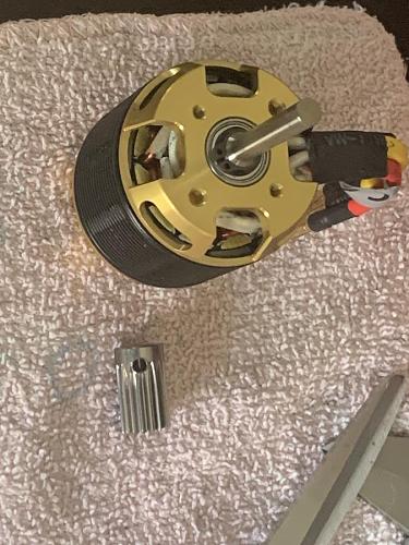

                              #34
                              Well, got the motor from Motion RC for the 600ESP (for my Roban UH-1). It’s a Scorpion HKIV 4025-1100Kv.
                              The pinion that came with kit is correct diameter for the motor but does not fit up on the shaft to allow set screw to hit flat spot on shaft. Seems the pinion should have bore all the way through??
ID:	403790 Click image for larger version

                                #35
                                Well unfortunately sometimes you have to custom fit those, I've had to do several myself, cut the shaft down the size you need and make a new flat spot.

                                  #36
                                  Ugh. Well another surprise. Feel like I am scratch building versus a kit. Well good experience but next will be a 800 or other type kit which has all needed pieces and designed all together.

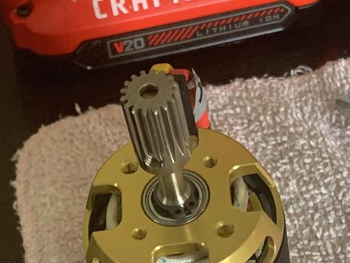

                                  • DLHam3463
                                    • Mar 2024
                                    • 28
                                    #37
                                    All it needs is the closed end opened up to allow gear to slide up on shaft.
                                    so may try that…..

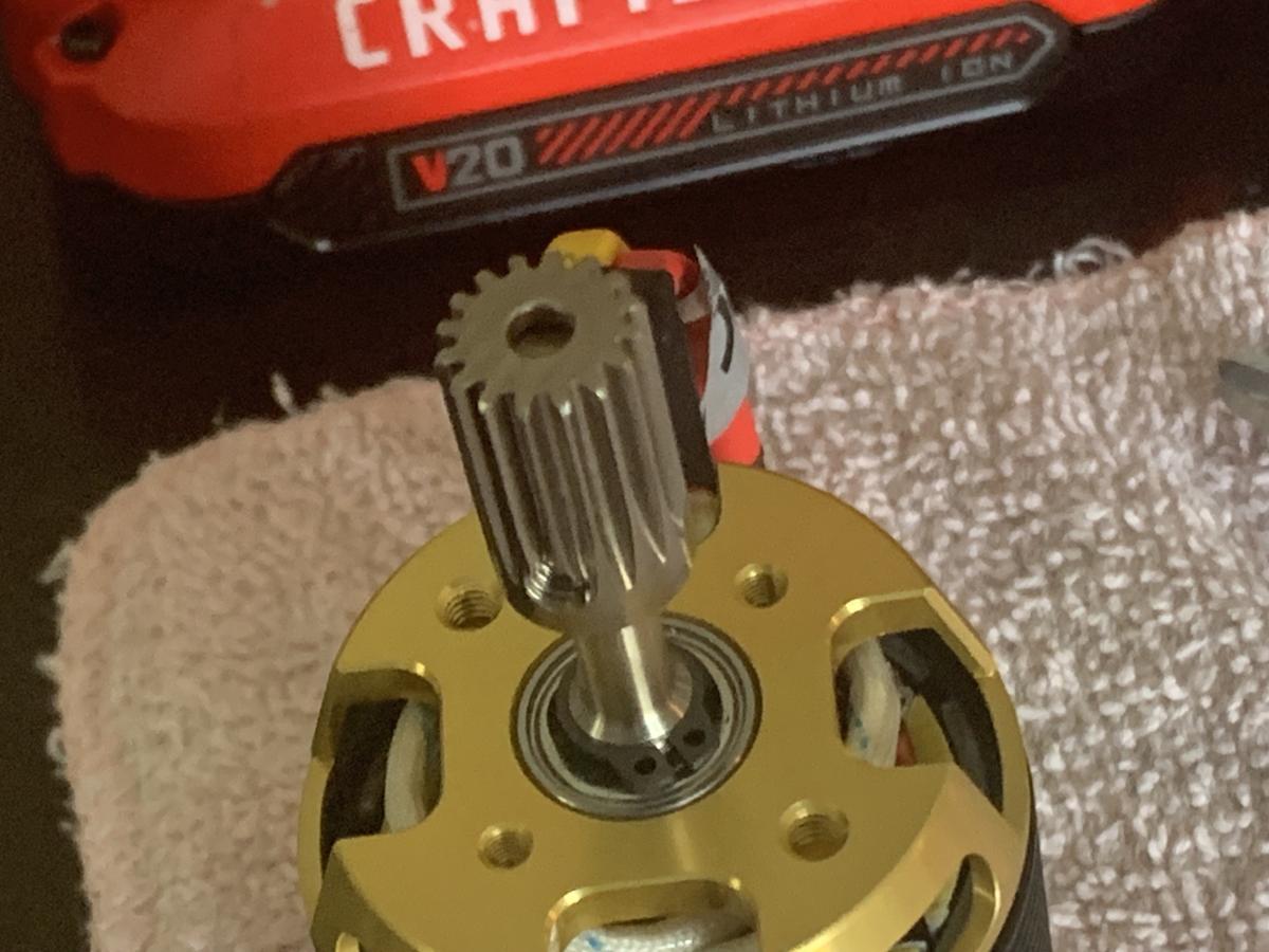

                                          #40
                                          Let me know if you get that to work, I haver tried to do that but those pinion gears are hard stuff and I could never get one straight, its really no big deal to cut the shaft and dremel a flat spot. I haven't bought a Scorpion motor in awhile but I think you can get replacement shafts if you mess up, you might want to check on that before you cut it though.
                                          Well, it worked out well. Chucked it up in drill press and opened up closed end. Click image for larger version
