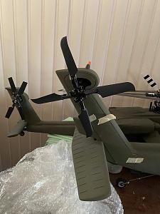

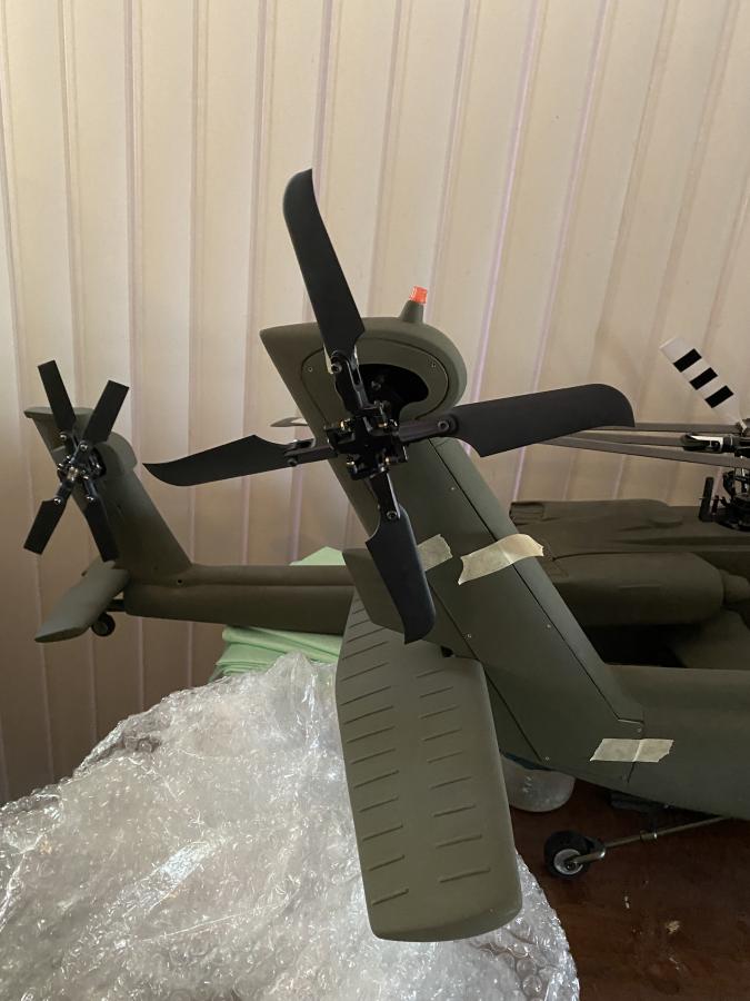

                    Was kinda worried the 4 blade tail assembly I ordered from Roban would be too large since it’s the same one used on the 700 size UH-60 (5mm shaft for both) but it’s fine, I think. It’s just sitting loose in the opening for the pic and will be higher when mounted. Click image for larger version

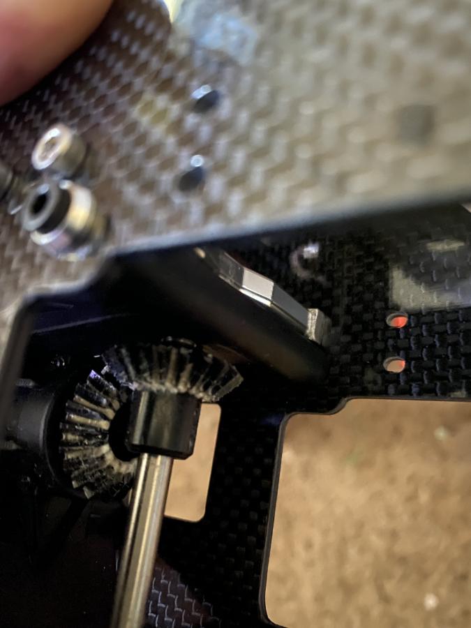

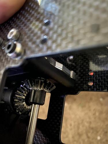

                      With the spacer/bearing block issue resolved was time to set the tail transmission umbrella gear mesh. This job is more complicated than normal because the entire transmission and both bearing blocks must be removed from the frame each time a shim is added to recheck the mesh. This is because the bearing blocks support the vertical drop shaft and can’t do so outside the frame. Using the supplied metal umbrella gears (recommended!) it took 6 shims to set the mesh correctly. I use white lithium grease on both gears to help visualize how the teeth are meshing as I turn the rotorhead. I will continue the lithium through my early test runs under power then switch to a higher viscosity grease when everything looks good. Click image for larger version

                        Luckily, the 4 blade tail rotor assembly from Roban had been shimmed correctly at the factory so I didn’t need to address that. The torque tube elbow gear box cannot be shimmed, so time to test assemble the long and short torque shafts and tubes and mount the tail rotor. Everything feels smooth with the normally expected small amount of play in the tail blades from the elbow gear box and torque shaft spline clearance.

                            I add shims until I can just feel a very little back and forth play in the horizontal (main torque shaft) gear. I hold the autorotation gear or main rotor grips firmly with one hand, then reach inside the frame to see how much I can slide that horizontal gear back and forth. Should just feel enough to know it’s moving. I would add another shim if it shows more play over time…it will feel “locked” if you add too many. The white lithium will accumulate at the base of the teeth if set right but will be forced out if too tight. Never tried honey grease but sounds good. I use Lucas gun grease but it does fling off more than I like so hafta keep an eye on it.
