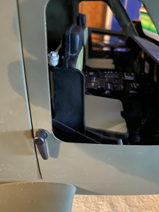

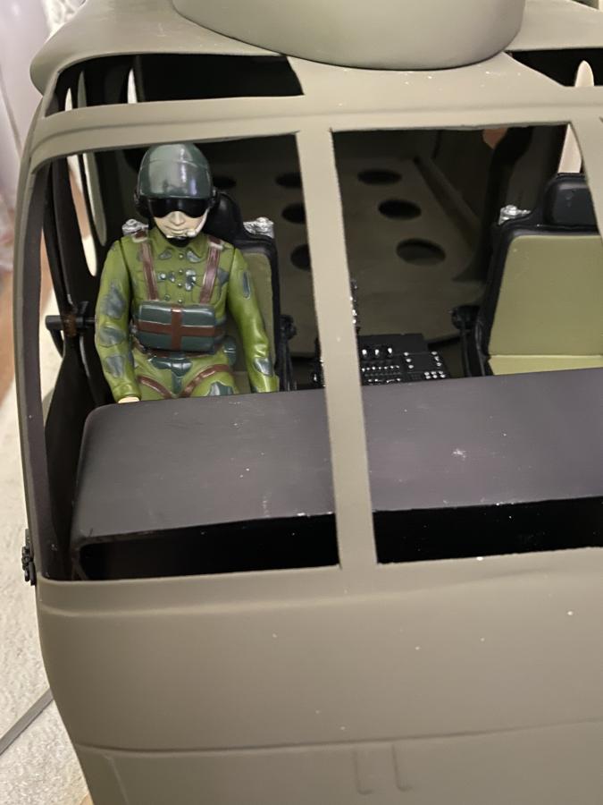

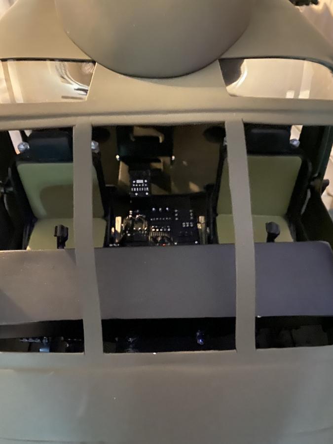

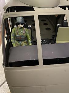

Did you buy the optional cockpit from MotionRC. I can't seem to find it from their website. A link will be helpful. Thanks.😀Originally posted by PawPaw View PostThe optional cockpit kit is very nice and an easy install in the big fuselage. The included pilots, however, are not, so I will decide later if I want to hunt 1/10 scale figures or just leave the seats empty. The windows are typical Roban quality and fit their openings well. I used Gravy’s carpet tape trick for the chin windows, which worked great. I used hot glue for the other windows and for the cockpit install. Holds good and easy to remove if needed. NOTE: All Roban kits that have DIY install windows have a thin plastic film on both sides of the part that peels off nicely. Easy to miss if didn’t know it was there.

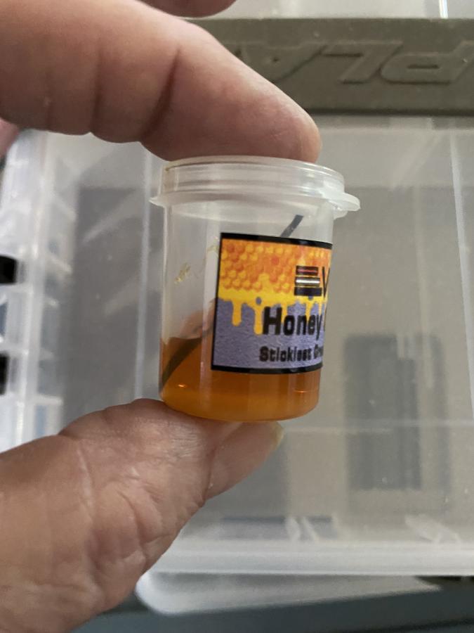

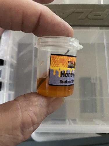

I have shimmed all my big ones so far but just curious what you go by to tell you its properly shimmed??? I really don't know myself, I just add shims until I get the outside edges on the gears to line up evenly, seems to work but my Apache that I got from Gravy has developed more slop now that I have several flights on it, he had problems right from the start and since my purchase, I have added more shims, I think its hopeless really getting them perfect but my worry is when does a person replace them to be safe?? I use honey grease on mine, stuff is sticky and seems to be working good, I grease every two or three flights.
