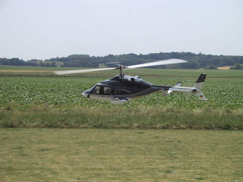

    my old helicopters:
    a Bell 230 benzin

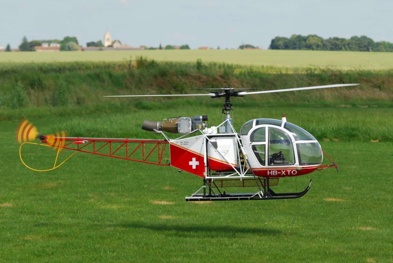

    A big Lama Benzin

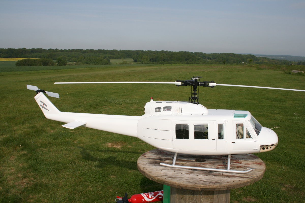

    A turbine UH1-D
    So I bought one of the latest kits from Scaleflying, a UH1-D army version.
    But I have a big problem: the absence of spare parts in Europe, do you have this problem in the USA?
    ​​​​​​I just placed an order directly with ROBAN:......wait and see....
    I will keep you posted on the results.

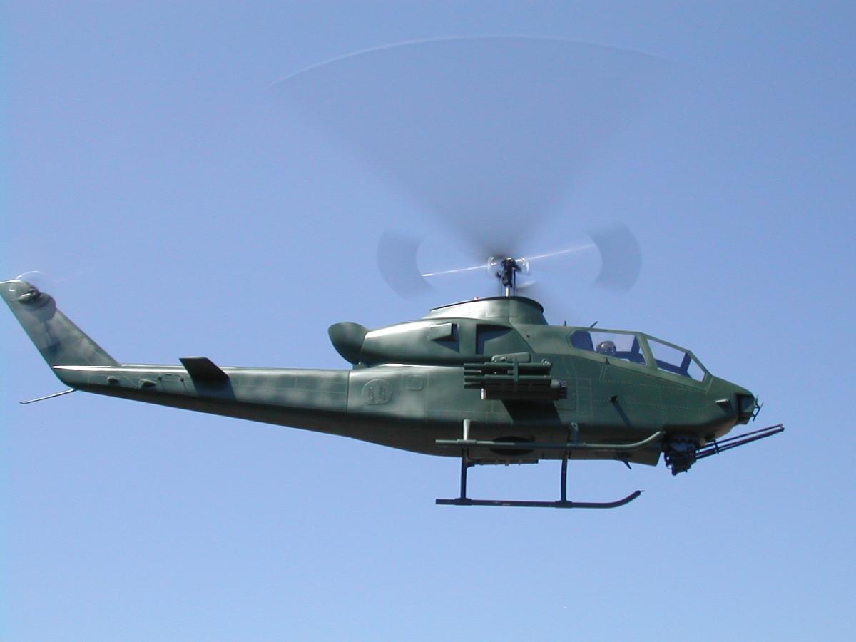

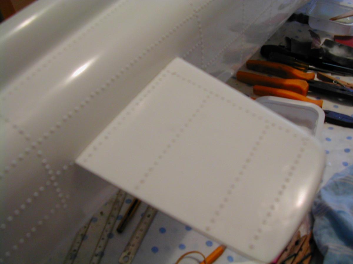

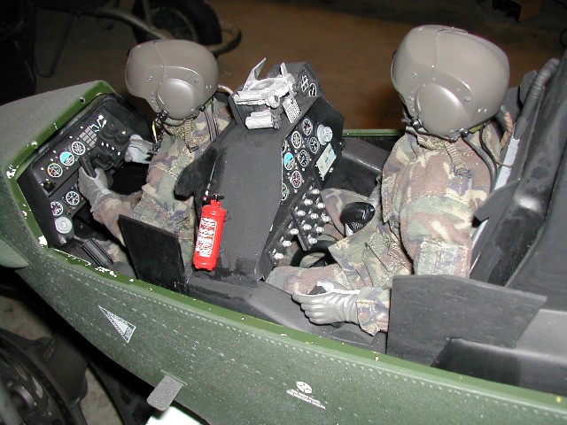

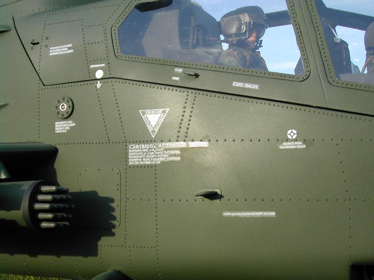

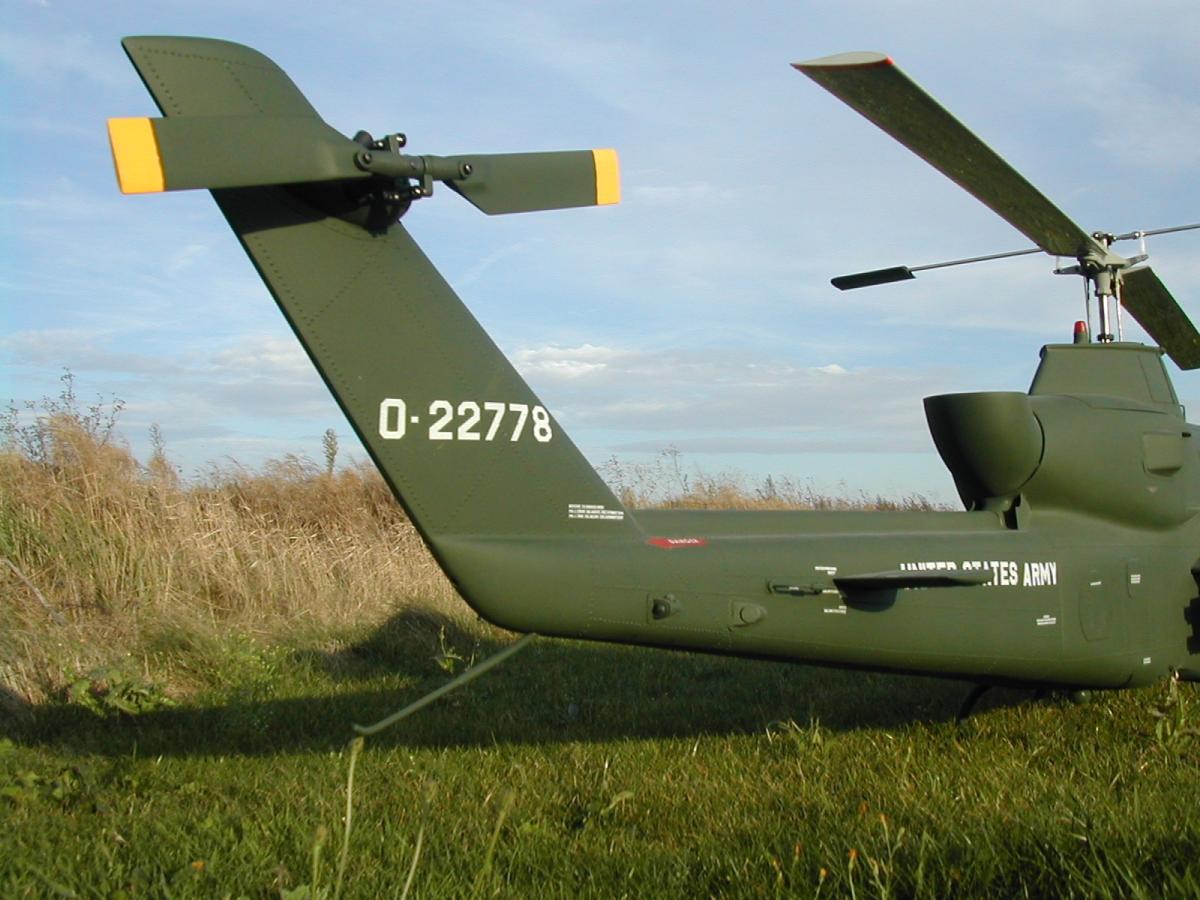

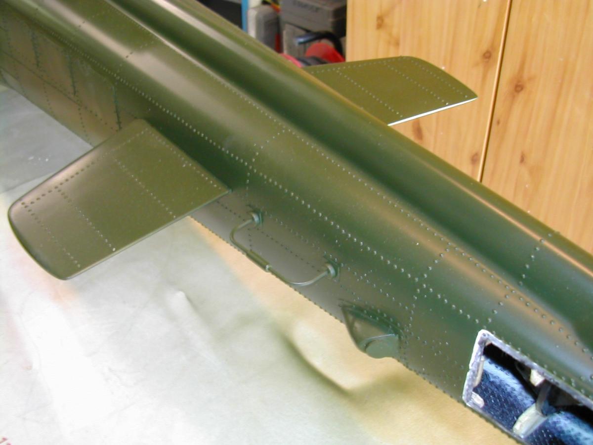

          Some pictures of my Cobra
          7000 drilling and rivets laid one by one

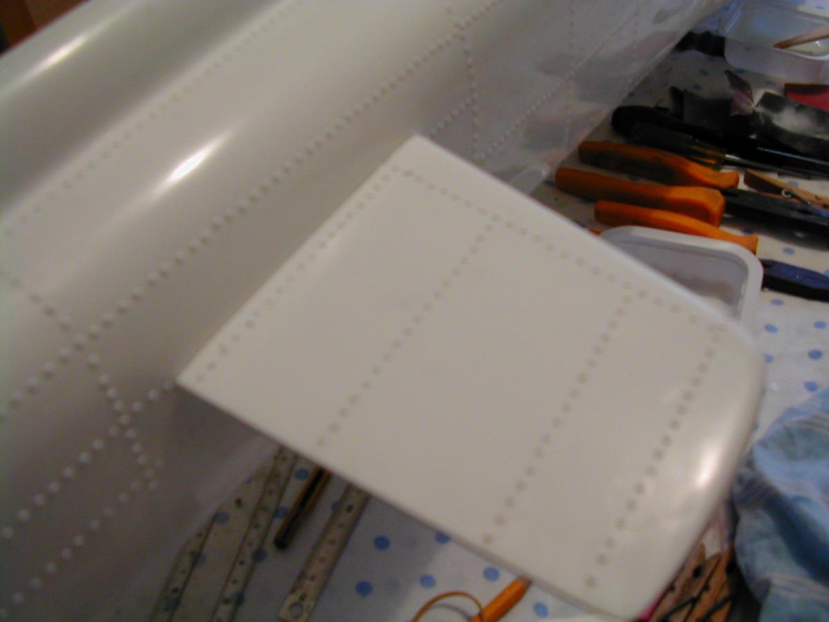

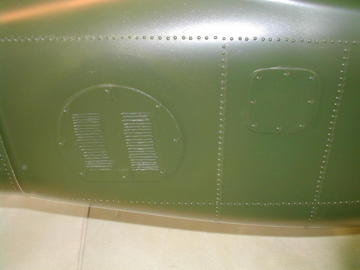

          Modification of the fuselage and addition of the various hatches

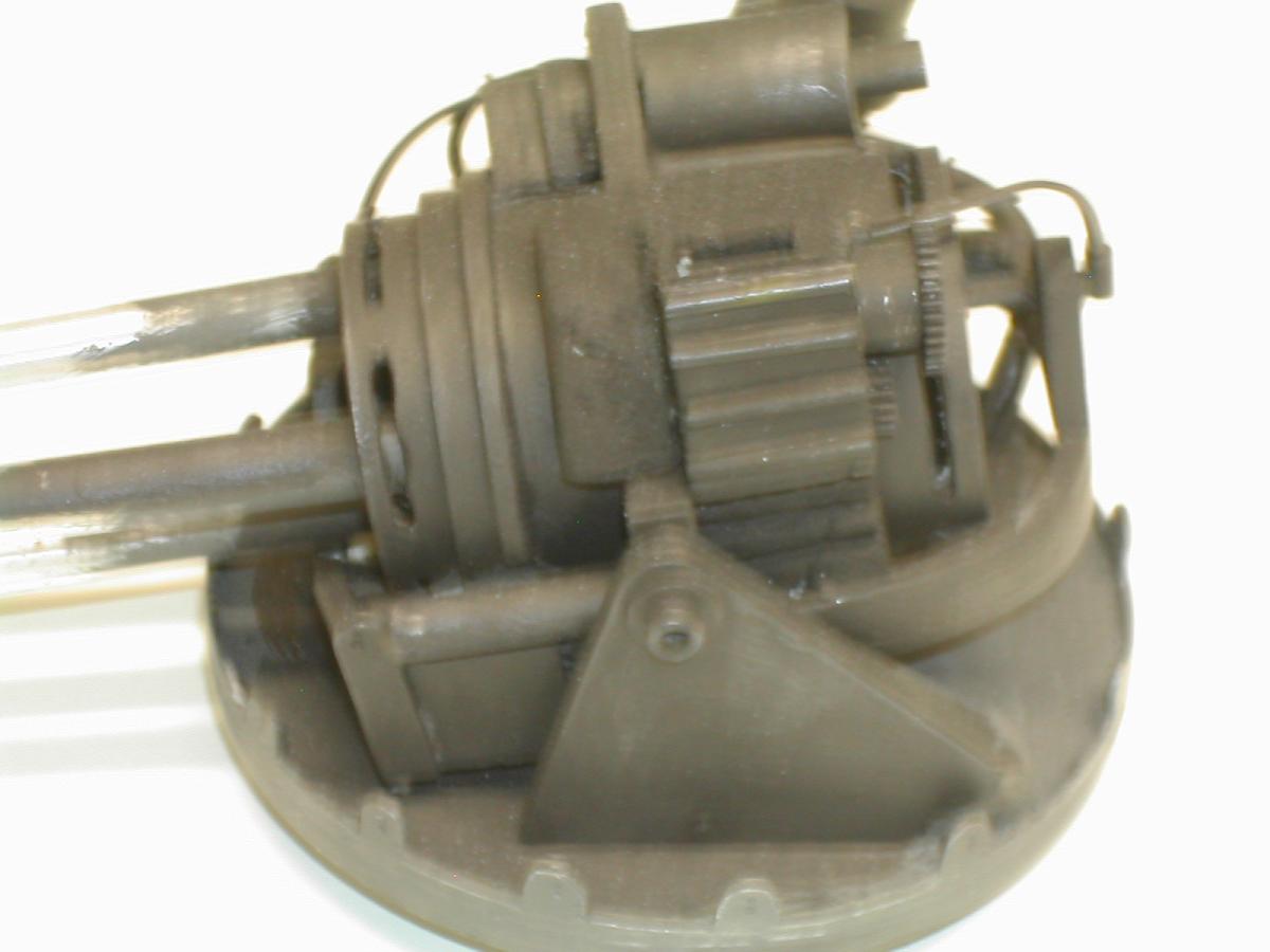

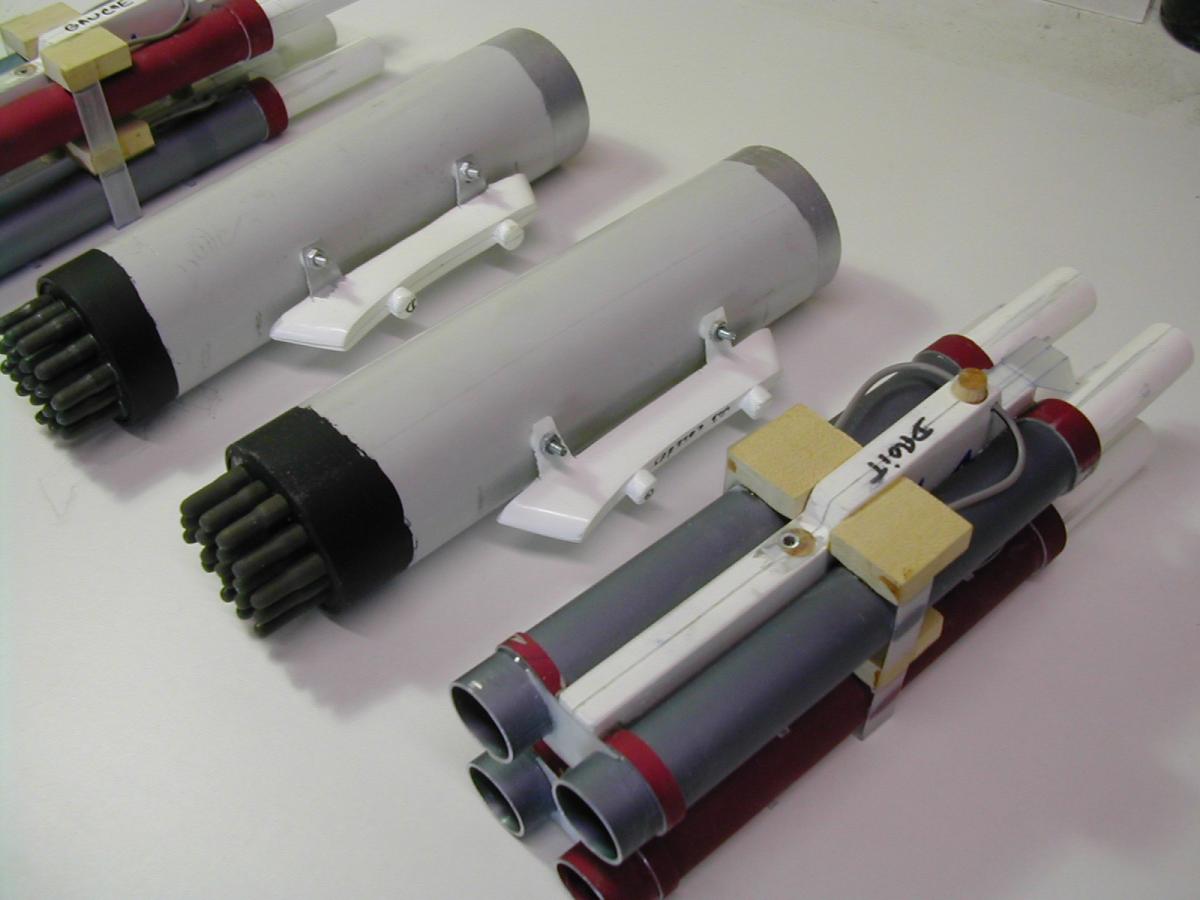

          Manufacture of armaments
          First adjustment flights before finishing
          Machine completed
          Good flights
          Daniel

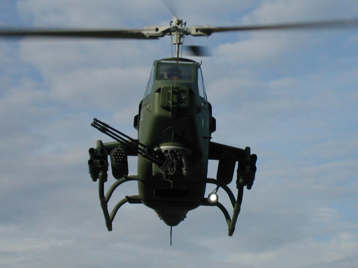

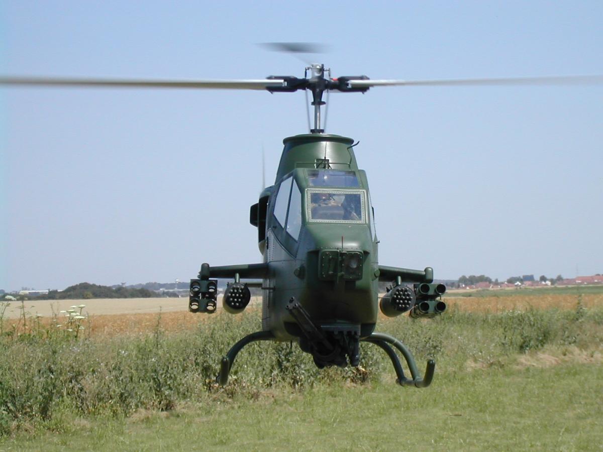

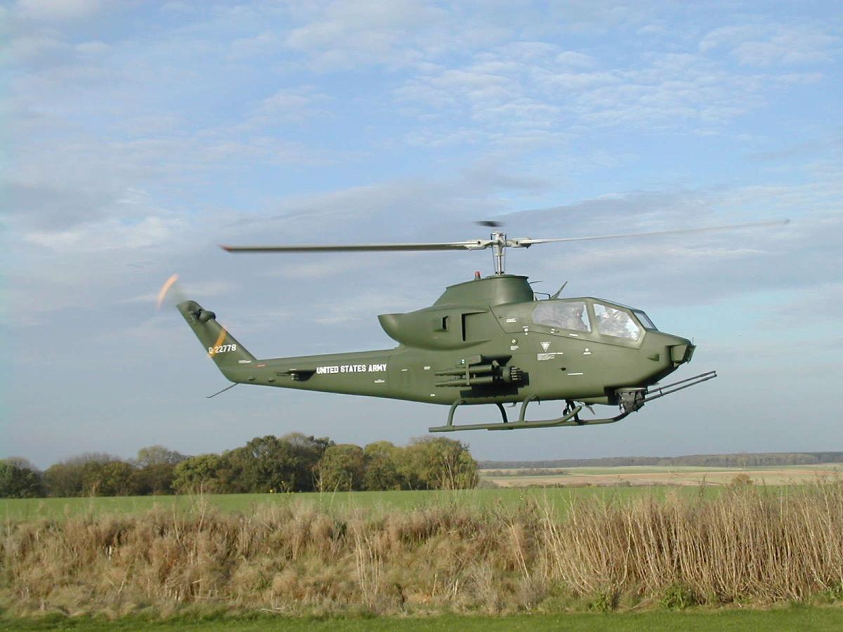

            Wow... that's a beautiful Cobra!!

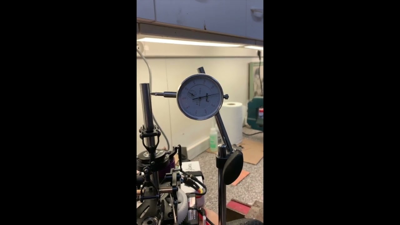

                  Hello,
                  I have a technical question for ROBAN machine owners:
                  Big vibrations appearing from 1200rpm,
                  The blades are perfectly balanced and their center of gravity verified.
                  Have you measured the concentricity of the rotor shaft?
                  I made a measurement with a dial gauge
                  Result: 0.05mm of "faux rond" (in French) Is this normal in your opinion?
                  I have never had this problem with a VARIO mechanic
                  Best regards,
                  Daniel
                  • PawPaw
                    • Jan 2019
                    • 539
                    • Baytown, Tx
                    I have never measured a Roban shaft, but 0.05mm (0.00197 in) of runout on an installed shaft does not seem extreme to me. You could remove the shaft and measure it separately to get a more accurate number but that would require some precision equipment. Have you dialed a Vario shaft for comparison?

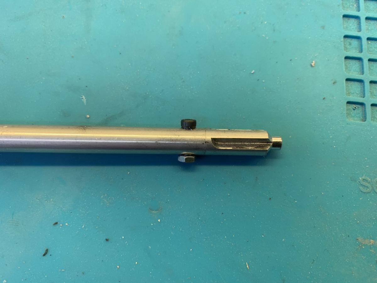

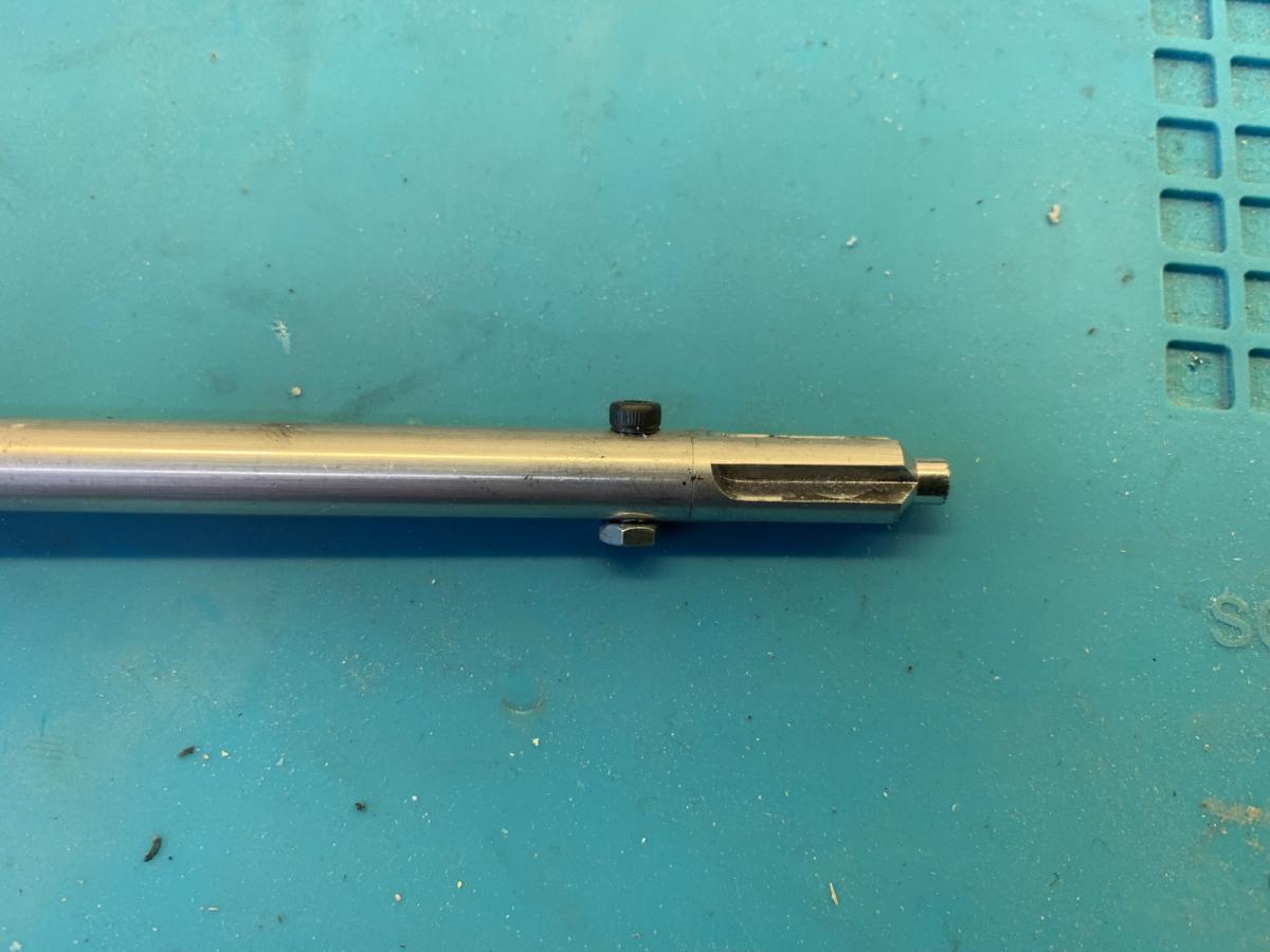

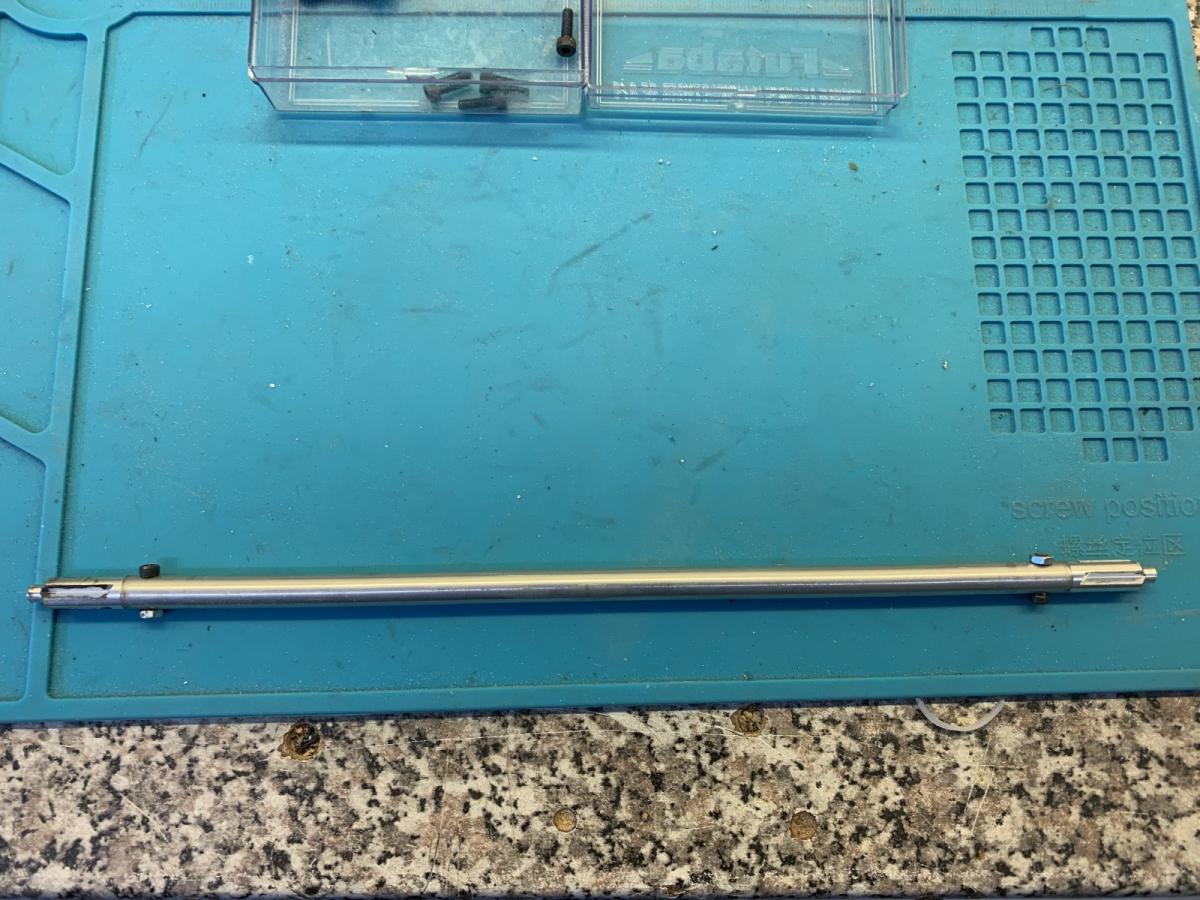

                              • Astronome
                                • Apr 2022
                                • 56
                                • France, Senlis
                                Originally posted by Helikapoter
                                Dont think that this is normal .must be zero .
                                Hello Helikapoter,
                                I agree, but I don't think 0 is mechanically possible, there will always be a tiny tolerance.
                                But what its value?
                                • PawPaw
                                  • Jan 2019
                                  • 539
                                  • Baytown, Tx
                                  #17
                                  If your finger rotation feels smooth, then just check the front and tail bevel gear end play. No need to remove the short tail boom for this. Reach inside the main frame and grab the horizontal tail drive gear and check for end play. Pull it back and forth as much as possible. Should be able to just feel a very small amount of play. Very small. In fact, if you did not install shims in the front transmission when you assembled your UH-1 I can almost guarantee there is too much play. Also, visually check to see if the vertical drop down gear is meshing properly with the horizontal gear. The back edges of both should appear 90 degrees with no offset in or out. There is no adjustment possible for the 45 degree angled gearbox, but check for gear wear and adequate grease. Check your motor pinion to main gear clearance. I set mine with a piece of thin receipt paper and it has worked well. Lastly, double check all the screws in the frame especially those around the tail drive unit. I had a bad vibration on my B407 700 that was found to be loose front transmission screws. Good luck!
                                  • Astronome
                                    • Apr 2022
                                    • 56
                                    • France, Senlis
                                    #18
                                    Hi PawPaw and all the members
                                    I check the front and tail bevel gear end play, all is OK.
                                    I check and securise all the screws of the mechanic like my Vario's helicopters.

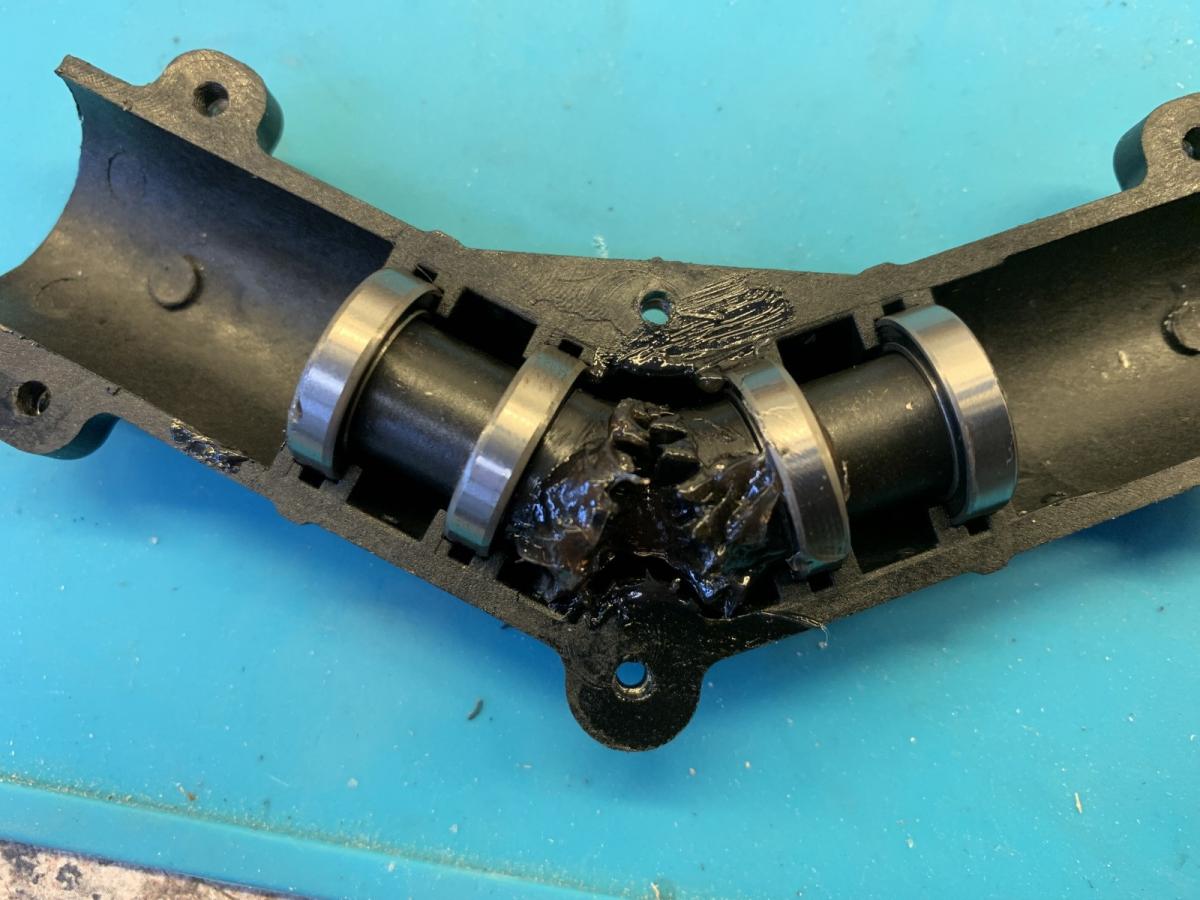

                                    I changed the grease (SKF) of the 3 sets of bevel gears.

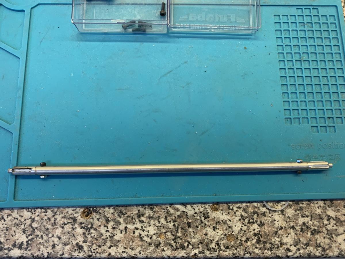

                                    ​​​​​​I took the opportunity to secure the fittings of the rigid transmission with a screw at each end, because the fittings are just glued and I don't trust.
                                    After reassembling the mechanics: always these vibrations :rage:
                                    I will have to wait for Roban to change the rotor shaft.
                                    Daniel
