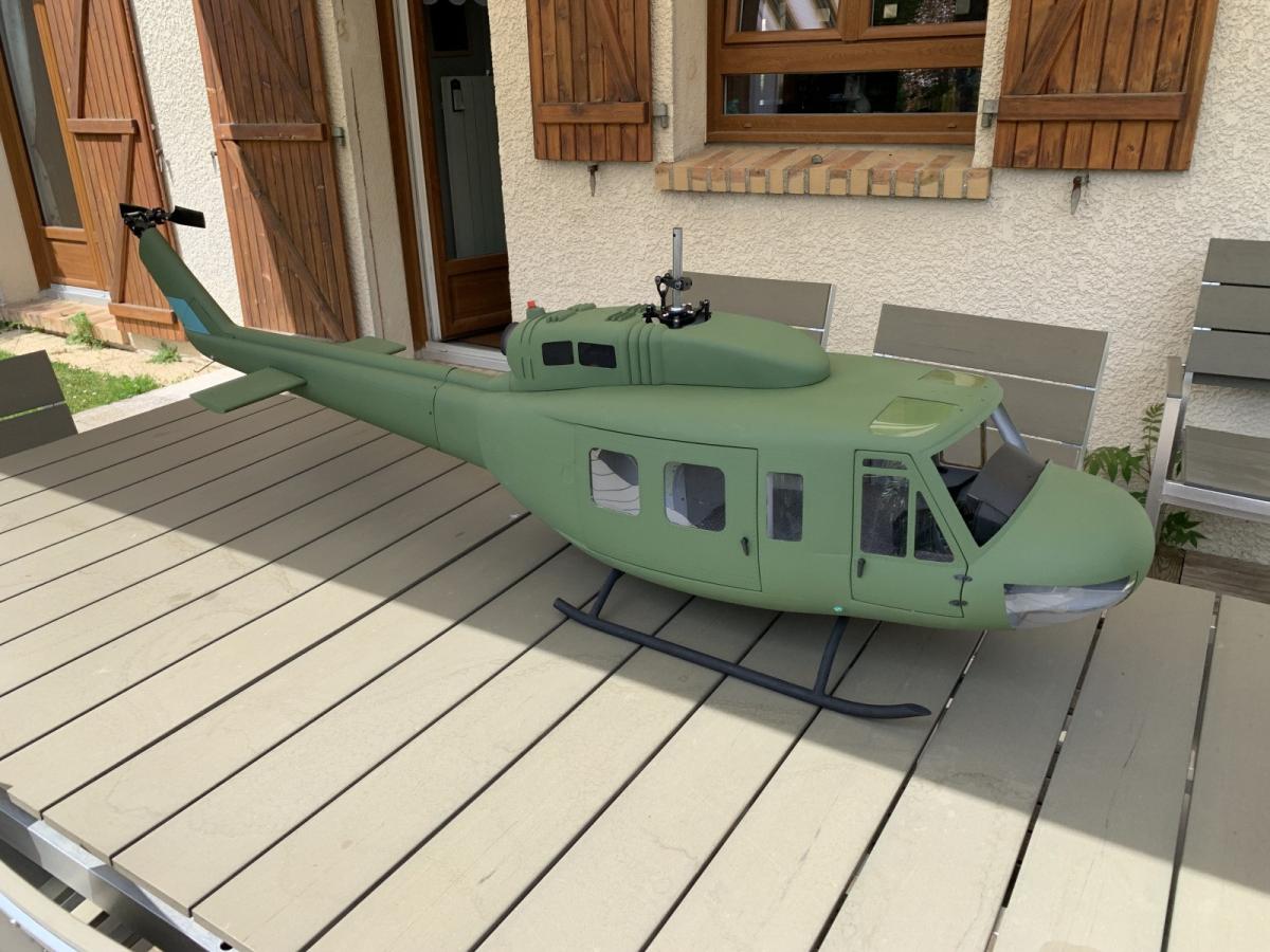

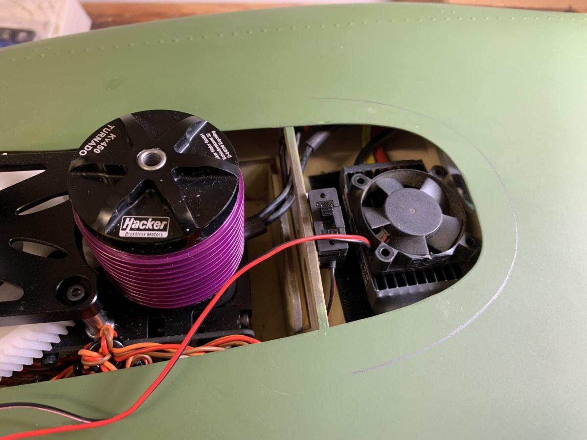

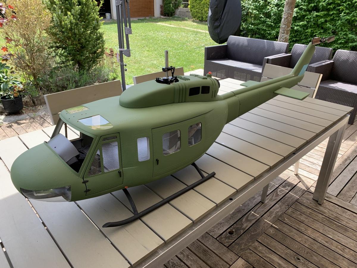

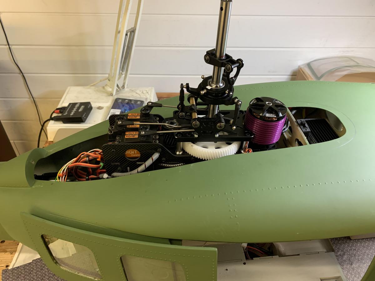

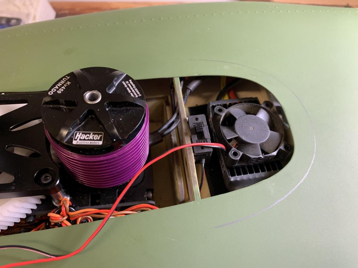

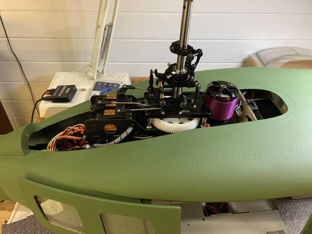

                            After the tests of the mechanics alone, I installed this one in the fuselage.
                            8.4 kg on the scale, without model accessories.

                            • DCORSAIR
                              • 1918
                              • Selma, Ca.
                              #54
                              Originally posted by Astronome
                              Hi,
                              Looks awesome and yes you will be up over 20lbs when your done with it, I was worried about the weight on all the ones I have owned, not an issue when your flying them, makes it very scale........

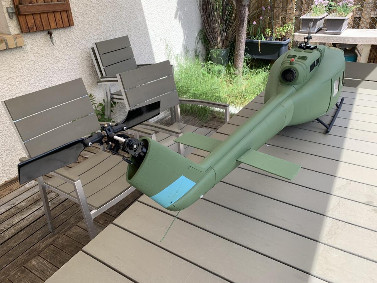

                                    #57

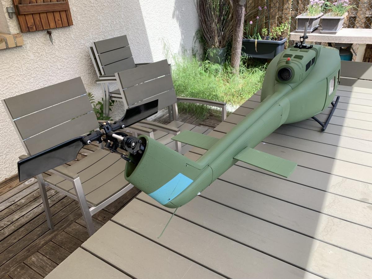

                                    What are you using for the tail servo horn?
                                    • Astronome
                                      • Apr 2022
                                      • 56
                                      • France, Senlis
                                      #58
                                      Hi sfcfury,
                                      I using a SAVOX DIGITAL SC-1258TG 12kg-0.08s for the tail
                                      and 3 SAVOX DIGITAL SA-1256TG 20Kg.cm/6v for the head.
                                      • sfcfury
                                        • Mar 2019
                                        • 490
                                        • Baton Rouge, La
                                        #59
                                        Well the actual servo horn is what I meant- it looks like you flipped the tail over?
                                        • Astronome
                                          • Apr 2022
                                          • 56
                                          • France, Senlis

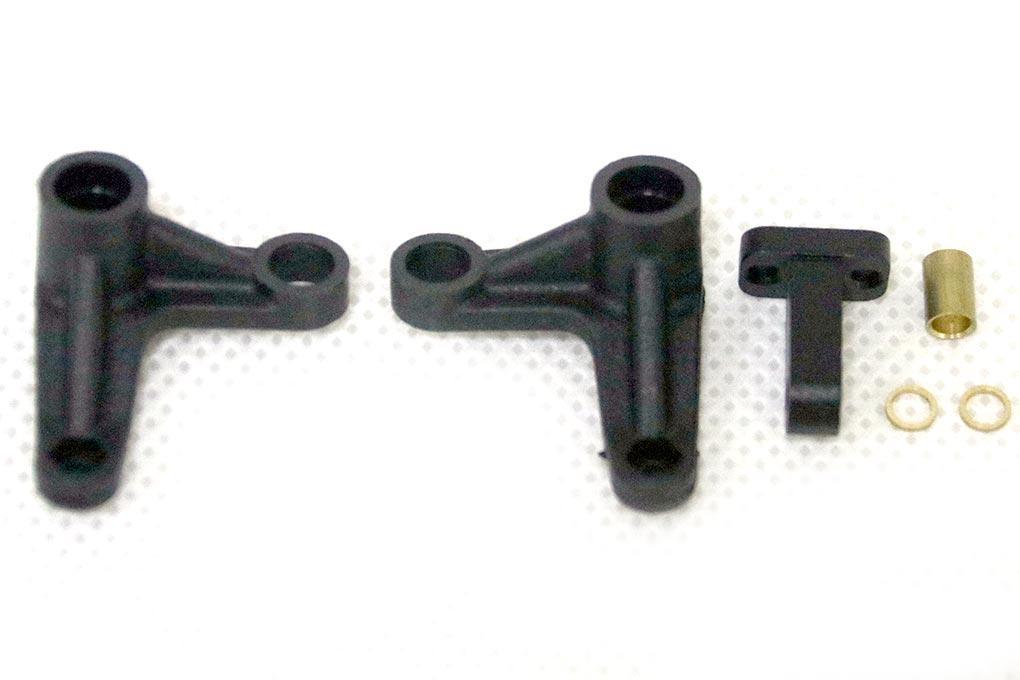

                                          #60
                                          Yes I installed the tail rotor on the left side (like the real helicopter).
                                          With part VARIO 97/20
                                          Click image for larger version  Name:	8TlNMm (1).jpg Views:	0 Size:	76.6 KB ID:	346594
                                          There is also the spare part ROBAN:
