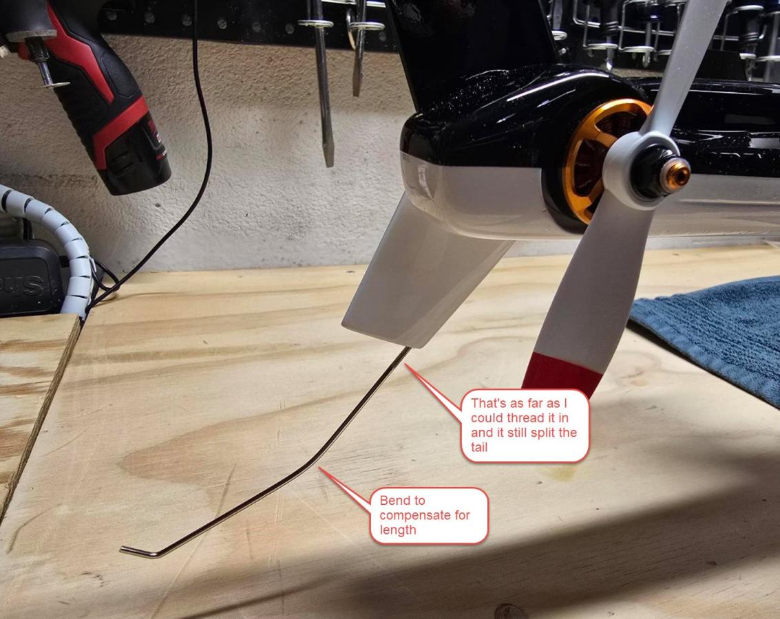

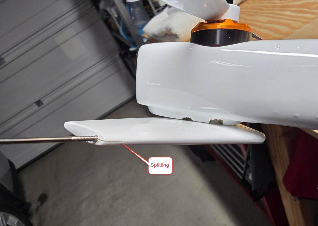

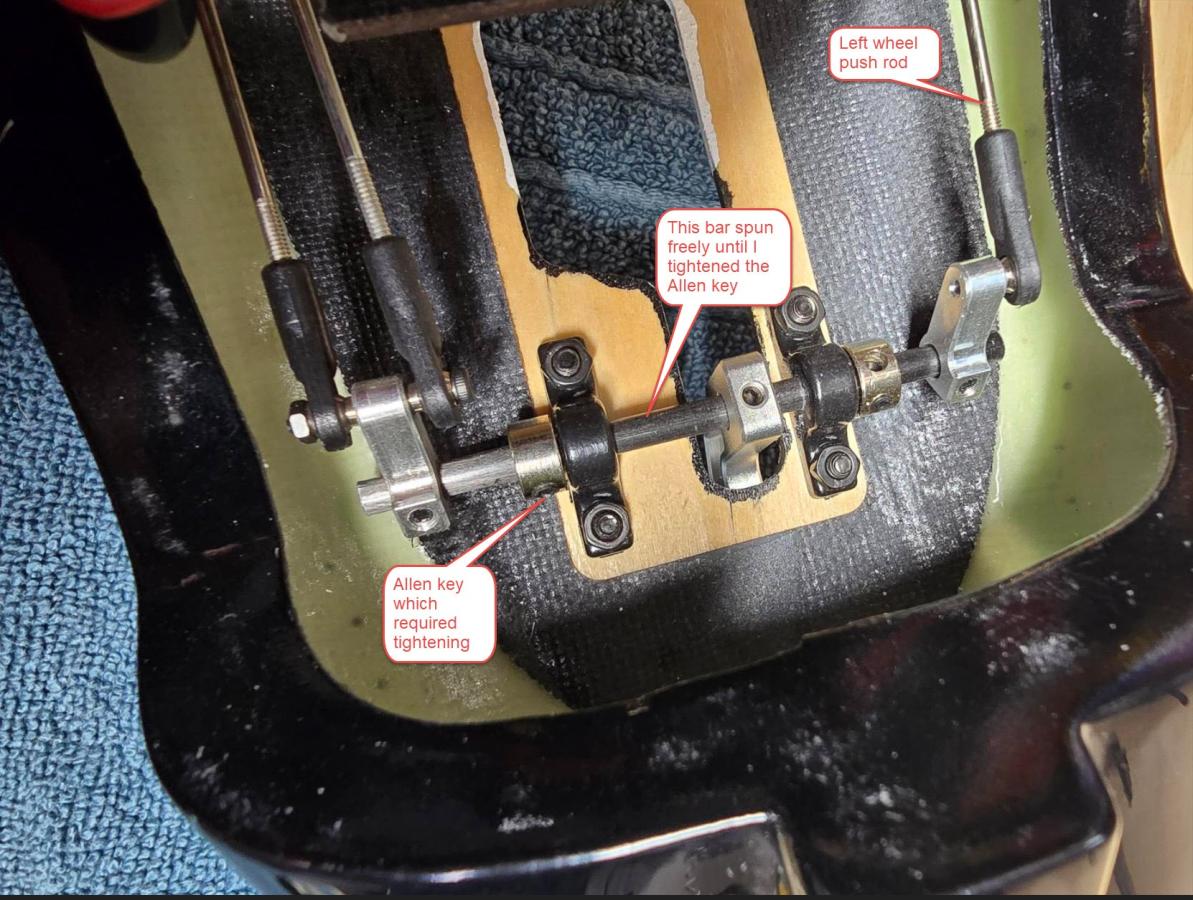

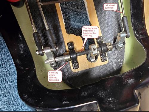

                    My landing gear was malfunctioning upon unboxing due to a loose grub screw on the rod to the right of the front wheel. It caused the front and left wheels to extend only halfway and not all the way to the locked position. Those two wheels were also moveable when extended until I called and talked to Tim at Motion RC, who directed me to tighten the Allen key.
                    Click image for larger versionName:	Landing Gear Repair.jpgViews:	2Size:	169.2 KBID:	419763
                    I am glad I noticed the issue, as it could have resulted in a rollover when landing the heli.
                    My tail started to split when threading in the tail support rod. I only threaded it in about half way and then bent the rod a few degrees to compensate for the remaining length. The windows do have film on both sides. I had to use a table vice to press the side gun rods into the outer covers albeit very gently and carefully.
                    Click image for larger versionName:	Tail Bar.jpgViews:	2Size:	125.9 KBID:	419764

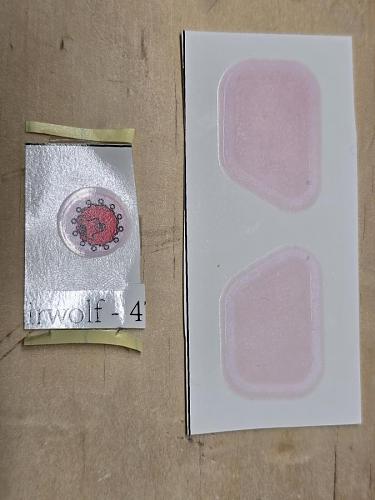

                          Does anyone know where these stickers belong?
Name:	2025-02-12 18.34.13.jpg
                          • Air-Fubanator
                            • Feb 2025
                            • 4
                            those on the right are your window stickers , the little white window, makes it look like one .. I did not get the one on the left so i have no clue

                              I highly recommend you remove that tail support rod as soon as possible. If your helicopter's landing gear malfunctions, its main rotor blades will hit the ground and be destroyed. Mine did not have it installed, and the landing gear gave way, causing the helicopter to fall on its belly and the tail propeller to scrape the ground slightly. Luckily, there was no damage other than a slightly scraped paint finish on the propeller.
                              You can check out my heli's maiden flight here.
                              Have a great rest of your night 🌙 Greetings from Douglas, Arizona 🌵 👍🏾 😁 🇵🇷
