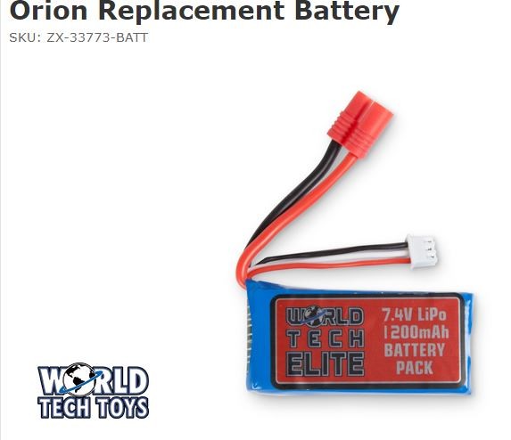

    I have this world tech drone and it came with a good battery 2S 1200 Mah no C rating on it.. .so I tried my airplanes battery in it that are very good in the airplane however fail in the drone and slows down .
    of it maybe the drones uses a lot more current so my 20C battery's wont hold up?Click image for larger version
Name:	33773  battery.JPG

      Your drone has 3 more motors than your plane and it is possible your 20C batteries are not up to the claimed specs. Only way you can tell is by using a watt meter but I can guess your batteries just are not good enough.
      What you describe is a battery that just can't hack it..

        thanks I replaced th battery with a new one and now works , it dont make sense because th old battery works well in my airplane .
