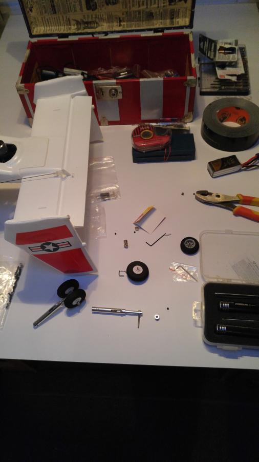

Wow what an experience today was. There was no wind at all today at our flying field. The V22 Osprey lifted off for its first half maiden flight. I wasn't comfortable at all. It started drifting pretty good. Got it turned around and I hovered it in circles. I didn't want to transition it into flight mode. I was the only one at the field. I'm happy with my day.1 PhotoComment
Is that a little EDF in the tail? Guessing they need that because the main rotors are not large enough to support the entire aircraft.Comment
Yes your correct. I'm not exactly sure how many mm it is. But it sure is loud. The whole aircraft is loud. On Sunday there'll be more experienced pilots their to help me fine tune it, via mechanically or trimming it.Comment
