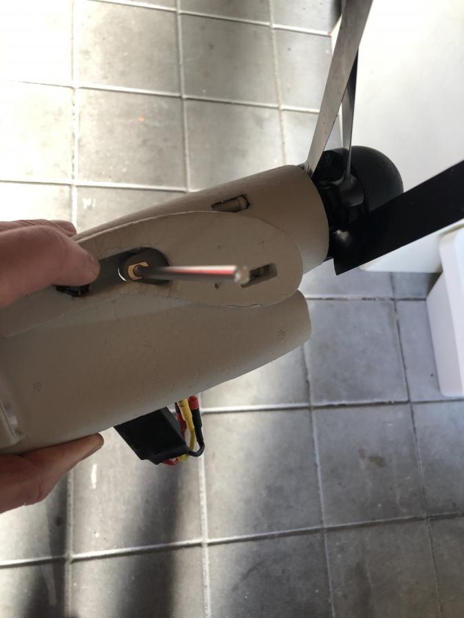

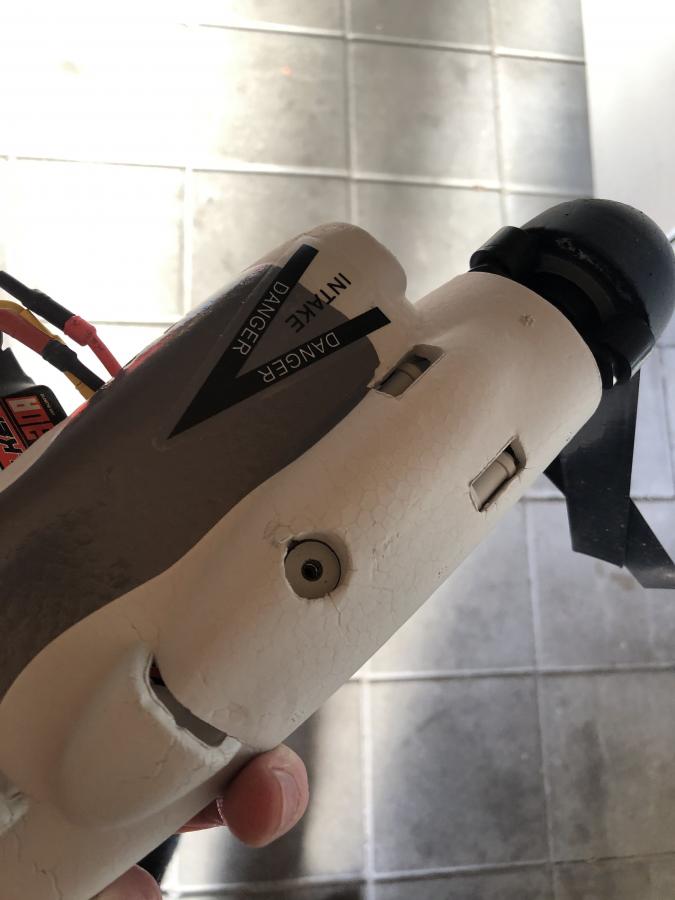

                              #34
                              Hopefully you can help me with the following regarding my Blitzrcworks V22.
                              After a crash, the rod/axis that moves the nacelle got bend. As shown in the pictures, I removed the nacelle from the wing, but I can’t get the rod/axis out of the servo. On the outside of the nacelle was a screw that I unscrewed, but the rod/axis doesn’t come loose.
                              Do any of you have any idea on how to remove the rod? I emailed Bananahobby and the employee who replied said he would look at it at home, but never got back to me.
                              Thanks in advande for your reply,
                              Paul Click image for larger version
                                • 8822
                                #35
                                From those pictures, it appears that you already have the rod removed from the servo. There is no servo in the nacelle. I bent mine up a few times myself and I've never removed the rod from the nacelle. After the first attempt, I just left the rod in place and just bent the rod with everything connected in the direction that needed to straighten it. Power up the plane and rotate the nacelles till you can see how the nacelle needs to be bent. Then power off, grab the nacelle firmly and bend it till you can get it to rotate through its arc evenly. I've done it about 3 times and the plane flies pretty good now.

                                          Originally posted by PaulfromHolland
                                          I just took apart my broken V-22 for parts and that rod you show does, in fact, just pull out after that screw is removed. The end has pieces that have angled surfaces, so they are wedged in there. Once the screw is removed, you take channel lock pliers and hold the rod and wiggle and rotate the whole rod while you pull. It will come out.
