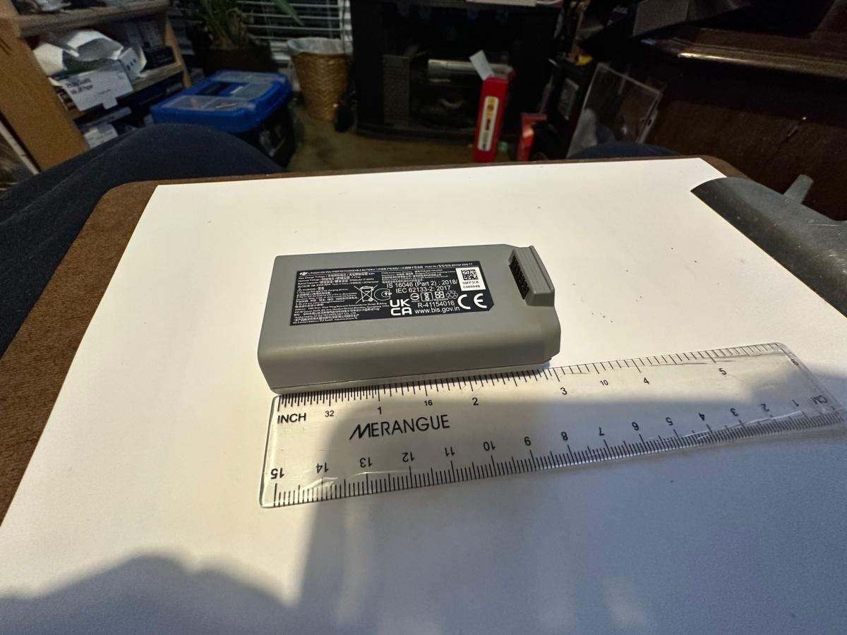

        I fully understand now what you are dealing with. I'm so sorry for getting your hopes up. I also have an Eflite QX350 and it takes a "normal" LiPo battery with an EC3 connector. That is a very proprietary battery. Not unlike the one for my DJI Mini 2. Have you tried to clean the contacts and pins with a dry fine brush? Also, can you check to see if the charger is actually putting out a charge. Perhaps the charger is dead? Since it's a LiPo battery, if it was somehow drained below 3V/cell, it may never come back.
        Here is my DJI battery. Notice that the size is very close to yours and it also has 6 pins that couple with the drone. It's 7.7V/2250mah. You even turn off the power in the same way. Perhaps you could look into possibly adapting it to yours.
