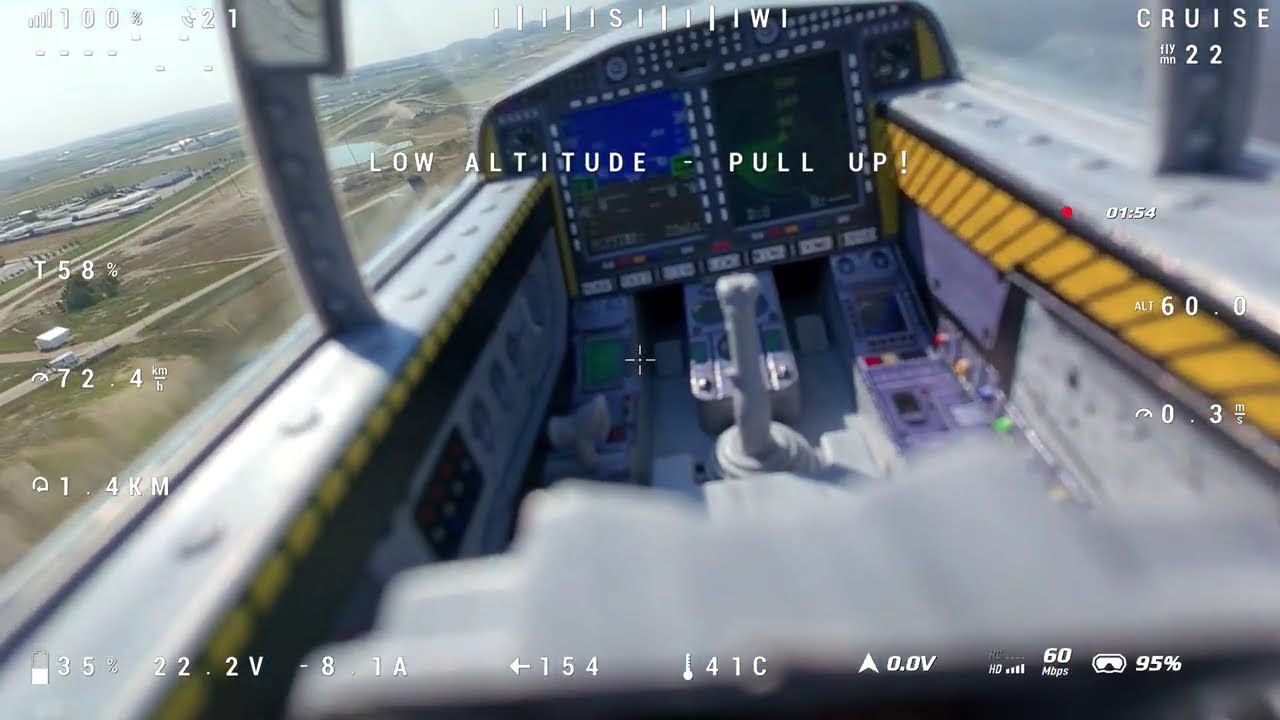

        Did the maiden this morning. A friend did a short video using his Iphone in the middle of the flight. And one of the video from the goggles. I'm glad I didn't push hard for a refund. This thing is everything I hoped it would be. It's really interesting to see fly and the friends who put on the goggles said it was an amazing experience. High clarity, resolution and big WOW factor. The transition is the best of any of the VTOLs I've ever flown. It is smooth, precise and extremely controlled. I'm still devising ways to make it more "bomb proof", like securing the battery so it doesn't fall out during flight and a locking mechanism so the wings don't fold, as reported by some owners. When I get familiar with the control responses, I'll start flying with the goggles and defeat the nannies (ie, beginner mode). Another few short flights ought to do it.

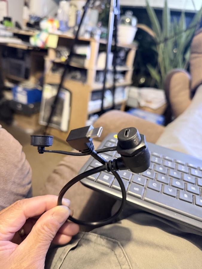

                  This is the extension. Just got it. Will install soon and take a photo. Click image for larger version

                    Nice I can't wait to see the pic. But that 90 bend looks too big...

                      I'm afraid you may be correct. As soon as I took it out of the bag, I thought the same. I have another one on order that's quite a bit smaller. We'll see.

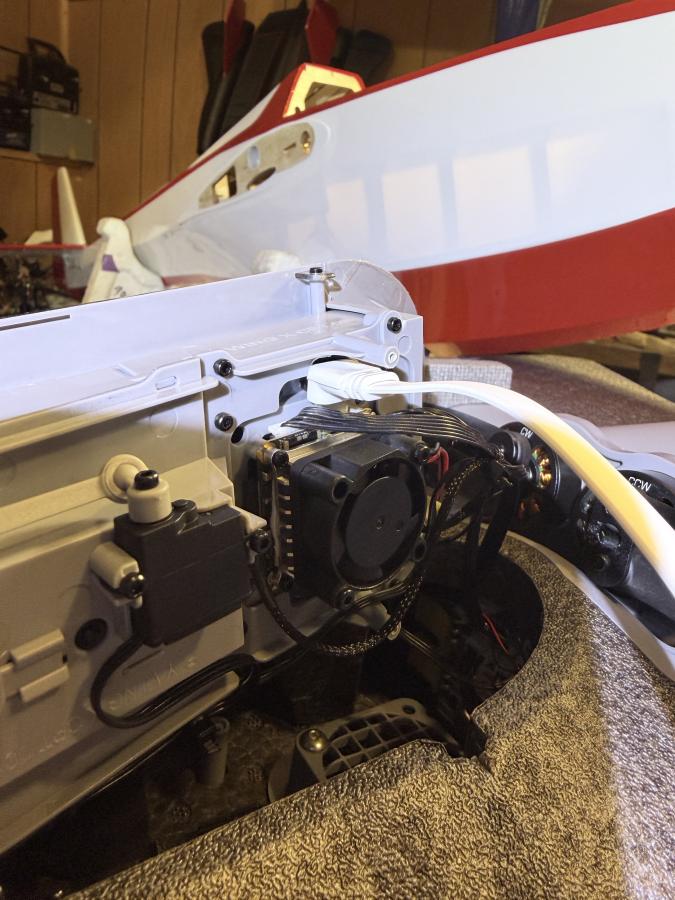

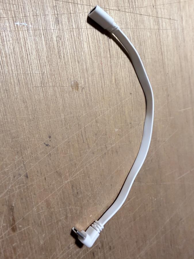

                        Yup that one looks like mine. But mine isn't long enough to reach out side. But I have another that is too long lol
                          • 8819
                          #52
                          Ain't that the truth. The next length up is almost a foot long, then next are the 10 foot ones.

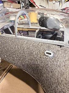

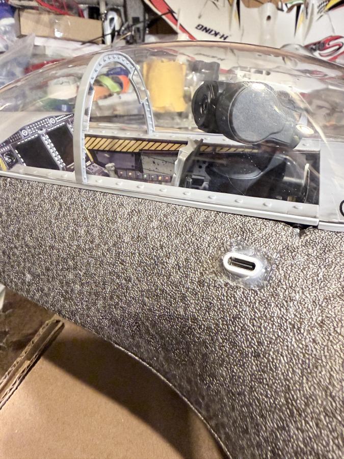

                            Finally got the extension installed and was able to extract the 4K videos from the air unit. Videos are magnificent. My TV can't even show them in 4K but still very impressive.

                              Dam Nice!
