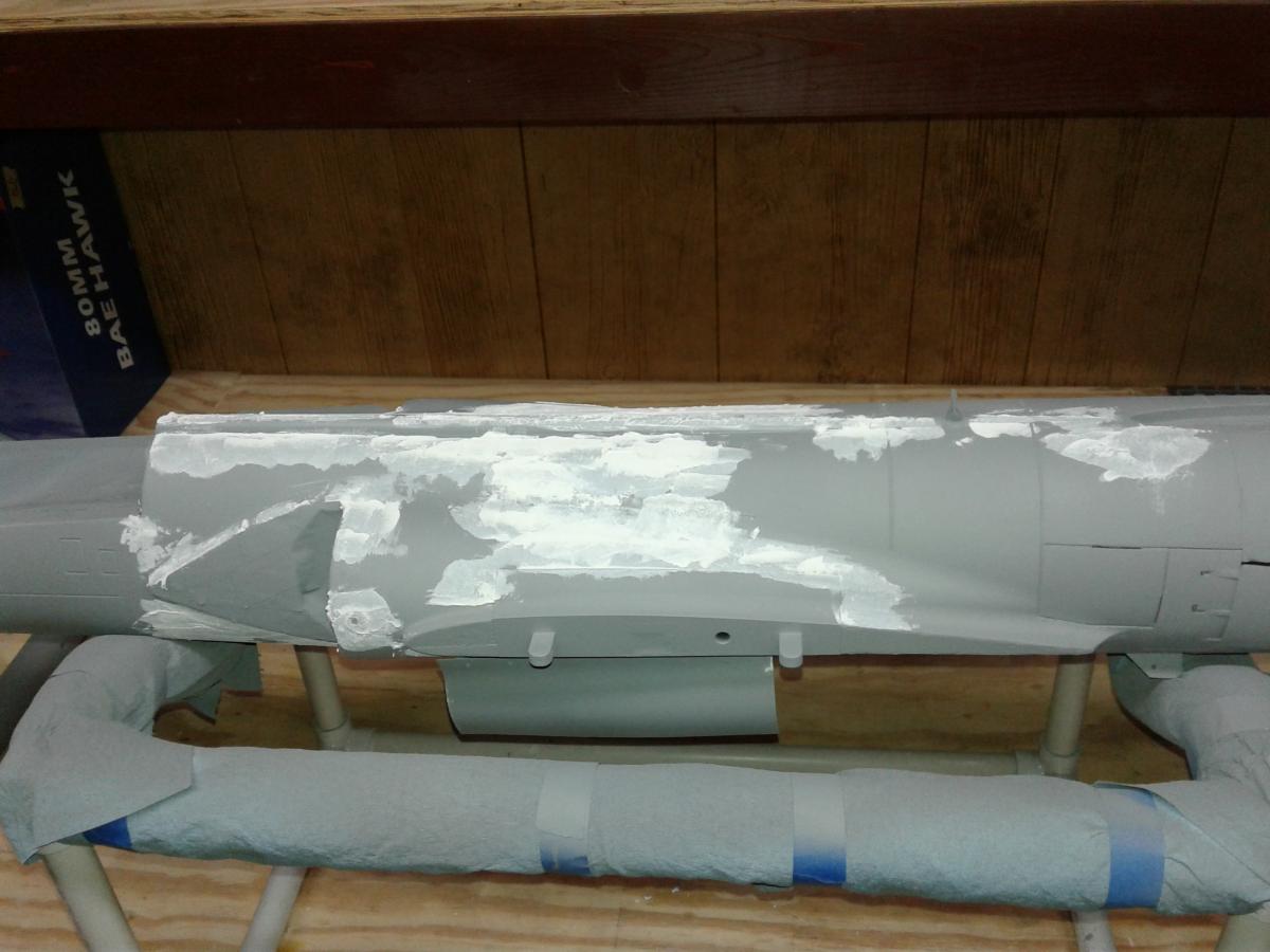

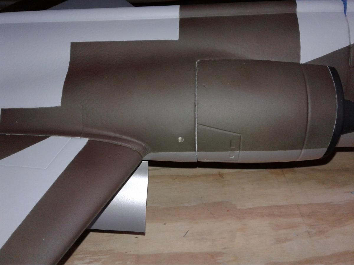

      I use 3M Patch Plus Primer. It's a lightweight spackle with primer in it.
      It's readily available at Lowes and is pretty cheap. As it gets older, just add a little denatured alcohol to it. Done.
      I use 220 for initial sanding. Then prime sand prime ...using 320 grit until she is ready for paint.
      I recently refinished an F-104 using this 3M stuff. The area around the lights was re-built this way. Also the top of the fuse was all torn up from the original stickers. It also got a good coat of spackle.
      If you take your time, you can smooth out wrinkles and crash damage pretty easily. So much so that people will not believe you crashed it. I did this on the nose of the A-4 a while back after a hard landing in the high grass. Took the wrinkles right out.
