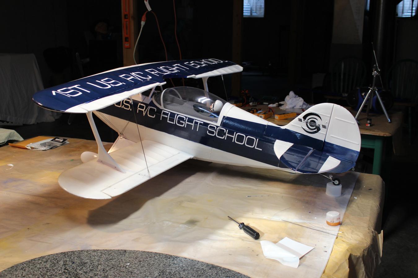

    I have a gallon of gloss white water based latex for whenever I get a white or partially white plane. I repainted the Pitts with it and more recently, the Avanti.
    The advantage is that it hides the foam cells and give the plane a brighter white color.

      DANG!!! What a beauty! Doc
        • 7415
        #23
        Hard to believe she's going on four years old!

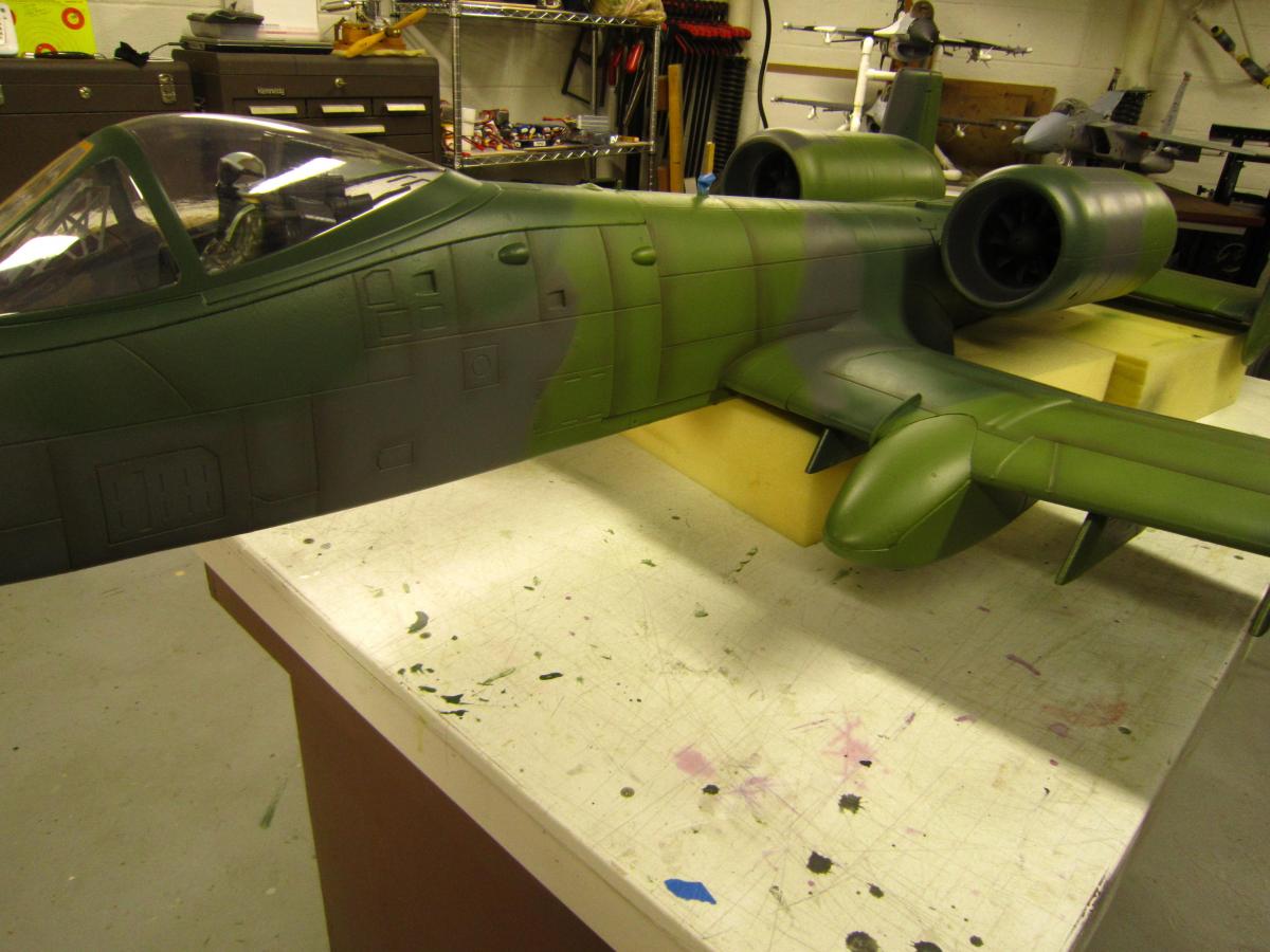

                            This weeks latex and windex!
                            • Prowler901
                              • 940
                              • Gunnison, CO
                              #34
                              Beautiful work! How much windex do you end up adding to the latex to get it thin enough for the airbrush?
                              • Phatbob
                                • Apr 2013
                                • 118
                                • Baldwinsville, NY
                                #35
                                30 to 40 windex. Trial and error until I like how it shoots. Roughly the consistency of milk.
