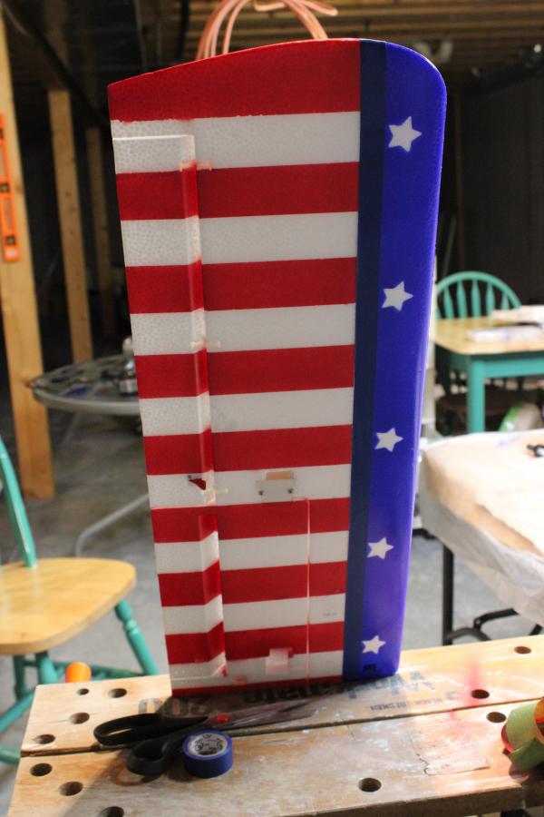

                  Regarding thinning latex paint with plain old water. Yes it will work. I use water and alcohol to thin latex paint for airbrushing. During the warm summer months, I use water as a thinner. During cooler months, I use alcohol as thinner. The reasons for this is that alcohol evaporates to quick in higher temperatures and water evaporates to slow in lower temperatures. With both types of thinners, the paint is thinned to the consistency of milk + or -.
                    • 7333
                    #49
                    Don't know about the spray cans, but Liquitex acrylics have been a staple for my art work and more recently my airplanes, it's great.
                    I use the Walmart bottles of crafts paint as well as Valspar that I get a sample can premixed at Ace Hardware. You can't beat the price!

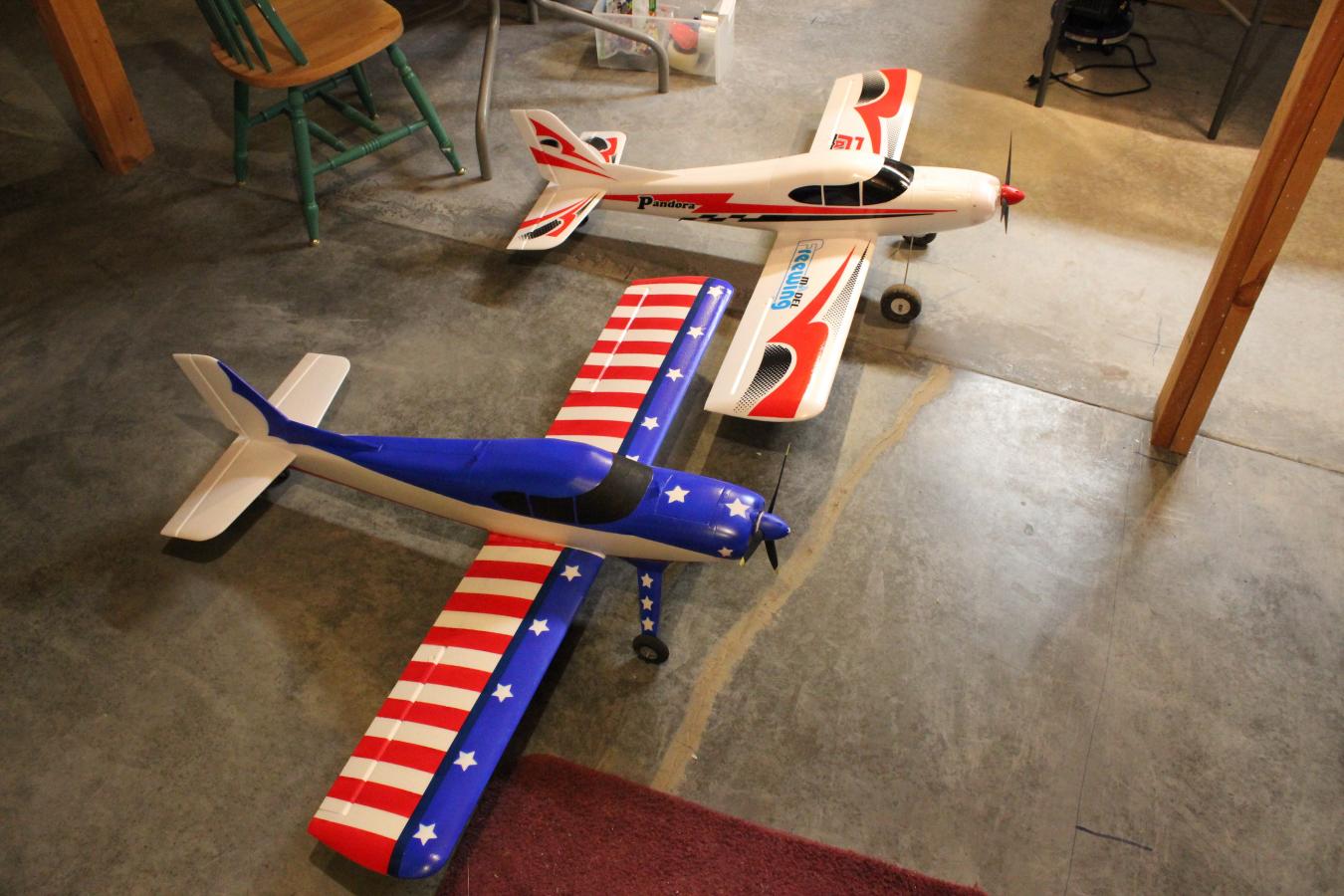

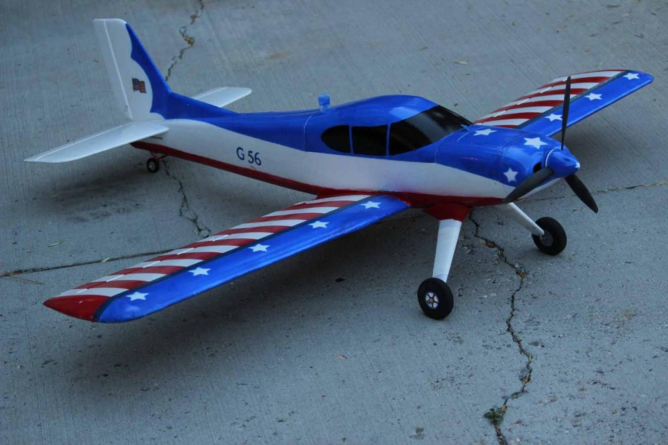

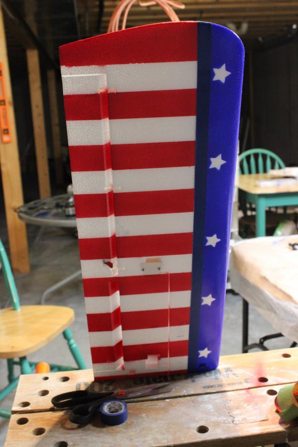

                    Pandora 1 and Pandora 2 a before and after shot. I follow up with a clear coat of Minwax Spar Urethane or Varathane Spar Urethane for a glossy finish. They both have a UV protectant in them, the Minwax seems a bit more shiny so its been my 'go to' lately. Does it last??
                    Three years and lots of flights later ( not to mention some crashes)

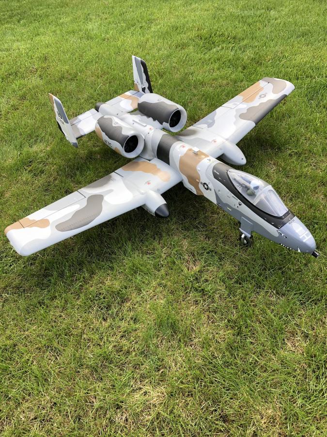

                                        I have been using The RUST-OLEUM 2X ULTRA COVER paint and primer. When it is on SALE, I can get two 12 oz. cans for $7.00 Dollars at ACE Hardware I have used it on many Free-Wing and Flight line planes, and my E-flite planes. Here is a photo of my E-flite Twin 64mm A-10 I did
