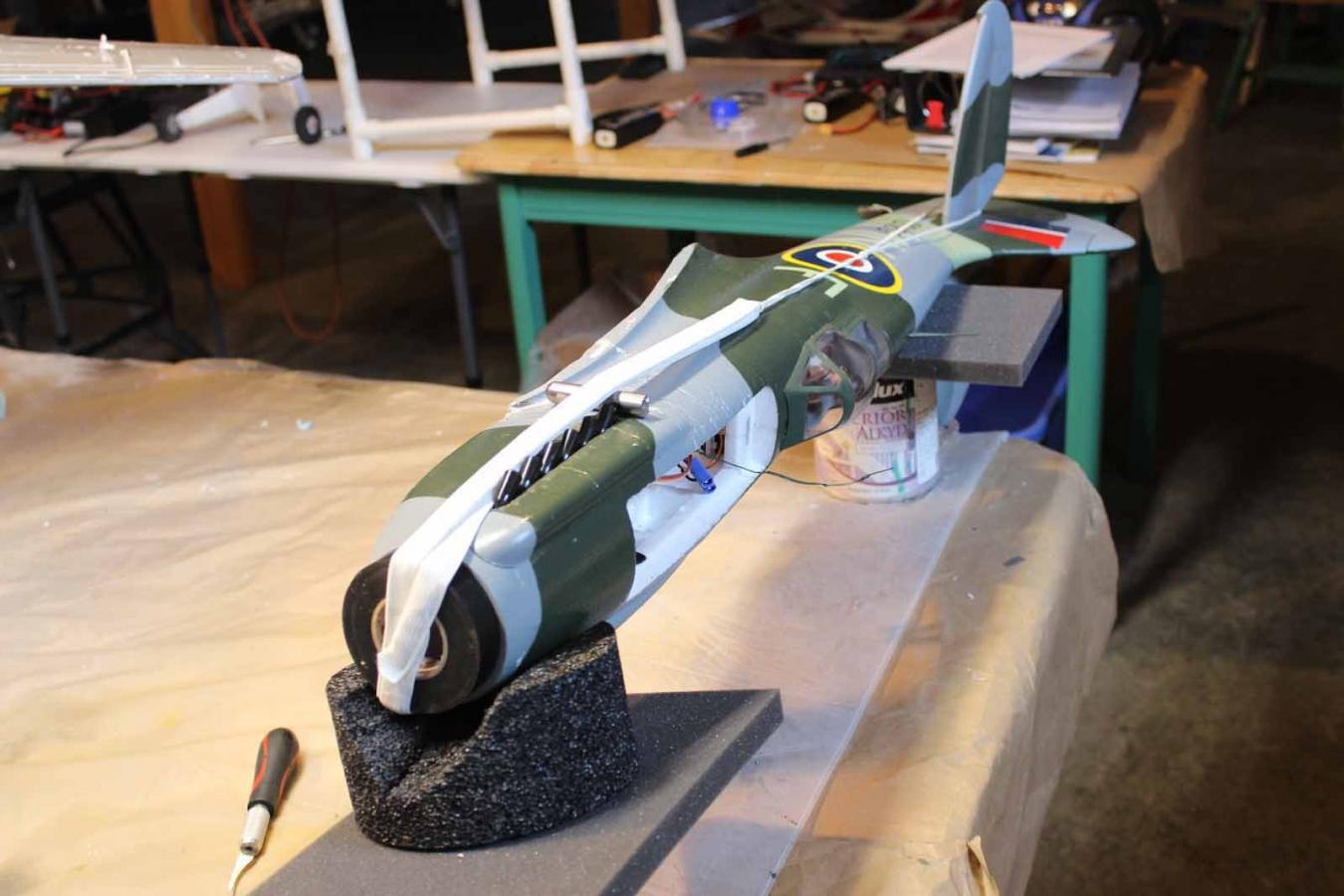

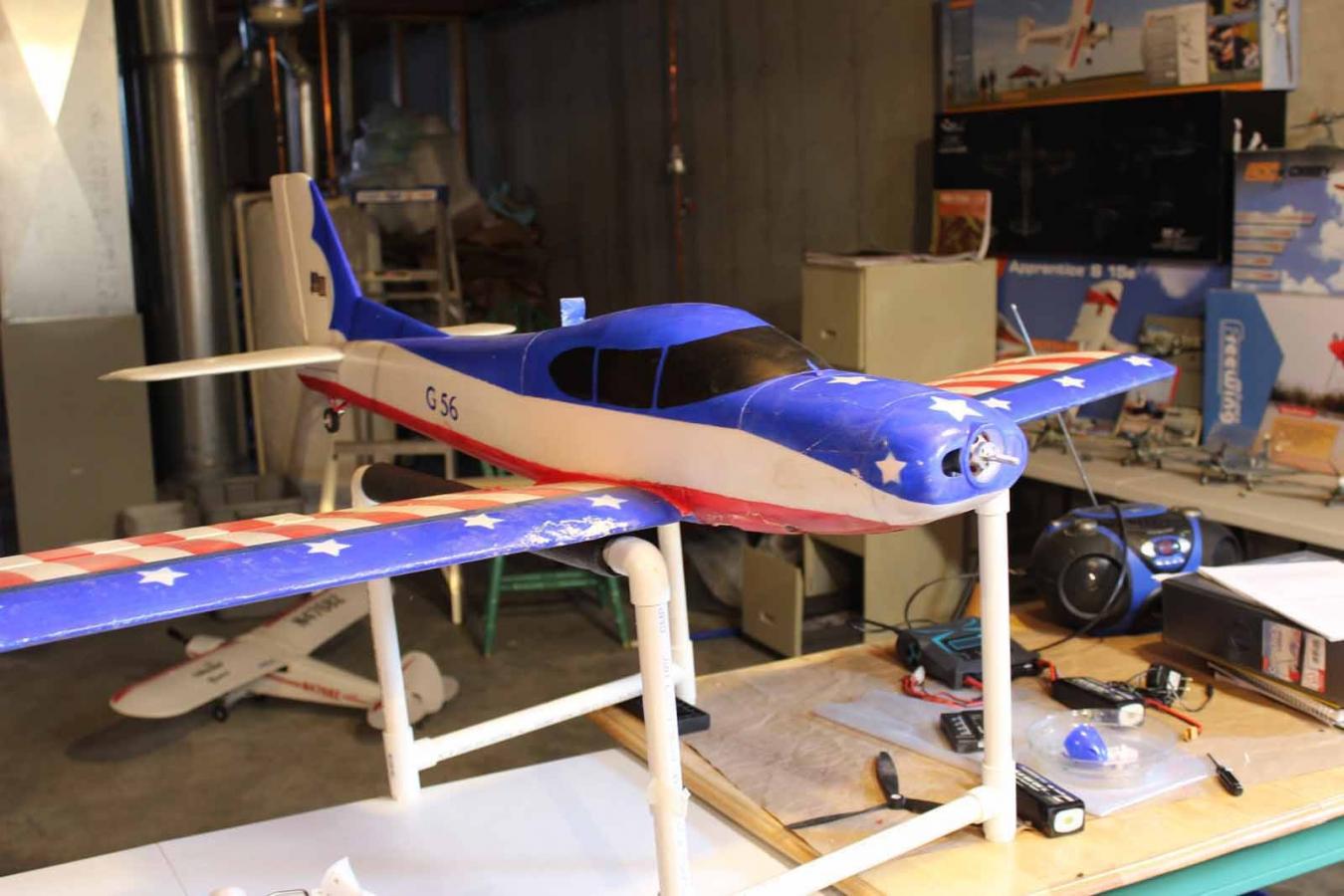

                                  From what
                                  I can see, that's just a project, definitely repairable
ID:	132116Click image for larger version
                                  The Spitty broke her nose off as a result of a bad soldering job on the Deans connector on the battery. The Pandora was because of the elevator servo packing it in during take off.
                                  Both are back in the air now.

                                    Oh yeah thats an easy repair job right there

                                      Groosman tell me that's not the 1600mm Spit But glad she's back in the air.:Whew::spitfire So tell me how you broke the nose off cuz of a bad soldering Job on the battery side? :Confused:

                                        Well, when you loose power and the plane is flying forward at a good clip, the solder joint let's go and you have no way to pull up

                                          Some ESCs (usually cheap ones...) will allow the prop windmilling to provide power to the RX through the BEC if the battery is disconnected. Works until RPM drops too low, then the RX goes through a reboot and never finds enough power to get back control of the airplane.
                                          The better the ESC the less likely this will work.
