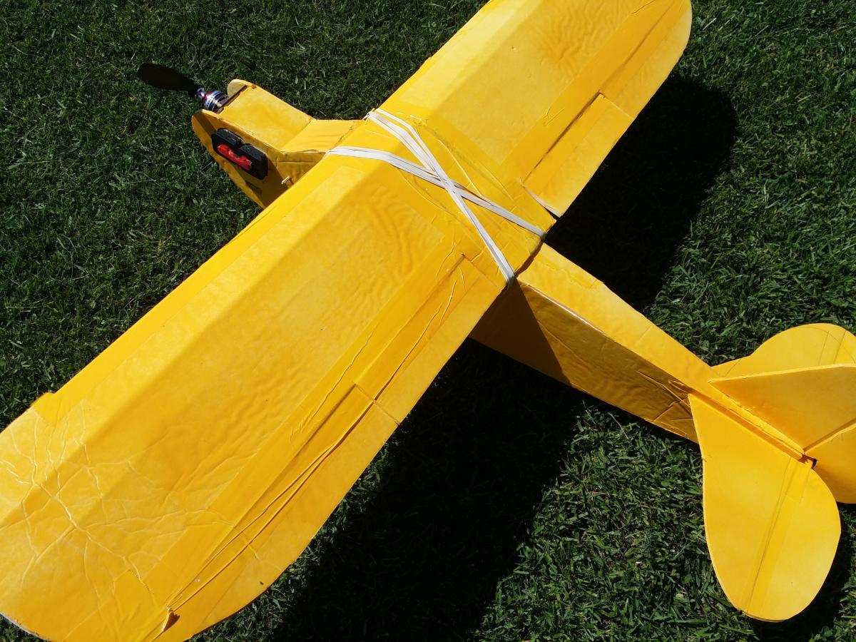

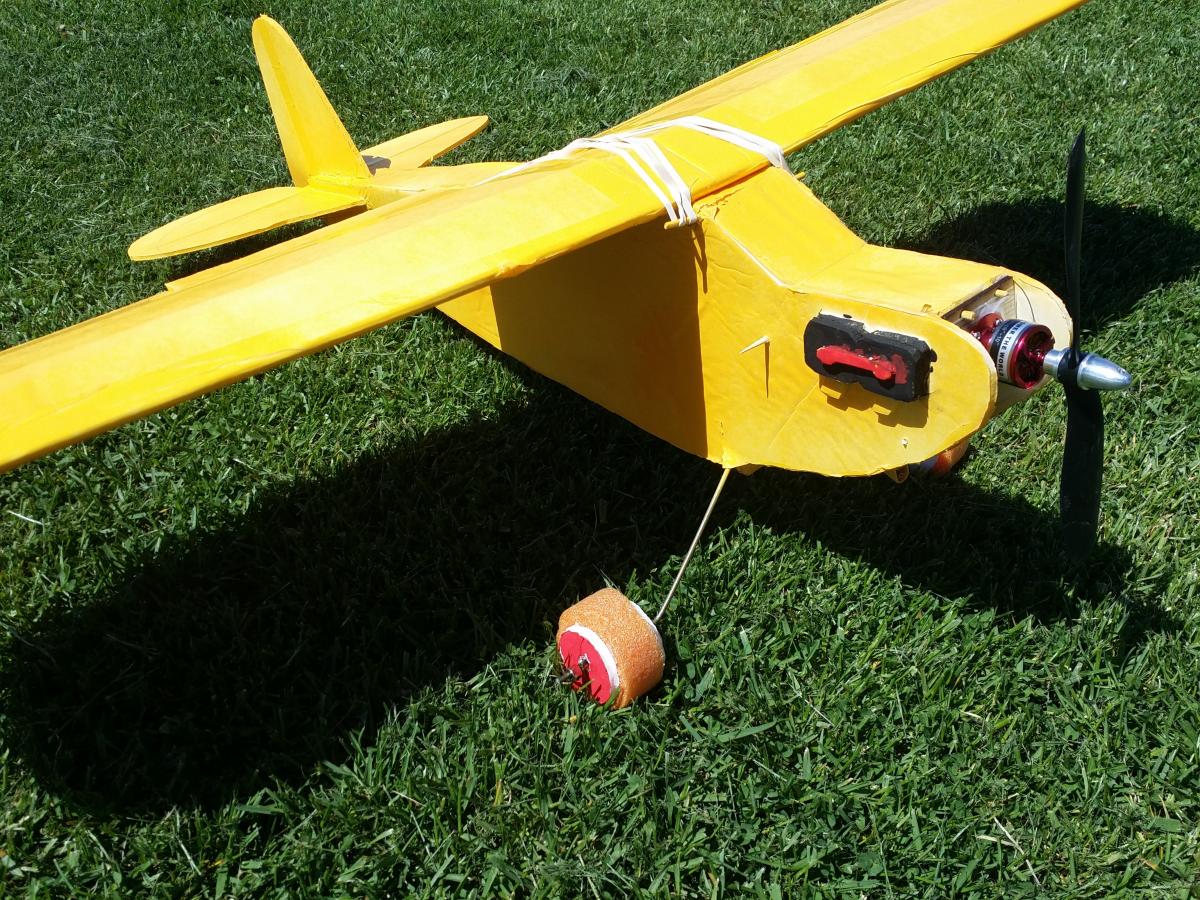

                                  a buddy of mine flew a scratchbuilt Flite Test J3 -
                                  (see attached)
