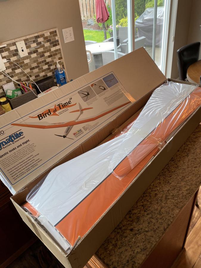

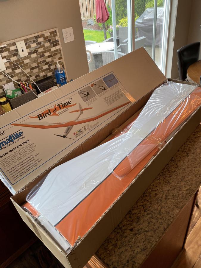

                                      • #39
                                        She arrived in impeccable condition. I cannot wait to get started!
