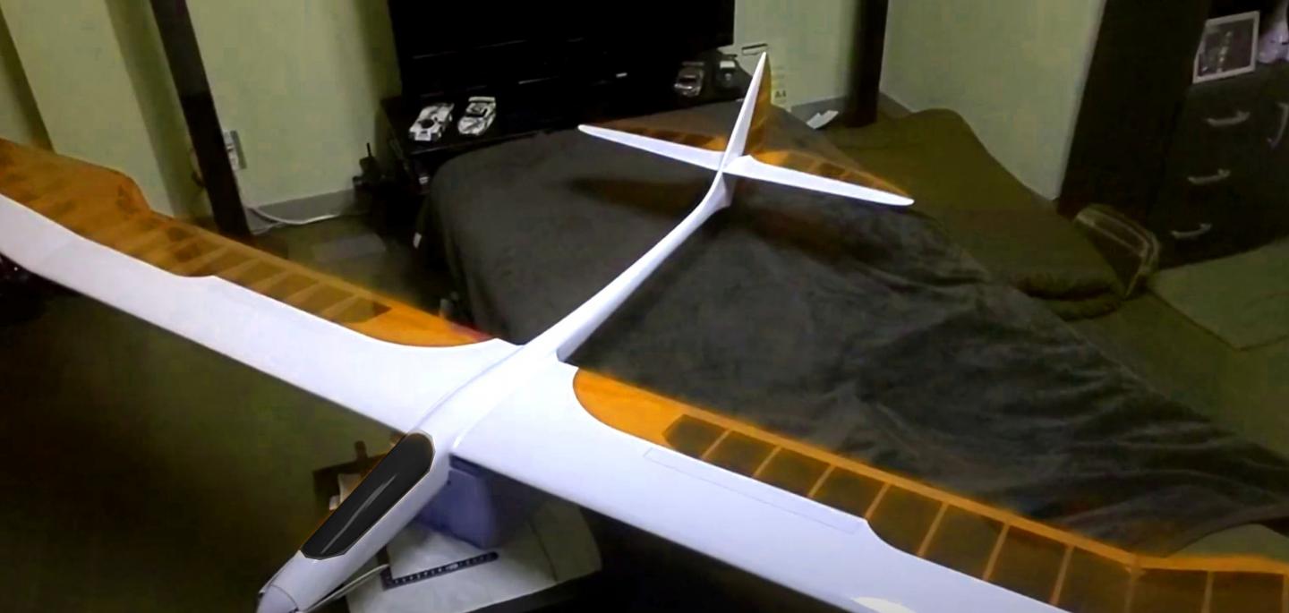

    One thing I know I will eventually want to do is have the skin redone to showcase the ribbing structure. I think it's a great compliment to this classic airframe and wing. I have to wonder how much of a nightmare it would be to "de-skin" the current livery (wing and tail) and add new skin with orange translucent covering (similar to the photo below). Nothing I will want or need to do anytime soon but down the road I would love it. I may have to outsource that job, lol.

      I think de-skinning can be done fairly easily with a heat gun. Slice the skin open in an area between ribs, heat it up as you peel it away. It should come off in big sections.
