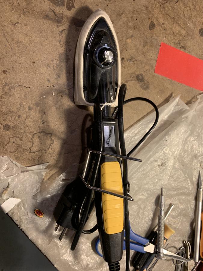

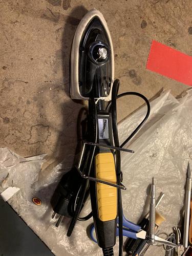

                      Also, sorry for all the questions but I've never owned a sealing iron before. Do you have any recommendations for a specific one? I see quality and temp control is a big deal with these...Thanks!

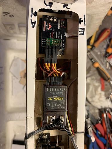

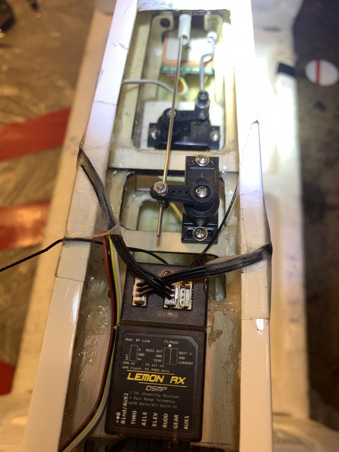

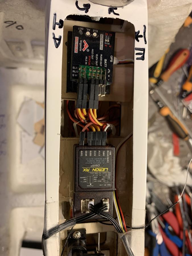

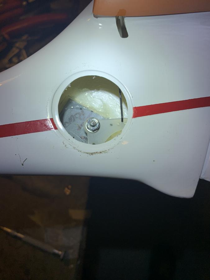

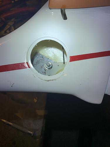

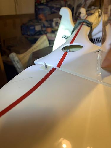

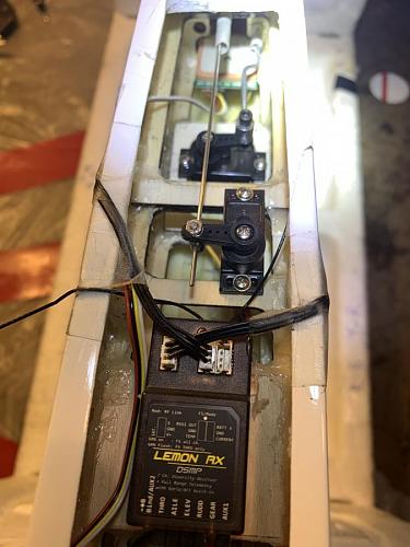

                        Yes, that bellcrank will do, however, the other Du-Bro ones that come in pairs and has a nut will be more secure. You'll have to cut the bolt a bit shorter. The iron I got was from HobbyKing but I'm sure your LHS will carry one. Inspect all the covering on your BoT. If it all looks like it's sealed down really well and the areas between the wood on the wing sections look tight, you may be OK to not bother with ironing it. It's just that the Mystique instructions say to iron the whole plane regardless. I'll attach a picture of mine.
                        The following is a series of pictures showing you the RX (with telemetry) and Bigaole placement and servo placement. Upon inspection, I realize that the spaces provided for servos is sized for 9g ones, so that's what I had and that's what I used. Seems to work fine over many dozens of flights. You can see that the rod sheaths were already in place, just needed to be trimmed a bit shorter for my build. You'll see the bellcrank through the hole in the tail. If you look at the slit above the hole, you'll see the elevator connecting rod. That was part of the parts bag that came with the plane. Also, you'll figure out that it must be installed onto the CF rod of the elevator as you thread it into the rod hole. To keep it from falling out, I left the whole elevator attached permanently. Another picture shows the other end of the sheath if you blow it up a bit. Again, that end had to be shortened a bit so it didn't interfere with the bellcrank movement.
