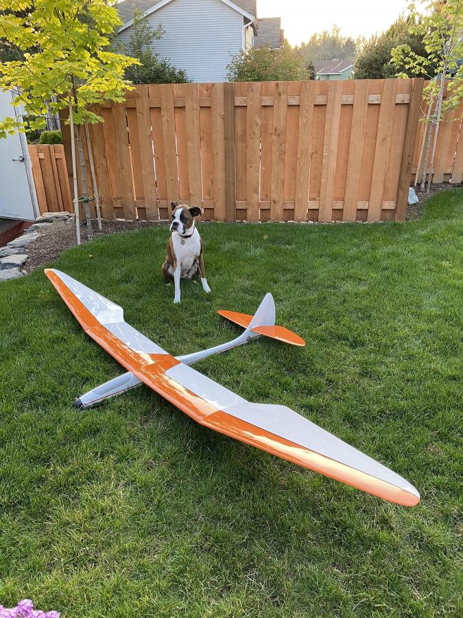

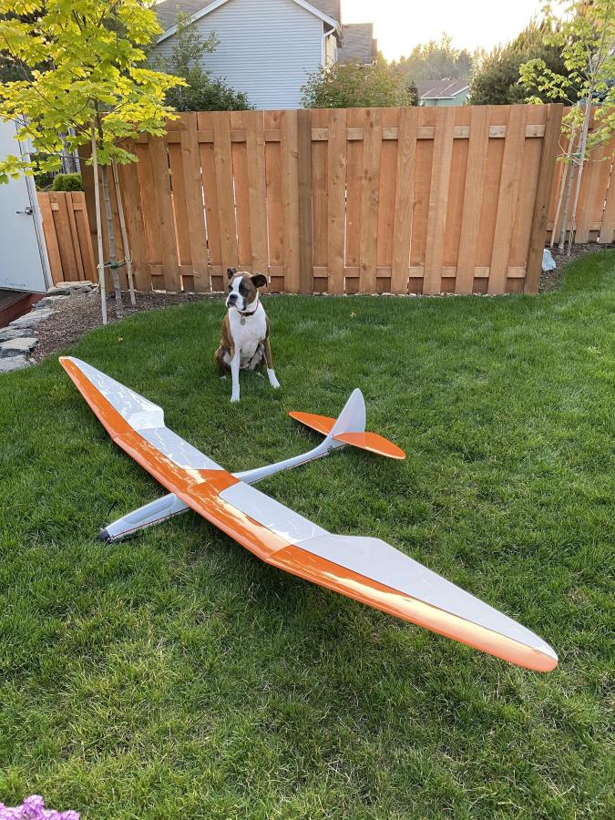

                      xviper maiden success. Beautiful day to maiden, found a nice open grass field. She needed several clicks of down and was a bit tail heavy. I have the CG marked at the manufacturer's location. I had to add a couple ounces of ballast and looks like I will need another couple ounces or so. But she flew beautifully and didn't want to come down, lol. She just wants to keep soaring. I found adding a little bit of power actually helped on the landing sequence. Looking forward to really getting her specked out at some point. Very pleased!
                      • #91
                        Bravo!!! Beautiful plane, beautiful scenery. I think they are all tail heavy when converted to electric. The amount of weight I had to add to the nose was ridiculous. Once you get it weighted right, it'll land almost all by itself (eventually).

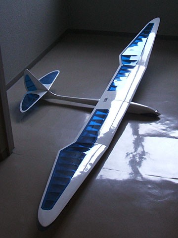

                                  Looking forward to eventually re-skinning her to show off the ribbing detail of the wings and tail like this:
