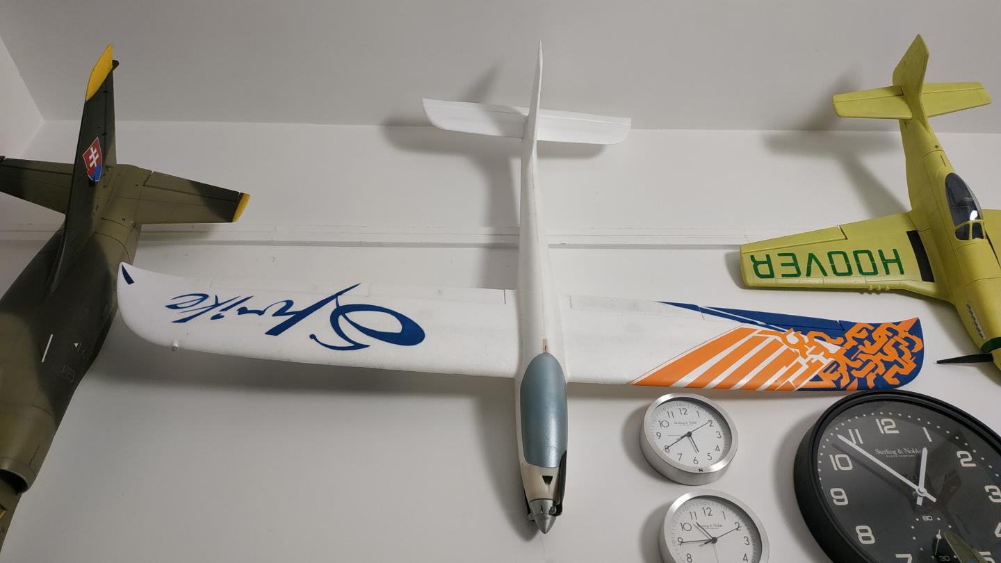

                I went back out with my Shrike earlier this afternoon, flying alongside its big brother..
