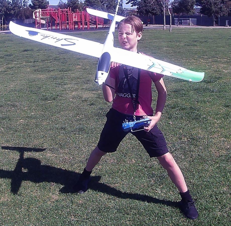

    BTW good luck to you and your grandson as you introduce him to the the absolute joy of flying airplanes, whether full scale or RC. I can tell by the look on his face in your photo that he truly is pilot material and should go far in the field of aviation, if he so chooses! Happy landings!

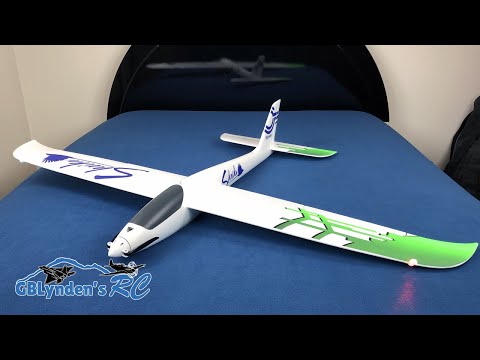

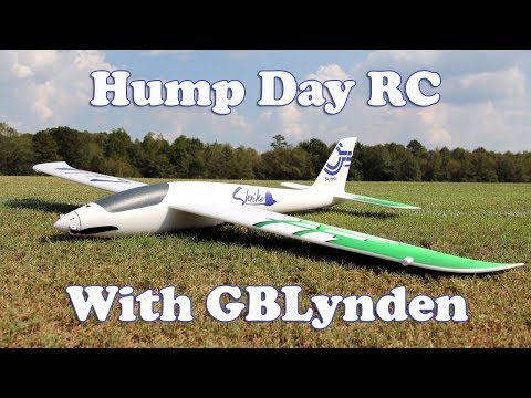

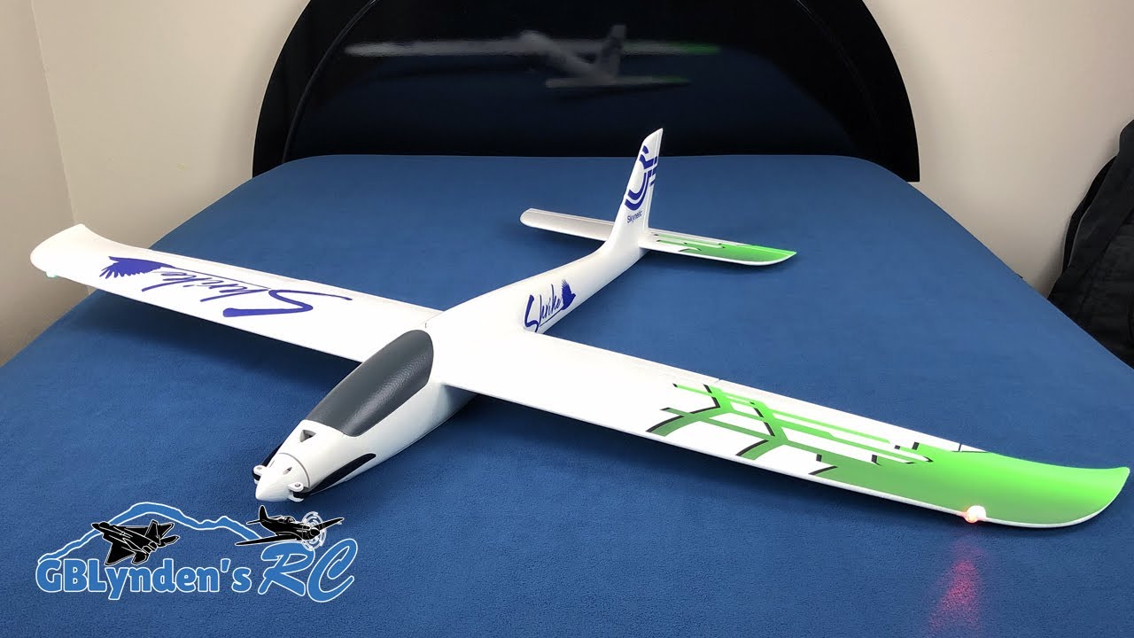

          Hey guys! I will be doing a livestream unboxing with this beautiful RC Glider on my YouTube channel this Wednesday at 6:30PM PST/9:30PM EST! My show is called Hump Day RC with GBLynden and I cannot wait to tear into this box live for everyone!

            Sorry about the link above. I was doing some testing last night and accidentally went live for a few seconds and it broke the link.
            This one should work for tonight

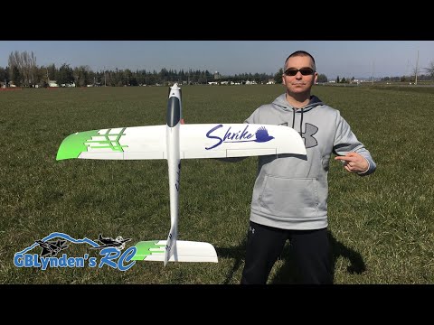

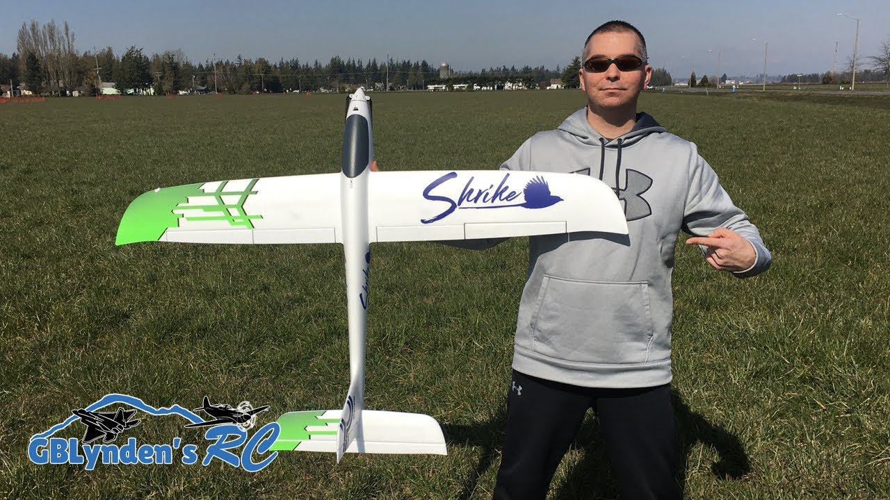

                          This video features my new Skynetic Shrike 1450mm Sport Glider Unboxing & Review.

                            Thanks for sharing, GB! I agree that the wire-less wing Connectors are a very convenient feature of this Glider. I like how it can break down in seconds to fit back in the box. Although, I normally only remove one wing for transport. That's enough to give me the space I need in the car to transport it alongside other models, such as the upcoming FlightLi--- oops, nevermind.
