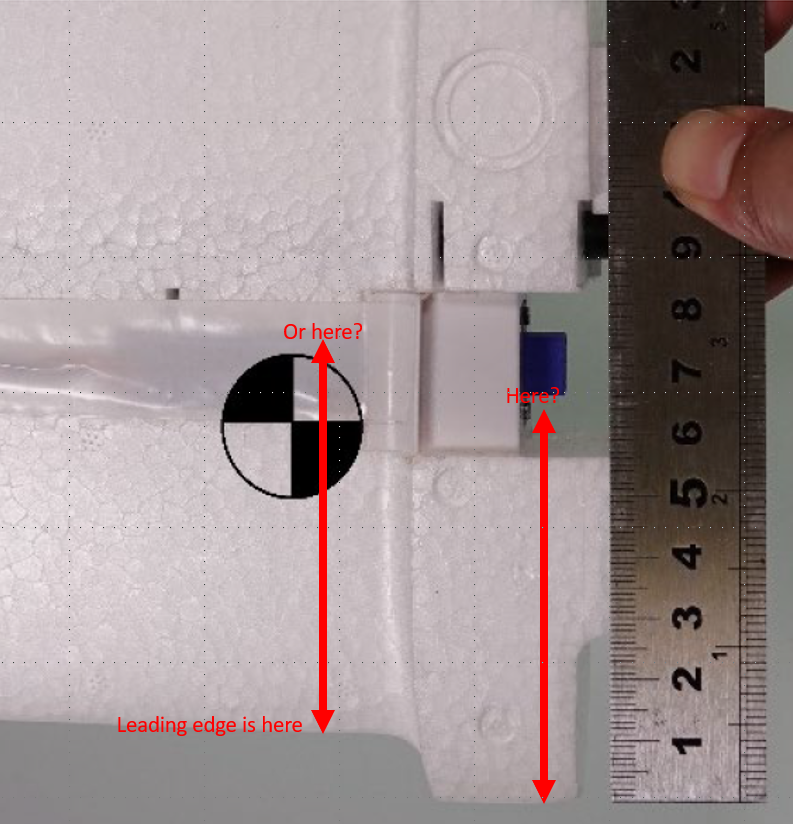

          CG Clarification
          The manual says 65mm behind the leading edge but the photo shows 65mm behind the fuselage insert which is about 10mm further forward. Which is correct?

            THe aft location is what I used and your rx AND battery have to be shoved WAY back in the fuse to get that CG however with this location the plane flies well with a neutral elevator
            • #86
              OK thanks, so just to be clear 65mm back from the actual leading edge? More or less the rear edge of the connector.
              • #87
                Yes, if not a little further back than that for a neutral dive test.
                  OK cool. I usually shoot for a slightly nose heavy CG so the dive test yields a mild pull-up.

                          The 3S 1800 45C fits and balances nicely to give COG 65mm behind actual wing LE. It is pretty close to being centered under the provided battery strap. I have not air-tested yet but will soon. My 3S 1800 came from GensAce

                                    The direction for the Shrike says that the cg is 65 mm behind the leading edge of the wing but the picture in the manual shows 65 mm aft of the front edge of the foam in the fuselage. Which is correct?
