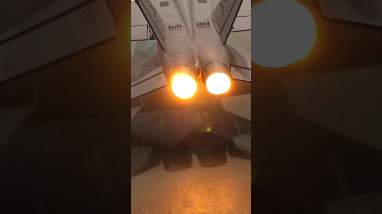

          Do-It-Yourself dual tailpipe flickering afterburner on the F/A-18F.
          Also I have some 3DP files for this model on Thingiverse.

            [QUOTE=kallend;n298288]Do-It-Yourself dual tailpipe flickering afterburner on the F/A-18F.Also I have some 3DP files for this model on Thingiverse./QUOTE]
            KE, Diggin' the 'flicker' a lot. Very cool... How did you do that? I need to know. :face_with_monocle: Best, LB
              • 8228
              #106
              Ditto. Flicker. Is. Ooooooooooh.

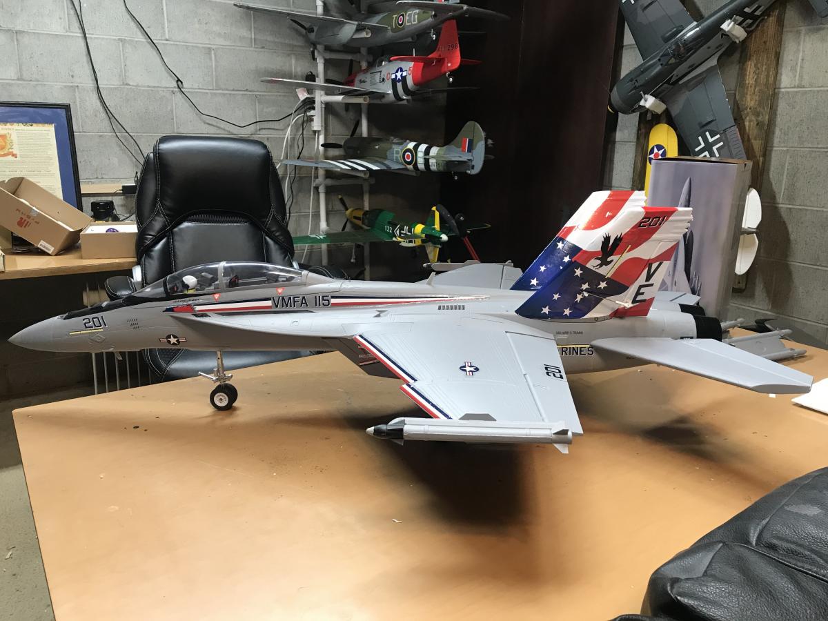

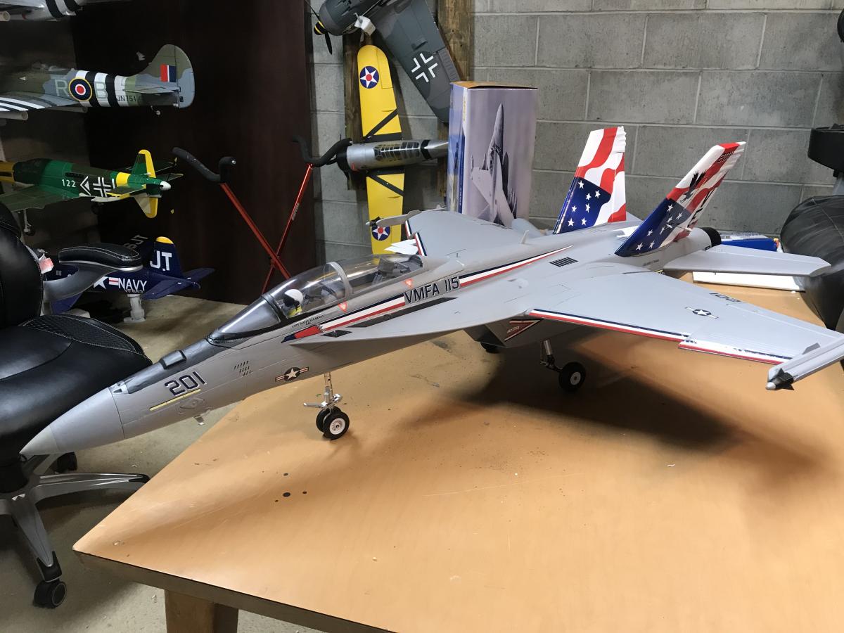

                  Just finished up the FMS F/A - 18/F 70mm. I have the V2 with the 1900 motor. I have the CG set at 70mm with my 6s 4000 pack
                  Thanks to callie-graphics.com/collections/f-18-hornet for the awesome livery of VMFA-115. Should make sure there are no visibility issues. Just waiting on Gooniac for the afterburner........ However, may have to maiden without if this snow ever melts....
                  Question - Based on the comments above, is it wise to move the CG back to 75mm or 80mm before the maiden or wait until I see how it does in the current position?

                    Originally posted by Ah's Availble
                    Just finished up the FMS F/A - 18/F 70mmThanks to [COLOR=#3498db]callie-graphics.com/collections/f-18-hornet[
                    AA, She's a stunner, great work. Best, LB
                      Looks awesome!! I am sending out a ton of burners over the next couple weeks so will keep you posted. I haven't messed with my CG since I got the plane and it has been through a few different edfs too... I used 30c-40c 4000s and they are about 1.25 inch from the front of the battery bay.
                          Thanks Gooniac. I am planning on using a 40C 4000 pack as well. I will try it as is. Really appreciate the info.
                          I didn't mean to prompt you on the afterburner. You were straight up on the delivery time. I just wanted everyone to know that your burner systems are awesome. I just want to see that beauty in the air. But unfortunately weather up hear is awful right now. I will post when it maidens.
                          No worries man! They have gotten pretty popular and I am having to meter what I do to keep my sanity and most of all... be able to fly! I gotta have my one day a week to fly! Maybe even make it a lil more often if possible. If I get them done sooner then great! But I gotta have the time for regular life too. I hand assemble every one of them! Nearing 2000 now....
                          also the F-18 looks really good with the latest set up! You will love it!
