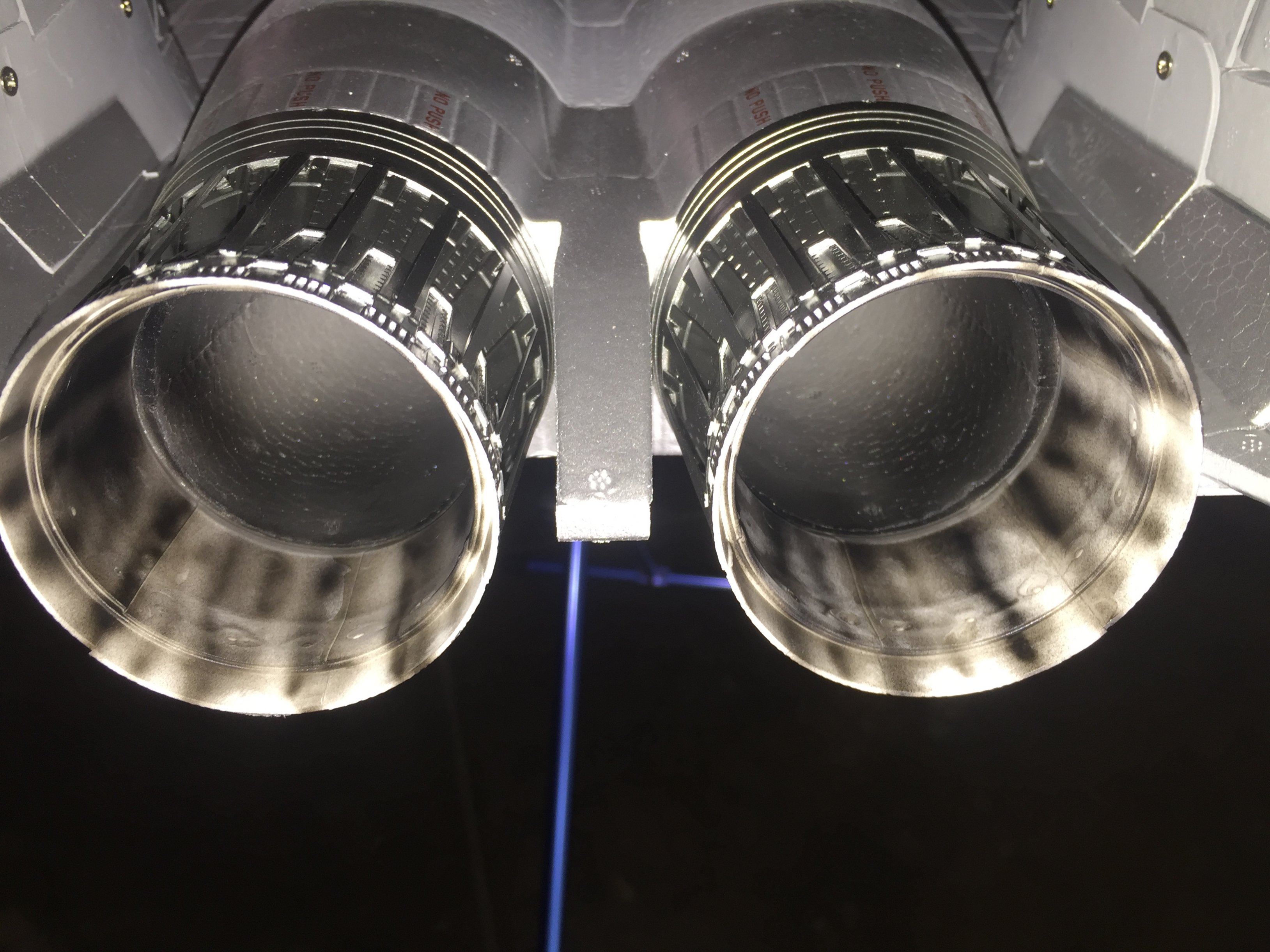

                  One thing I've wanted to do from the get-go was paint the inside of the exhaust nozzles to make it a bit more realistic. Having the plastic being white is perfect because all that's necessary is to make the black shading. It's easy as pie with an airbrush and a couple minutes time, as well as some water-based opaque black Createx color.
                    #89
                    Those pictures Bajora... talented, you are, my friend!
                    Nice nozzles, T-cat! Yes the white plastic was chosen by design instead of being painted black. I once climbed INSIDE an F-15's burner can on the flightline decades ago. I remember it being white with those dark areas, exactly as your picture shows.

                      Thanks Alpha. The F-15 has some of the best looking exhaust nozzles out of any jet. Very cool and unique!

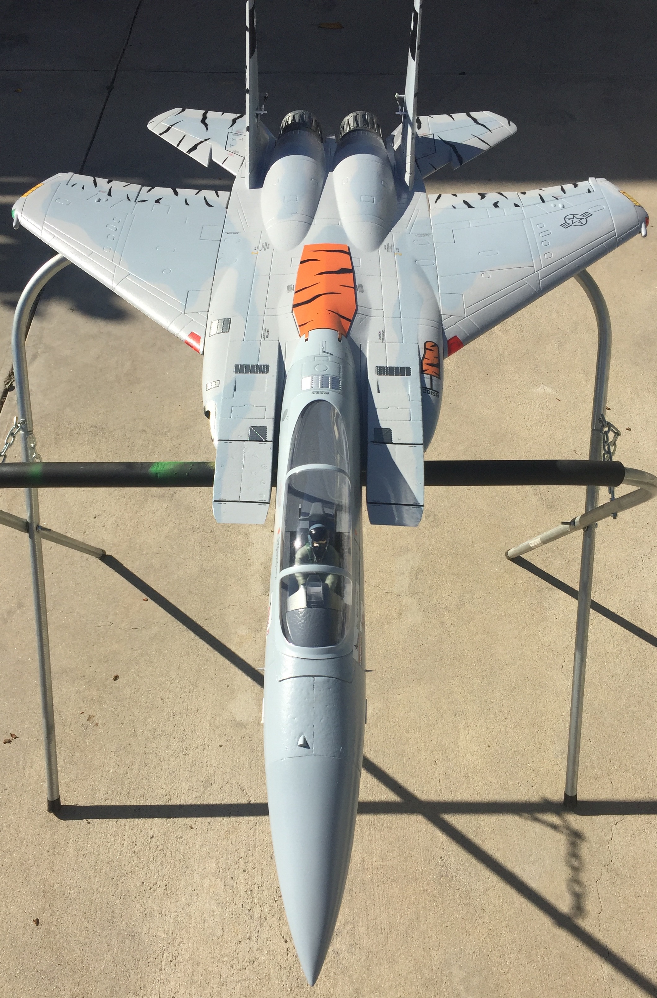

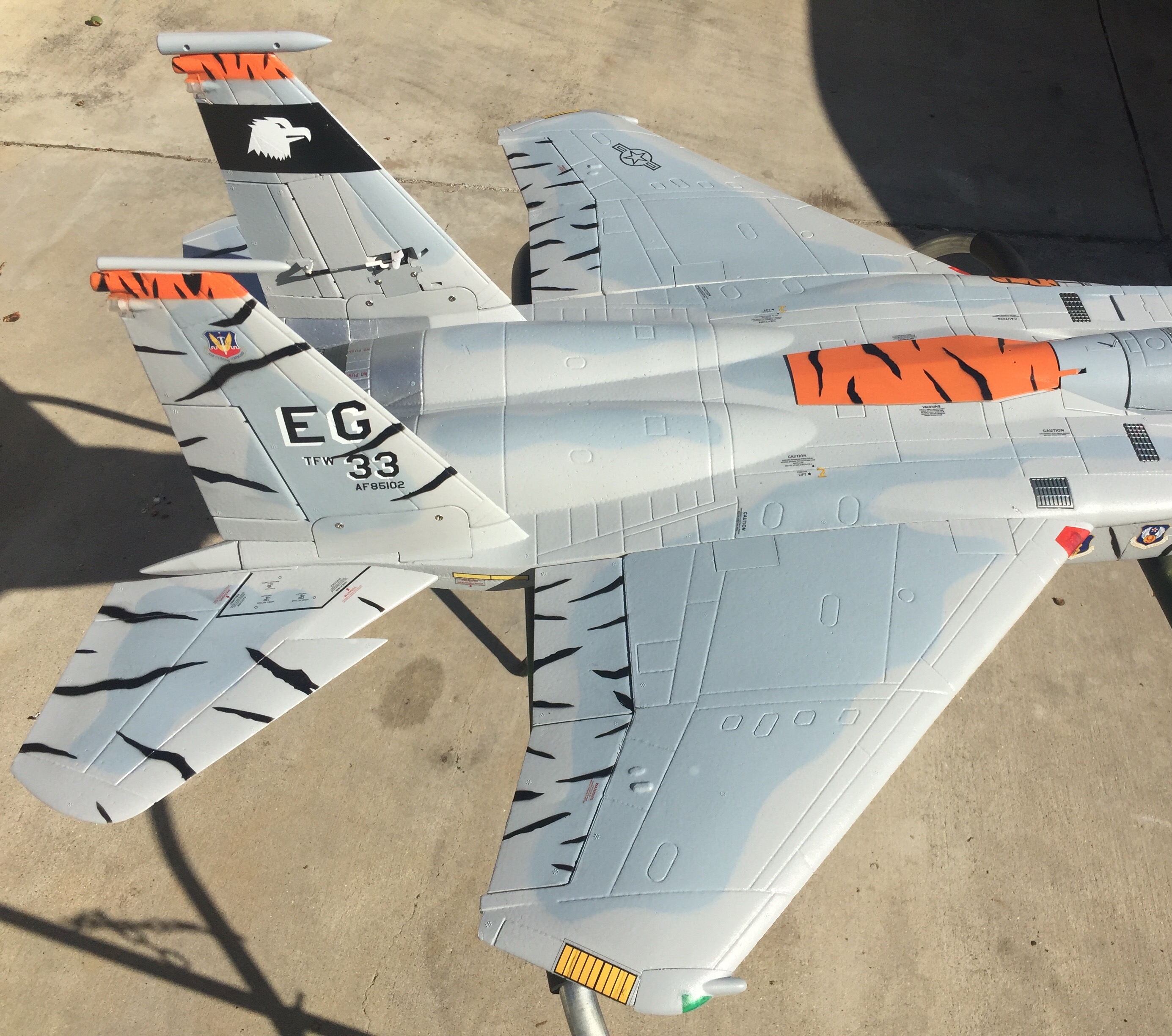

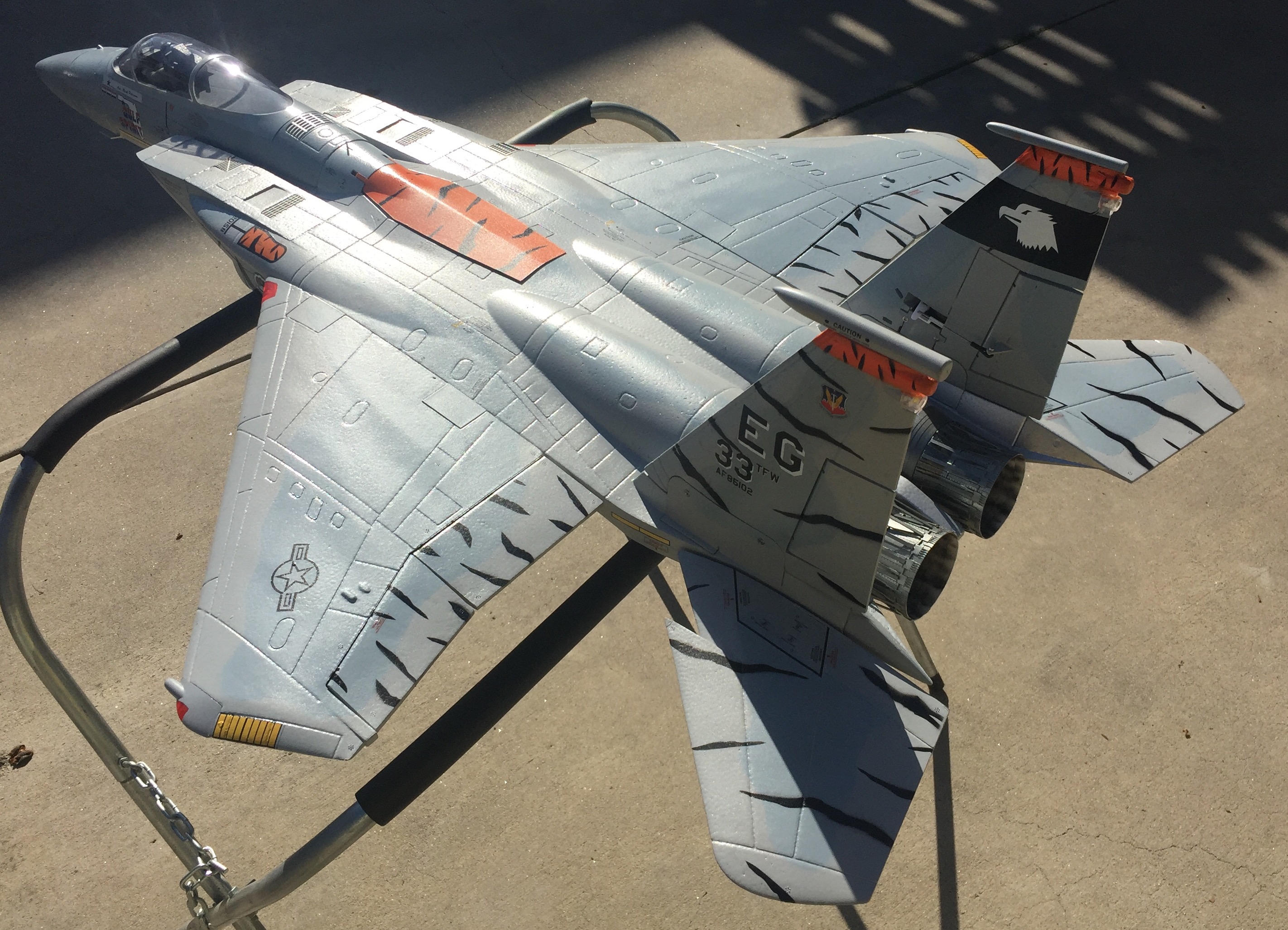

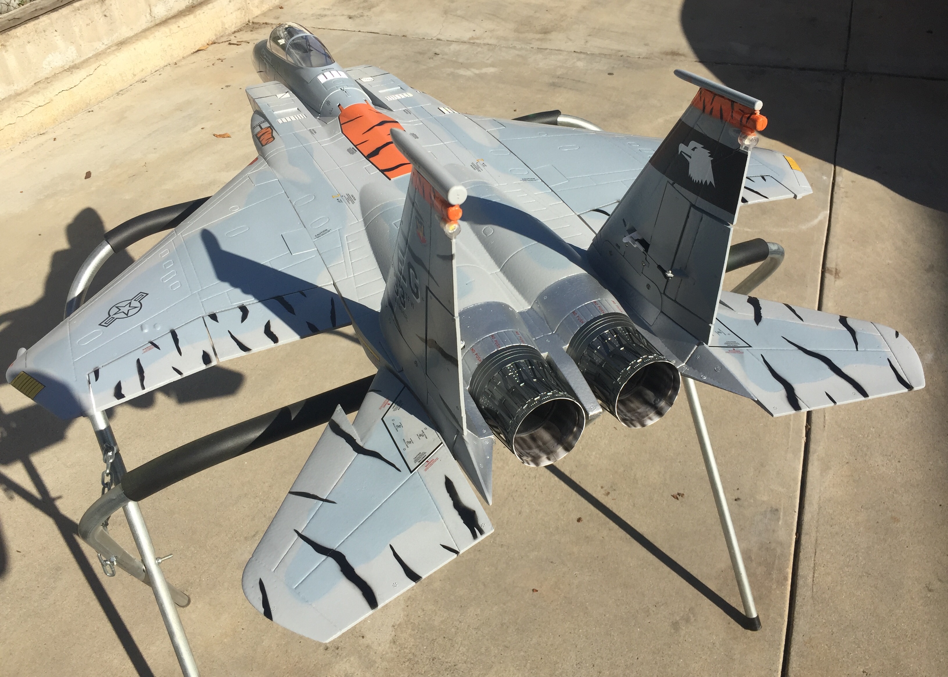

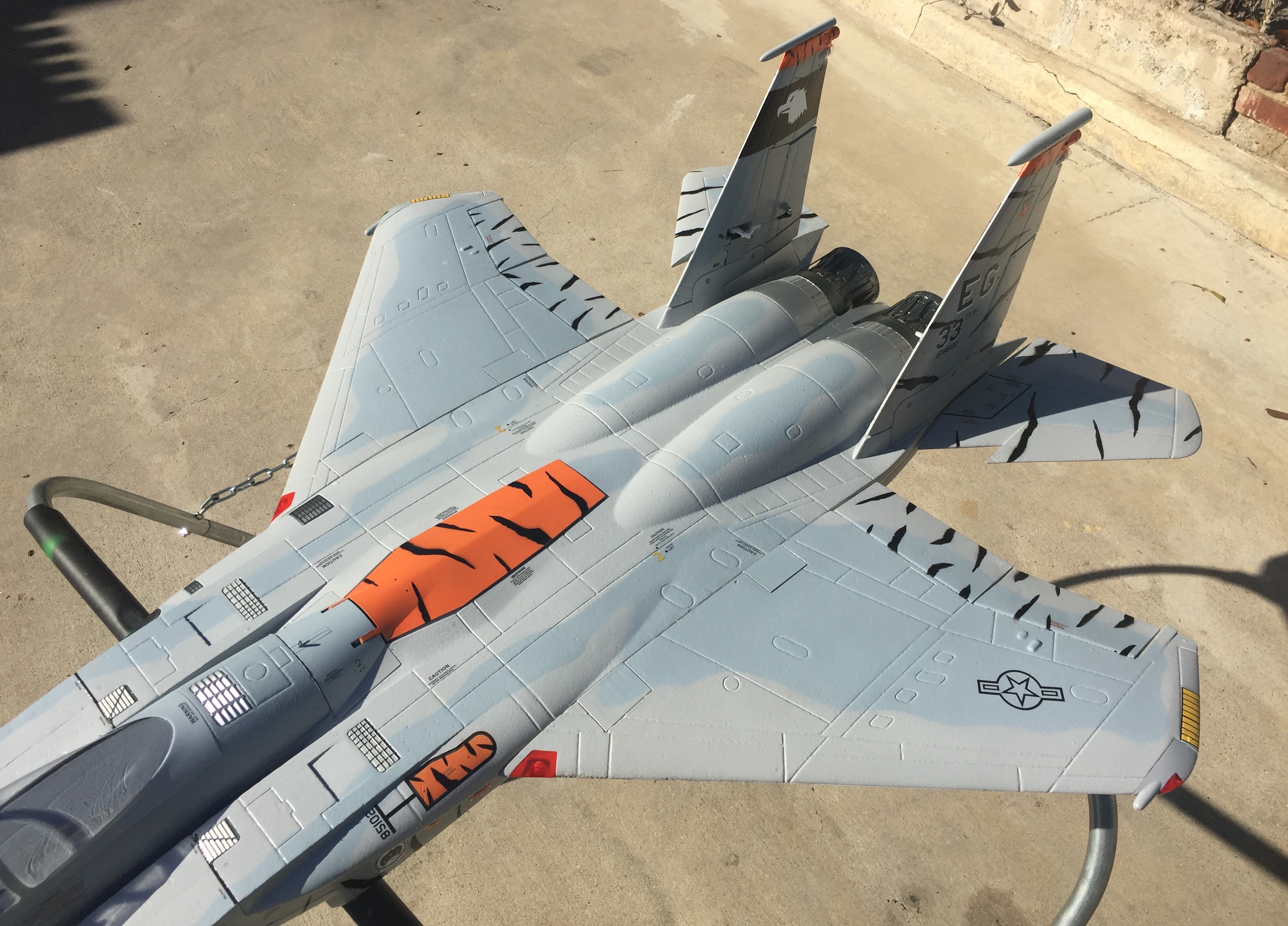

                              Thanks guys :). Since I have been airbrushing lately, I figured I minds well go for a new paint job. I really like the look of the 2005 Tiger Meet of the Americas paint scheme. Now, that is only for the E-model, but I'm not going for any scale awards, so I made this C-model into that paint scheme.
                              I used Createx water based airbrush paint in opaque black and opaque coral colors. There is also a couple costs of gloss Minwax Polycrylic clear spray on the jet. I forgot to take pictures of the sides of the aircraft because there are tiger stripes painted along the fuselage as well.
                              I'm really pleased with the way it turned out.
