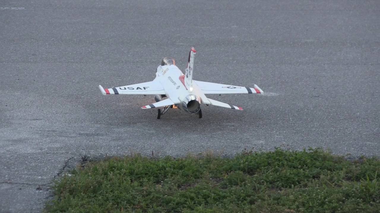

Hoping to mod my F-16 like this also. Unfortunately it may be another week before I can test fly.
I love the enhanced sound and plan to do my F-16 the same way. Don't know about you guys but I want more whistles! Perhaps in the intake also!Comment

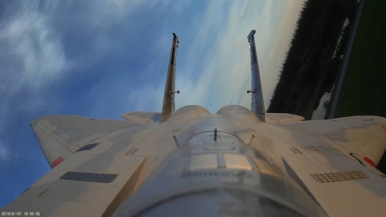

Pretty pleased with the whistle mods on my F-15 and F-16; even though the whistles can't be heard much at full throttle, which was to be expected, the sound during slow passes, taxi, landing and take off is very cool to me.
Doesn't seem to effect thrust in the aircraft.

Thanks guys. Final test with 6 whistles; this time with three additional; on the intakes and bottom of nose.Whistles taken from Nerf Vortex mini football.Comment
I prefer the way that it sounded with less whistles because it seemed more realistic to me. At full throttle there is no whistle sounds so it was accurate. but with that being said it is awesome either way!! I may have to do this to mine now....Check me out on youtube at https://www.youtube.com/user/gooniac33
