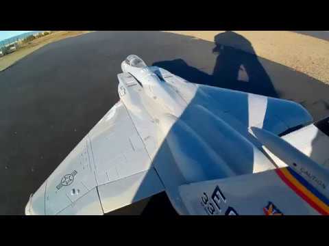

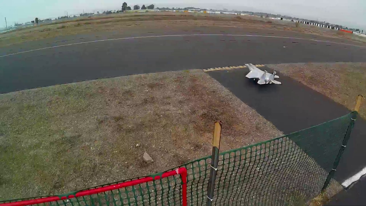

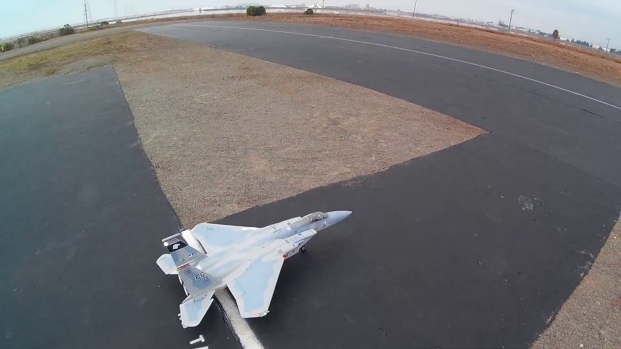

                • F-15 from this weekends flying...

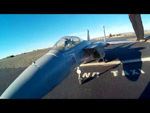

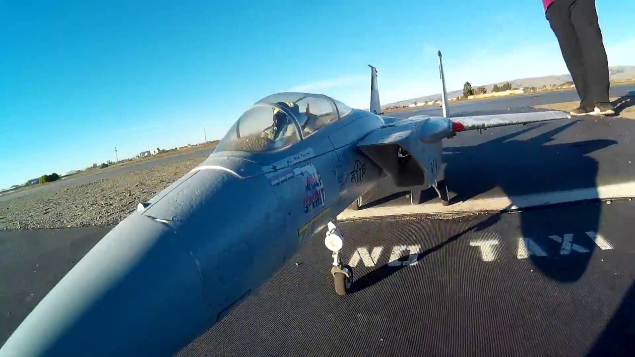

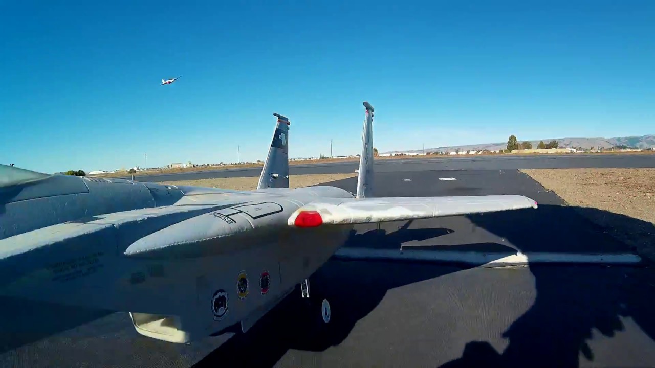

                  • and more this past weekend as well...

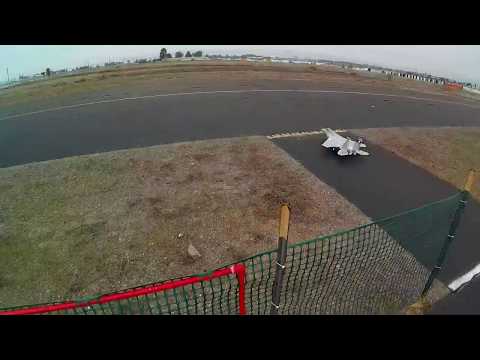

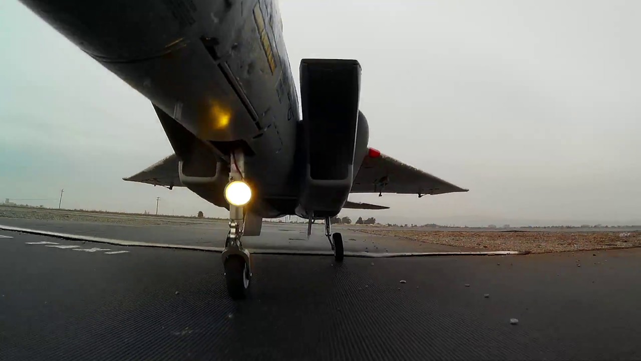

                        • Yesterday's flight
